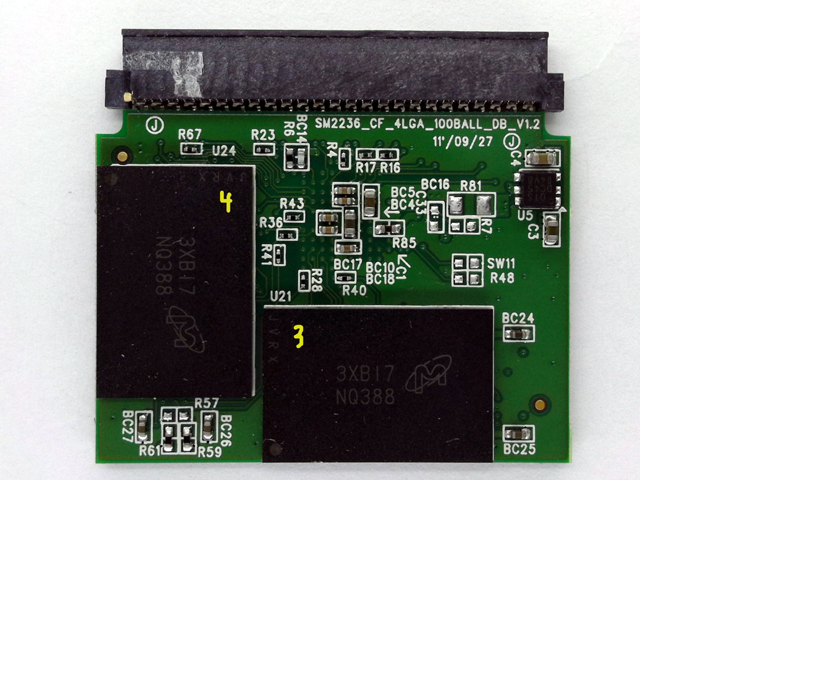

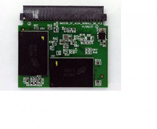

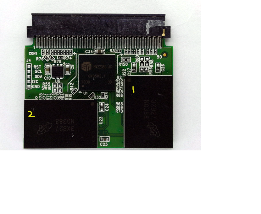

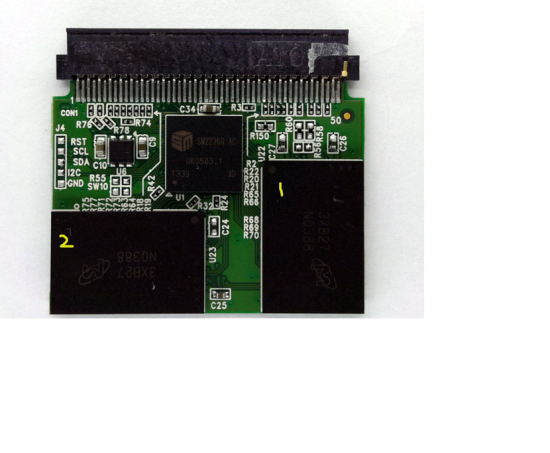

dear all am new member here and have this cf memory
the order of chips is correct or no?
thank you

I don't know, but the white silkscreen order says U21, U22, U23, U24, which would be 3, 1, 2, 4

Soft-center use this order number sequence - same as on photo. I recommend it.
