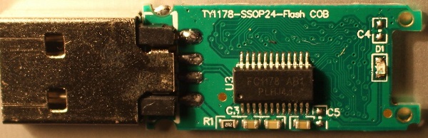

HI,
Anyone able to share pinout of this FC1178 controller? I haven't come across much documentation for FirstChip controllers.

ISTM that it shouldn't be too difficult to reverse engineer the pinout.
I would start be measuring the voltages on each pin. The data pins would most probably be grouped together.
The 3 capacitors are probably 5V, Vcore and Vio or Vcc/Vccq.
The USB pins should be easy to trace.
