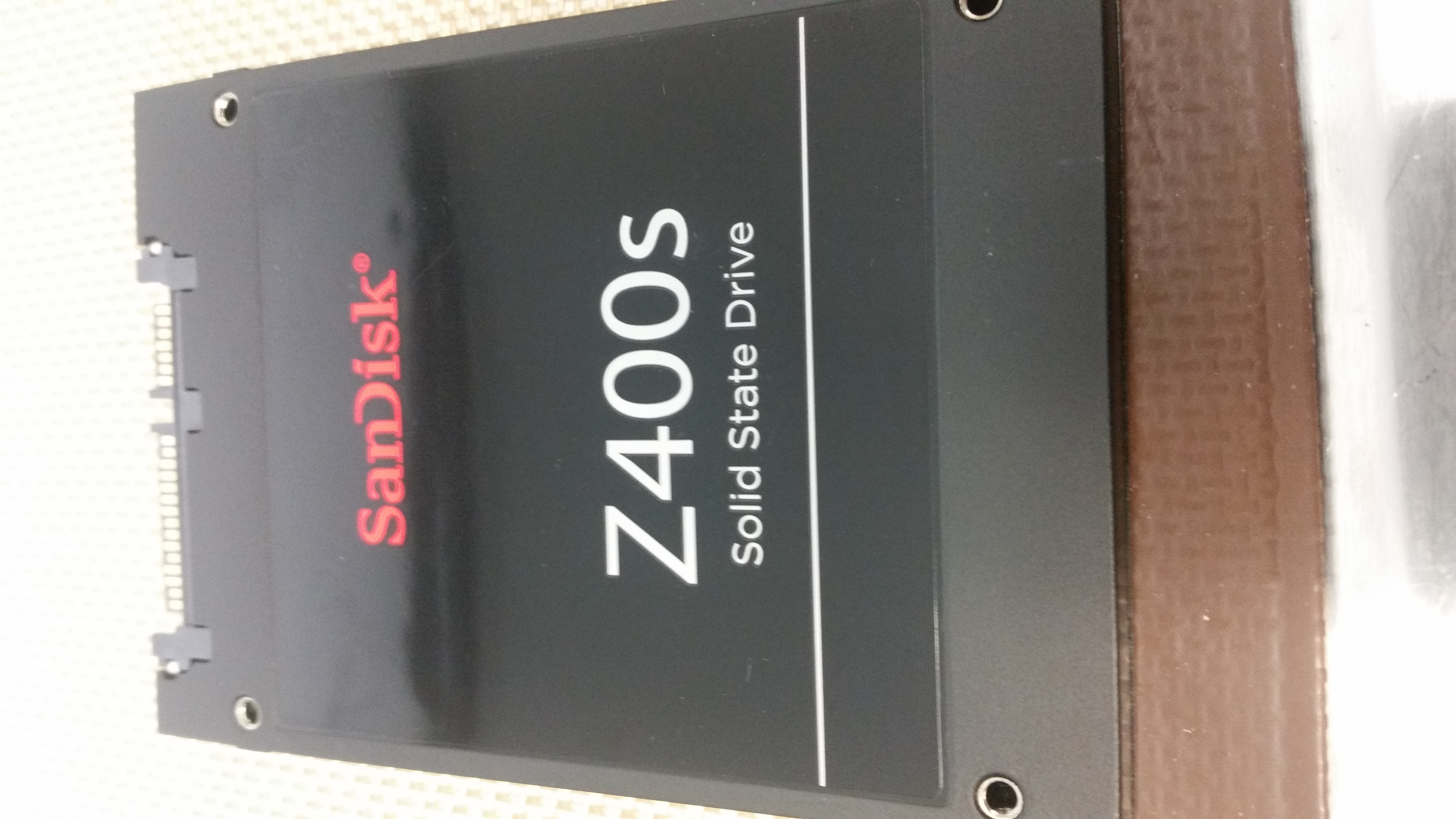

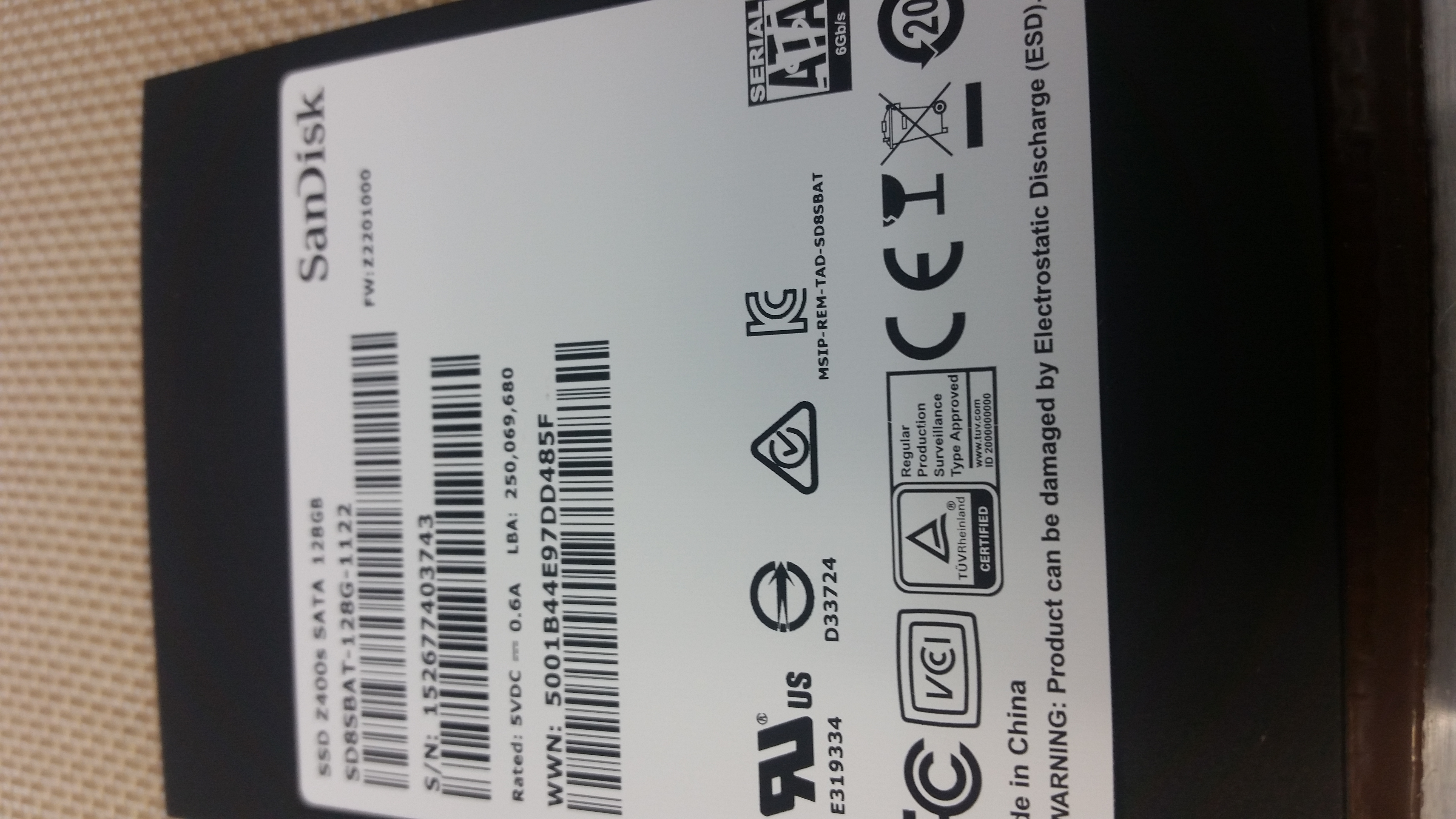

May seem a simple question, but how do you open this SSD? Normally you can see indentations of screws through the labels, but this seems absolutely flat like its been glued together?

get a spudger, a good strong stainless one and slip it between the plastic shell. it is held together with clips probably. most sandisks are.
something like these
http://www.lightinthebox.com/metal-pry-spudger-opening-tools-kits-herramientas-mobile-phone-repair-tool-for-iphone-ipad-samsung_p6228210.html?currency=AUD&litb_from=bing_shopping&utm_source=bingshopping&utm_medium=cpc&utm_campaign=bingshopping
another trick is to search for reviews and look at the case disassembly pictures for seeing how it is held together.
BTW, in the sandisks that I have pulled apart, the PCB only goes to just under where the red SanDisk word ends, and there are 2 clips also holding case together there. You have to force it quite hard, while being careful!

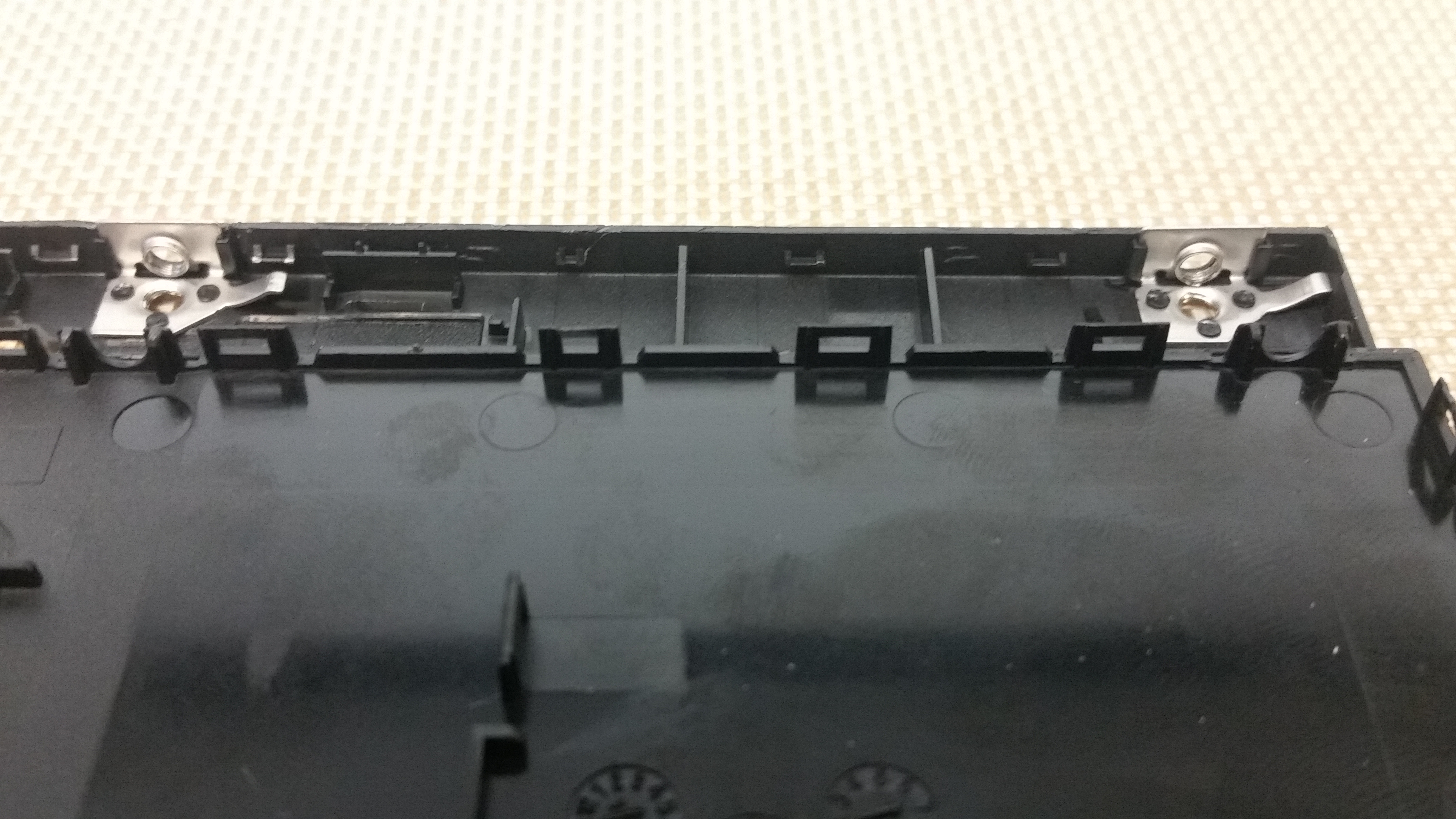

Thanks for the comments and help. For anyone that has the same SSD, these are the clips and locations which will help opening the little sucker.

the 2 clips who makes you think that there is some screws
