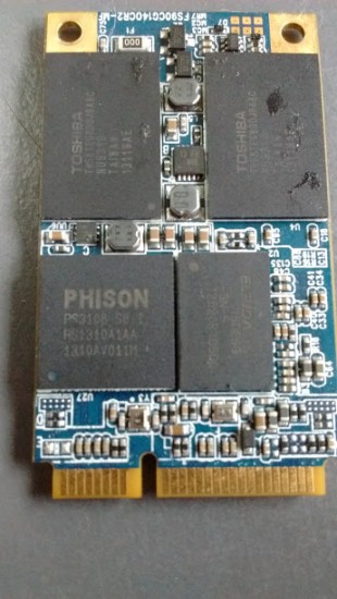

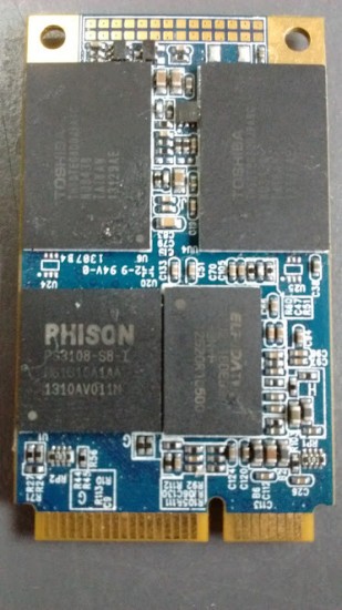

Hello everyone, i receive a very strange msata ssd is made by kingston the model is SMSR150S3 128GB. And this ssd is like 2 ssd in one drive, because if you see the the board this have 2 controller (ps3108) 2 ram chips and 4 flash memories. When i put the drive in a adapter, msata to sata the mother recognize a drive with 64 GB o capacity. I want to ask if some one have a similar case and if exist a adapter for this ssd, because i belive this ssd is 2 drives in one pcb.

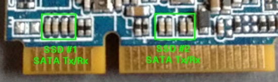

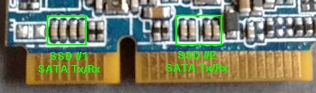

It appears to be a RAID.
These could be the SATA Tx/Rx capacitors:
 Post subject: Re: strange msata kingston
PostPosted: November 6th, 2017, 15:37
Yeah, that's from an Acer Aspire S5 or S7 laptop. It's a RAID 0 of two SSDs.
I've got a setup here so I can recover them, and so does Recovery Force who I shared the pinout with and also built his own adapter for these.
There is no standard adapters for these, only way is to buy one of these laptops and use a Linux live build or build your own adapter.

I can help with voltage measurements in case one of the SSDs is dead. I would need better photos, though.

There is no standard adapter for these, they use a proprietary mSATA pinout. Standard adapters will only allow access to one of the two SSDs, which is why the OP is seeing a 64Gb SSD even though it's really 128Gb. In my experience, these are usually fine, they just can't be copied using any standard adapter so computer techs give up.

I clone one the drives, now a im a looking wath i can do to read the another.
the ssd wich i can read is with the decouplers capacitors of the right, i am thinking to take off this capacitors and soldring the decouplers capacitors of the left directly to contacts of my msata adapter.
You would need to get the order right. To this end I would compare the traces leading to the controller on each side of the PCB. You may find that one Tx/Rx set is inverted with respect to the other.
