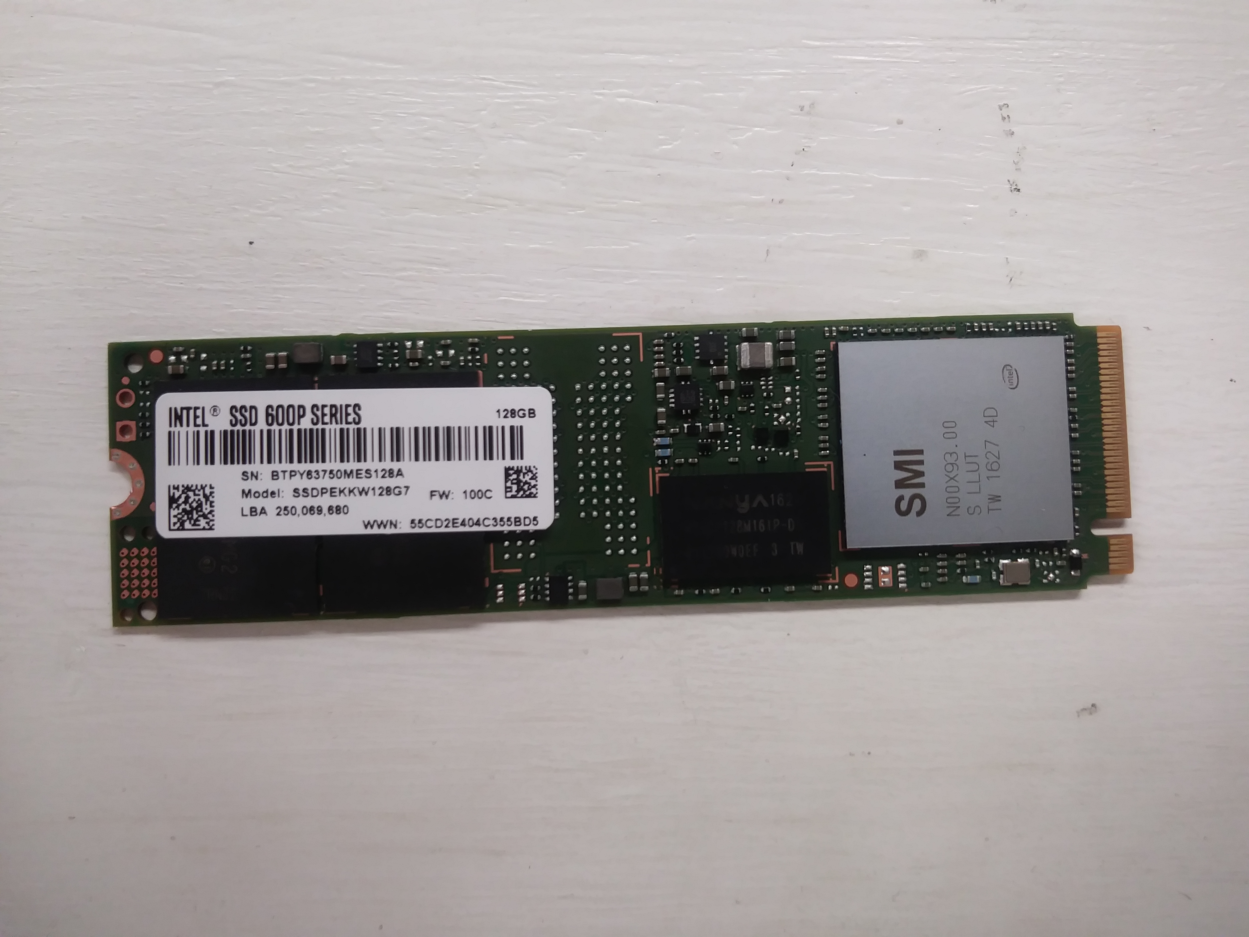

Does anybody know if there is an adapter for this type of SSD?
Many thanks.

Is this it?
http://www.google.com.au/search?q=NVMe+"gen3+x4"+adapter
eg https://www.angelbird.com/prod/wings-px1-1117/

Looks like M.2
https://www.mjm.co.uk/

http://forum.acelaboratory.com/viewtopic.php?t=9371&p=33394#p33394
https://www.ebay.com/itm/PCI-E-3-0-x4-Lane-Adapter-Converter-Card-M-2-NGFF-M-Key-SSD-to-Nvme-PCI-Express-/302311834321?epid=2131339460&hash=item46633082d1:g:e7MAAOSwlMFZErwi

Though I had not had a chance to read the Ace thread until now, it confirms what I have been scratching my head about as far as M.2 compatibility goes. NVMe M.2 SSD do not seem compatible with SATA M.2 SSD.

Your card is an "M key" type. This configuration can support PCIe ×4, SATA and SMBus interfaces. However, your controller implements only the PCIe interface.
