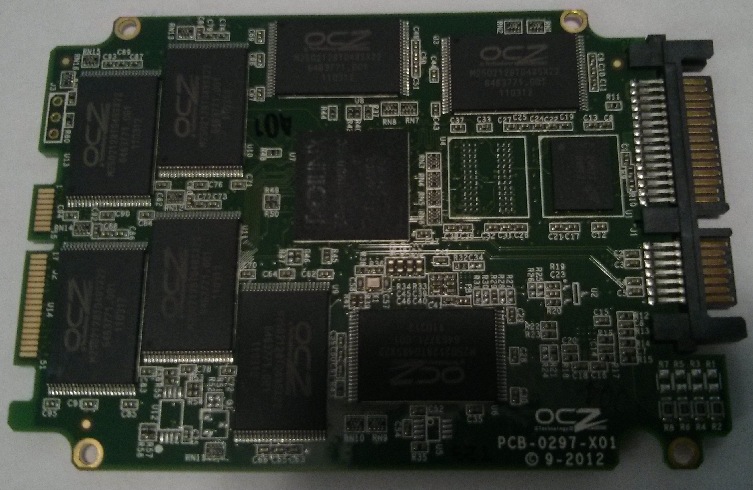

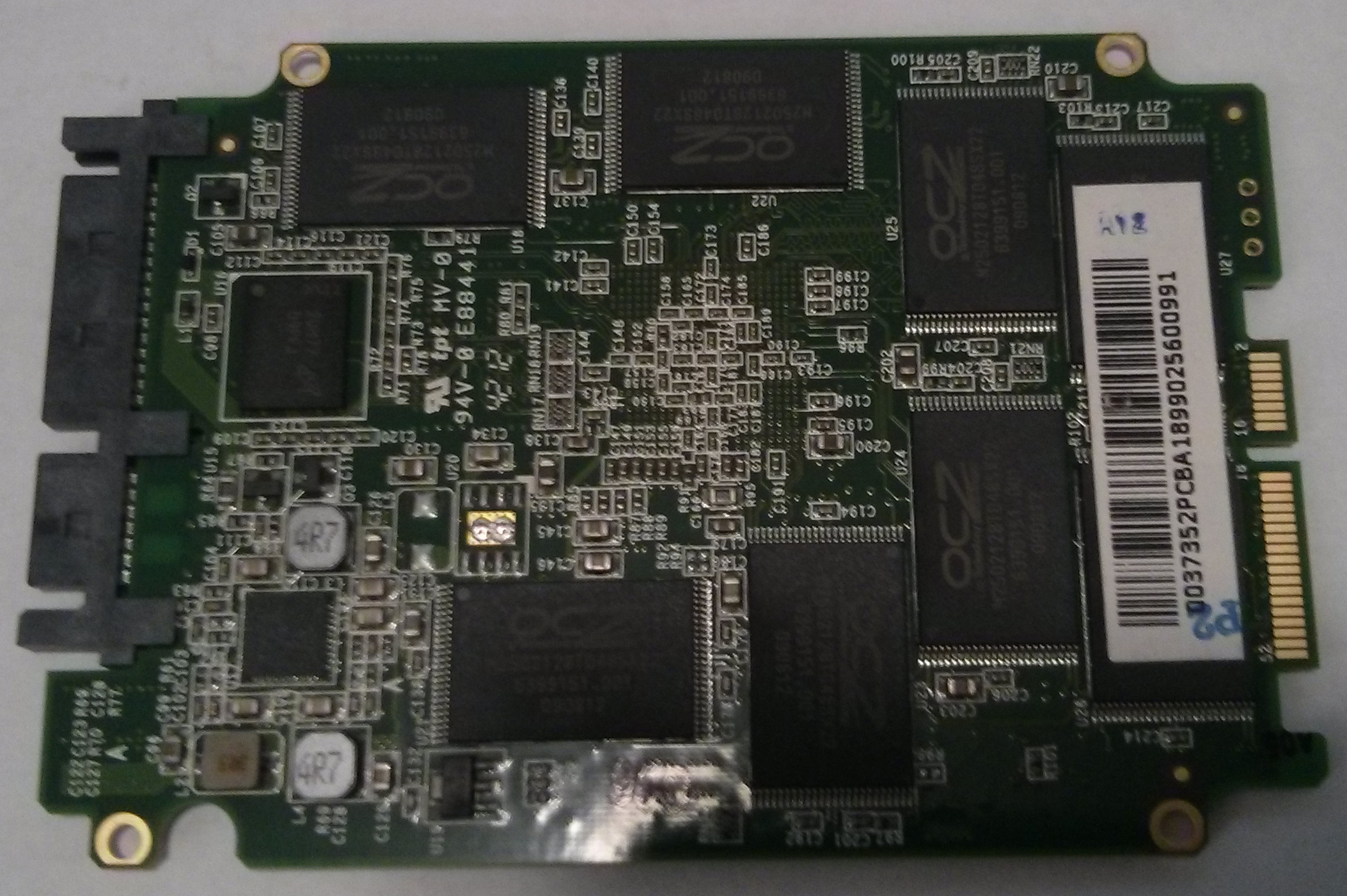

I have an OCZ Vertex 256GB SSD (Model VTR1-25SAT3-256G) with an Indilinx Barefoot 3 controller which suddenly stopped being recognized in the BIOS (of any computer).
As I understand it, this should be an easy problem to fix by using PC-3000 (with an SSD addon?) to fix the firmware using this tutorial: https://www.youtube.com/watch?v=Wxrg_helKLE
I'm wondering if there's any other options to fix the firmware. I'm in Canada and PC-3000 is very expensive considering I'd only be purchasing it to fix one drive.

Start by measuring the onboard voltages. Next, check whether the SSD can communicate in "safe mode" or diagnostic mode, or whatever is applicable for this controller.
I could help you with the voltage test points if you could provide detailed photos of the PCB.
I don't currently have a working multi meter but yes, shorting the 2 pins at J3 gets it into technological mode (it shows up as BAREFOOT3-FACTORY-ROM).
Please see attached for the PCB pics.

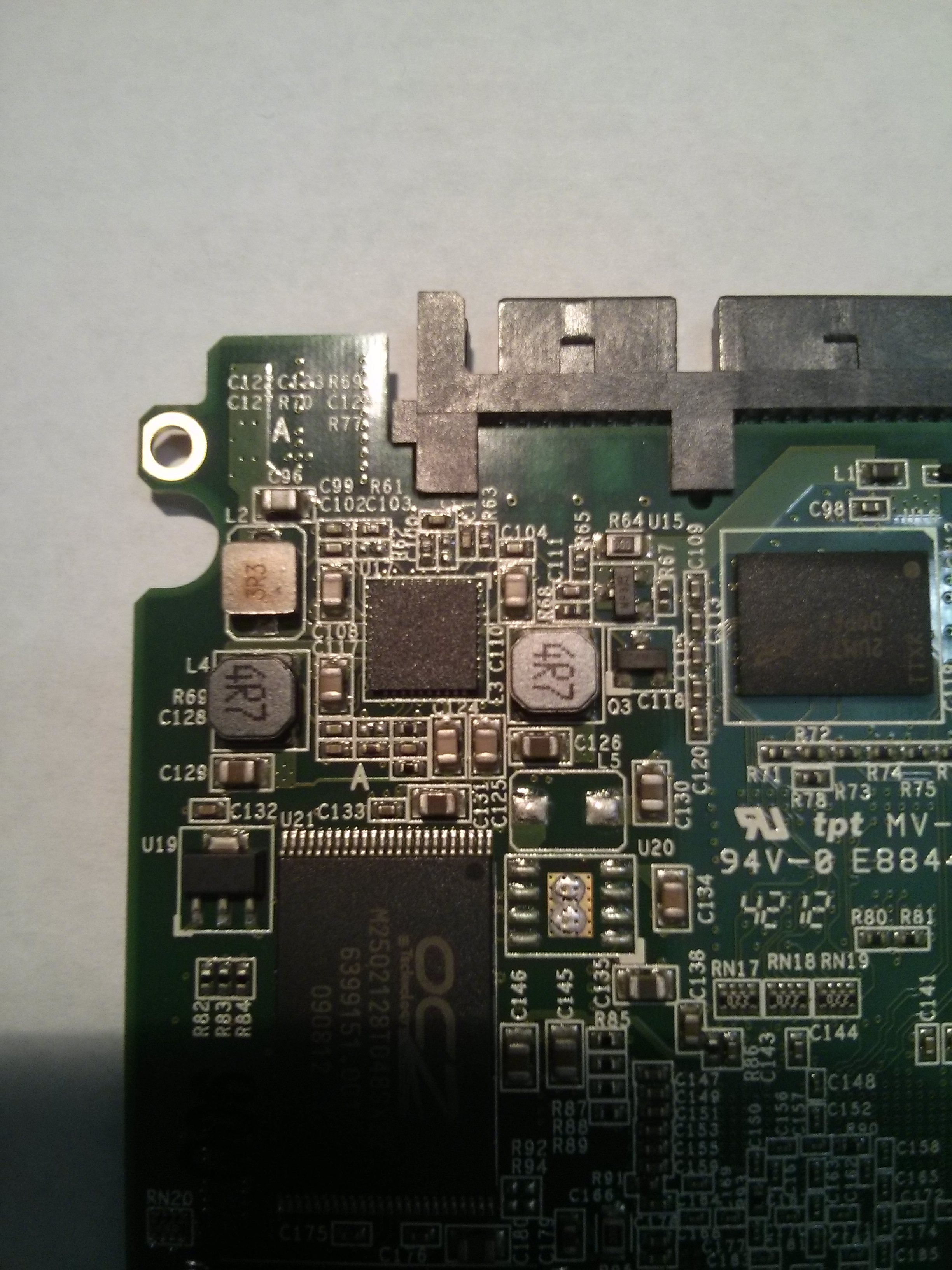

The power supplies are located at the bottom left corner of "VertexBack.jpg". Given that you are getting the "BAREFOOT3" ID, the voltages are probably OK. In any case your photos are too poor to work with.

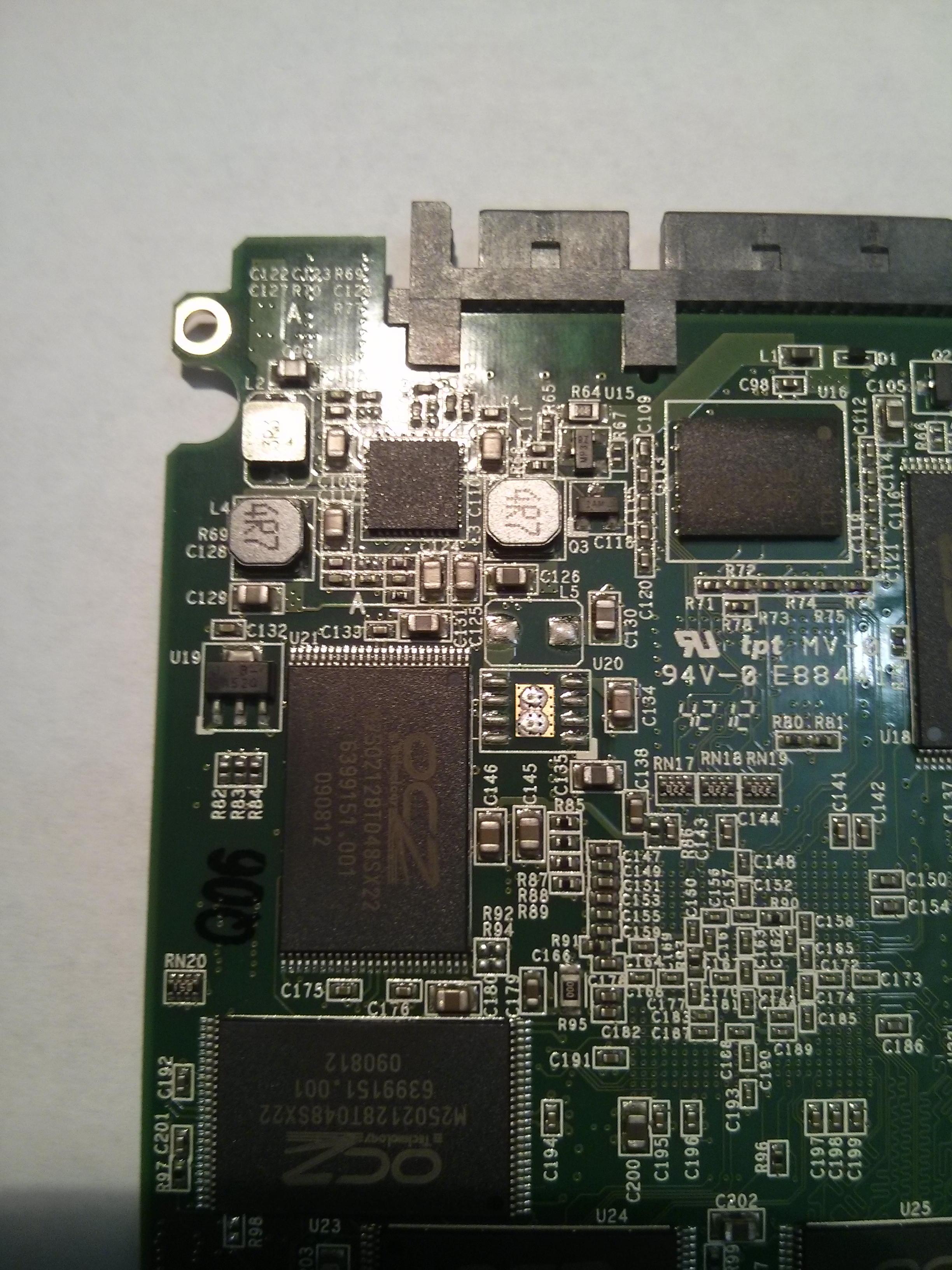

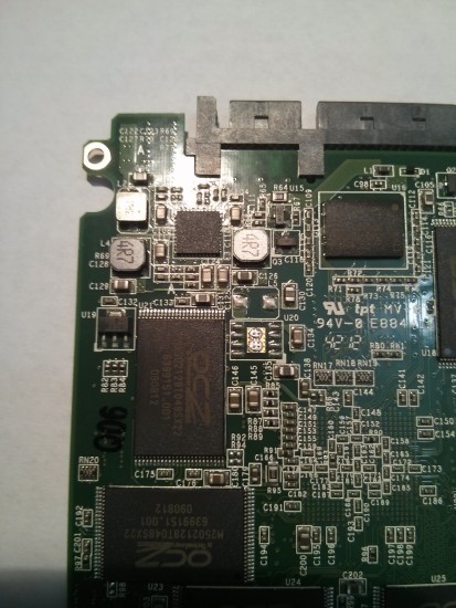

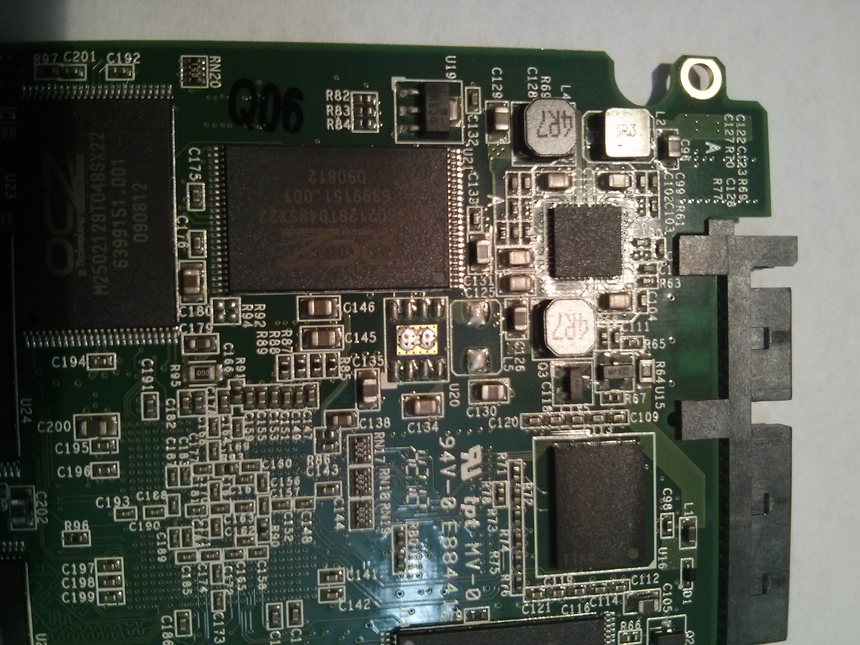

Thank you for your help, sorry about the image quality, here's 3 more attempts at that area. I have managed to acquire a very cheap multimeter for testing.

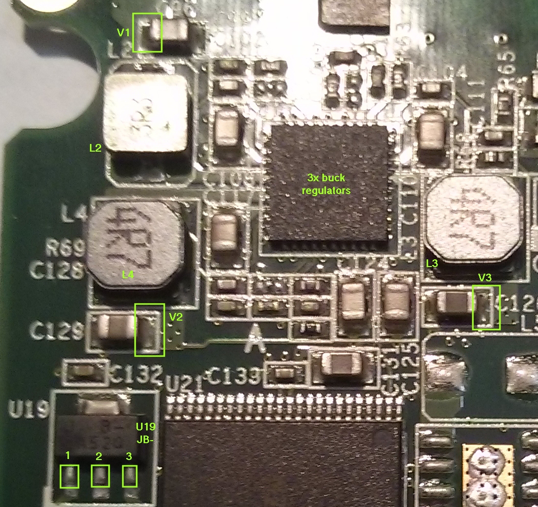

Can you measure voltages V1, V2, V3 and pins 1,2,3 of U19?
Can you confirm whether the marking code on U19 is "JB-"?
Can you provide the markings on the "3x buck regulators" IC?

V1 is 3.010V
V2 is 1.000V
V3 is 1.519V
U19 Pin 1 is 0.000V
U19 Pin 2 is 5.087V
U19 Pin 3 is 2.528V
U19 Marking:
J B-
EA520
3x Buck Regulators IC Marking:
TPS
652510
T1 271G2
AZC6
 Post subject: Re: OCZ Vertex SSD (Indilinx Barefoot 3) not recognized in B
PostPosted: December 13th, 2017, 16:24
Posts: 17323
Those voltages are OK.
