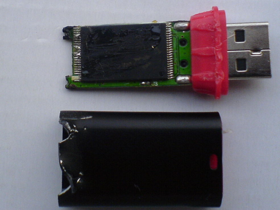

Here is the picture, I re-saved the picture at a lower res. so as not to overload the DL.
Generally before I bother looking at a stick I take a quick couple of pictures, just so there is no dispute later about how the damage occurred.
'apparently' pin 1 is top left away from the USB connector (according to the repairer,actually it is marked bottom right, because the PCB is upside down)
So we have a 'bridge' on the data lines the board was a 'bit' burned top left, bottom left, which was due to 'soldering' brazing or whatever word fits the 'skill' of the repairer.
The case was 'professionally' opened, even though we can see from the red end cap, it is actually a friction fit.
Also the chip appeared to be covered in some sort of 'sticky' paste, maybe glue that had re-melted after having a blow torch on the pins, or perhaps the repairer was just 'very pleased' at his ability to solder an I.C and popped his load.
Any pros wanting to re-produce this, apparently you clamp a nail across the pins, then heat the end of the nail. (hence the carbonized PCB at the top) I would really like to see this guy repairing SMT components. :shock:

Nice job. Glad everyone does not work like this. :mrgreen: Thanks for showing the photos on this one. Sorry for your client though.

This is what I noticed usually happens when 'average joe' is adviced that is simple and diy-able, they go to the nearest Hw shop, and... Voila ! ...

I have seen worse (imagine that same person fixing a laptop motherboard) -
and whats is up with the spunk on the chip? . lol :D :D
SMD's are so fragile. Did you manage to fix it?

The issue I have when getting this sort of work is: can I be bothered, usually this sort of stuff is via a recommendation from someone who wants a favour for a friend.
Generally my work is specialist rather than main stream - 'suspect'- smashed drive ,you will not believe the number of criminals that think dropping a flash drive in a liquid destroys it.(my favorite type of case)
Physical damage is usually easy, as long as the Nand-Flash is not cracked.
I have systems for recovery of devices with all the pins broken off, don't even need to solder connections back, same with the "BGA" type packages with the damned connections underneath, generally I don't like "pogo pins" they excessively stress the IC, and you have the issue of 'not' tampering with evidence.
worst case is an etch down of the package and a re-bond, but even that is not as hard as it used to be.
