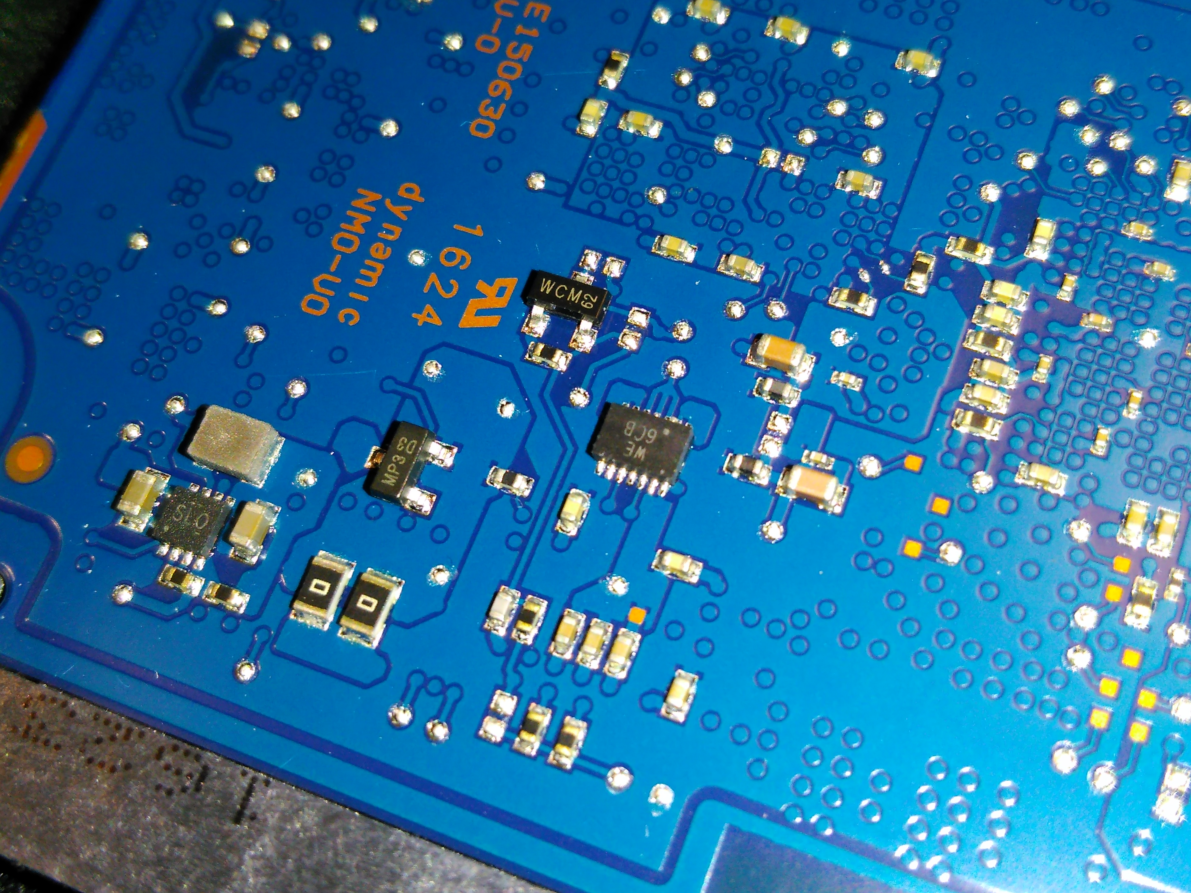

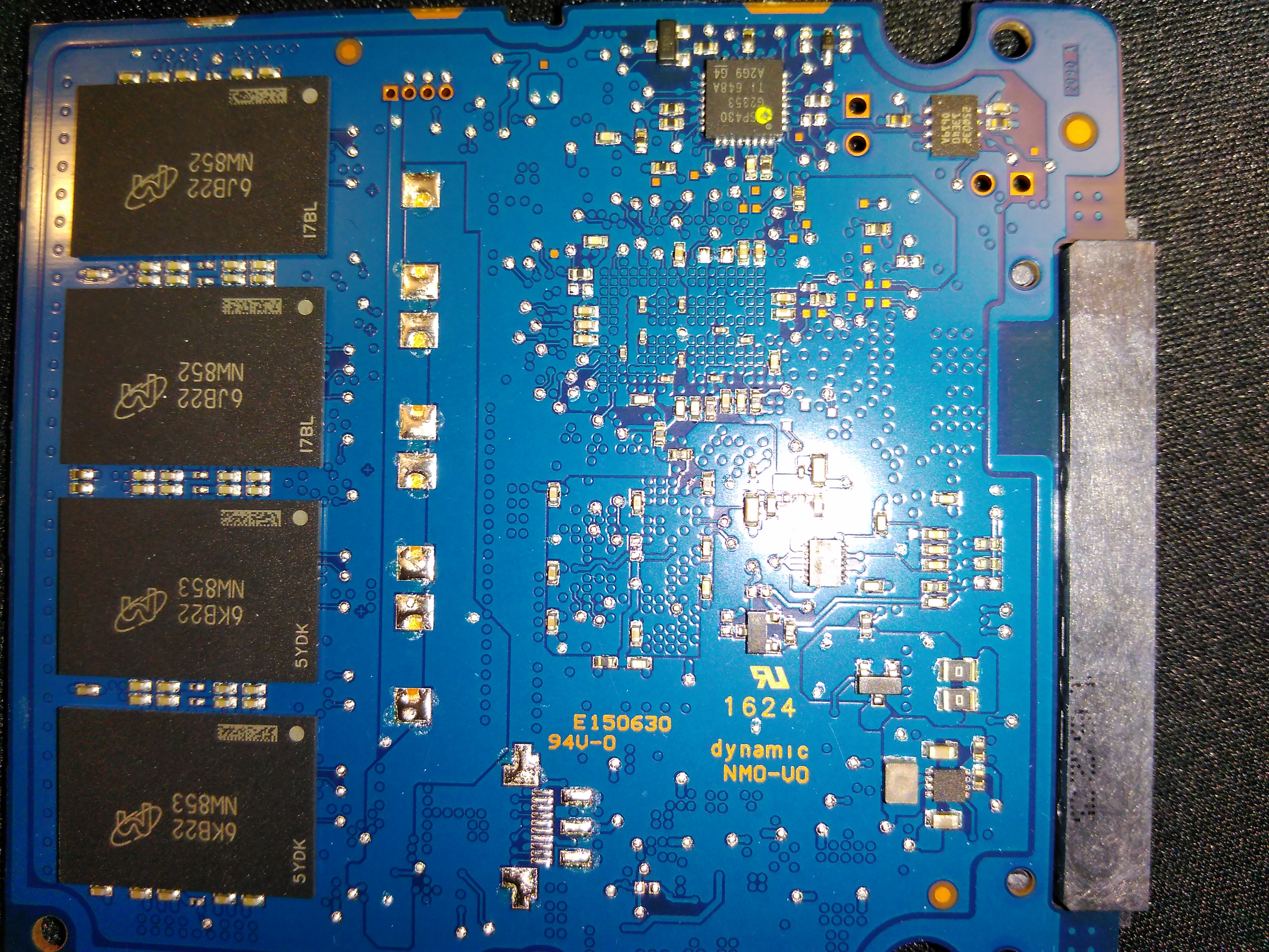

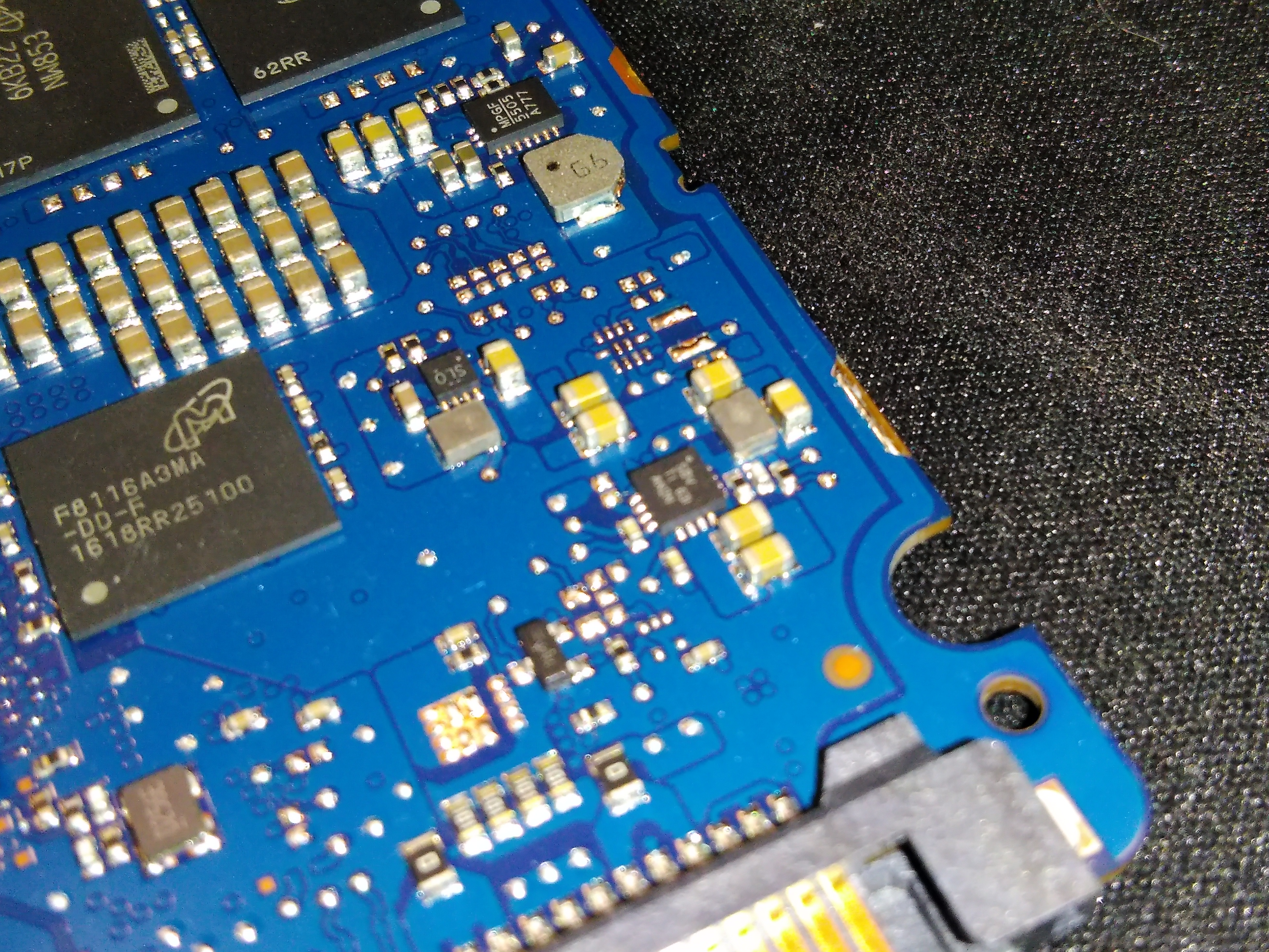

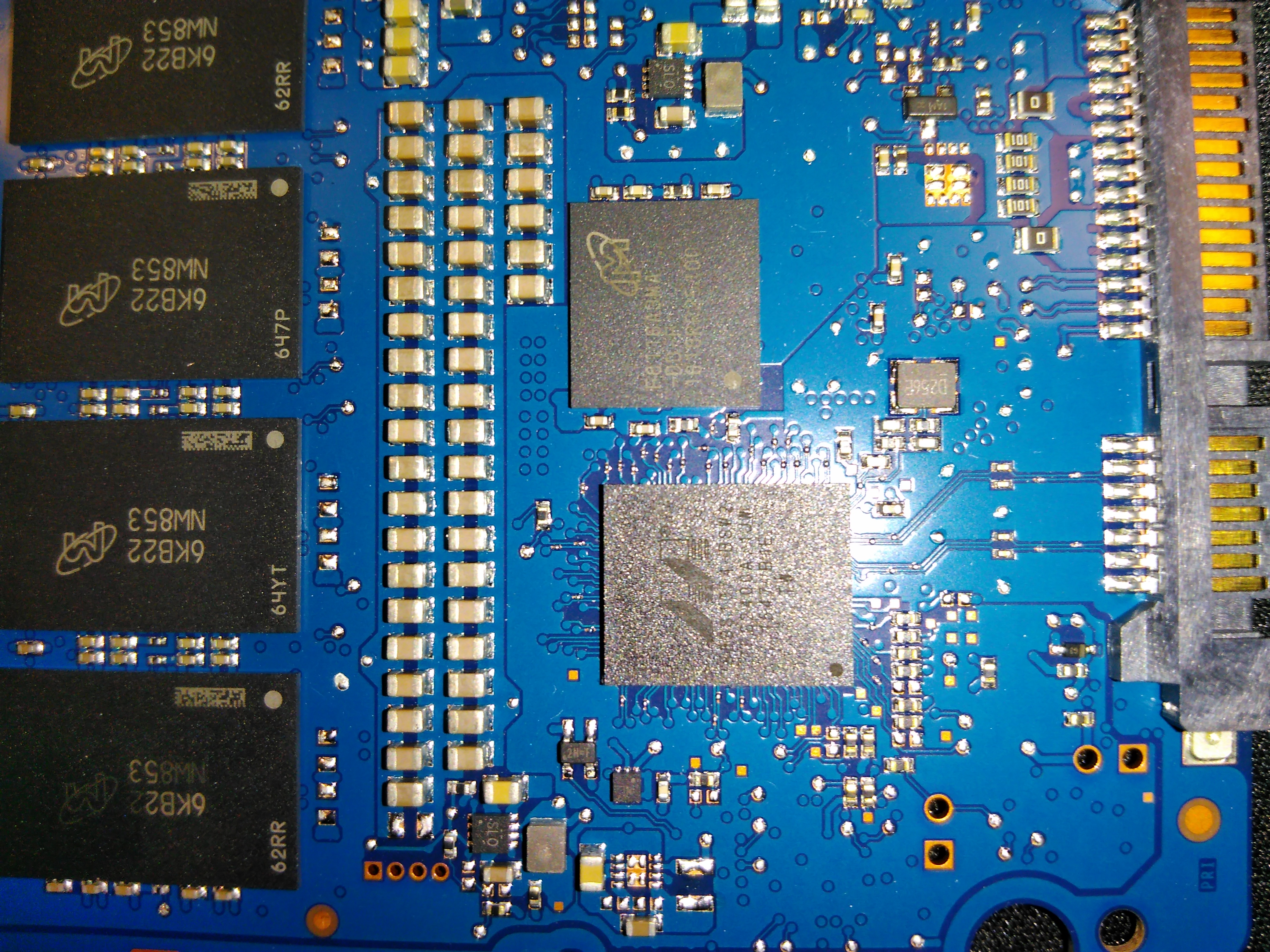

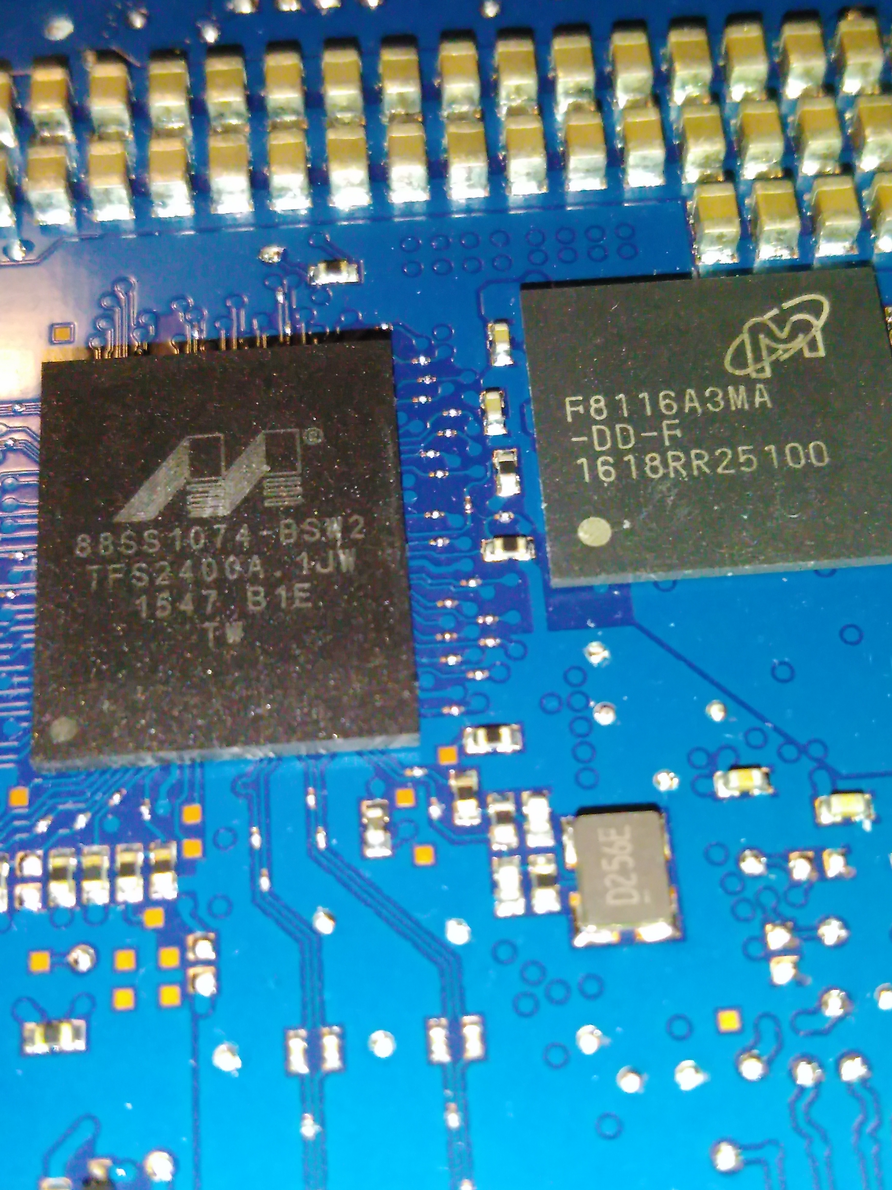

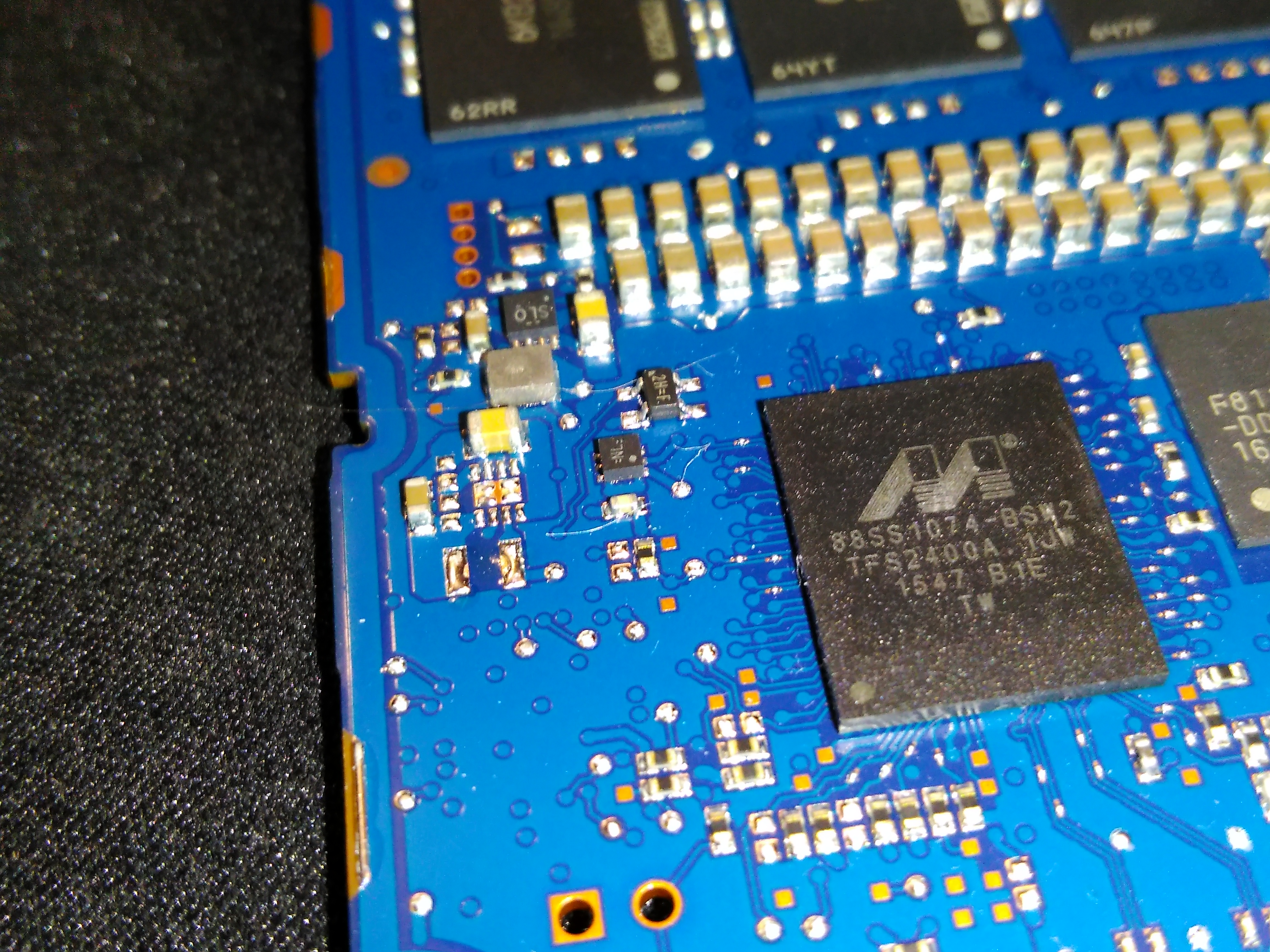

Attached are images. You'll see the available test points aren't really similar to the crucial boards shown online. I have a smaller MX that is also unlabeled. It works but has a different layout entirely.
IR images were not instructive. It heated up exactly where I expected, so I didn't include them.
Headers visible on back of the board. I'll get poking at them tomorrow.
File comment: Closeup of remaining chips on back
File comment: Closeup chips right of both controllers
File comment: Closeup chips up, left of Marvell controller
File comment: Closeup main controllers

File comment: Back of the board

I hope I have identified these ICs correctly:
TLV62084, Texas Instruments, marking SLO, 2A High Efficient Step Down Converter, 2x2mm WSON, 8-pin, 2.7 - 6V Input:
http://www.ti.com/lit/gpn/TLV62080
TLV70028, Texas Instruments, marking NL, 2.8V, 200mA, Low IQ, LDO Regulator, WSON, 6-pin:
http://www.ti.com/lit/ds/symlink/tlv700.pdf
MP5505, Monolithic Power Systems, 7V, 4A, High-Efficiency Energy Storage & Management Unit, 2.7V-to-7V in, marking 5505, QFN20L:
https://www.monolithicpower.com/Desktop ... nt?id=2477
MSP430, Texas Instruments, 16-Bit Ultra-Low-Power Microcontroller, 32-pin QFP:
http://www.ti.com/lit/ds/symlink/msp430f1122.pdf (not identical chip)
N25Q032A, Micron, 32Mbit, SPI serial flash memory, 8-pin, 2.7 - 3.6V, quad IO:
https://www.micron.com/~/media/document ... v_65nm.pdf
The 4-pin IC marked "2H=F" is probably a Richtek device. I suspect it may be a power supply supervisor.
The MX100 SSD in the following thread sustained a failure of the MSP430 IC. The OP provided much useful feedback.
viewtopic.php?f=10&t=33908
I would start by measuring the voltages at the inductors at the outputs of each of the buck regulators. Then check the LDO output and the voltage on the backup capacitor array.
