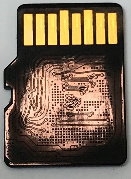

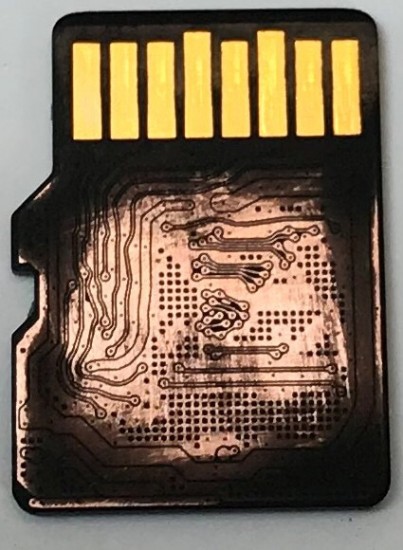

It’s a fake 128gb from ebay (shock!!) that’s almost certainly an 8gb card (from what I can make out from the P/N)..

We have this one almost done, I think will finalize on next week.

It’s not my card, we are a data Recovery company and just trying to recover some data off this poor guys failed fake card.
But I know what you mean, these ebay crooks are scum. But no matter how many times we report them (and also other crooks selling fake usb hard drives) ebay are simply not interested. They are just happy to take their fees from crooks selling fake products.

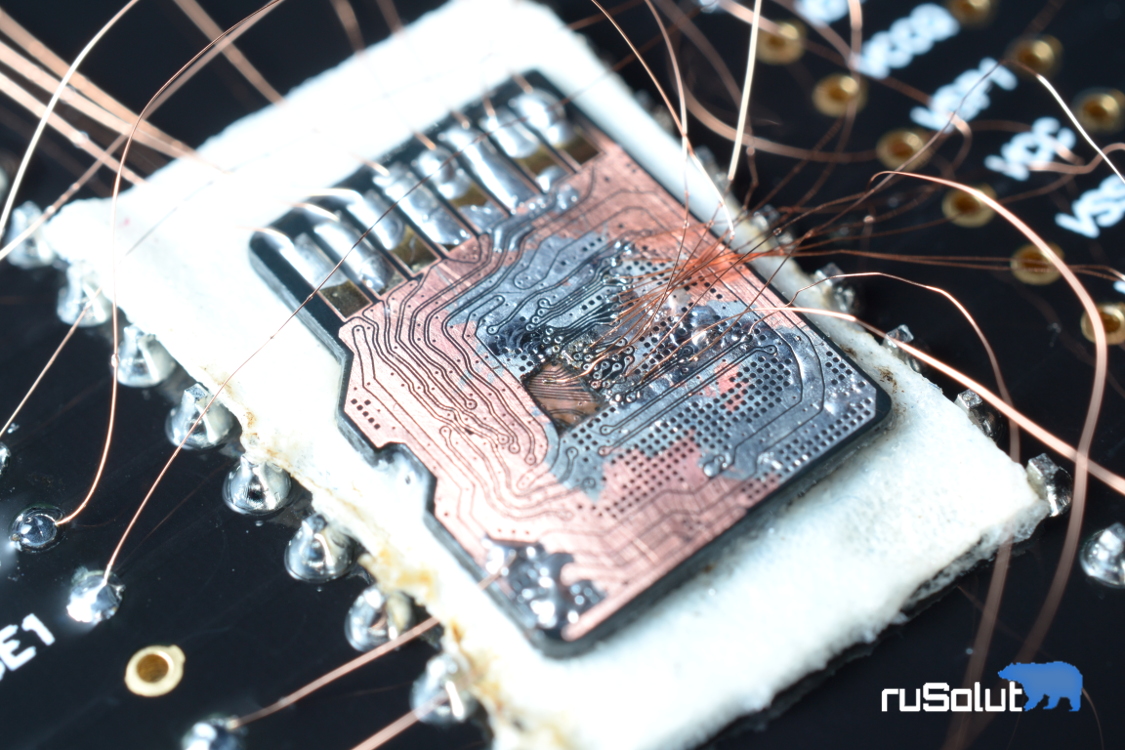

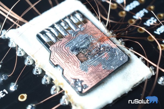

You are right about capacity of this card. In our case it is has marking as 32 GB but inside is 8 GB chip.
Drop message to our support about pin-out.
PS. I hope you like soldering.
