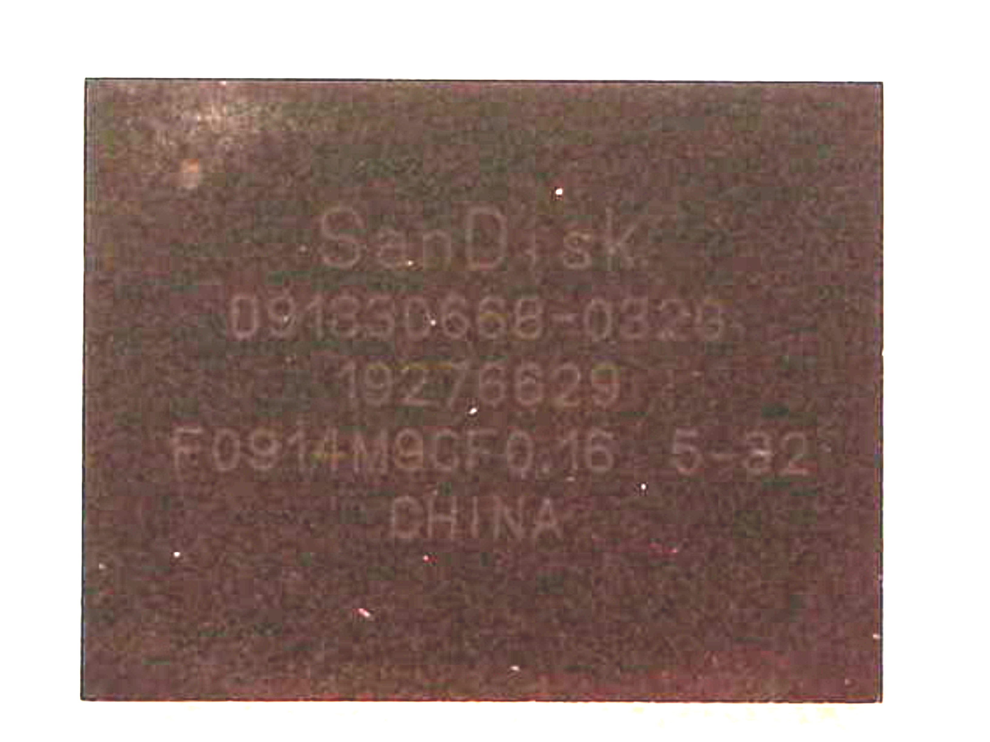

Hello guys,,
anyone knows the datasheet for this Sandisk?
i was searching and seems cannot find it
thank you

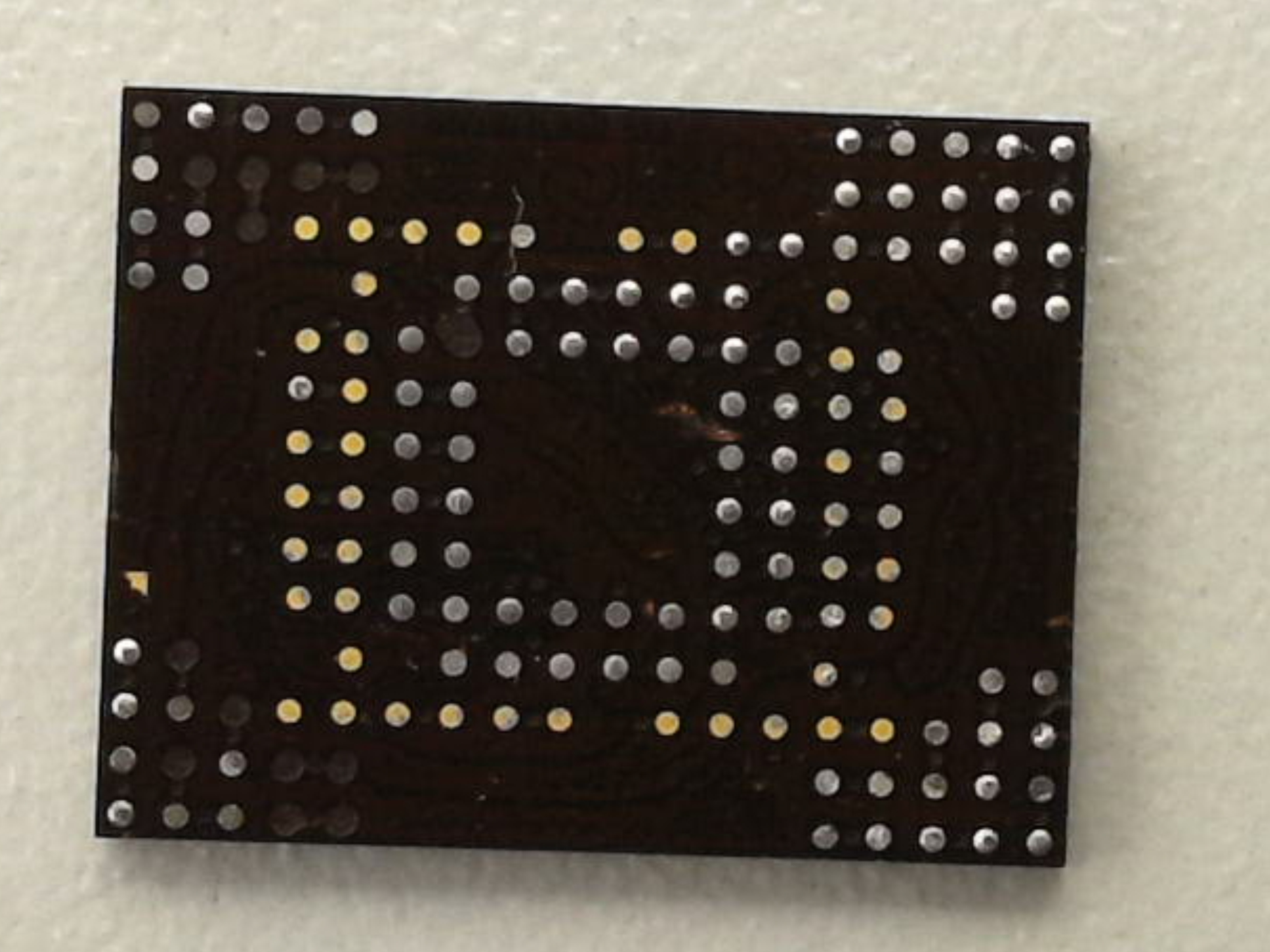

You won't find datasheet very likely, we figured out pinout long time ago using XRAY.
This is BGA-154 chip, in VNR starter kit you can find special adapter but you'll need to reball the chip (this one is easy).
If you have problem with NAND config drop me message
 Post subject: Re: Sandisk datasheet
PostPosted: March 6th, 2018, 6:04
Joined: July 2nd, 2014, 8:05
Posts: 215
Just found a picture of device, it was reballed.

Its rare chip, quite often need read as 16-8bit.
