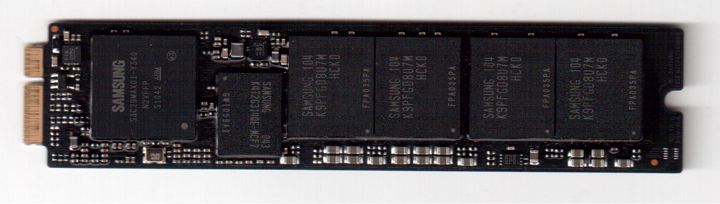

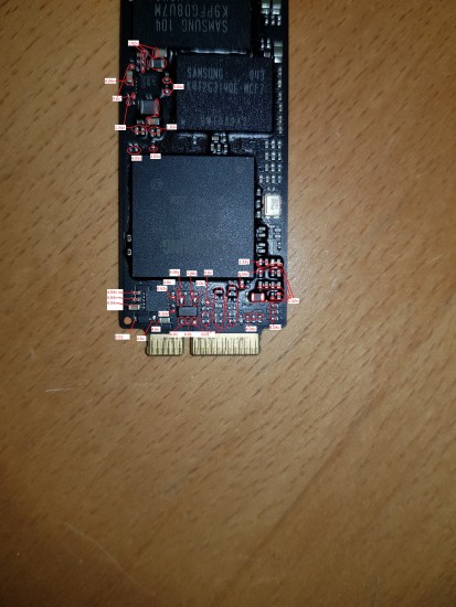

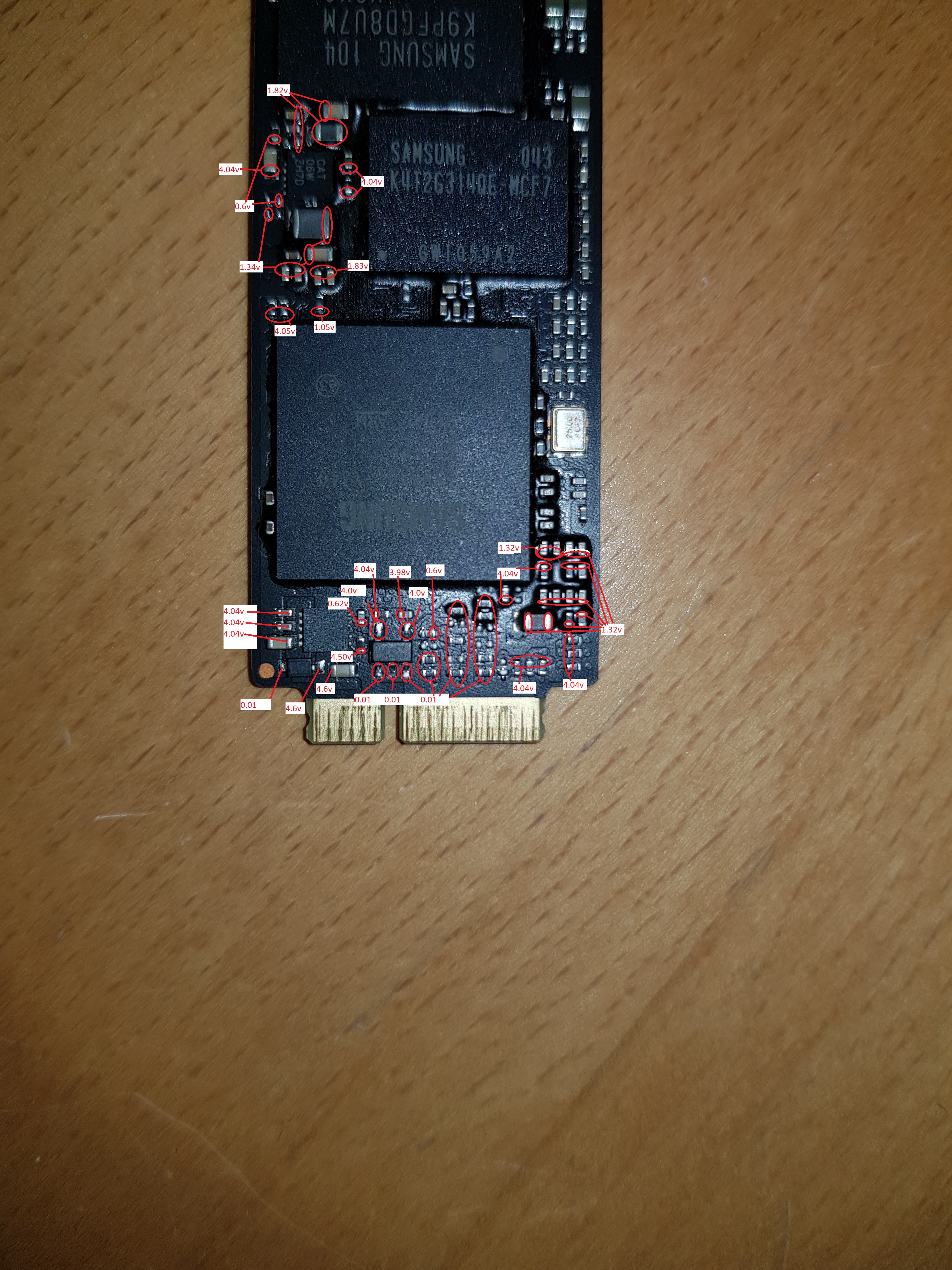

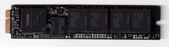

Hi guys, got this one in...when put into adapter nothing happens and adapter is not recognized by system, adapter alone is recognized...so some kind of short is it.
I have a good drive to cross-check with and all power measure looks ok, in the picture the voltage is the same on both working and non working drive.
The chip close to connector is:
7MAE
913
The other half way up is:
CAT
06W
ZH7D
Thanks for looking

Why are you powering a 3.3V SSD from a 5V adapter?
MP5003EQ, Monolithic Power, 3.3V, 1A-3A Programmable Current Limit Switch with Auto Enable, QFN10, marking 7M:
https://www.monolithicpower.com/DesktopModules/DocumentManage/API/Document/GetDocument?id=1407
TPS62410, Texas Instruments, 2.25MHZ 2x800mA Dual Step-Down Converter with 1-Wire Interface, Vin = 2.5V - 6V, QFN10, marking CAT:
http://www.ti.com/lit/gpn/tps62410

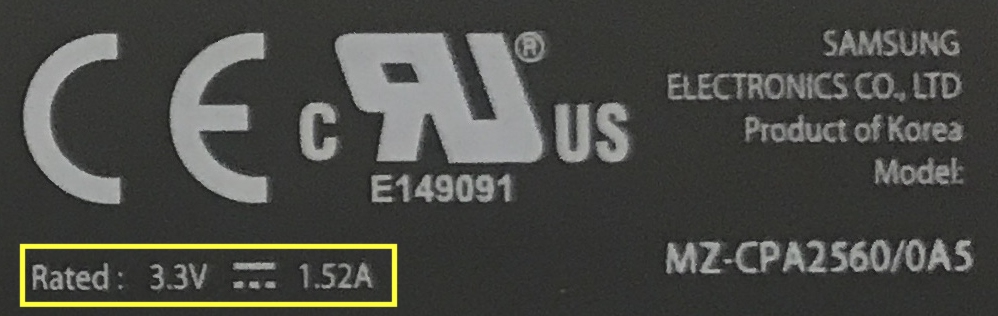

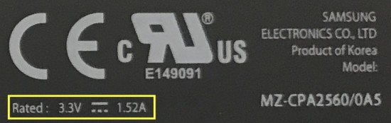

No, it isn't "proper". Please STOP using it. The correct adapter would supply 3.3V via its own 3.3V LDO regulator. Your adapter is supplying 4.60V. That in itself says something about your "+5V" supply.
Please read the label of your client's SSD.
The only reason that your SSD is working with this adapter is that the MP5003EQ IC is protecting your client's data by limiting the output voltage to 4.04V. In doing so it is dissipating approximately 0.5W when it should be dissipating nothing.

For the frustration I went into the office today and checked the ssd with another adapter...and the incoming power on the ssd was 3.29v...so no problem there.
There is no power problem on that ssd, "only" firmware corruption.
Thanks for looking

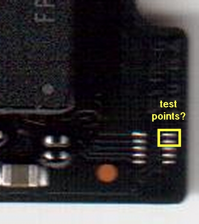

In another thread (?) someone posted the following "test points". Could they be shorting points for safe mode?
 Post subject: Re: Apple mz-cpa2560 ssd
PostPosted: March 4th, 2018, 19:05
Joined: May 21st, 2007, 16:10
Posts: 1592
Location: Gothenburg/ Sweden
Yes they are.

I've recovered this model with PC3K, but getting to safe mode is trickier than one would want.

Firmware fixed, and drive now cloning.
