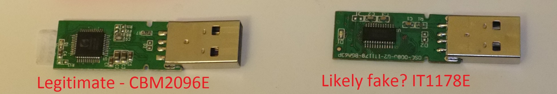

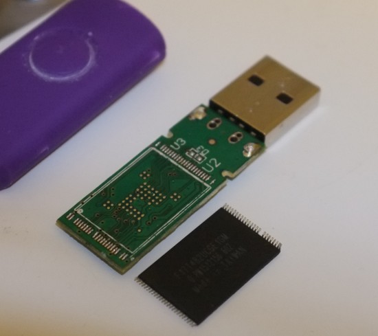

Hi all,
I have what I suspect to be a counterfeit / fake memory stick in. I wondered if anyone else could confirm? Memory stick has failed, so chip removal was required. However, I still cannot get the NAND to ID to confirm the capacity. It's quite possible that the NAND has failed, but I'm currently waiting for Ace TS to login and take a look just in case I have missed something.
The owner reports it as a 8GB memory stick. She also provided a second matching working 8GB memory stick purchased at her university, with the matching university branding. Under the plastic casing they are quite different.
The likely fake has a rectangular processor. I have only ever seen these before on fake memory sticks (eBay purchases etc, with 512Gb capacity for £15 etc) . It has ITE numbering, but for a processor number that does not exist (at least on Soft Center and PC3000 library) - IT1178E.
Moreover, the marking on the NAND chip on the underside of the chip is:
F17T482UCGE1GM
0 PW1512156 602
Made in TAIWAN
I cannot find any specification on this chip, but I'm taking a bet that in this case the '1G' at the end is indicating in this case that it is a 1GB NAND.

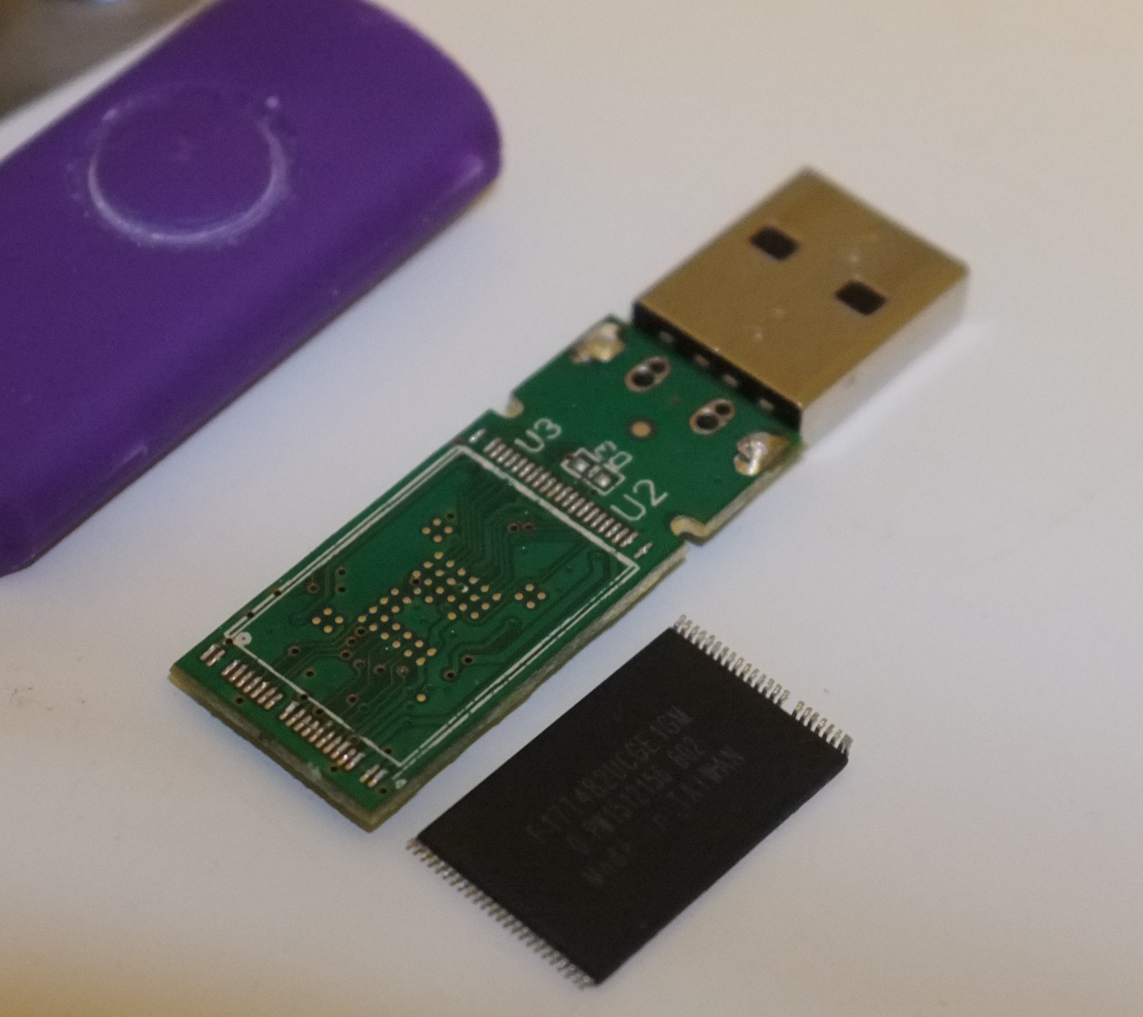

Thanks for the responses so far. Correct - there is a pin missing. This was the case before the NAND removal and the owner had not tampered with the memory stick ahead of delivery. The combination of all the factors (processor shape / number, marking on Nand, and missing pin) all add to my suspicions on this job.
When first received and the Nand was still attached to the PCB it would give an ID in Windows Device Manager as "NAND USB2DISK USB Device". With the Nand removed and the memory stick plugged in it gives the same ID in Windows and symptoms of failure.

Hold on...
I must admit it's very hard to work with NAND chips with broken CLE pin.
CLE stands for Command Latch Enable and it forces databus of memory to "listen" the commands.
You send a command "READ ID" and chip just ignores you.
I mean chip has no idea that you send a command in case when CLE is not connected.
From the picture I can assume with 90% probability this chip has a standard TSOP48 pinout, no playing around is required.
You just need to fix a pin and solder it to VNR Monolith adapter, there's a secret area at the center (just keep this between us, I'm sure most of users have no idea how to use it;)) where you can solder TSOP48 chips with broken pins.
It won't be too easy to fix the pin but possible, probably work for 30 min (or 10 min for guys like Arvika, Jeremy and others).

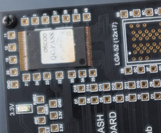

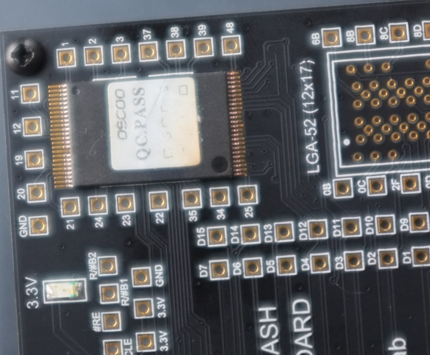

Looks like you are correct, it is pin 16 which is missing, so CLE on standard layouts. I've lined it up on an adapter for viewing.
Note that this particular adapter looks box fresh ;)
Truth be known is that the prospect of soldering on the additional pin in the centre of the chip is not one I relish. I've only ever done it on the outside pins (usually when there has been accidental physical damage to SD cards) and there is a bit more room to manoeuvre.
Ace TS have confirmed that model of processor referenced on this stick is not supported by PC3000 which has a dynamic XOR so RAW is not possible either. If I can get a dump then happy to share. My suspicion though is that once the dump is obtained then this is going to be a 1GB chip on a faked 8GB processor which will then bring some other significant challenges with it.

OK, after some fiddling getting a connection to pin 16 I've got ID :)
Chip ID= 0xADDE14A7
Currently reading as a 8GB NAND with single part. I'm looking forward to seeing what is actually in this dump. Perhaps this is not a fake, but maybe as Michal's and this is refurbished.

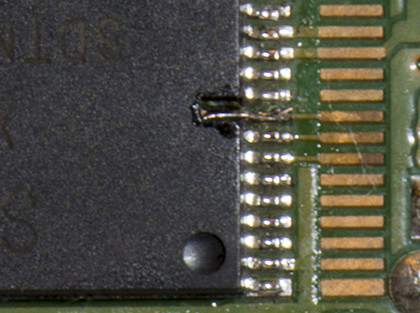

It was easier to leave it attached to the PCB in my case ;-) :D :D :D :D
Recover My Flash Drive
 Post subject: Re: Counterfeit / fake memory stick identification - IT1178E
PostPosted: November 9th, 2016, 20:27
Posts: 1777
Location: Phoenix, AZ USA
What do you use to cut through the chip surface?

ddrecovery wrote:
I thought you were IPC certified :D :D :D
How I cut through the surface does not matter, only that the surface no longer exists... Besides, that's an awesome solder job, put some black overcoat on it and that shit looks factory, ready for sale in Shenzhen.

On this one there was still some metal contact left on the NAND and I was able to bridge the broken pin and the contact on the chip reader to get a connection without re-soldering. Sean is taking a look at the dump at the moment, I can't detect the type of XOR used.
