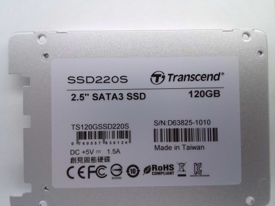

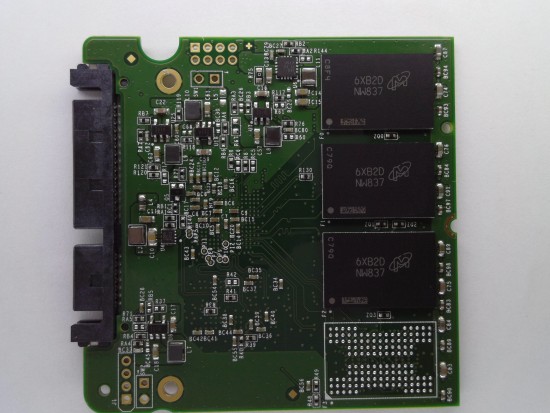

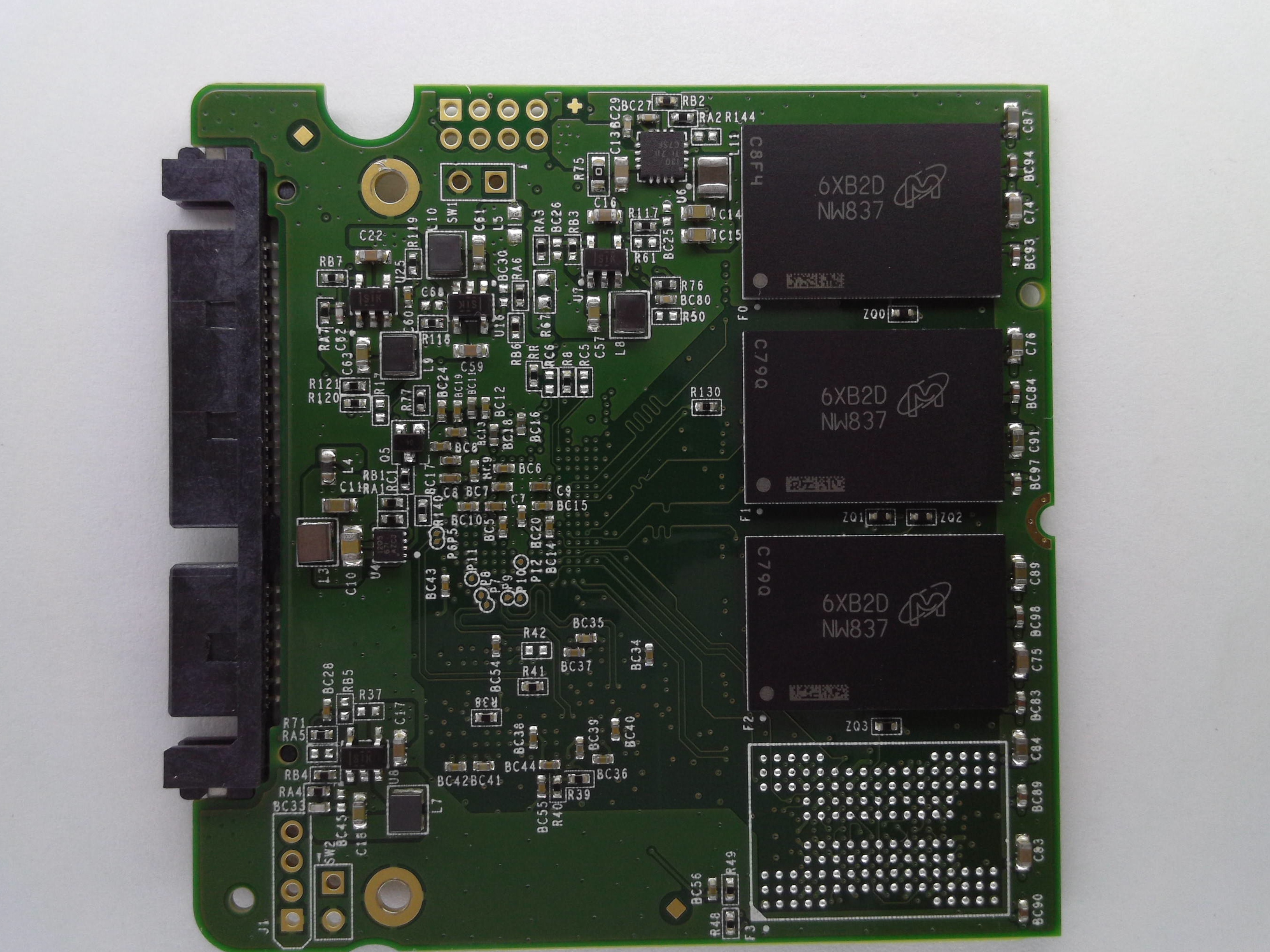

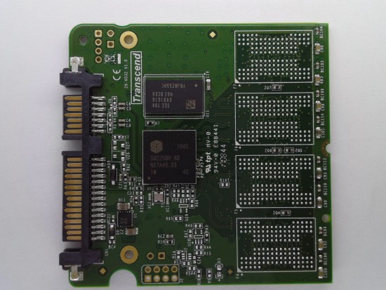

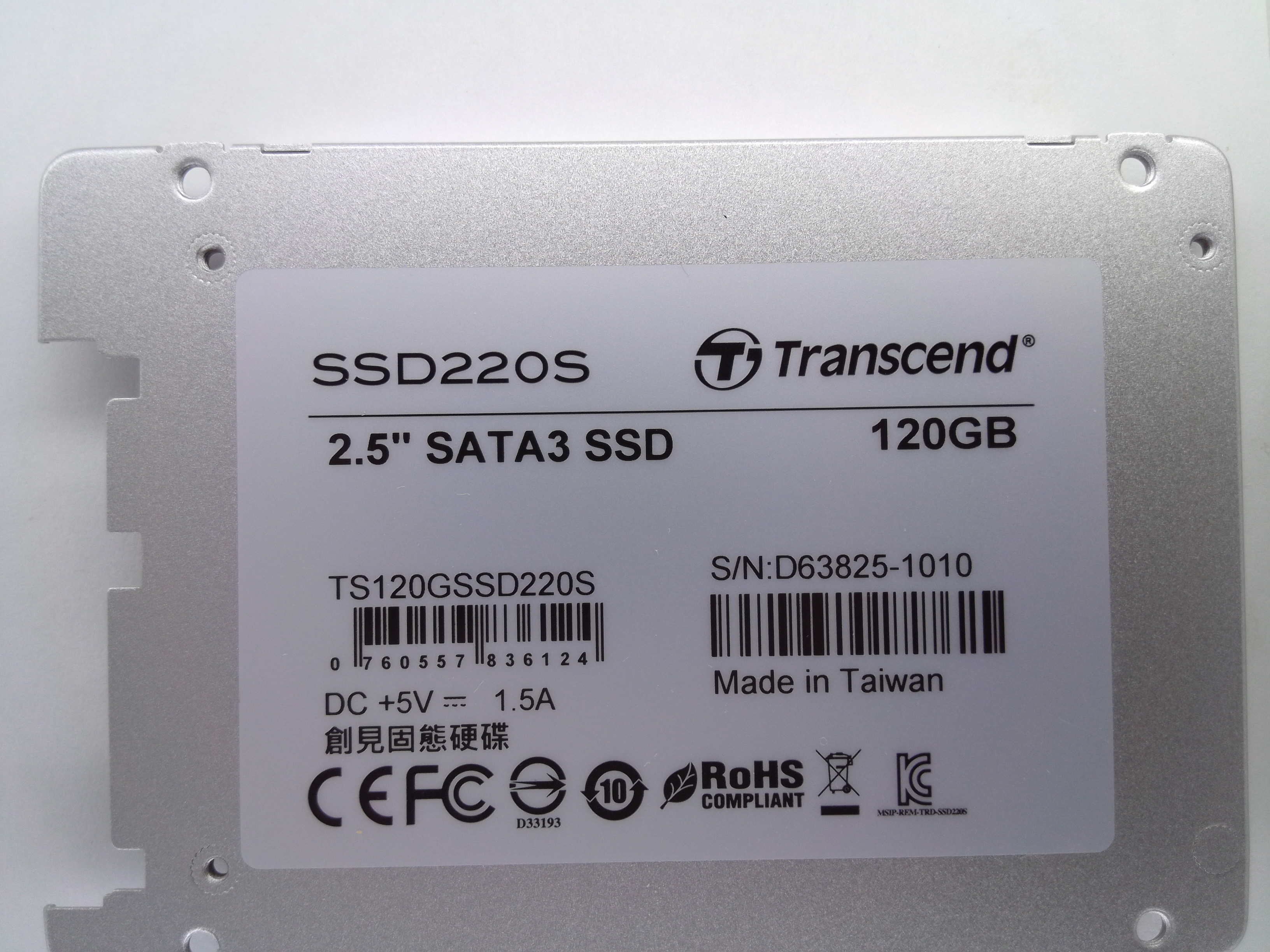

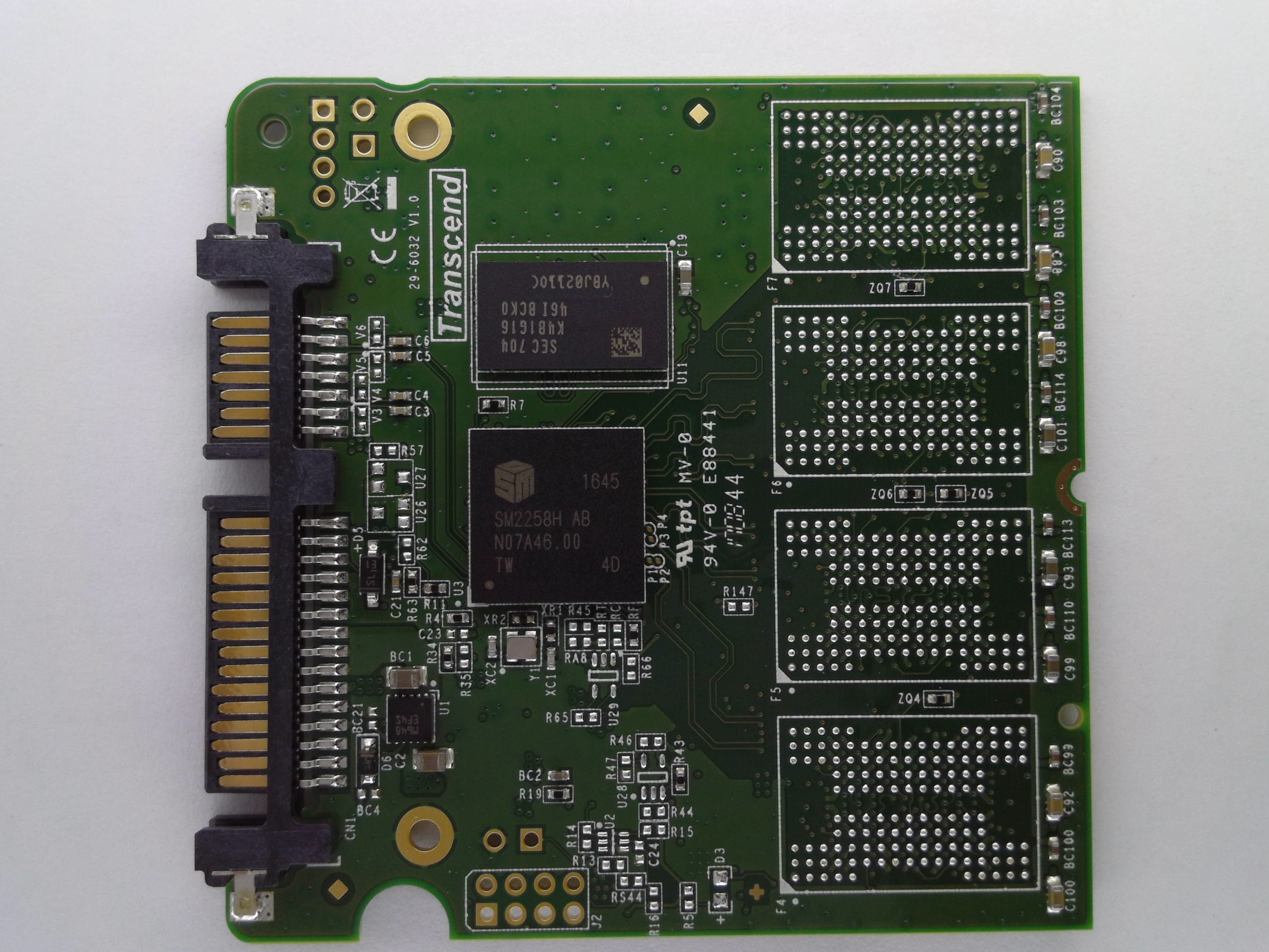

Anything Odd here?
just bought it today :shock:

Micron have some strange sizes.. This chip is 384Gb (48G x 8) Quite odd (pun intended) though to what we are used to!

This is new SSD i bought and i opened it to see the internal controller for my ref.

some of these new SM controllers have a strange firmware as well. Some have different XOR for different dumps. Also ECC after XOR. I have about a dozen here to test of different SM varieties
