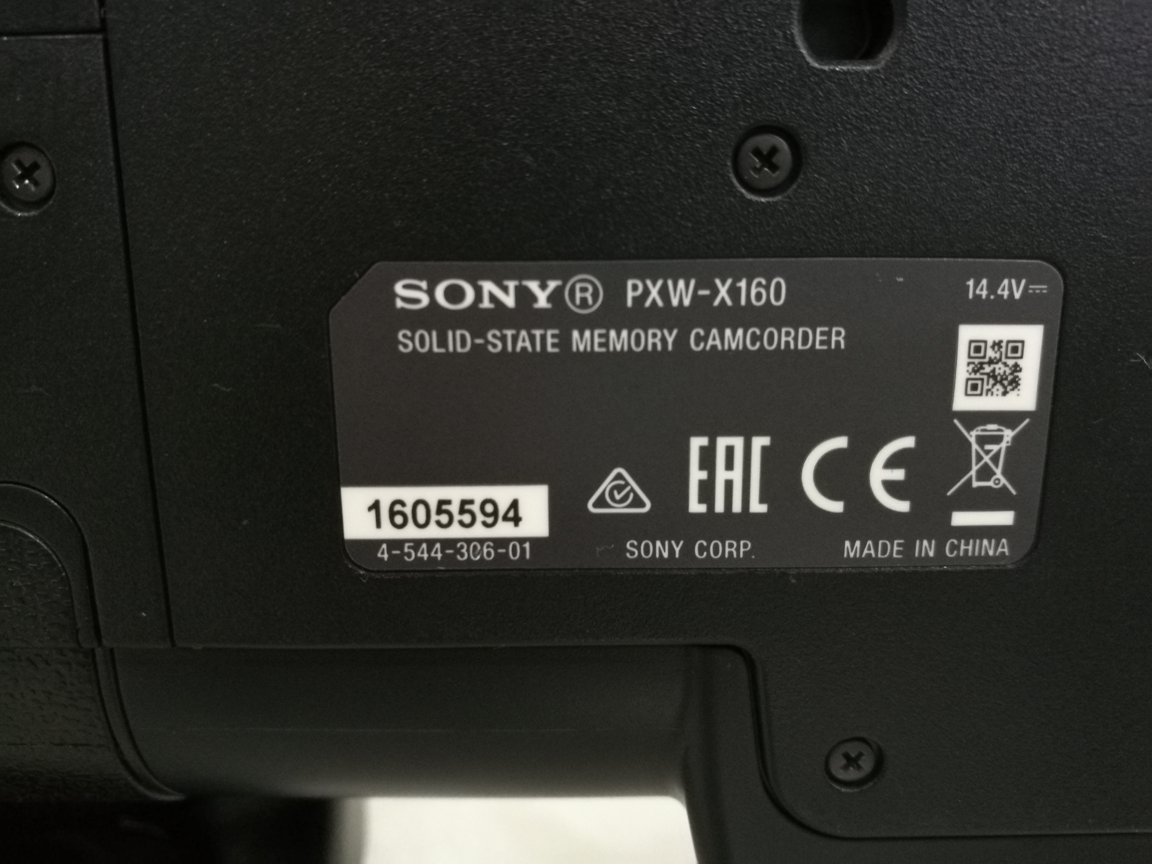

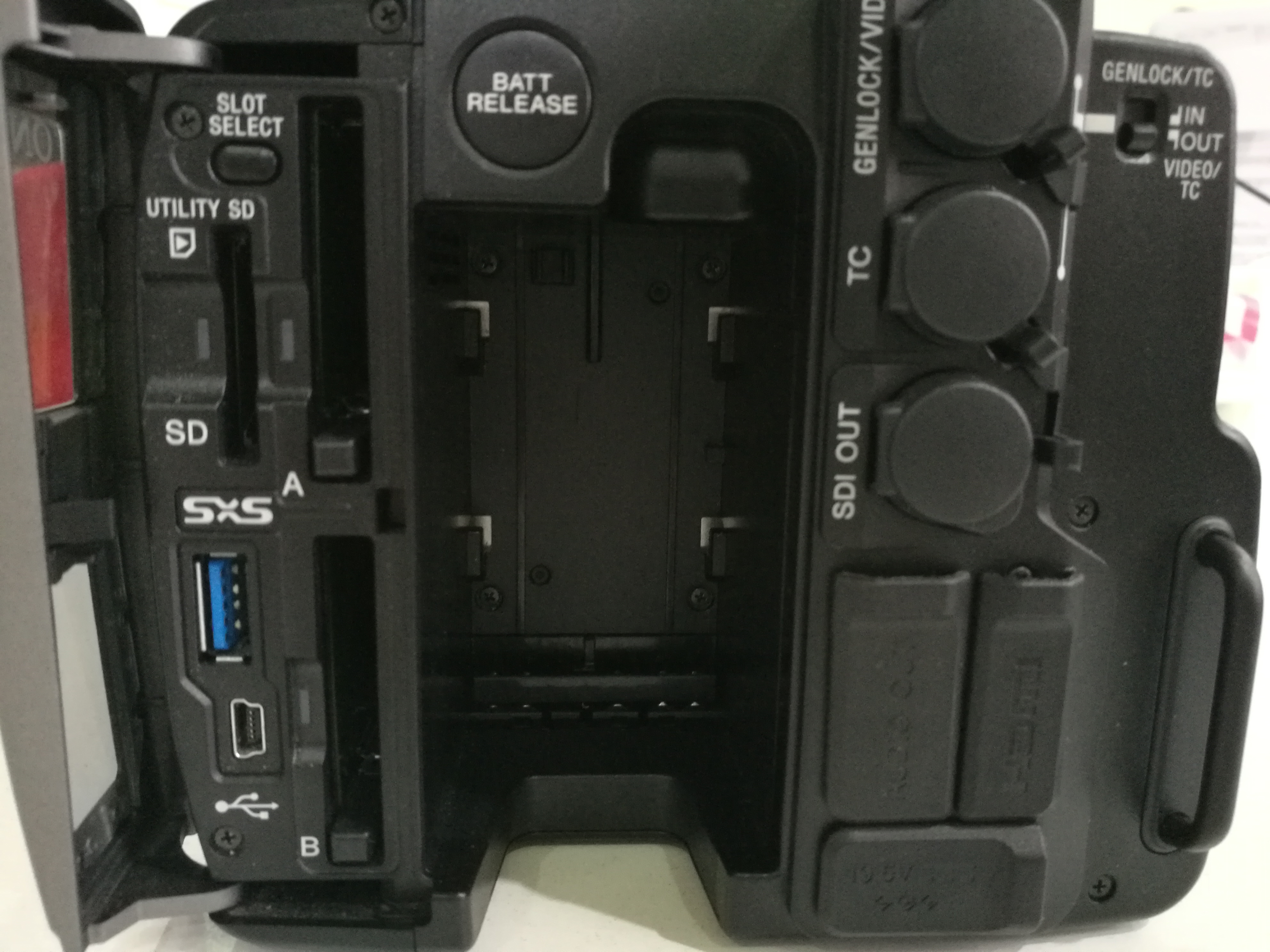

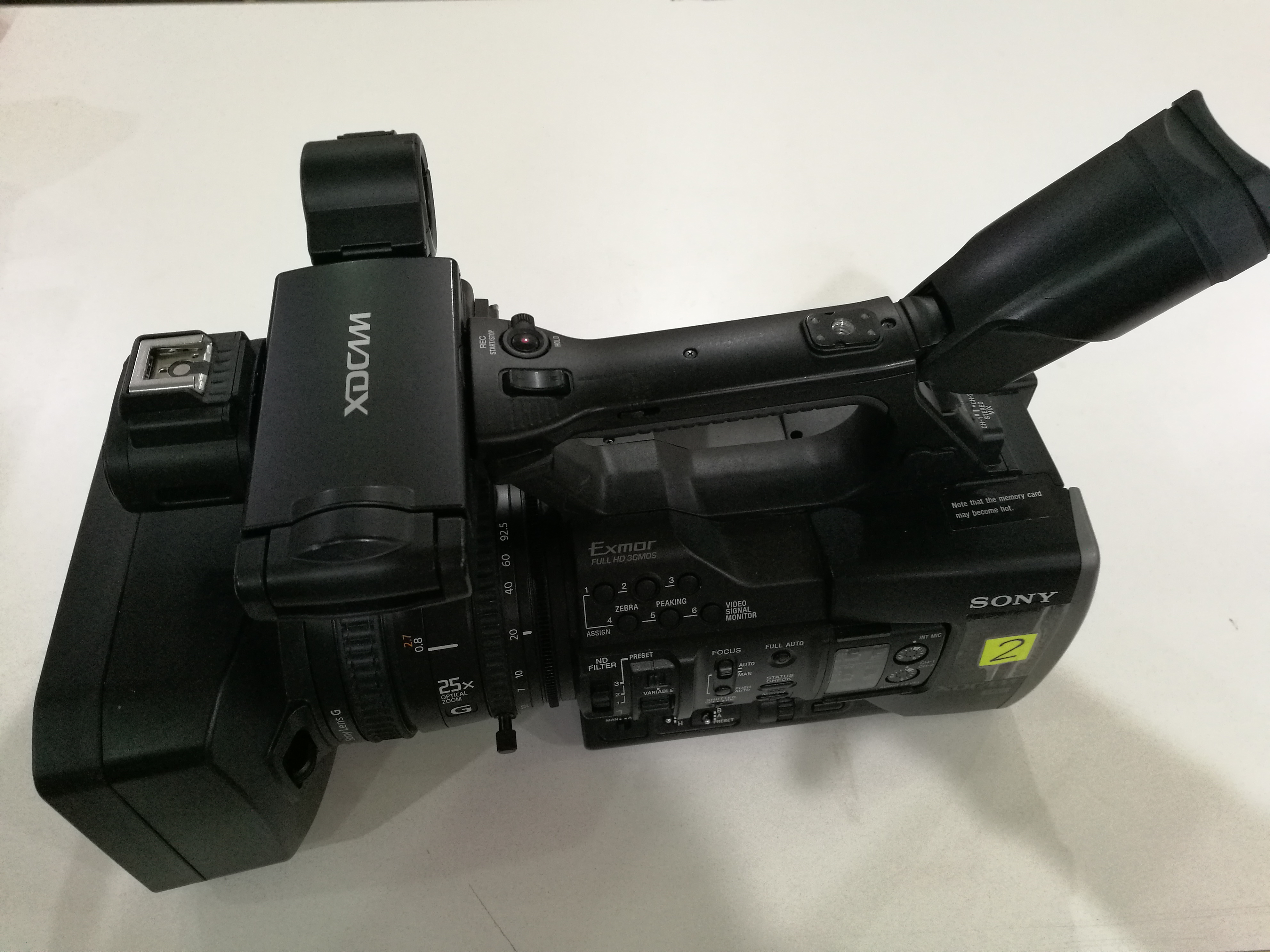

As an update here, in Winhex it shows the disk is part of RAID0 (64gb x2)
but It is not.
Never trust the client <------ Rule #1 in DR
I got the camera and installed 2 SxS memories inside, and found that There is NO RAID0 option
not even inside the Manual.
When you install 2 memories and start recording it fills Mem-A when almost full will send you an notification then it switches to Mem-B (if both fixed) otherwise will stop @ the end.
Now based on those facts, can someone Guess what really happened here? (I got it figured here)
i really don`t like it sometimes when someone tells you a story.
I`ll put it this way:
Patient visits a Doctor and sits not saying anything, and when the Doctor Asks Whats up? Whats Wrong with you?
Patient says: Well, You are the Doctor here, you should tell me what do i have?
Take a Good guess here heheheh :shock:
 Post subject: Re: SxS Memory in RAID0
PostPosted: March 19th, 2018, 9:14
JBOD set up?
PostPosted: March 19th, 2018, 9:41
Posts: 2857
labtech wrote:
JBOD set up?
Its not in RAID (but Winhex reports it some how)
to cut it short here....
client or one of his Employees connected Both SxS memories to kind of reader (both together) and Re-Init. it
re-partition it with ex-fat
The 1st. time the client sent me only ONE memory, when i saw it reporting as 120gb i asked ur Cam supports 2 Memories (thought its Raid-0) <--- then i posted here about it
they said YES, then i asked for the 2nd. memory, when i saw both i found its separate and not in Raid
something else, i asked for the Cam to verify it myself, i fixed 2 memories inside to test, there is NO RAID OPTION (as i explained before on prev. post)
