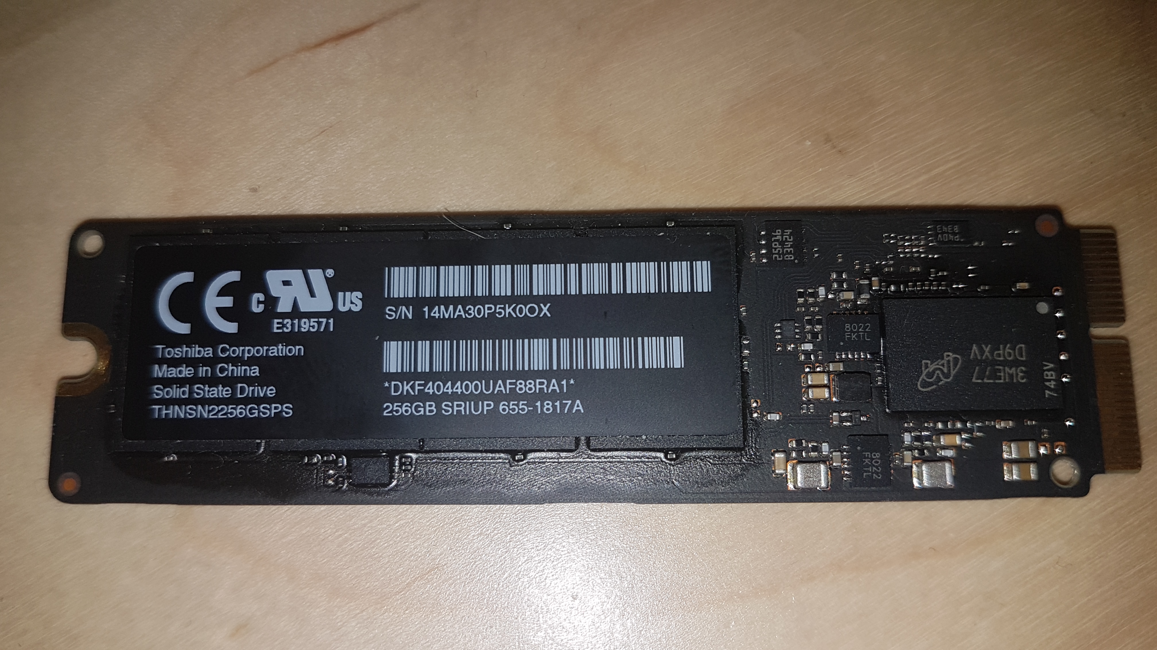

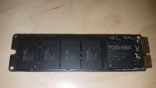

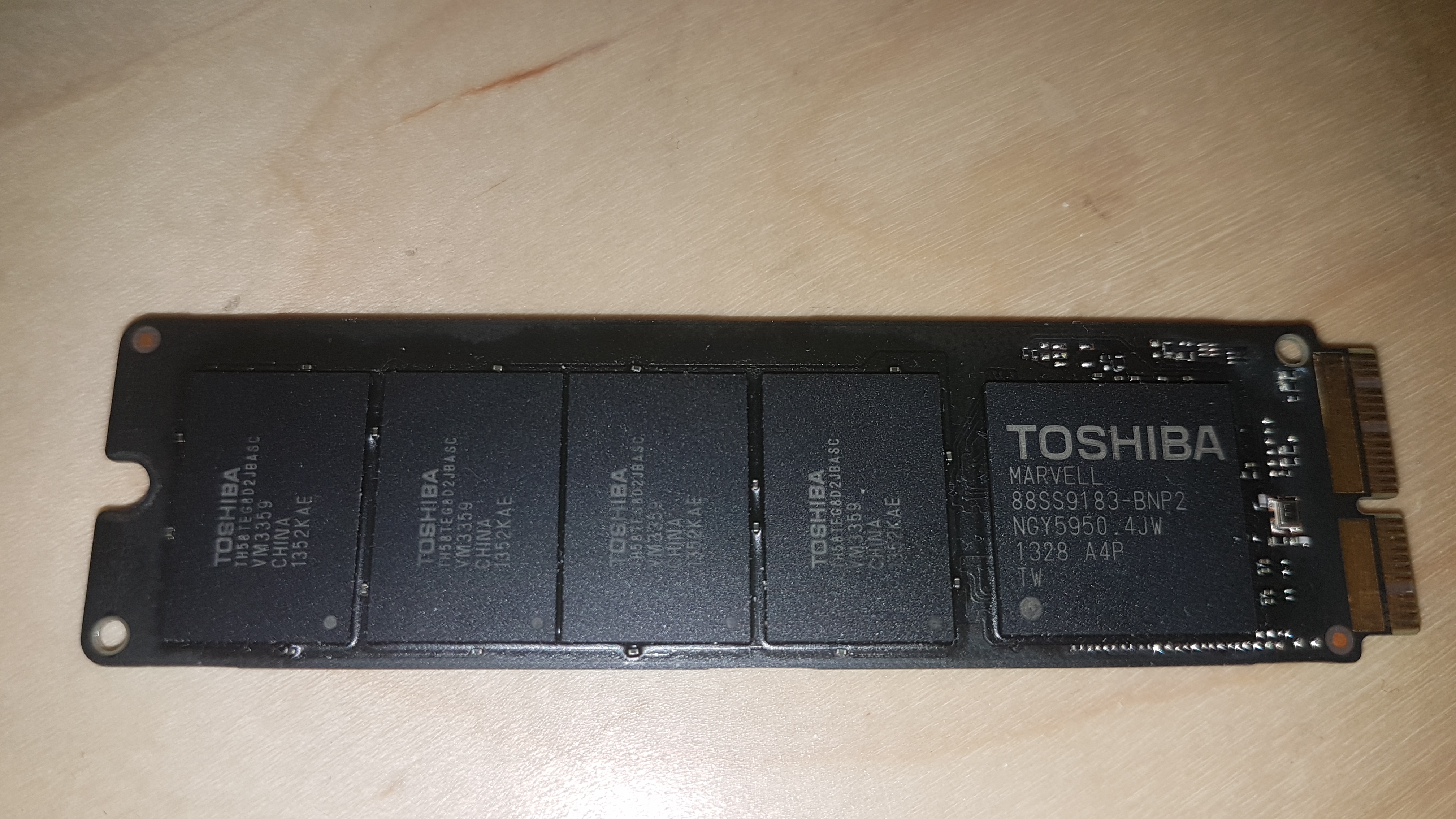

Hi Sirs,
I received this SSD. Connected to adapter (PCI card) no signals of life. Completely dead, not recognised at all. I double checked the adapter with another SSD, adapter it's ok.
Electrical issue (if yes where to check) or Controller issue?
Thanks in advance
Max

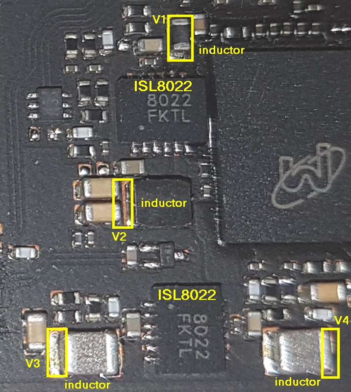

I would measure V1 - V4.
ISL8022, Renesas/Intersil, Dual 2A/1.7A Low Quiescent Current 2.25MHz Synchronous Buck Regulator, Vin = 2.8V - 5.5V, marking 8022, DFN-12:

I have the exact same problem on the same drive. You say to check V1-V4, what should they be normally?
 Post subject: Re: Toshiba THNSN2256GSPS totally dead
PostPosted: March 6th, 2019, 15:53
Posts: 17335
I don't know their actual values, but I know they shouldn't be 0V.
