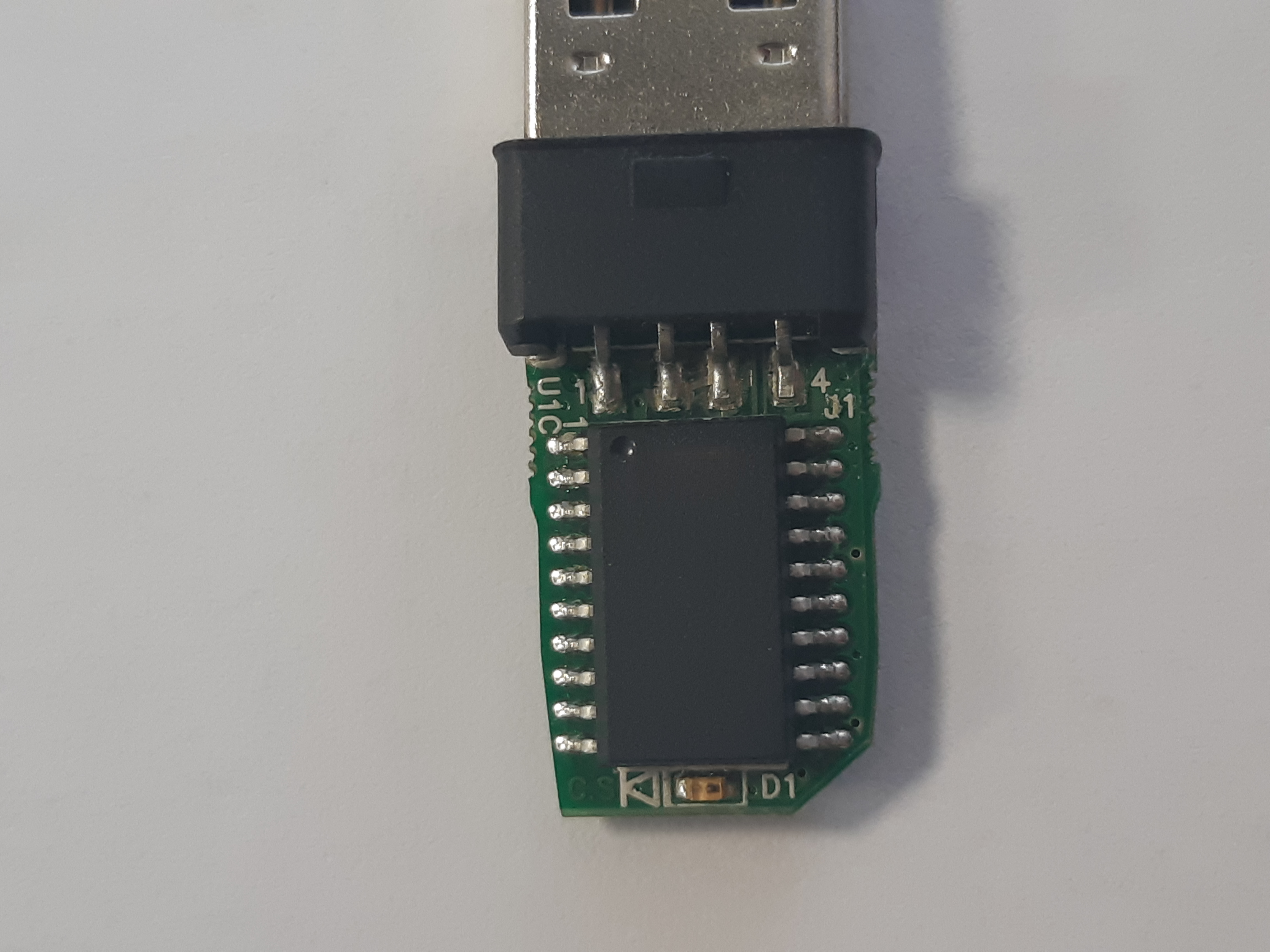

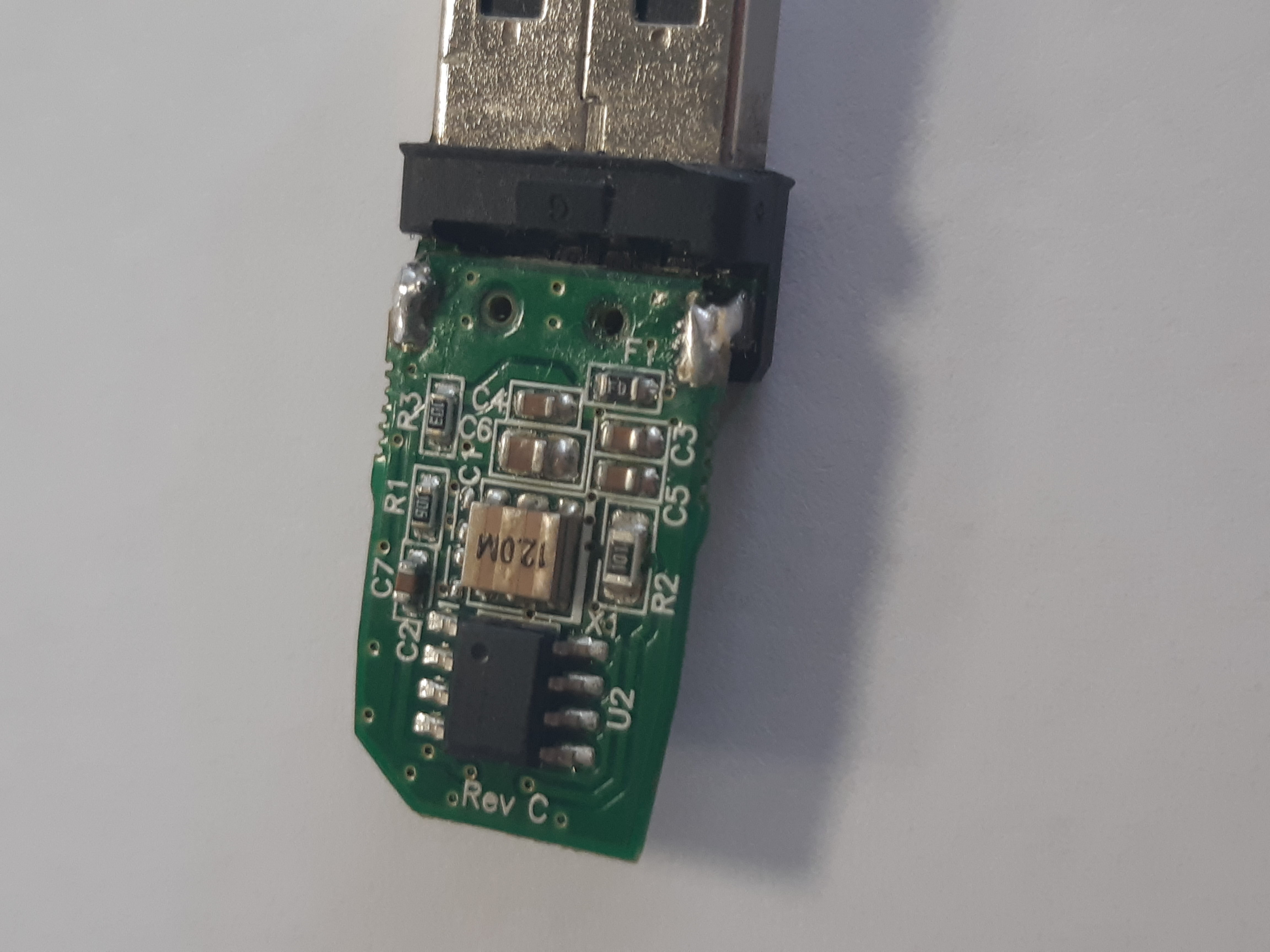

here are pictures attached
Sorry for not posting earlier
 Post subject: Re: USB dongle connector broken
PostPosted: March 5th, 2019, 12:13
Posts: 511
Location: Austin, TX
Hard to really see, but it kind of looks like some of the pads may be damaged/not connected and that is why you are not getting a solid connection from the repair.

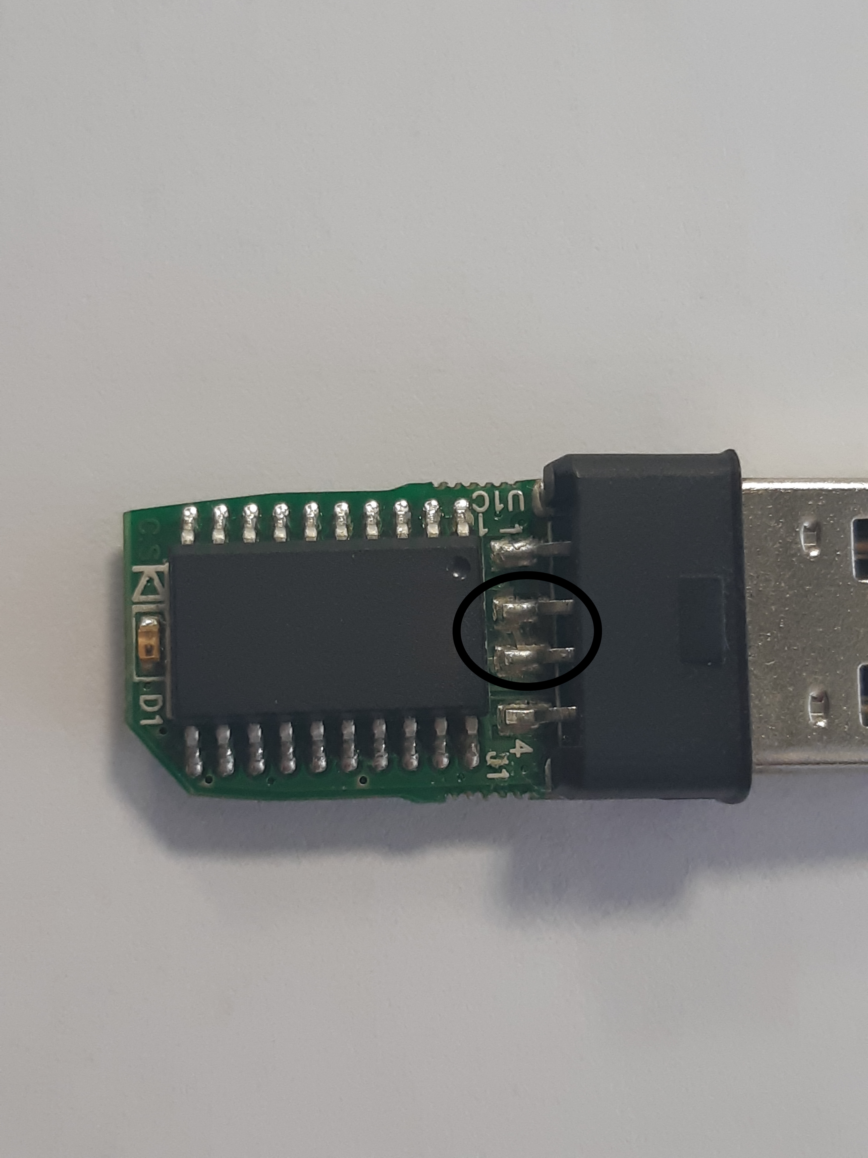

PostPosted: March 5th, 2019, 16:34
Posts: 738
Location: Ottawa, Canada
Perhaps @Cleanroom is referring to this one...
PostPosted: March 5th, 2019, 18:00
Joined: March 4th, 2019, 8:33
Posts: 78
thanks LarrySabo
when you say "Perhaps ... this one..."
do you mean the one who belongs to the USB connector
or the one who belongs to the chip ?
PostPosted: March 5th, 2019, 18:32
Joined: May 21st, 2007, 16:10
Posts: 1592
Location: Gothenburg/ Sweden
I would say the two center pad's look lifted...might need to be reconnected.
PostPosted: March 5th, 2019, 19:47
Posts: 78
thanks mr_spokk
already written above
I have tested continuity to all the pads, eliminating the possibility you have mentioned
those 2 pads have continuity as shown in the picture attached below
So, they can not be lifted
PostPosted: March 5th, 2019, 22:03
Posts: 738
I was referring to the USB lead. Never even noticed the IC lead being dodgy. I would touch them all up.

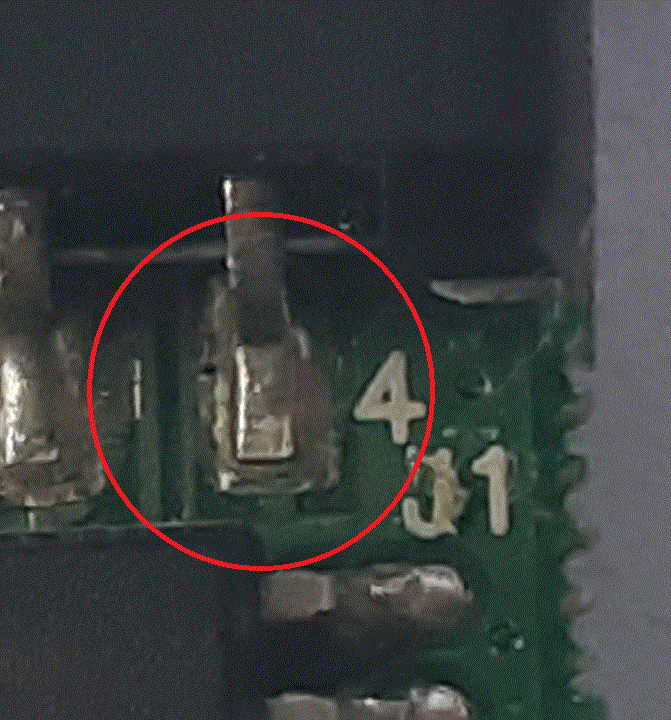

PostPosted: March 5th, 2019, 22:20
Posts: 3975
I don't like the look of this one either:
PostPosted: March 6th, 2019, 4:30
Posts: 78
thanks HaQue
but number 4 you referring to has continuity with number 1 of the chip
maybe it is dumb question
is there any risk of transffering both chips to a similar dungle (if I can find one) ?
PostPosted: March 6th, 2019, 4:37
Posts: 927
Location: uk
The symptoms described in the first post could mean a missing data line connection or a crystal oscillator fault.
Check for continuity on both sides of the usb plug as its not uncommon for the Data+ or Data- connection (circled in black) to break inside the plug in connector.
Then if required you would also need to check if the oscillator is functioning correctly.
