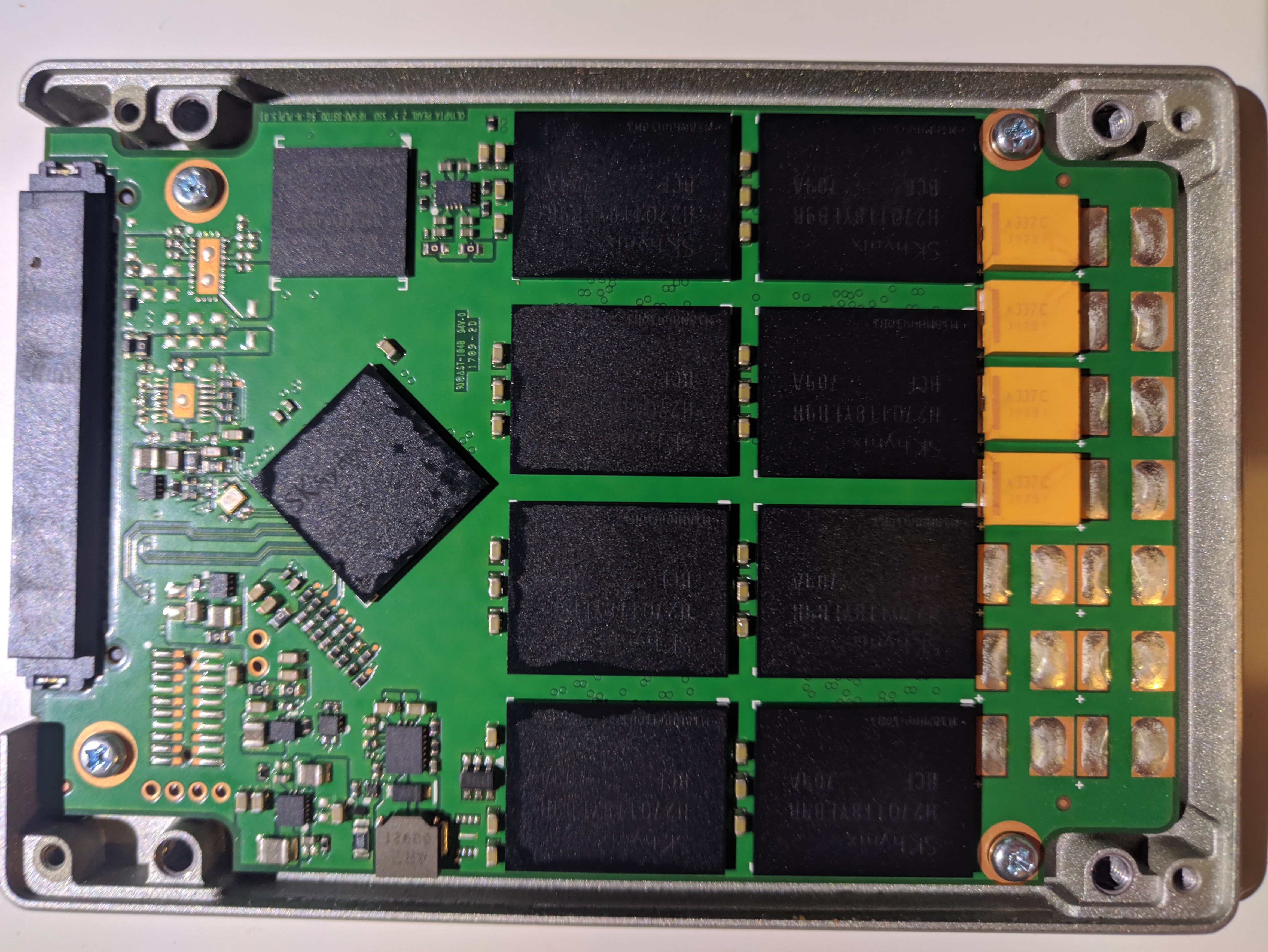

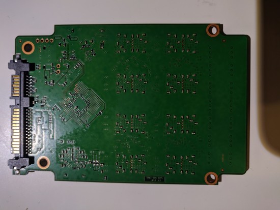

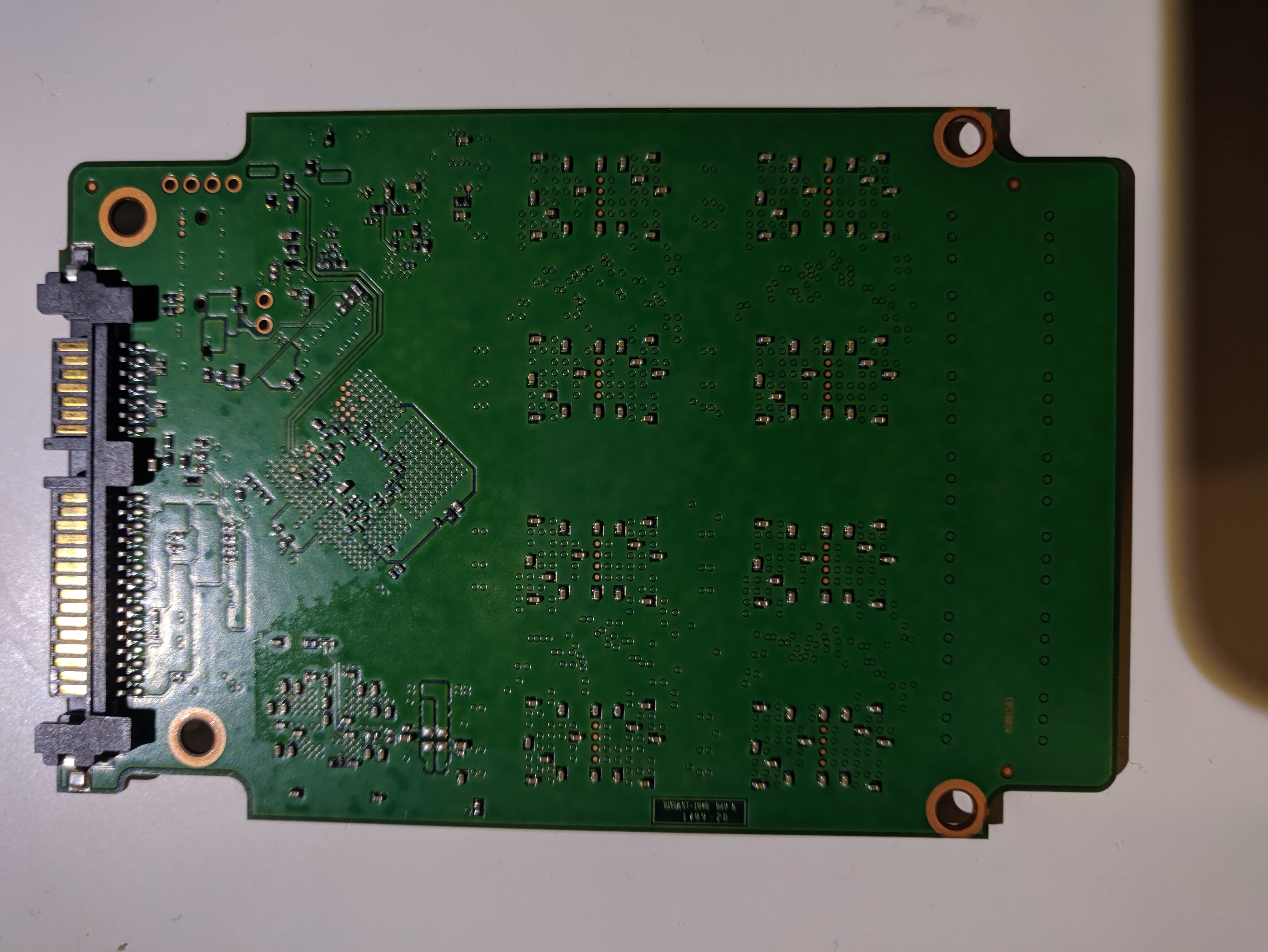

I can't get the text on the chips on camera, the middle one (I assume the controller) is a skhynix SH87810AA
 Post subject: Re: Seagate XF1230 ata password unlock?
PostPosted: September 12th, 2023, 16:38
Posts: 17225
Sorry, those images are impossible to work with.
I'm interested in the 20-pin chip at the bottom left. I suspect this may be an MP5505 which would be involved in power loss data protection. I was thinking that we could disable this chip and force the SSD into "safe mode" or "error mode" This technique was successfully employed to unlock a Samsung enterprise SSD in a recent thread.
Yes, it is a MPGE 5505 891 chip
