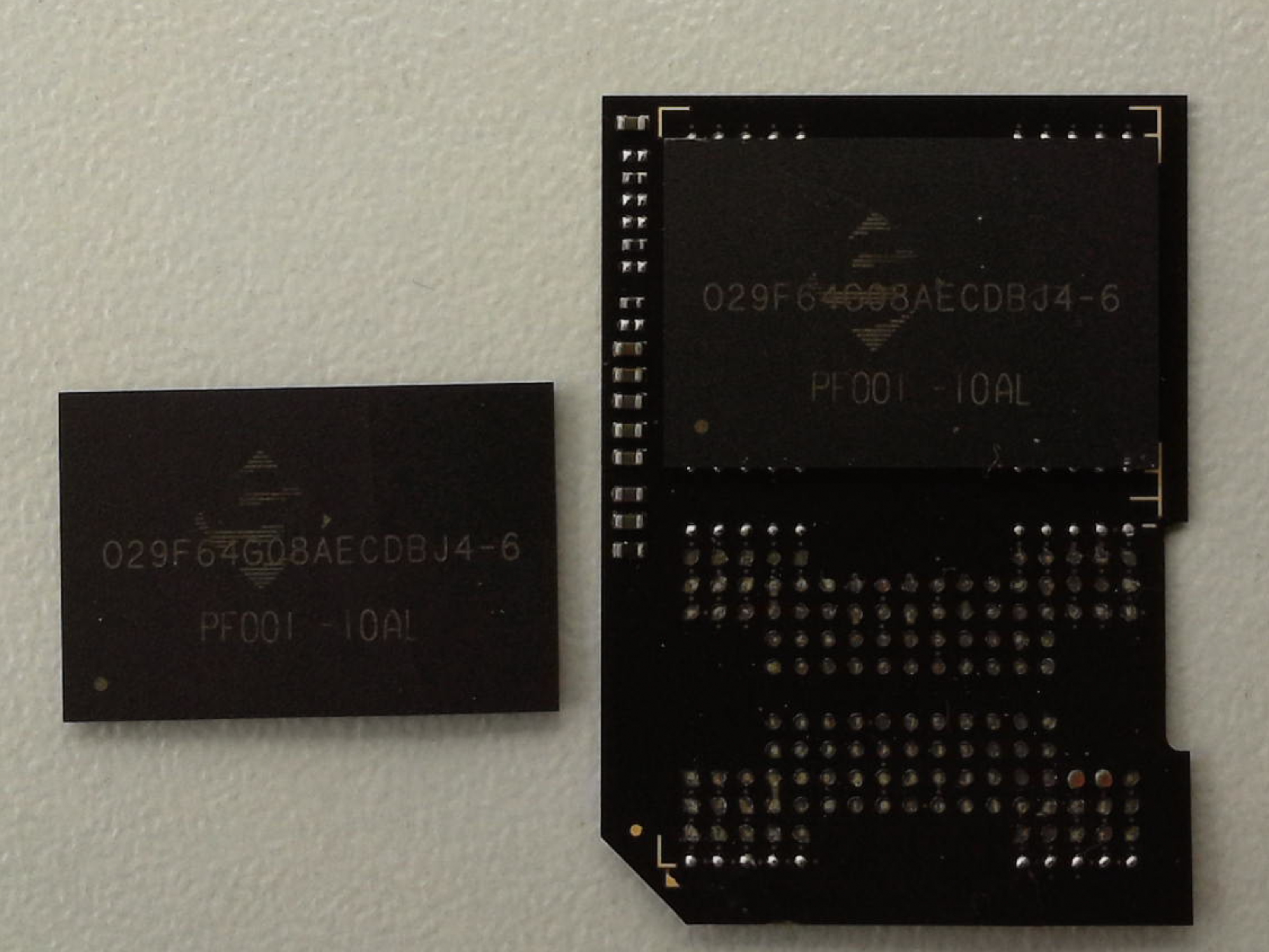

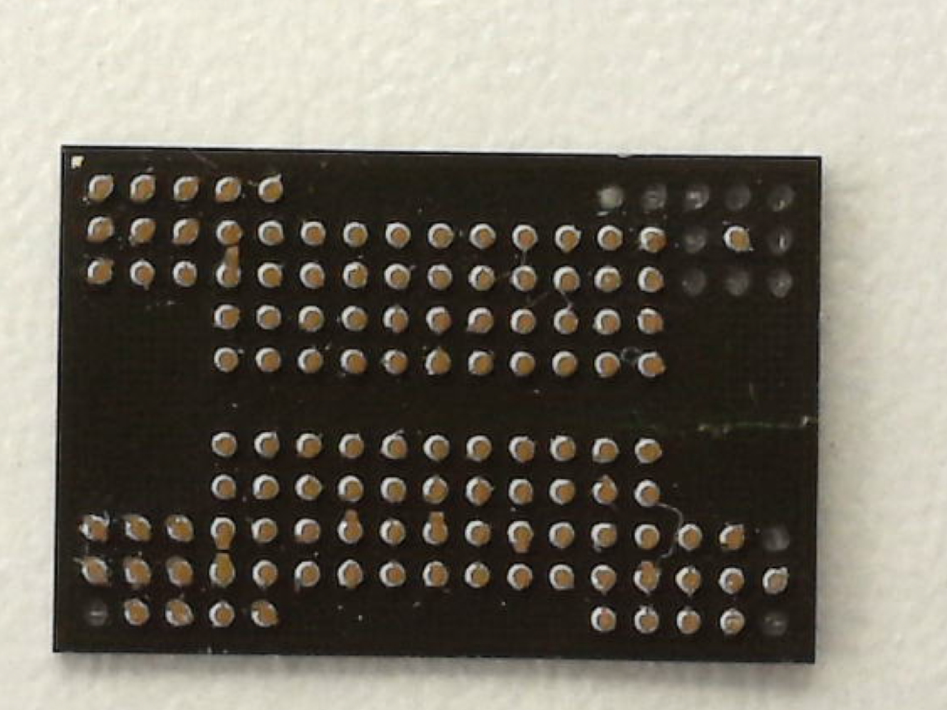

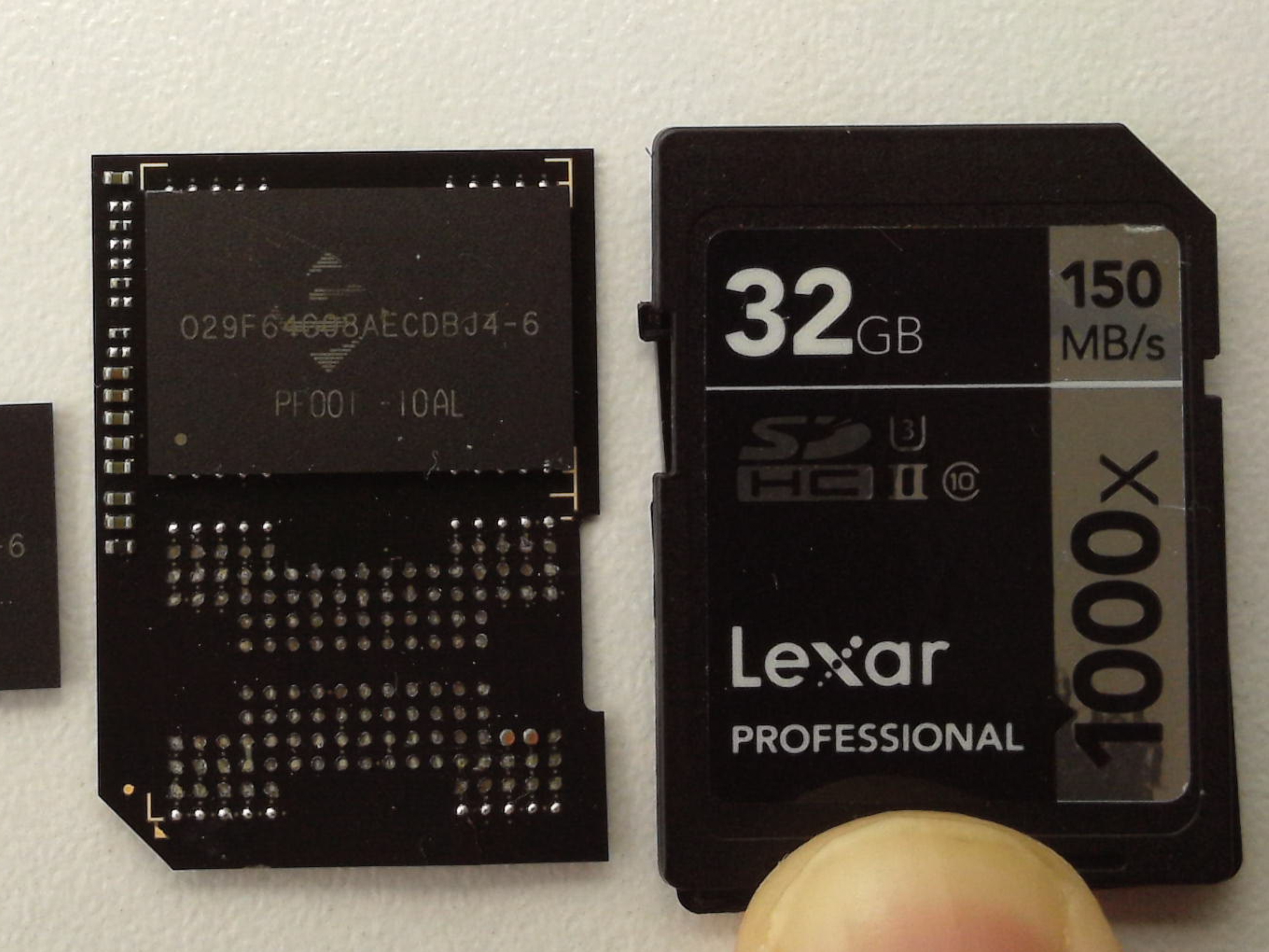

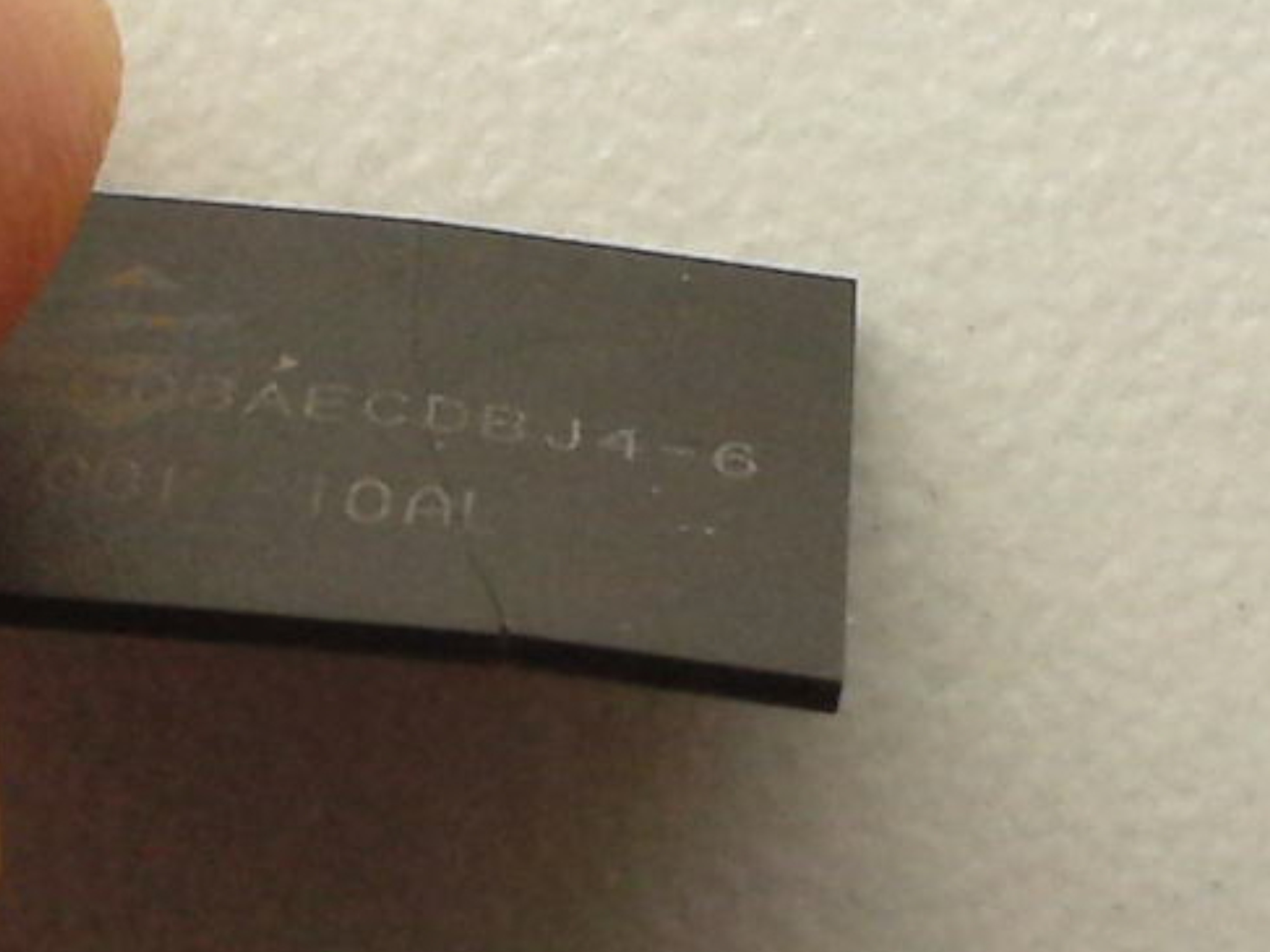

Anyone experienced such a case with this damage guys?
worth the time or not?
Thnx

Game over for that chip.
Most of the fast SD cards will use pairing of chips extensively I think. I would very much doubt any recovery.
What controller is it, Guessing SM?

If you see damaged crystal inside the crack (check under microsope), there will be no chance for read memory. Since there is Join by Page by small part there will be no chance for success. http://www.flash-extractor.com/library/ ... 0SD/SD_61/

The Break is in the middle which is worse of its kind ,It breaks the crystal under it into two .Sometimes we can get lucky with little break at edge not at this location .I i got a water corroded sandisk which someone refused recovery .I am sure i could reconstruct top layer circuit but i also know that people can go deep into inner layers ,But i am sure they have a good X-ray and lasers to cut surfaces .I am pretty much enjoying learning ,Might be like arvika sir gave you a little tutorial long time back i can also get one from someone after few days once i am more comfortable with tool ,But i do take out time daily to learn this and keep solving cases side by side

The damaged pads are N/C, don't worry about them.
Put it in a reader, 99% it won't work/overheat.. but there's always that 1%
