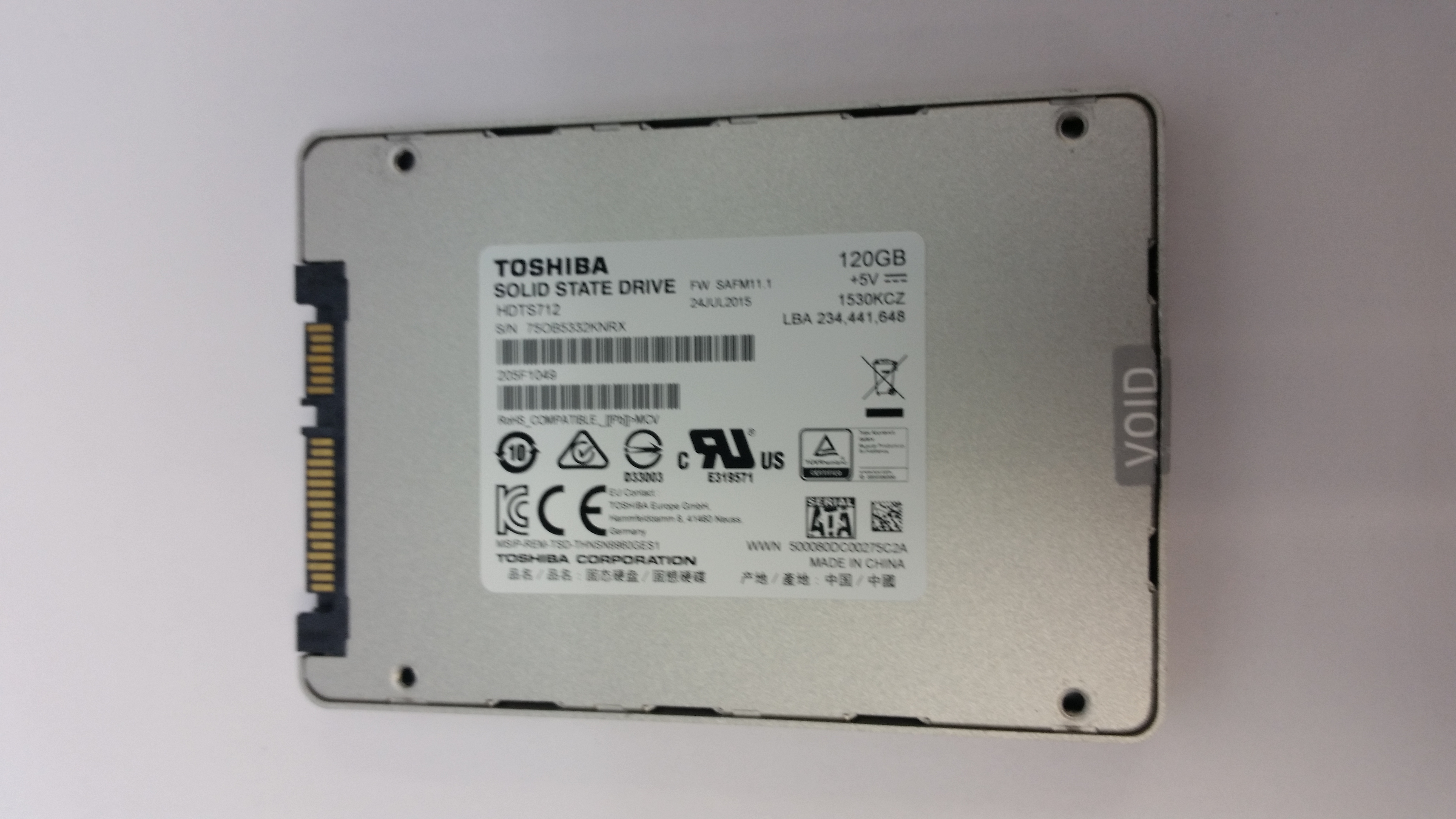

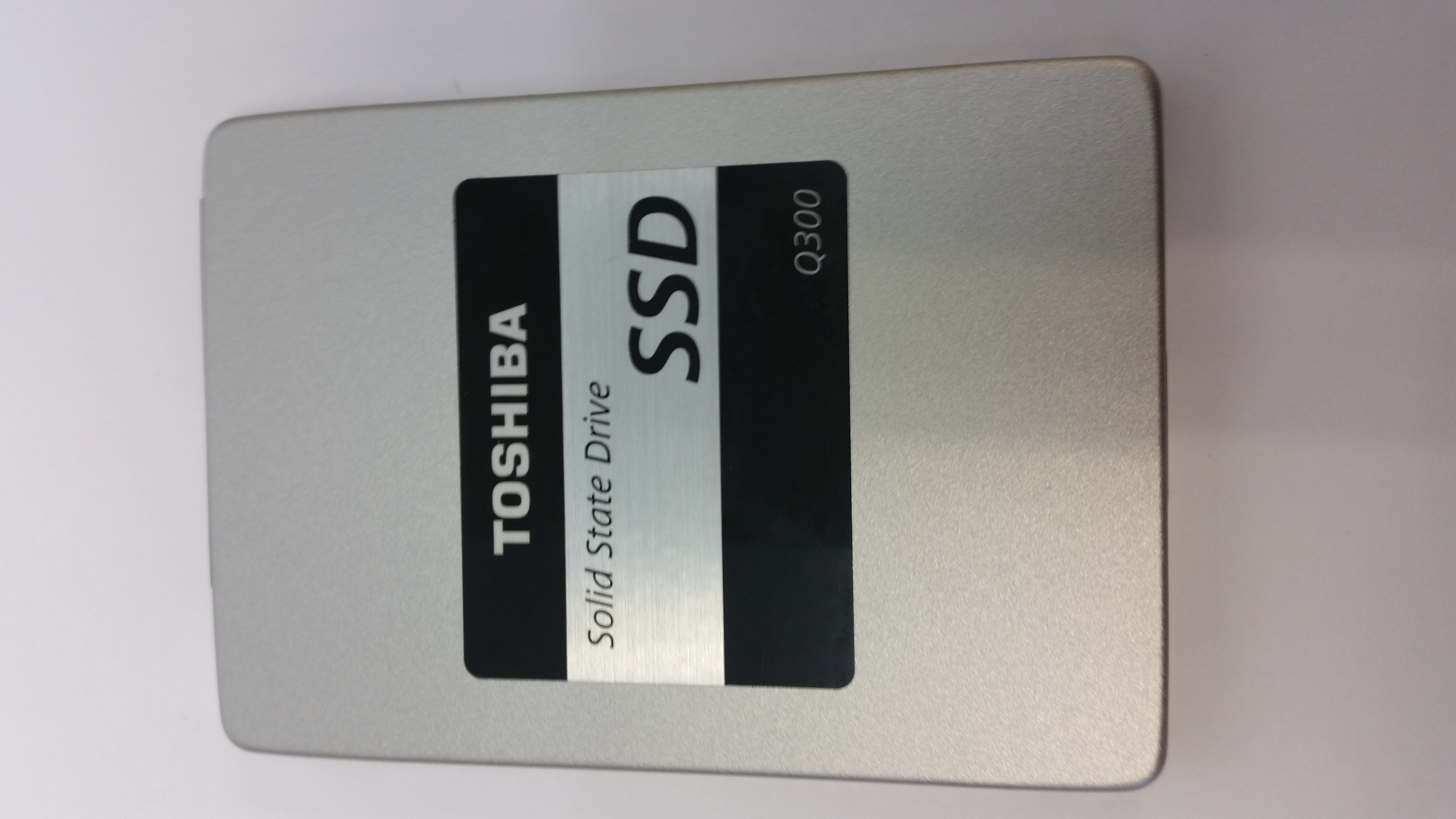

 Post subject: Toshiba Q300 Case
PostPosted: April 23rd, 2018, 17:49
Posts: 1777
Location: Phoenix, AZ USA
Anyone have any insights on the best way to open this SSD. Looks like both covers are just clipped together with plastic clips, but can't quite work out how to pry them open.

i think there are metal latches on the side. You may need to relieve the pressure on the sides to pop the clips.
I have seen this with other ssd drives.
use a metal spudger or a small flat head screw driver

Thanks @Cleanroom. For anyone interested. The best way to open it is by inserting an iSesamo tool at the top corners by the connector. Comes apart pretty easy.
