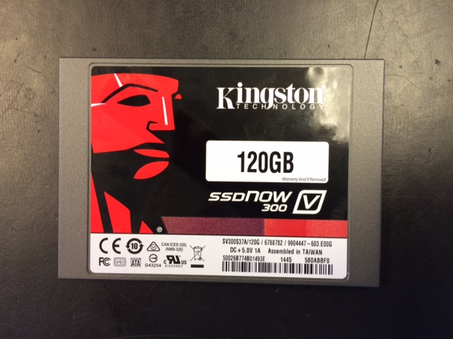

Any advice on how to crack open this case? No screws in this one.
 Post subject: Re: Kingston SSDNOW 300 Case Opening
PostPosted: June 20th, 2016, 18:22
Posts: 1898
Location: In your hard drive.
Screws under front sticker...

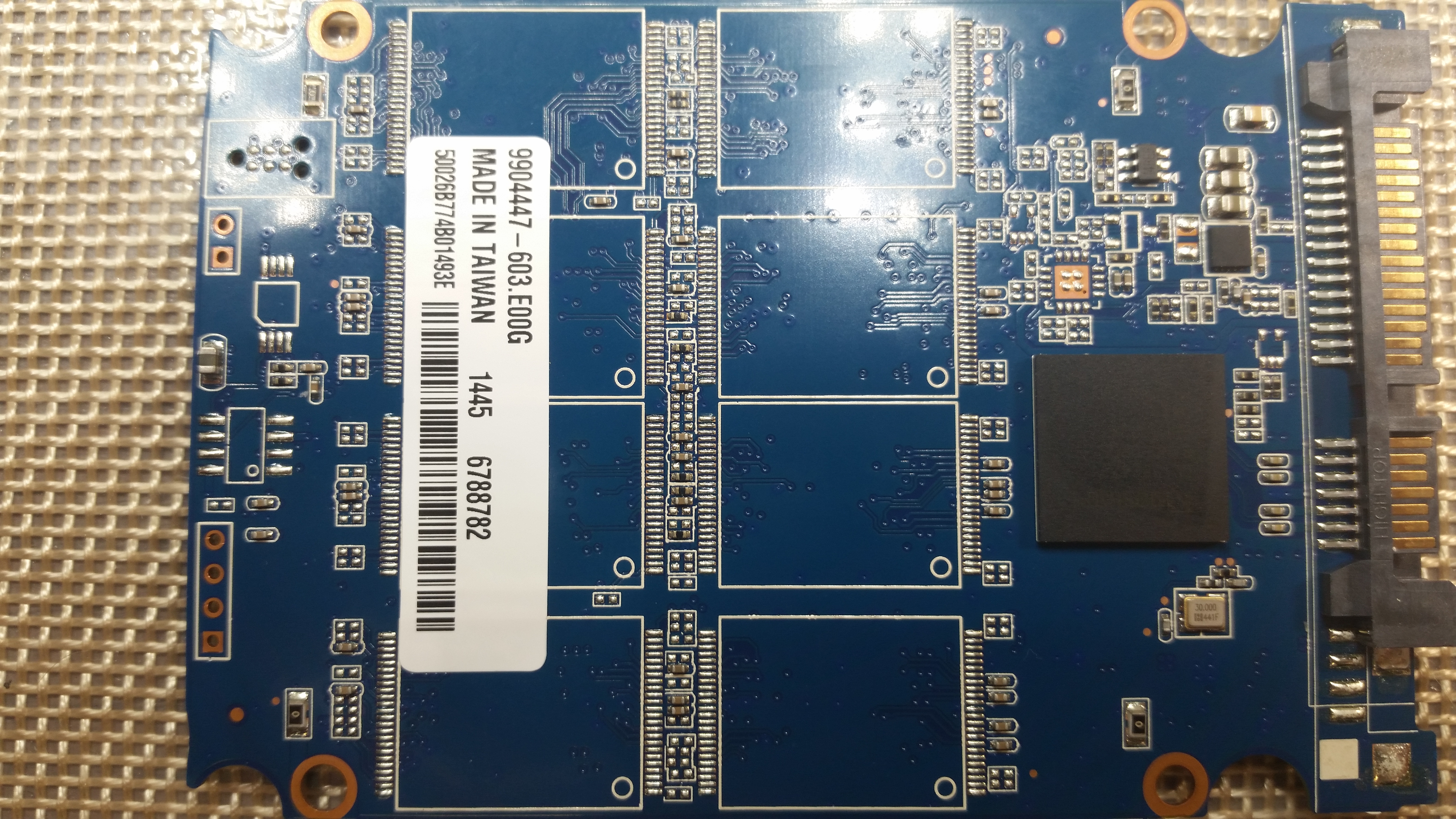

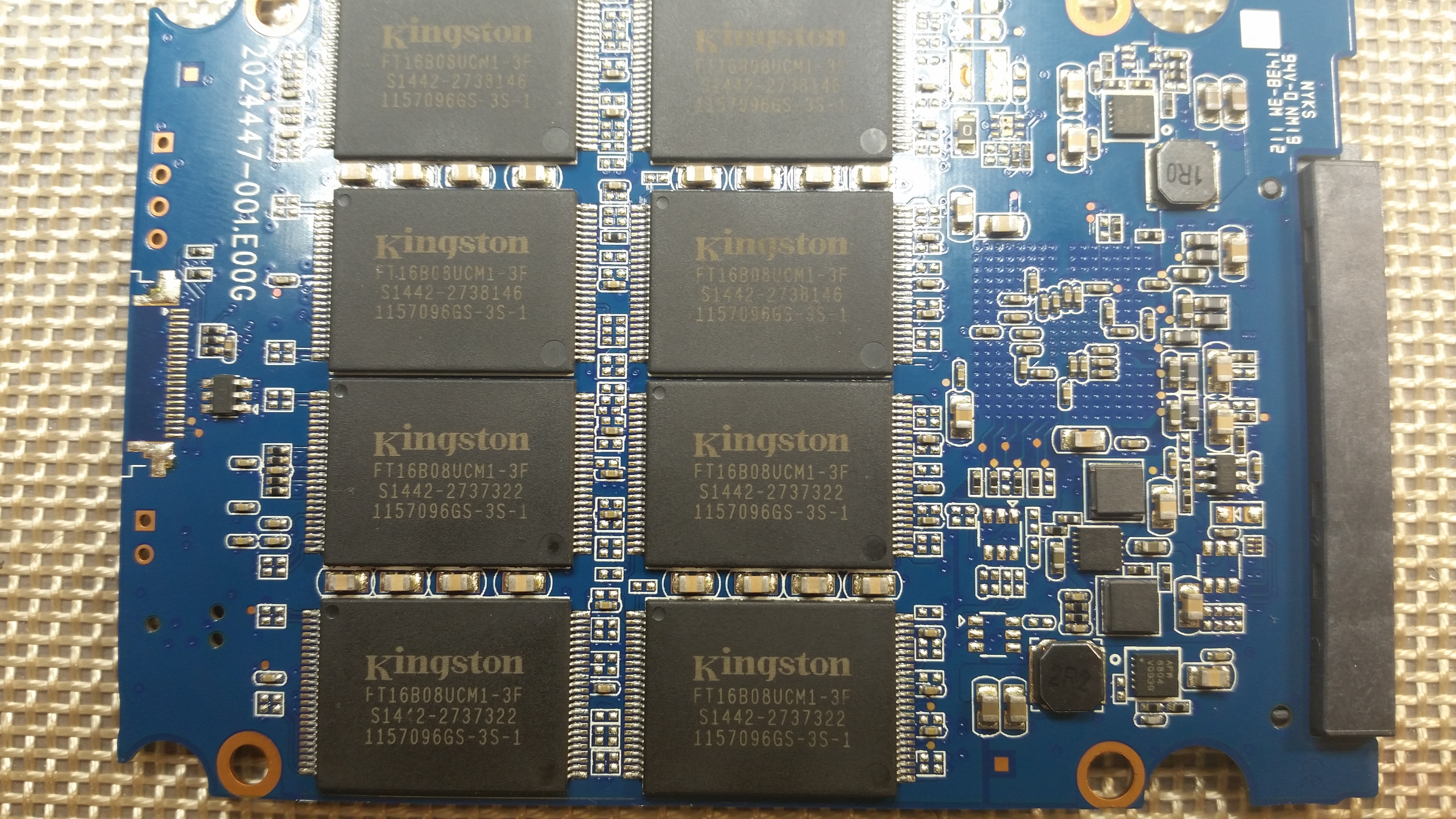

I can help you with the "not-so-obvious PCB issues" if you upload detailed photos of both sides. For example, there is a 5V e-fuse near the SATA power pins.
PCB protection devices - Electronic Fuse:
http://www.hddoracle.com/viewtopic.php? ... 8872#p8872
Thanks. Here are the pics, let me know if you want me to focus in on anything in particular.
PostPosted: June 21st, 2016, 17:17
Posts: 17256

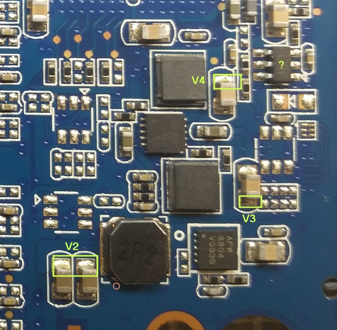

I would start by measuring the +5Vin and +5Vout voltages at the 5V e-fuse.
Then I would measure the regulator voltages at V1, V2, V3 and V4.
I presume there would be a serial interface that you could test with the appropriate tool. That should tell you whether the controller is alive.
APW8804, Anpec, synchronous buck converter with high and low side MOSFETs, 3A, 2.6V - 6V in:
http://www.anpec.com.tw/ashx_prod_file. ... PW8804.pdf
http://www.wpgholdings.com/uploads/bu/b ... 8804a4.pdf
+5 Voltages both read 5.06v
V1 1.06
V2 2.87
V3 1.06
V4 2.87
PostPosted: June 22nd, 2016, 16:19
Posts: 17256
1.06V looks like a Vcore supply for the flash controller, but I don't understand why there would be two of them, unless the controller had two cores. However, there is no mention of this in the datasheet:
http://www.seagate.com/www-content/prod ... 1409us.pdf
2.9V would be the supply for the NAND flash array, but once again I don't understand why there would be two of them since only one side of the PCB is populated.
I expect that there would be a 3.3V supply for the serial diagnostic interface (at the headers at either end of the PCB) but I can't see where this would be coming from. Could either of the 6-pin chips (which I have marked with "?") be a 3.3V LDO regulator? BTW, the 6-pin chip marked "T730" is a temperature sensor.

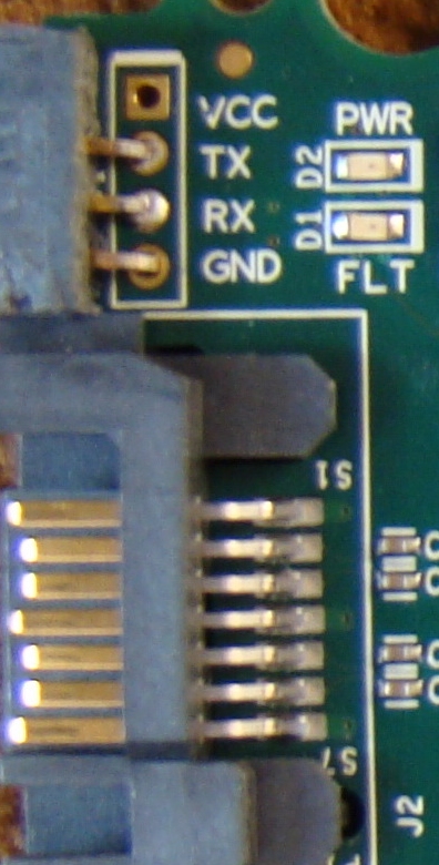

I would think that there should be a way to confirm whether the controller is alive by hooking up to the serial terminal. Perhaps there are shorting points that place the drive is some kind of diagnostic (safe?) mode.

Here are the terminal pins from an OCZ SSD with an SF-2281 controller:
