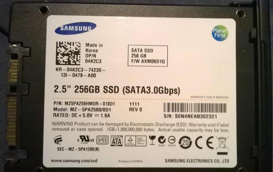

Hi Everybody,
I have a Samsung SSD 2.5" of 256GB that was working on a DELL M4500 Laptop. After leaving the laptop working, when I came back I found a message on the screen saying that "can not boot from device". After attempting some diagnostic I am receiving a 2000-0150 error code. The laptop its just 3 years old.
I have been trying to mount the SSD in other computer via USB but it doesn't shows up as a drive, at least its recognized in Windows in the device administrator. I tried to use "HDD Raw Copy Tool" to clon the disk so I can work the recovery, but the tool can not copy the disk as fails in the process. Also I tried with "Partition Find and Mount" tool, but the Scan process seems to hang. In the past these tools have worked excellent with hard drives.
I will really appreciate any advice in how to recover the disk or data and what SSD tools I could use . SSD are kind of new for me , not sure if there are other tools designed to work with SSD.
Best Regards,
Carlos.

I apologize for the delay. The disk model is Samsung MZ-5PA2560/0D1 (I attached a picture of the label on the disk just in case). I think this is older than the EVO series. Pelase let me know if you think I can diagnose with the software you suggested https://github.com/thesourcerer8/SSDdiag.
Any suggestion is appreciated and welcomed.
Best Regards,
Carlos.

The firmware part is definitely unsupported, the firmware is a different one than the EVO840. I don't have any donors for that SSD, and I couldn't find enough information about which controller is used, so I don't know whether the hardware-diagnostic part is compatible, or not. I would need the number on the controller, S4LN045X01-8030 would be compatible.

Ok, some ideas I have:
Try Samsung Magician, and see what it tells you.
Either attach the SSD directly to a SATA port, or if you only have USB, buy a UASP capable USB-SATA adapter. (Normal USB-SATA adapters that do not support UASP are not sufficient for data recovery)
