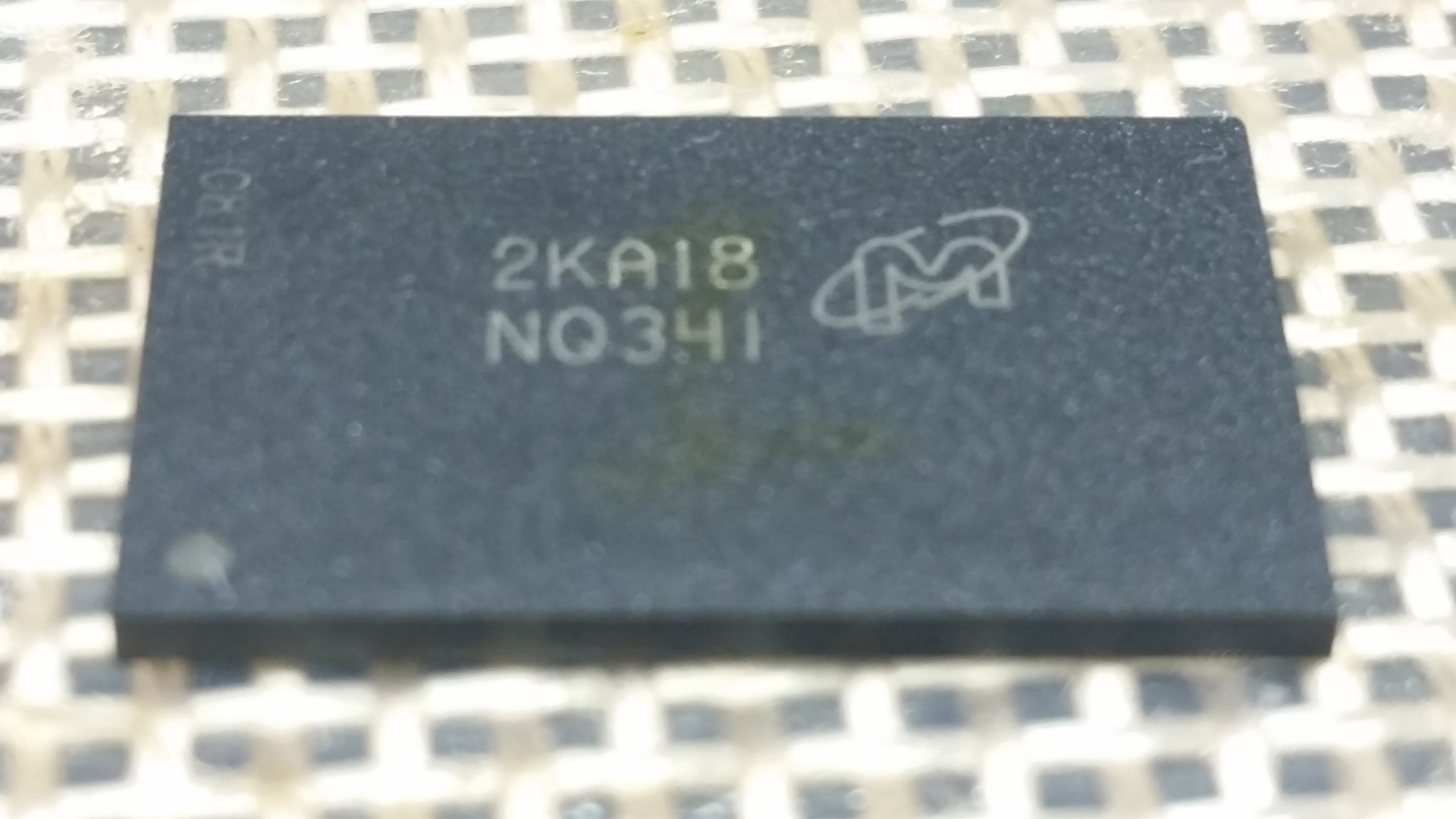

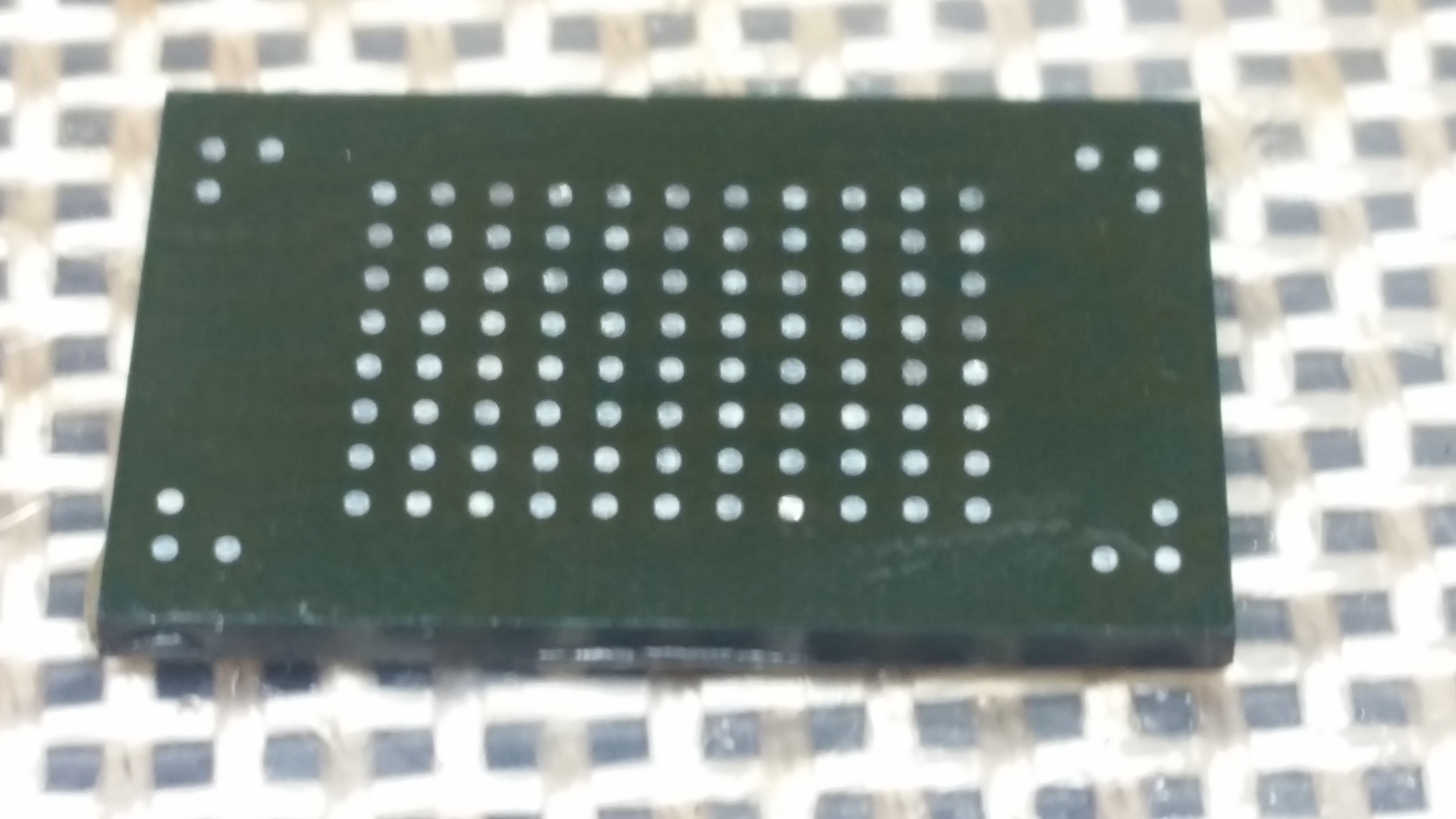

Just got a Lexar CF Card in with these chips. I cannot find the specs from the number on the chip. Are they BGA 152?

It's BGA100 chip - there are sockets or direct BGA boards for this. You can look in VNR standard set ;)
If you need to solder then page 18 on ONFI - http://www.onfi.org/~/media/onfi/specs/ ... .pdf?la=en

While learning flash these days i have come to know that there are many ways to read most chips and specific ways to read some chips .I do not agree that the socket would be bad or all of your 4 chips are fried ,Its impossible that all 4 are .Definately Not BGA 152 That Beast Has a Different Pinout All Together .What All Tools you Have ? .

The chip is Micron MT29F256G08AUCABK4-10:A, where 'K4' is the package code.
Micron's use 'H1', 'H2, and 'H3' codes for their BGA100 depending on the package thickness, but I can't find any information about 'K4' code.
I suspect that this chip may have an non-standard package or pinout.
BTW, they have a very similar chip with a standard package code: "MT29F256G08AUCABH3-10:A".

NAND Flash Component Part Numbering Guide - SpecTek:
https://www.spectek.com/pdfs/SpecTek_pns_Flash.pdf
    H1 = 100-ball VBGA, 12 x 18 x 1.0
    H2 = 100-ball TBGA, 12 x 18 x 1.2
    H3 = 100-ball LBGA, 12 x 18 x 1.4
    K3 = 100-ball VLGA 12 x 18 x 0.9
    K4 = 100-ball TLGA, 12 x 18 x 1.1
