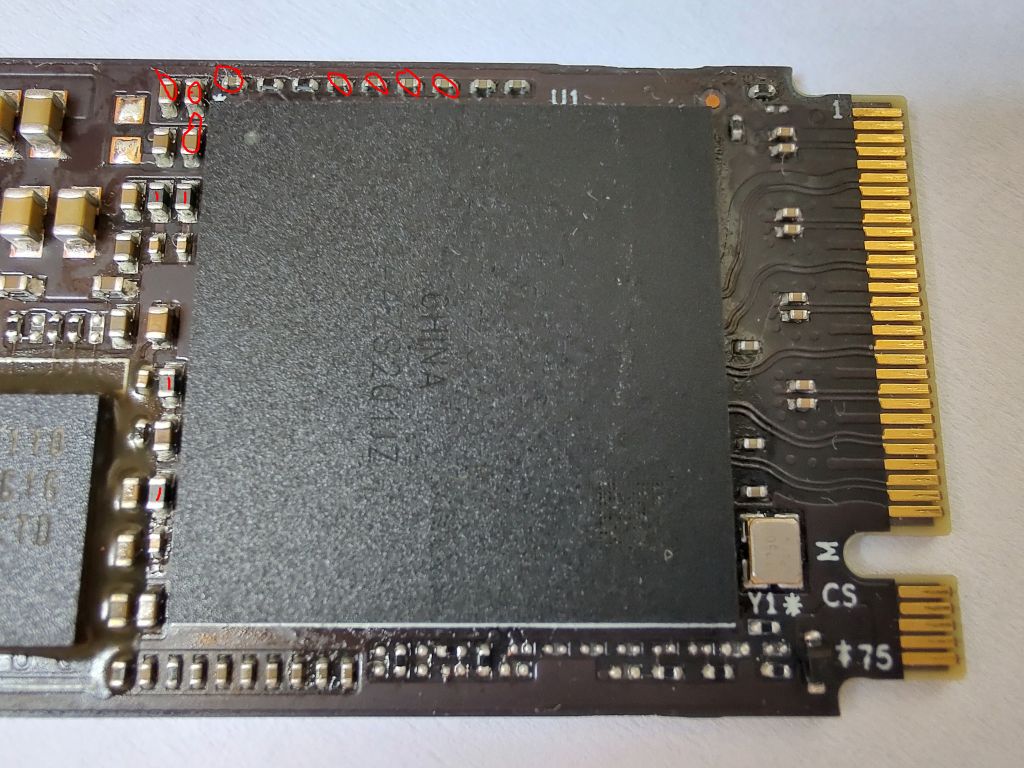

Hello everybody on the forum,
My WD 1TB SSD since wednesday suddenly stopped to be recognized by my Intel NUC on boot, (no bootable device found). I tried also on two slots of motherboard and external enclosure but problem persists. The contoller chip becomes hot after a minute or two, about 85C, while memory chips around 40C. Any components I can check for shorts or else with my multimeter to diagnose it? Thank You.
Model is WDS100T1X0E-00AFY0 DOM:08SEP2021

Is that damage, thermal paste , glue residue or just the light on the controller? pmic also looks a little discoloured.

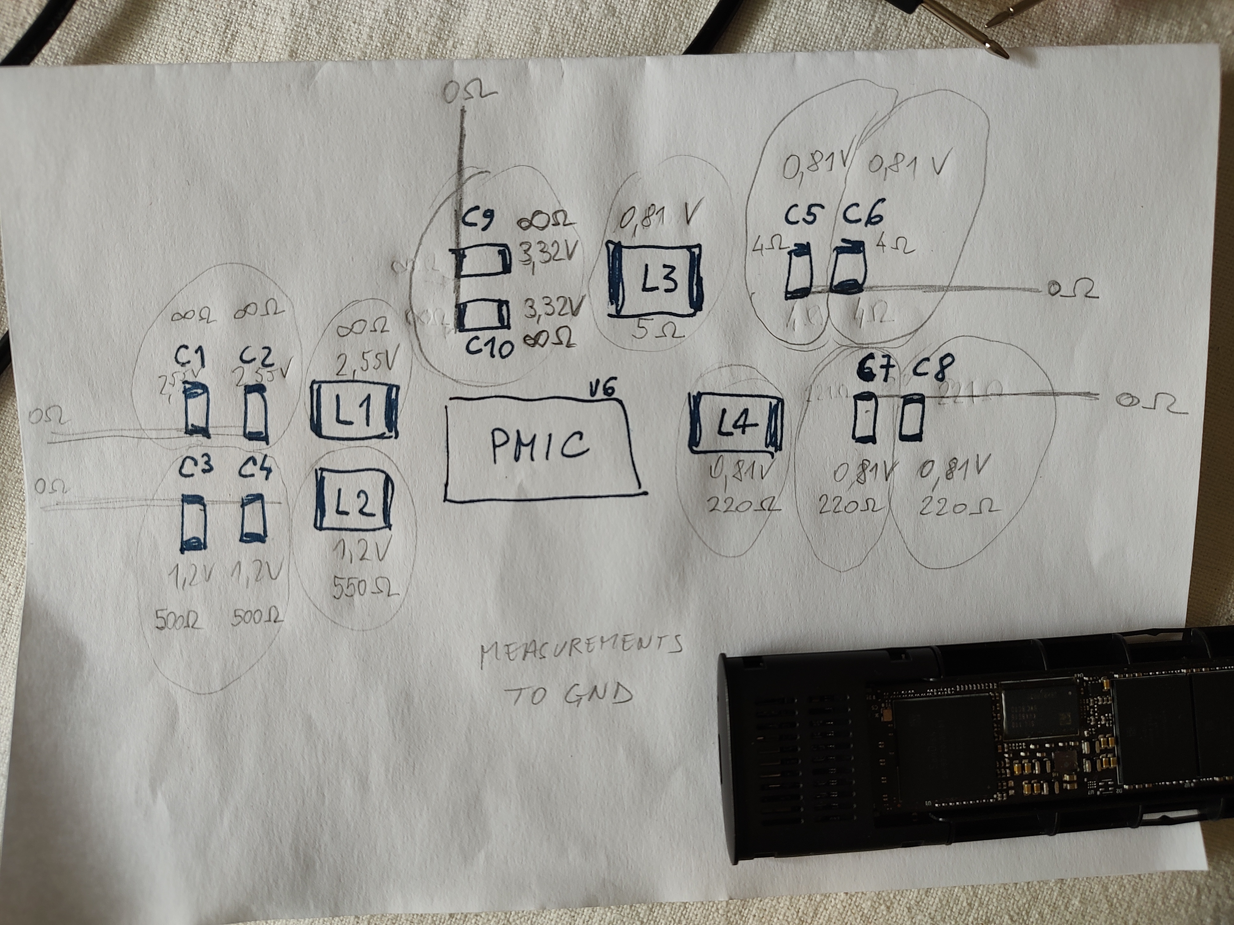

I checked the resistances however readings are not very stable, they fluctuate a little (measured with UNI-T UT60S)
1: 828-838 Ω
2: 320-328 Ω
3: 4.6-6.3 Ω
4: 430-440 Ω
I see something like a solid semitransparent paste around PMIC and DRAM chips, I don't know what it is. However I have another identical SSD in desktop pc so i can take it out to make some comparisons, just need some time to remove graphics card.
@Lardman: The left portion of controller was covered with label

The goop is conformal coating/underfill - makes things more difficult to work on the board.
You appear to have a short on L3, I'd lift l3 to see which side it's on, given the controller was getting hot you might want to check if the caps around it are on the same rail.

I checked the two capacitors right of L3, both shorted (5 ohms) the other big capacitors no less than 250 ohms. Could I replace those two or something else to check yet? How do I know specs of those caps? Probably the same as other couples next to inductors right?

Can you repeat those resistance measurements for your working SSD? Can you also measure the voltages at those points on your working SSD?
L3 seems to be associated with the Vcore supply for the controller. The resistance would normally measure around 100 ohms. As Lardman has pointed out, the discolouration on the controller would suggest that it may be shorted. As he suggested, measure the resistances of the capacitors around the controller to confirm whether they are bypassing the same faulty supply.

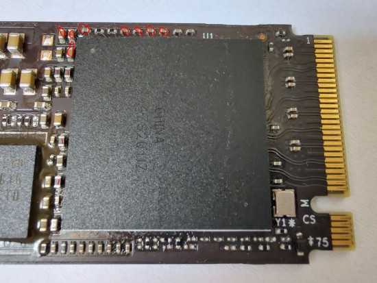

Unfortunately after removing label i discovered it has different PMIC and memory chips with differences as you can see... same model just manufactured 6 weeks later, so i don't think we can make comparisons in this case. PMIC has a mirror like surface very reflective, this is the reason is may appear discoloured. I cleaned it with isopropyl alcohol But personally i don't think is damaged, at least visually.

You can still measure the resistances and voltages. There is one additional inductor, which suggests an additional supply. Are the two controllers identical?

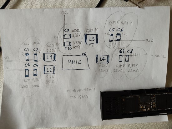

Measured the voltage values connected to PC and resistance unplugged (or I had to measure also connected?). One side of big capacitors is to ground. Found also other shorted caps on top and left of controller, some are small black SMDs so i suppose are inductors right?
Probably bad capacitors are on some rail, maybe even just one blown cap making others looking shorted.

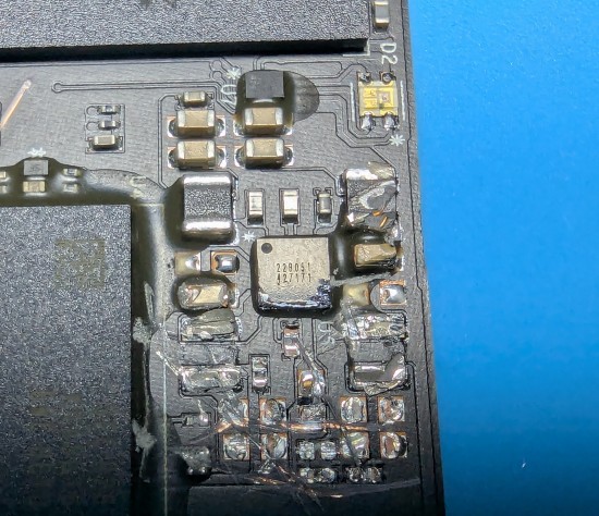

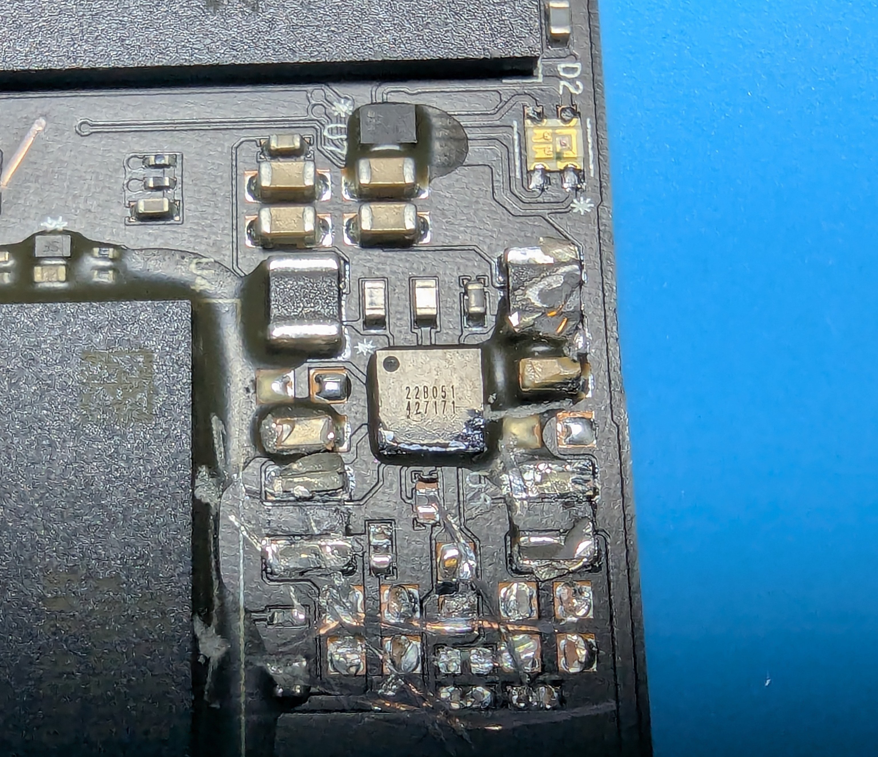

Hi all,
i hope it`s okay to add my problem here. I got a SN850X where somebody tried to open the cooling block with a screwdriver.
I removed all broken parts and checked for shorts. Everything looks fine until now besides the PMIC. Is there any chance to replace it without getting a donor?
