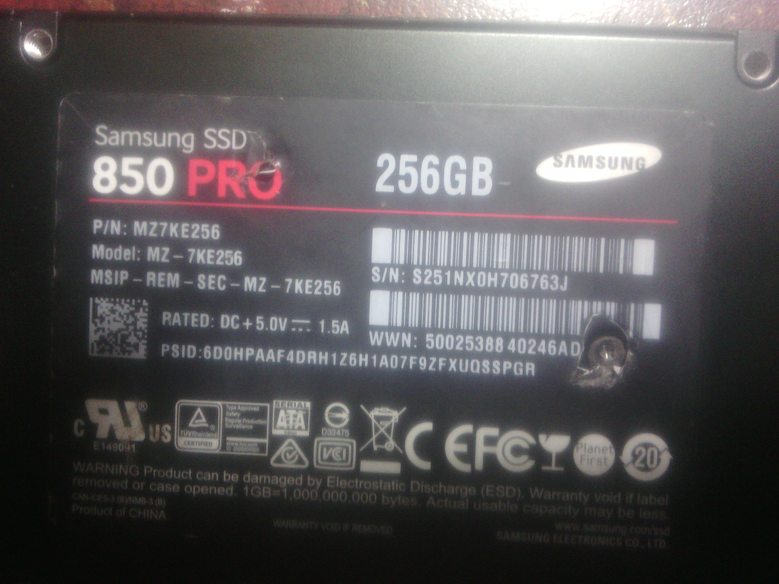

This ssd has MACAFEE ENCRYPTION i did tray to PSID revert but wont work kindly help me to decryption of this drive.

You will need the mcaffee decryption software, the code of the day and the decryption key.

Well its wont format until its decrypted thats why i am looking for solution i have try many tools bt still wont format...

Every one for such a nice comment i have unlock the ssd and its work fine now my apology it was TCG OPAL security which i found in Samsung magician watever it was i will share how did i unlock this drive with (sedutil)https://github.com/Drive-Trust-Alliance/sedutil/wiki/PSID-Revert
here is the file http://www.mediafire.com/file/u638377asinna3c/RESCUE32.img.gz/file
which u can tansfer to usb drive with Disk Image Writer and follow the commands on website hope this will help others user.
