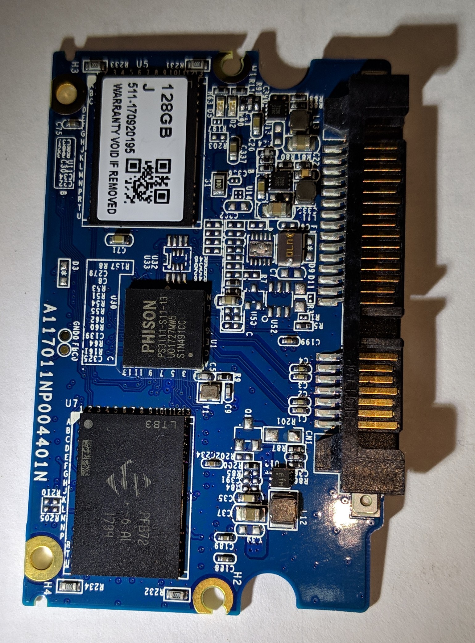

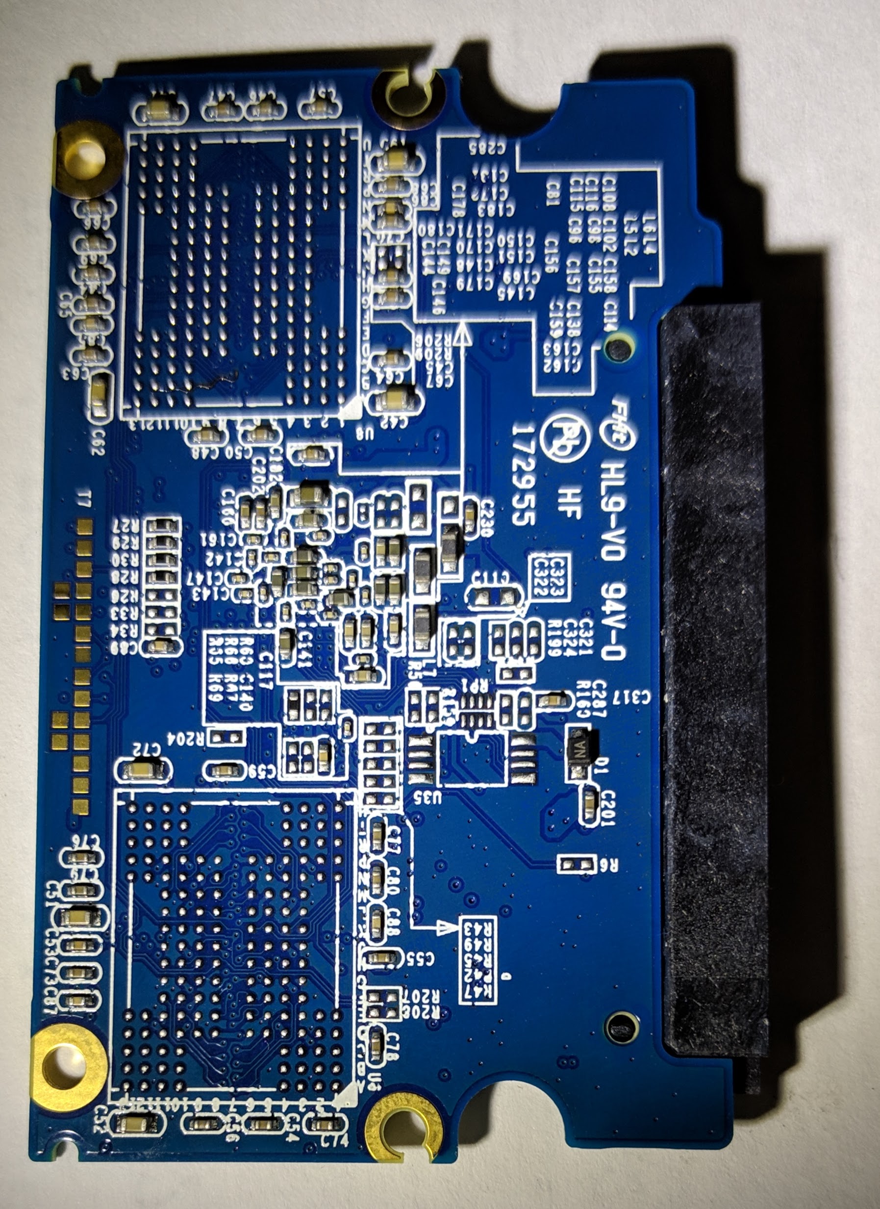

PNY CS900 120GB SSD that suffered an unexpected power failure. Drive now identifies as SATAFIRM S11 with 120GB capacity but doesn't respond to SMART commands and data cannot be accessed.
Controller is Phison PS3111-S11-13. It does get slightly warm to the touch when power is connected.
I see mention in this thread of shorting points for safe mode but the PCB discussed is slightly different:
https://forum.hddguru.com/viewtopic.php ... 9&start=40
Pictures are attached.

Probably it can be recovered (if supported).
You will need to do a translator regen to access data.

Any solution for this that doesn't require PC3000?
 Post subject: Re: PNY CS900 SSD Idenifying as SATAFIRM S11
PostPosted: December 12th, 2019, 7:23
Not as far as I know.
