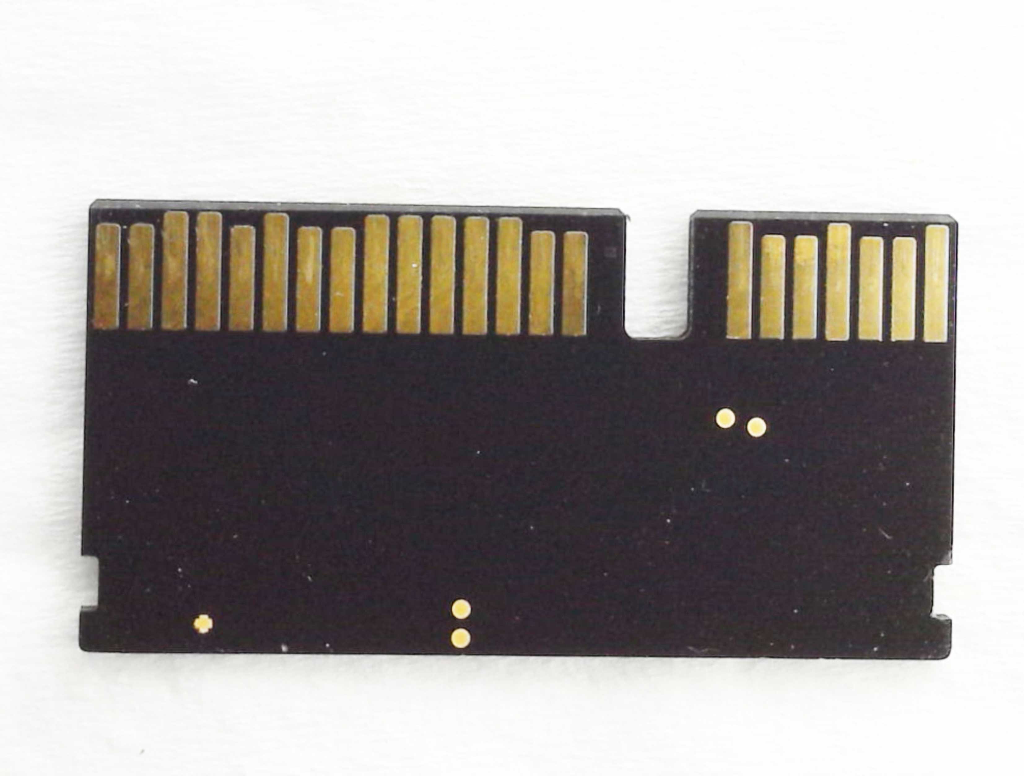

 Post subject: Ugly Lexar NQ100
PostPosted: February 24th, 2024, 4:08
Posts: 2854
Anyone got similar cases? coz its the 1st. here with me
We used to see the Maxio but this is new
:shock:
Lexar NQ100.rar [1.16 MiB]
Downloaded 391 times
 Post subject: Re: Ugly Lexar NQ100
PostPosted: February 24th, 2024, 4:55
Posts: 1317
WTF - new one on me. Please tell me that's not the direction manufacturers are going. Have you had a probe around, did you find anything?
PostPosted: February 24th, 2024, 6:33
Posts: 2854
found the safe-mode pins (which is visible here) but nothing else yet...
PostPosted: February 24th, 2024, 6:38
Posts: 1317
What does the controller ID itself as in safe mode?

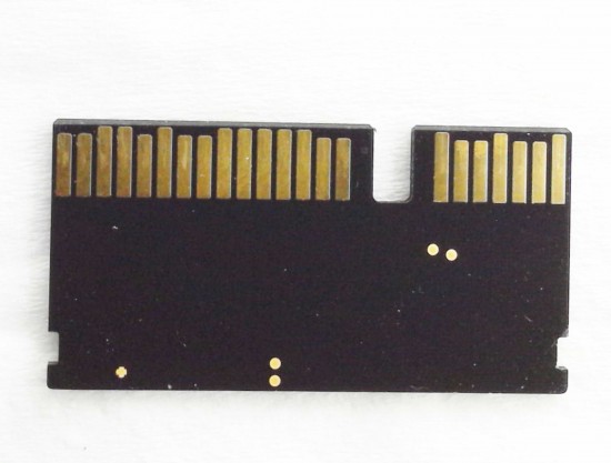

PostPosted: February 24th, 2024, 8:22
Joined: July 8th, 2019, 12:27
Posts: 162
Location: 中国大陆浙江省湖州市
It's called mini SDP. This form of SSD is rare, and I encountered it a long time ago. Typically, the controller is one of 88NV1120, MAS1102, MAS0902, or YS9082.
https://finance.sina.com.cn/tech/2021-0 ... 4448.shtml
http://flash-matrix.com/
PostPosted: February 25th, 2024, 2:44
Posts: 2854
similar to Maxio safe-mode
@csava
Thnx for the info.
PostPosted: February 26th, 2024, 3:53
Posts: 3551
They're around since 2016? Wow, they must be very rare, haven't seen one either. Which, I guess, is a good thing :mrgreen:
PostPosted: February 26th, 2024, 8:11
Posts: 162
I also dislike similar things. This company seems very keen on producing products with non-standard interfaces, which I think is a rather low-level innovation. Truly capable companies don't spend too much time showcasing how different they are.
PostPosted: February 27th, 2024, 18:17
Posts: 17256
Is that the correct model number? When I search for "Lexar NQ100", I get a 2.5" SSD but no mini SDP.
https://tpucdn.com/ssd-specs/images/d/601-pcb-front.jpg
https://aphnetworks.com/review/lexar-nq100-480gb/006.jpg
The controller is a Lexar DM928, which is a rebranded Maxio MAS1102.
https://www.usbdev.ru/files/lexar/lexarns100fwupdate/
PostPosted: February 28th, 2024, 3:16
Posts: 2854
@ fzabkar
correct model, but inside is diff. (have a look @the attach)
Users browsing this forum: Google [Bot] and 103 guests
