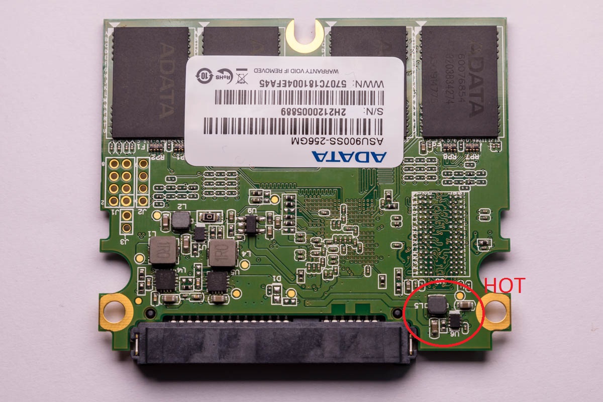

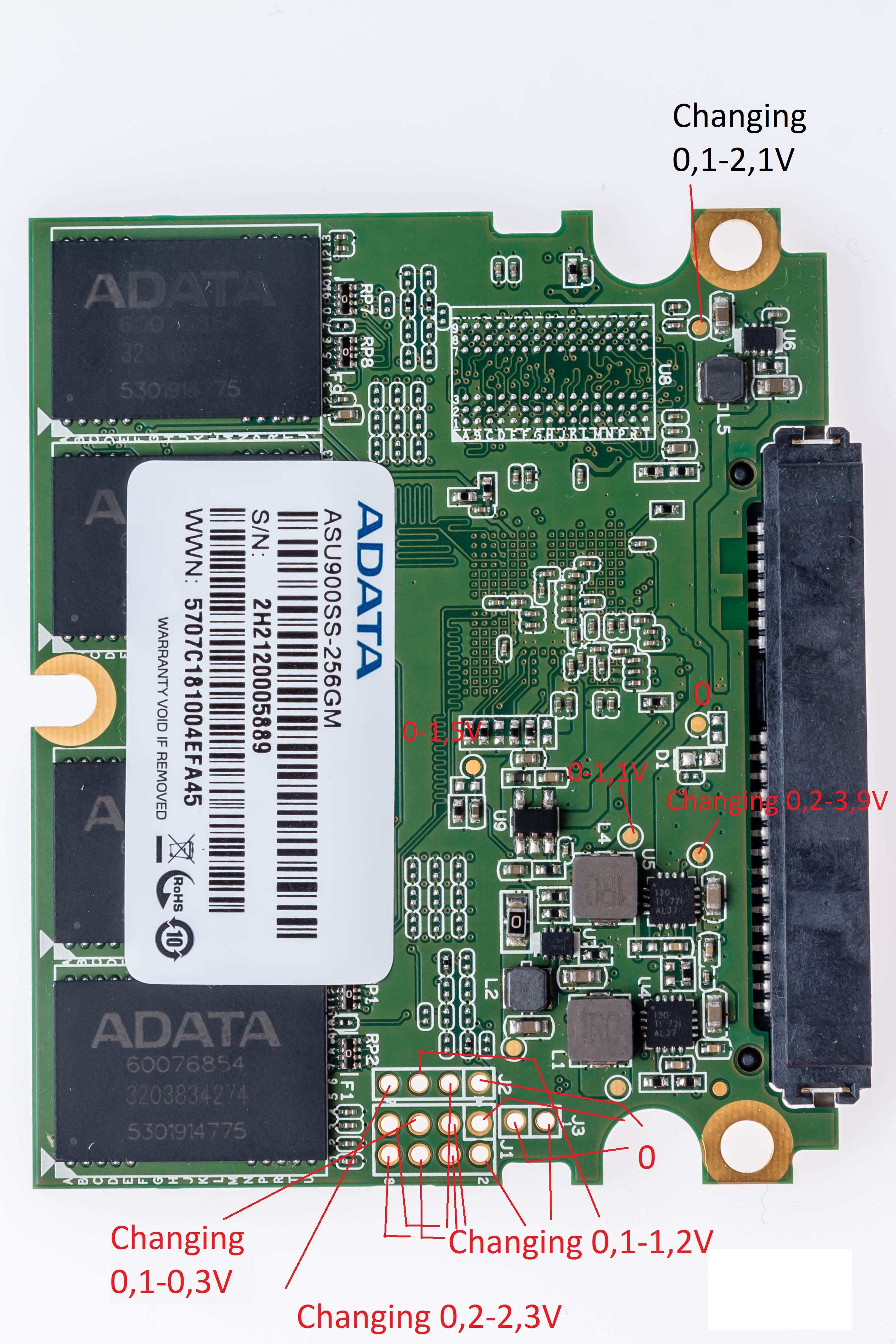

I have disk ADATA SU900. Customer said that was some power issue with computer and after that two disks from computer stopped working. One of them is SU900. So at the moment disk when I connect to PC3000 then I have only BSY state which little blink strong green with bright green.
Another symptom is when I connected disk using USB convener when sometimes disk is recognized in windows and showing partitions. But after about 1-2 seconds disappeared. Using USB: controller and another some component are very hot. When I connected disk only to sata then isn't so hot .
Could you help me where I should find problem?

@lasek, the voltage test points have already been dotted and circled for you (thank you Adata). Can you measure these?
Also measure the +5V supplies produced by your PC3000 card and USB "convener". Presumably your PC3000 card reports the current draw (as already stated by @arvika). Note that the PSUs which are supplied with USB enclosures are often poorly regulated. In your case the SSD draws no current from the +12V supply, so the +5V rail of a dual-voltage PSU may be significantly higher than 5.0V
The only chips whose markings I can see (from an alternative source) are U10 and U3. U3 is a protection device. It should have protected the SSD from overvoltages or reverse voltages. :?
The controller is a Silicon Motion SM2258H-AB.
Can you tell me the markings on the remaining Ux ICs?

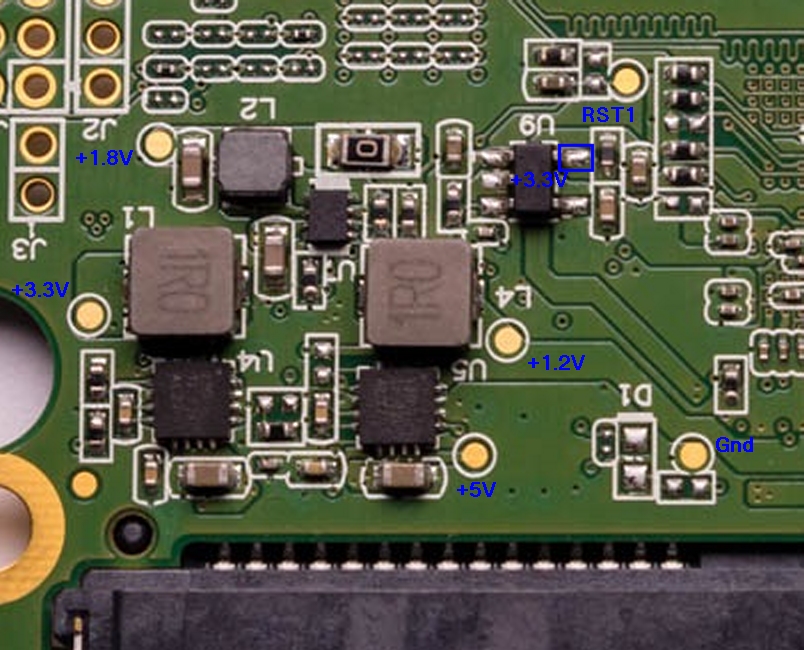

Here is a similar (but not identical) PCB:
https://elchapuzasinformatico.com/2017/04/adata-su900-review/
https://elchapuzasinformatico.com/wp-content/uploads/2017/04/Adata-SU900-08.jpg
https://elchapuzasinformatico.com/wp-content/uploads/2017/04/Adata-SU900-09.jpg
The voltages are marked.

Thank you. At the beginning my PC-3000 show disk in BSy state with blinking now show only error.
I measured some points. In each points current is not constant and changing.

@lasek, IIUC, PC3000 monitors the current (amps or milliamps) drawn from the +5V and +12V supplies on the PC3K card.
I don't understand why the voltages are not constant. Is the +5V supply also cycling on and off?
By "Ux ICs" I mean U3 - U10.

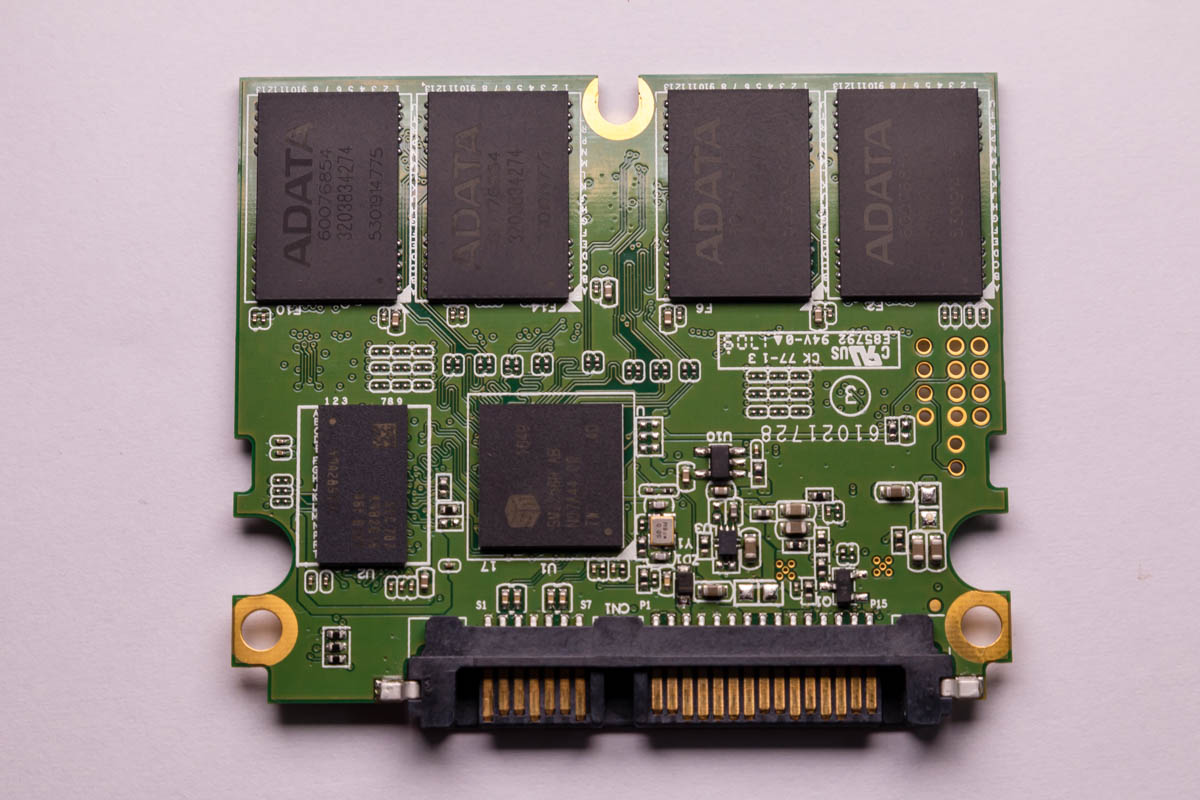

These are my guesses based on a similar PCB.

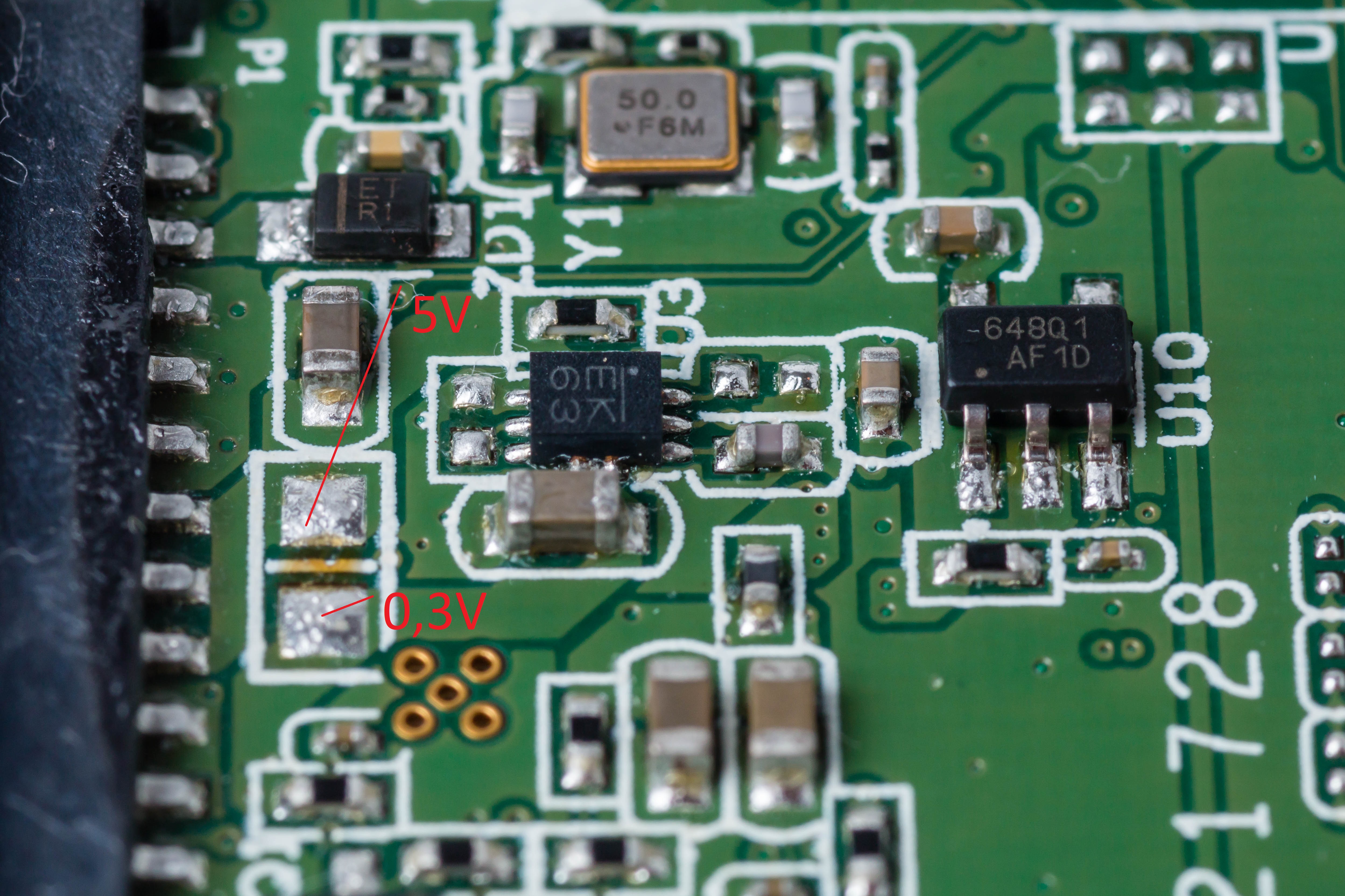

On Vin I have 5V but on Vout I have only about 0,3V. Also now I have different value then I measure before.
I Have to take good photos to check name U3 and U10.

I took beter picture where see name component U3 and U10.

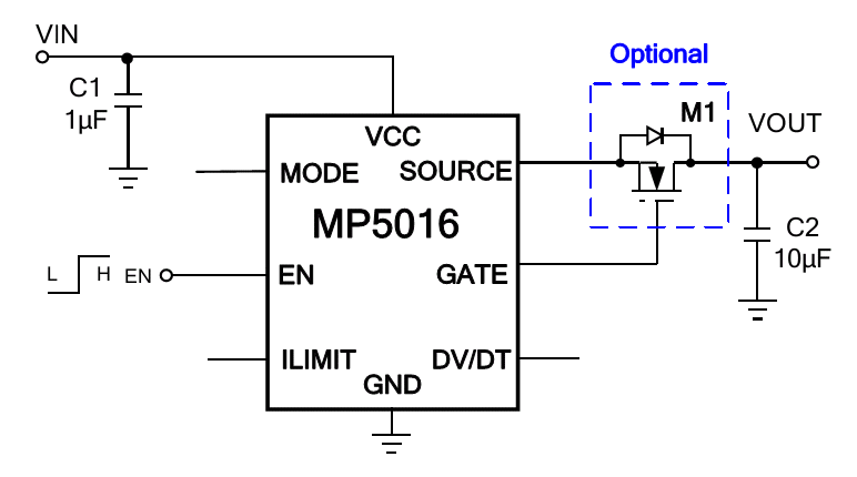

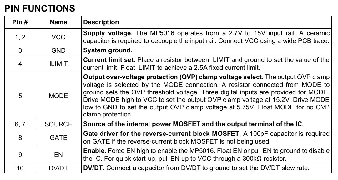

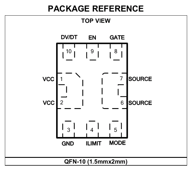

The EK part (U3, MP5016) is configured with a 2.5A current limit. ISTM that this current limit is being reached by the circuit, thereby causing U3 to shutdown. I would measure the resistances between ground and each of the marked voltage test points.
Datasheets for OP's SSD and for similar SSDs found in Internet searches:
MP5013A, Monolithic Power, 5V, 5A Programmable Current-Limit Switch with Over-Voltage Clamp and Slew-Rate Control, 3V - 5.5Vin, marking IAMKx, TSOT23-8:
https://www.monolithicpower.com/pub/media/document/MP5013A_r1.0.pdf
DMG6968U, Diodes Inc, MOSFET, n-ch, 20V, 6.5A, marking 2N4, SOT23:
https://www.diodes.com/assets/Datasheets/DS31738.pdf
EUP7913A-33VIR1, Eutech Microelectronics, 3.3V, 300mA LDO regulator, 2.5V - 5.5Vin, marking AF1H, SOT23-5:
http://www.bdtic.com/datasheet/EUTECH/EUP7913_EUP7913A.pdf
EUP7913A-18VIR1, Eutech Microelectronics, 1.8V, 300mA LDO regulator, 2.5V - 5.5Vin, marking AF1D, SOT23-5:
MP5016, Monolithic Power, 2.7 - 15V, 0.7 - 5A, Current Limit Switch with Over-Voltage Clamp and Reverse Blocking, marking EK, QFN10:
https://www.monolithicpower.com/pub/media/document/MP5016_r1.0.pdf

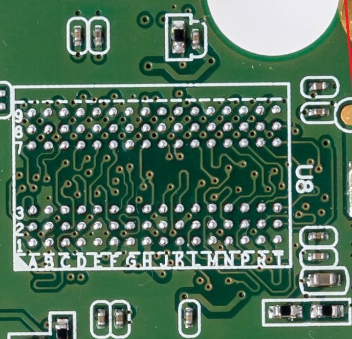

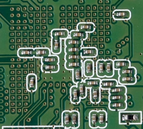

Measure the resistances of the bypass capacitors (inside rounded white rectangles) on the underside of the controller and SDRAM.

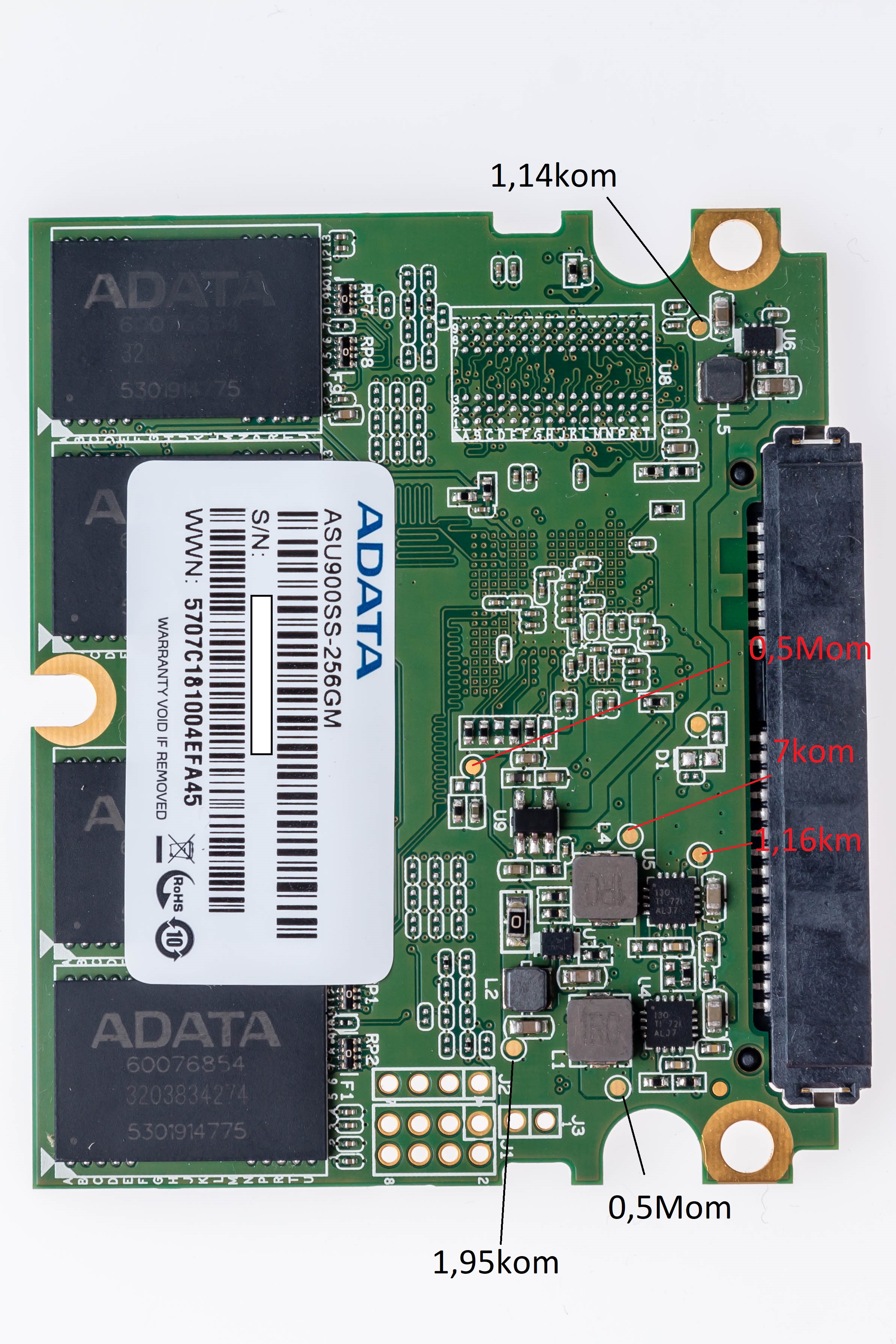

I have measures resistant between marked points.
 Post subject: Re: power problem ADATA SU900
PostPosted: August 4th, 2018, 17:47
Posts: 17101
AFAICT, there are no abnormal resistances. :?
I would focus on U3 and U6. I would determine whether the output of U6 (+1.5V) connects to the controller or SDRAM or both. To this end I would test for continuity between the +1.5V test point and each of the aforementioned bypass capacitors.
