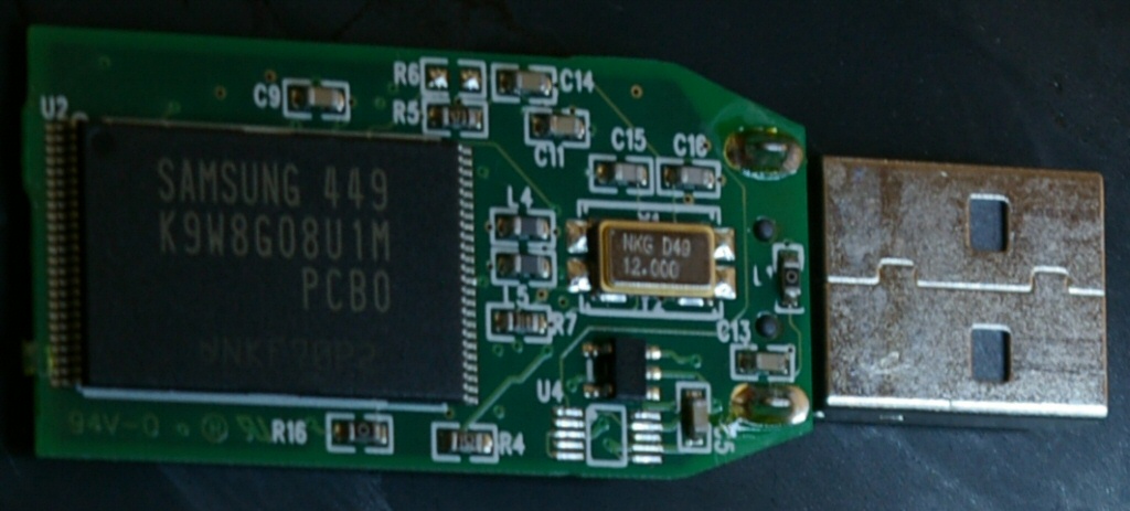

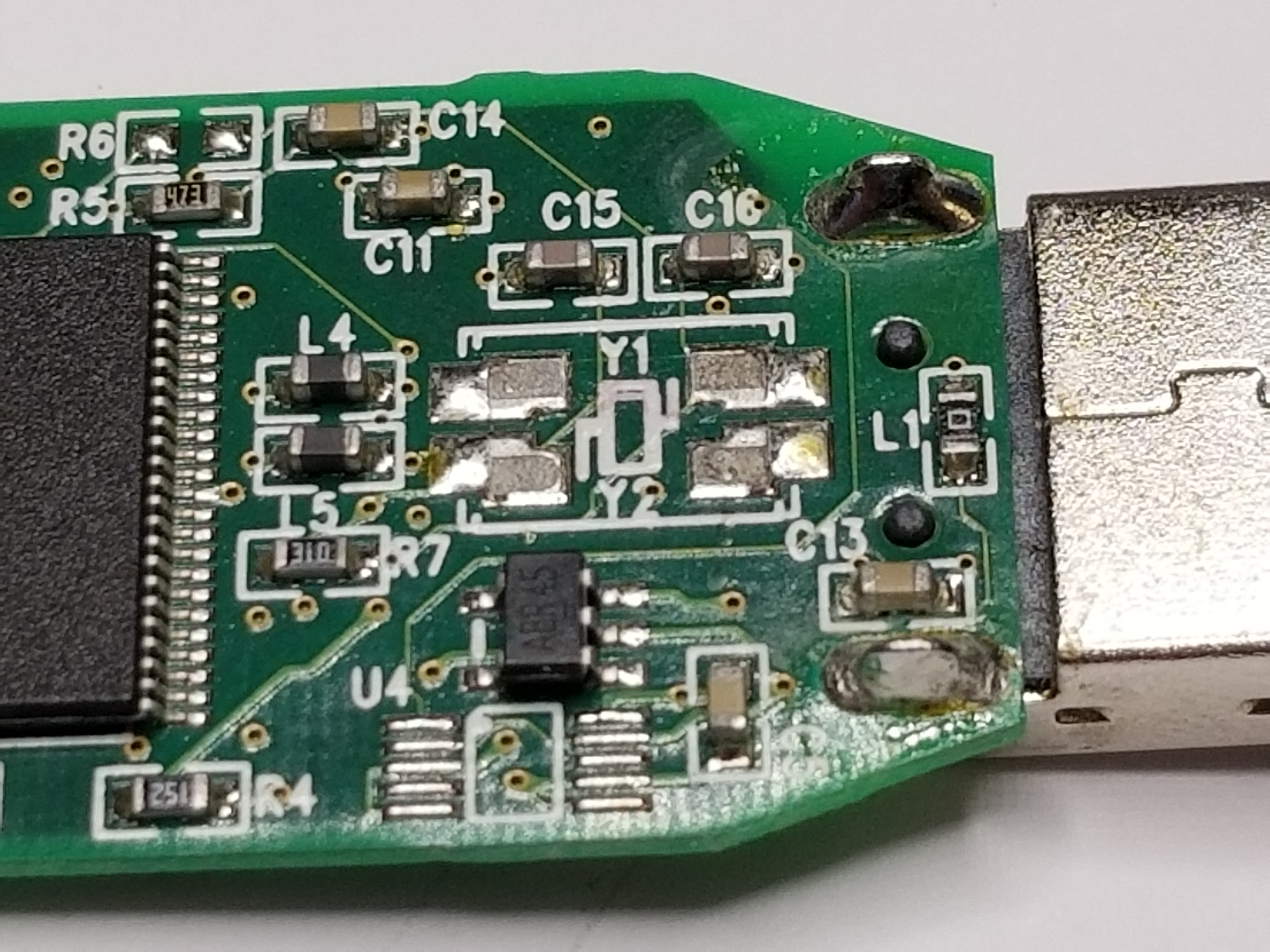

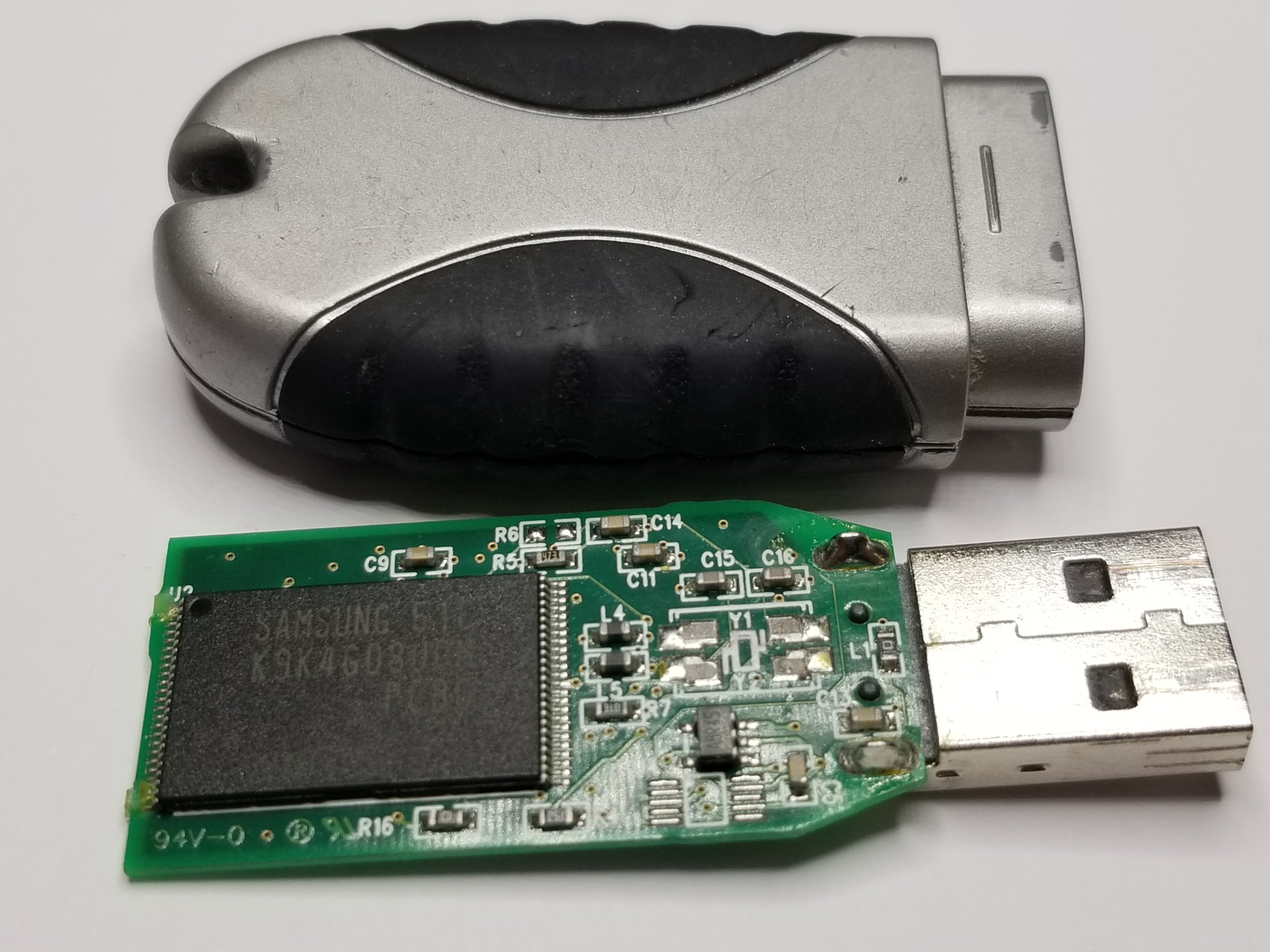

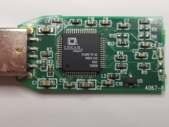

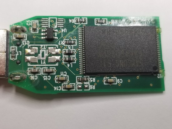

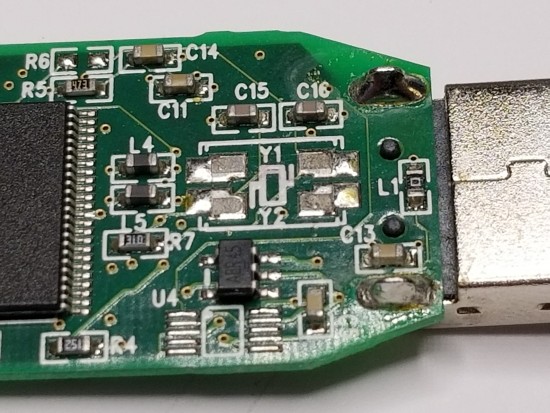

Had one of these in for the first time. I can see it has the crystal missing. I have tried searching for a donor on eBay and Amazon but can't find one. Anyone have the same board you can send me details of the crystal so I can try to match it?
Many thanks

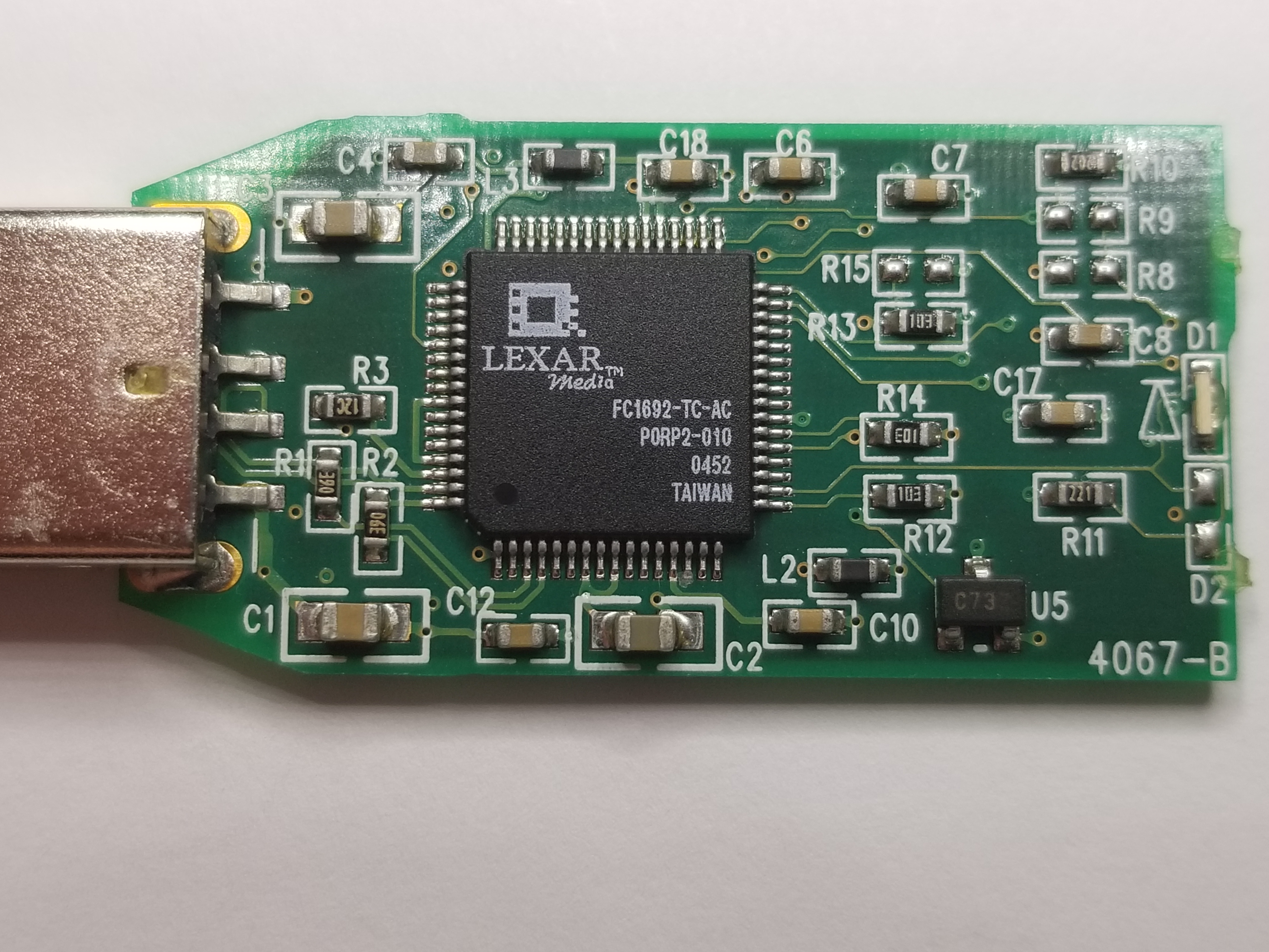

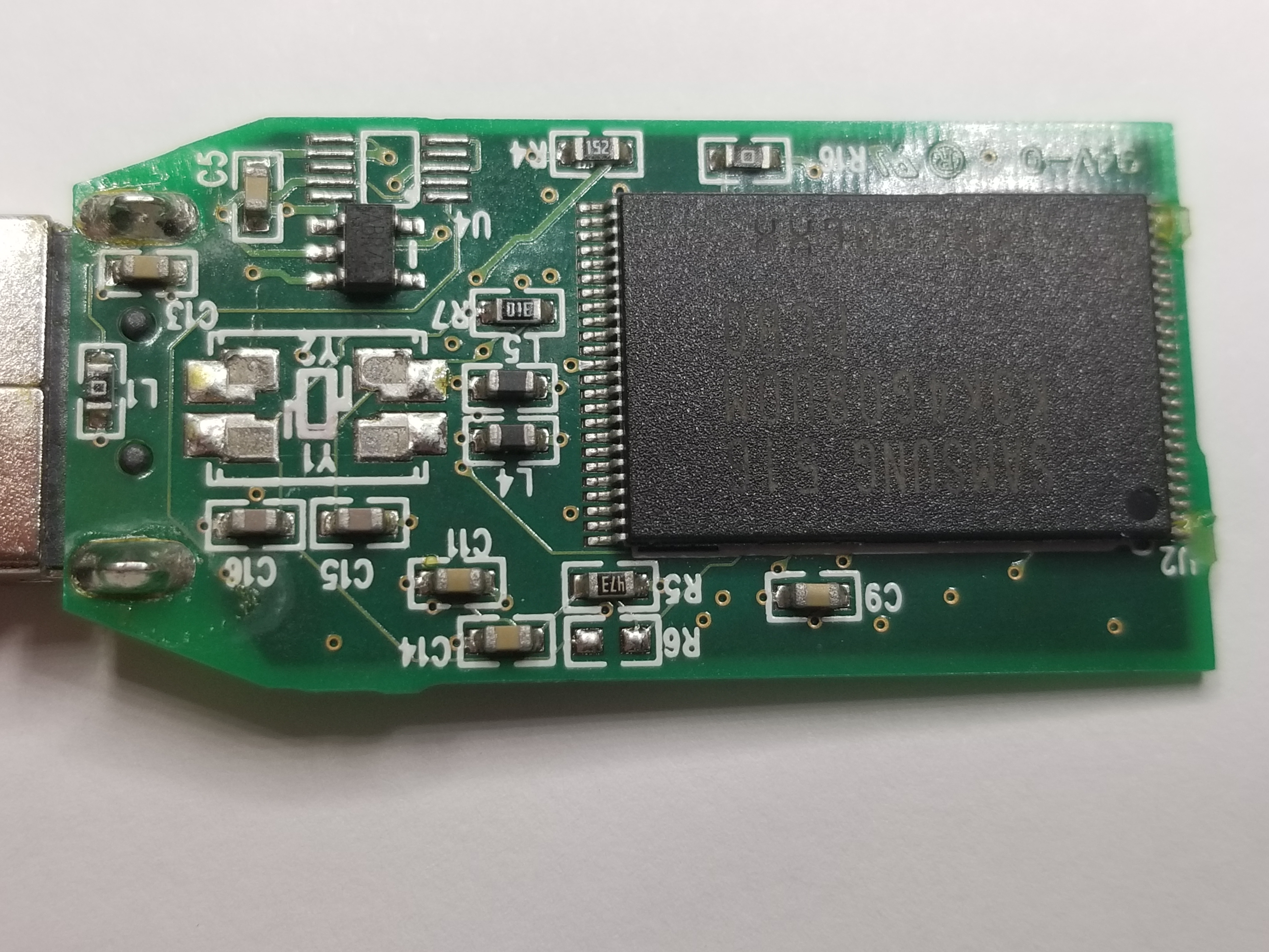

Well I consider myself admonished for not sending a full shot of the board which I apologize for :shock:, but I was just asking for information on the crystal if anyone had a donor just for simplicity sake. I have attached a full picture of the board, but it is just the crystal we need for the time being. AFAIK there are no other problems. I also have no idea how to match a crystal to a controller?
Blizzard wrote:
We store donors by controller manufacturer + storage capacity if you want to add that info.
Controller is Lexar FC1692-TC-AC
I could of course do a chip off, but don't want to mention that yet for fear of further admonishment :wink:
You appear to lack a basic understanding of electronics. Essentially you have asked the wrong question.
A particular flash controller will normally be optimised for a specific crystal frequency. Therefore we would need to know the identity of the controller before we would be able to suggest a suitable crystal. It may very well be that your Lexar FC1692-TC-AC is used in other PCBs, not just your lonely example.

chip off shouldnt present a problem in this case. If you are careful removing NAND, you could always put it back on.
I would be very surprised if you find any documentation on the controller to be able to use to match it. Flash drives usually use 12MHz.
Often you repair any electronic issue you find but drive still doesnt work. By now you could have unsoldered NAND, read chip, found if supported by tools, and soldered back on.
just find any 12.000 with similar footprint from an older drive and try it. I think these are rebranded Silicon Motion controllers, SM321 or 324. Usually no XOR and either no mix or very simple.

I hear the voice of reason.... I did find a 12MHz crystal and the data is saving off now. This forum can be cruel as well as extremely useful. You get admonished for doing chip offs instead of testing the board, when you do test the board you get admonished for not knowing enough, while all the time just trying to protect the clients data.

As for your recent pics, they tell us that your flash drive was probably manufactured in early 2005 (the controller has a date code of week 52, 2004). The NAND appears to be a K9K4G08U0M (512M x 8 Bit / 256M x 16 Bit). All of this information, including the identity of the controller, should have been provided in the original post. Surely that's obvious?

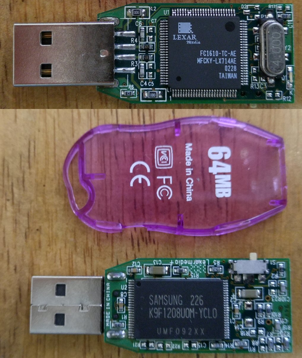

Sorry! It's an old 64MB. Isn't it a beauty though :)

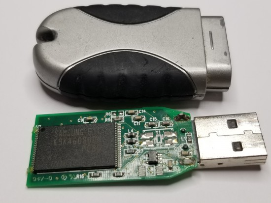

Late to the party, but here is that flash drive :)
It was a 12MHz crystal.

Many thanks for sticking with this. We did get the data back with the 12MHz crystal.
