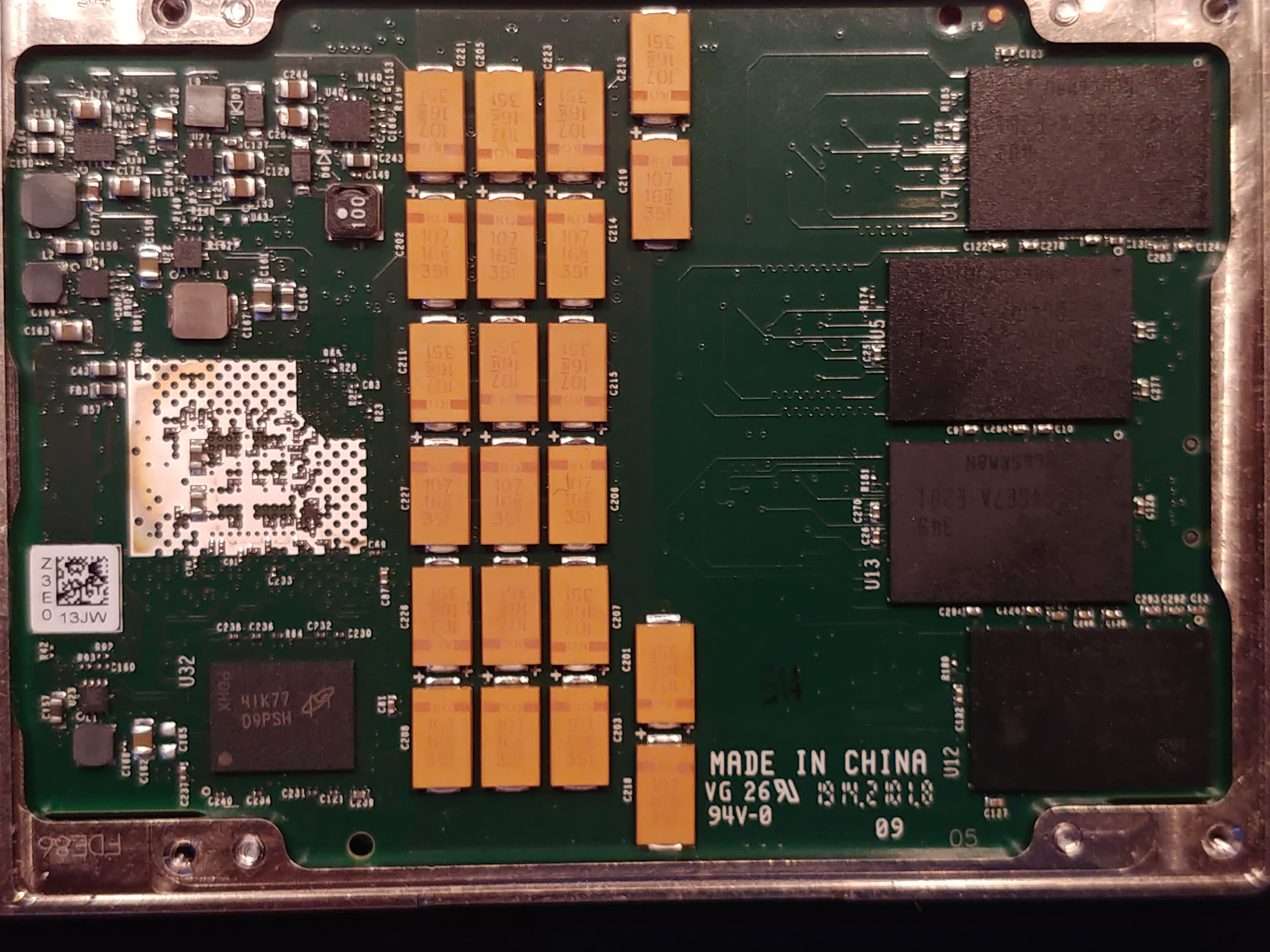

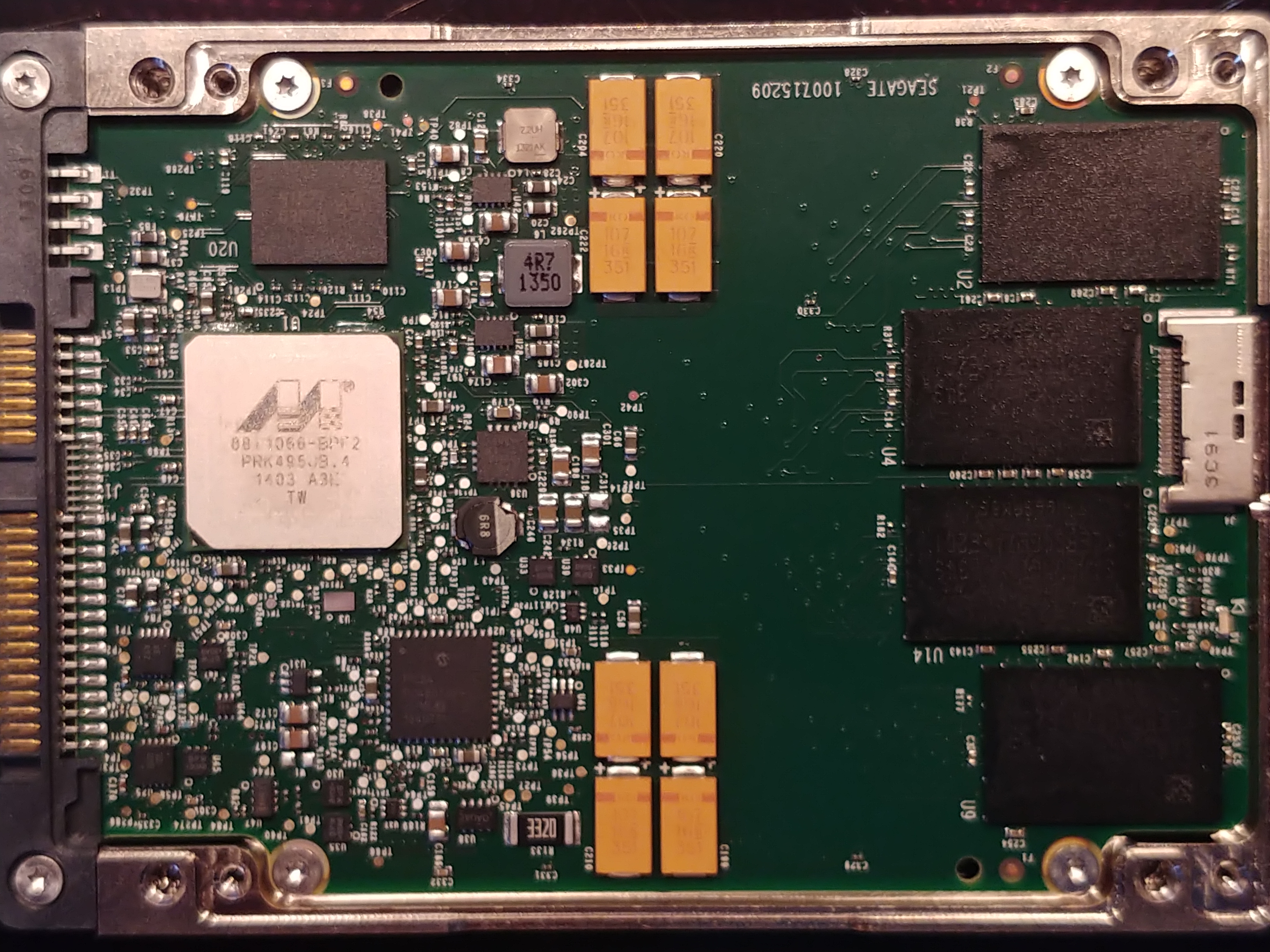

Hereby the images. I don't see any jumpers; and I don't see serial controller chip next to serial interface, unless it's in controller itself. On the first slide you can see unknown front connector.
 Post subject: Re: Seagate SAS SSD (ST200FM0053) - how to get diagnostic mo
PostPosted: March 12th, 2018, 16:39
Posts: 17335
I can't see the IC markings in your photos. Do you have a CCD scanner (not CIS)?
In the absence of any better methods, would it make sense to disable the power to the NAND array? Would this cause the SSD to output a message to the terminal port? If this approach is of interest to you, we would need to identify the buck regulator ICs and measure their outputs. Then we could locate the corresponding bypass capacitors at the NANDs.

Nah, markings on IC are invisible; black on black, and it's so small that best camera zoom can't help and certainly not readable by eye.
Referring to your proposal - I can't do it, multimeter pins are too big and board is too tiny and my hands are too big LOL - not that I care about damaging SSD, it's 70% of life, so can't be used for cachecade (what I use them for).

So does anyone know what is this connector port on the opposite side of the sas data connector ? it looks like micro hdmi or something; I wonder is it diagnostics or some kind of expansion connector for SSD....
PostPosted: July 15th, 2019, 12:15
Joined: July 8th, 2019, 12:27
Posts: 162
Location: 中国大陆浙江省湖州市
That's the connector for the data center storage sequence.
