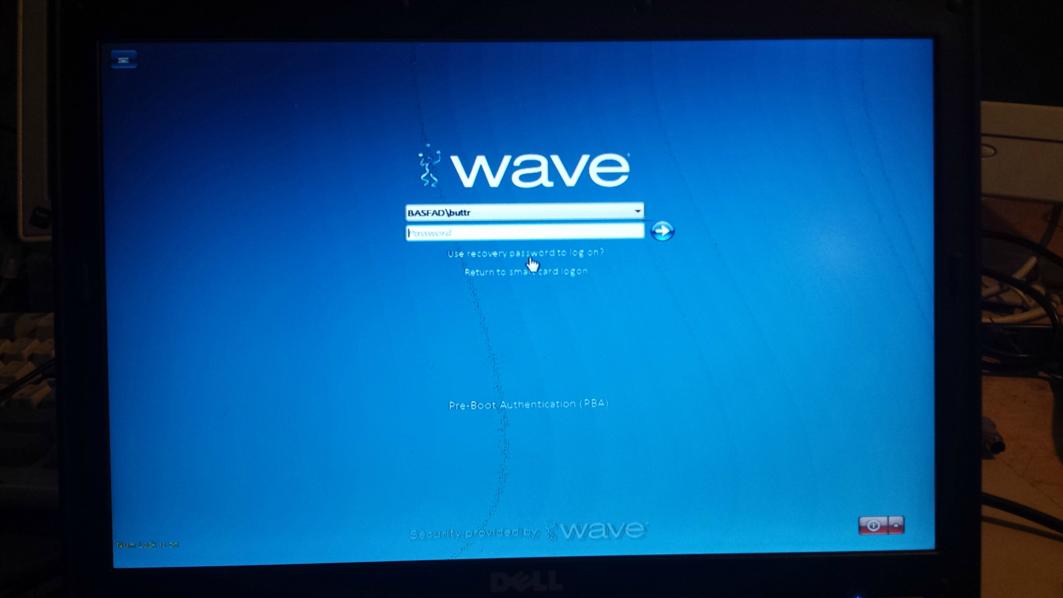

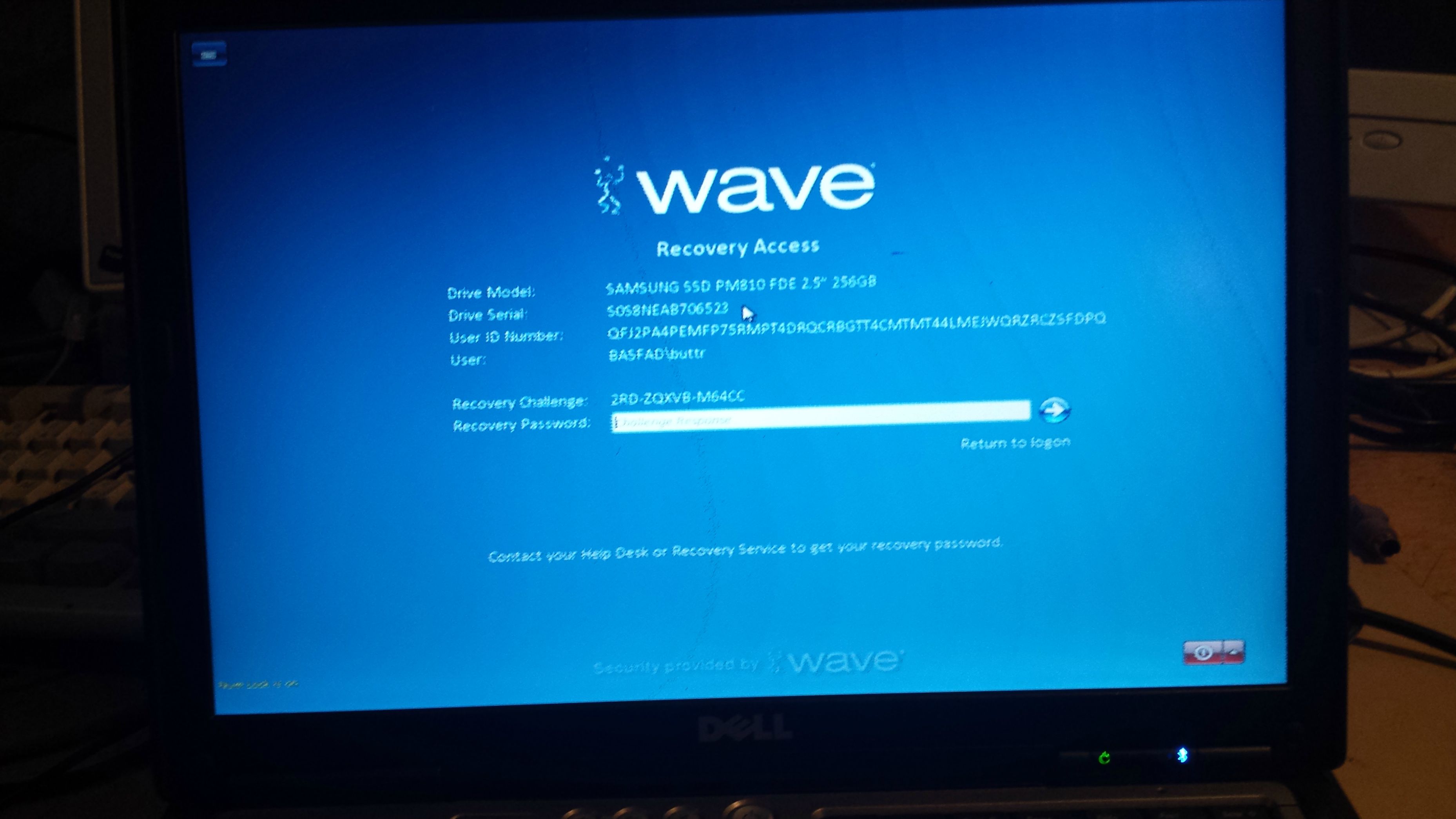

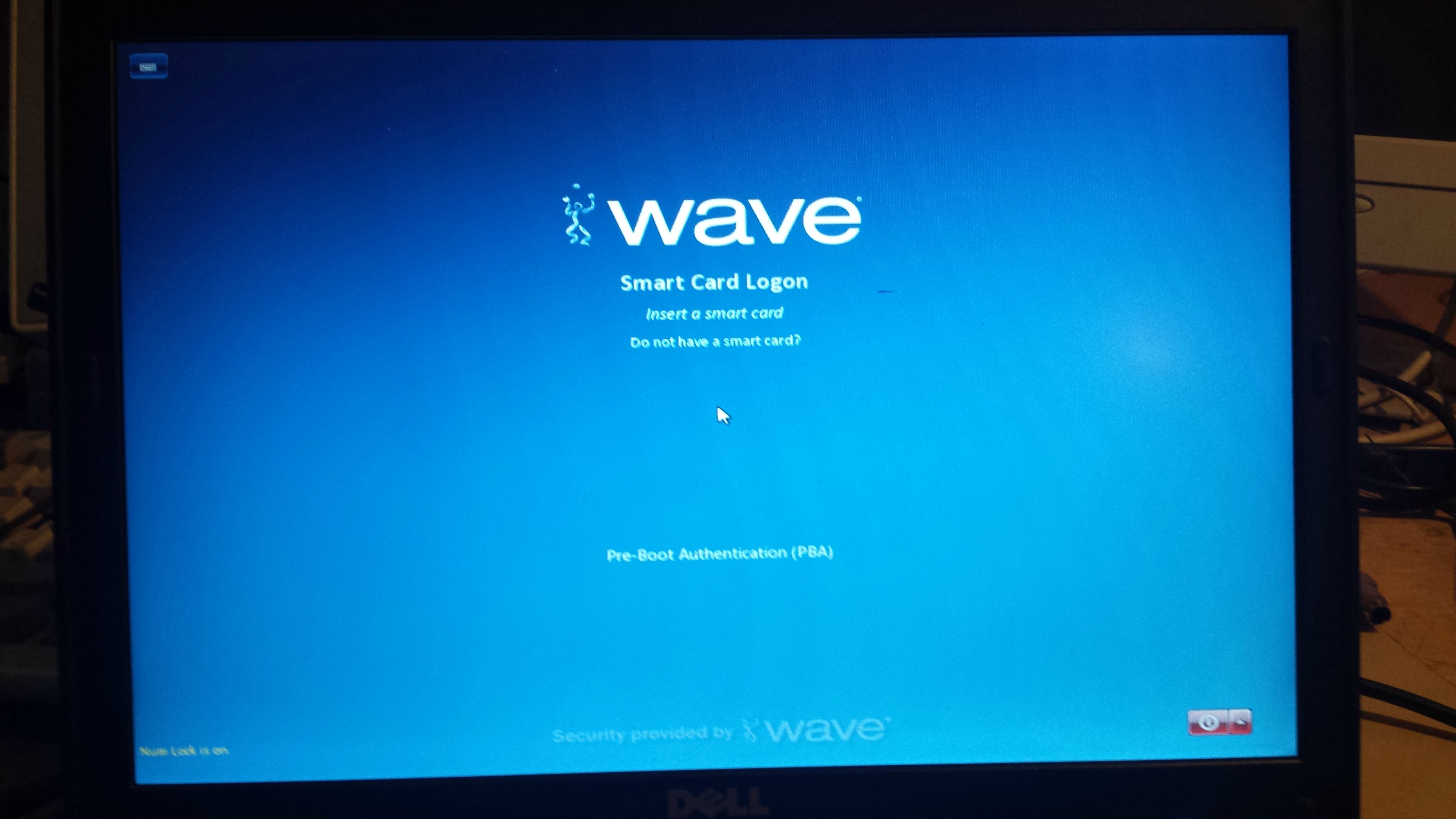

hi everyone ... i have SSD marque Samsung 256GB model: MZ-5PA2560/0D7
encrypted by Wave Smart Card ... if can be someone help me to unlock it
this is Pic of what i get when i put on desktop
SSD from DELL Laptop (idk which model)
PSID not printed on SSD

Customer does not know password?
Where is the laptop?
 Post subject: Re: Samsung SSD Smart Card Logon
PostPosted: October 23rd, 2014, 8:20
Joined: October 22nd, 2014, 17:05
Posts: 11
Location: SYZMA
i don't have the laptop
PostPosted: October 23rd, 2014, 10:51
Posts: 3975
This is working as designed. Contacting the IT dept of the company that this belongs to seems the way to go, you don't say if it is stolen, needs DR, the IT dept cant fix it, or other. I don't think someone is going to simply help break into a computer.

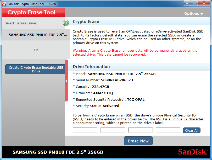

I have similar problem with bricked SSD drive. I know I have to do crypto erase(I dont care about data, I just want tu use my drive). Samsung PSID revert tool detect the TCG activated device but when I try to do crypto erase ask me about PSID. The drive is samsung ssd pm810 FDE and PSID is not located on drive. Is there some kind of universal samsung PSID number or another way to make drive usuable ?
PostPosted: October 24th, 2014, 5:20
Posts: 219
Interesting, usually drive has to be usable (with data lost) after security erase. FDE is a Seagate technology feature, so if this drive built by Seagate technology try to find update from Seagate.

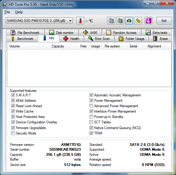

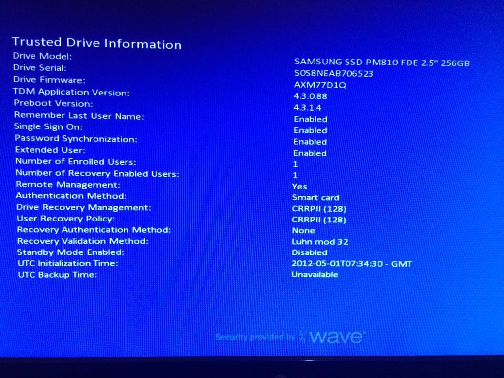

this my ssd info
PostPosted: October 24th, 2014, 11:02
Crypto Erase tool says "it is for Sandisk...". Should work on other SSDs as well?
PostPosted: October 24th, 2014, 11:56
Joined: October 24th, 2014, 4:56
I've read some docs and this apps(Sandisk, Samsung, Dell Protection.., Wave ESC) should work on all OPAL based security drives.
Issue is that we don't have PSID required to perform this Crypto Erase function.

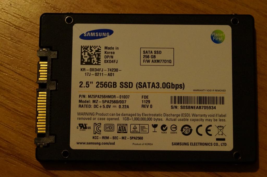

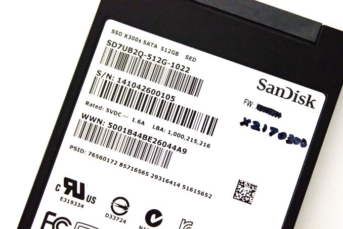

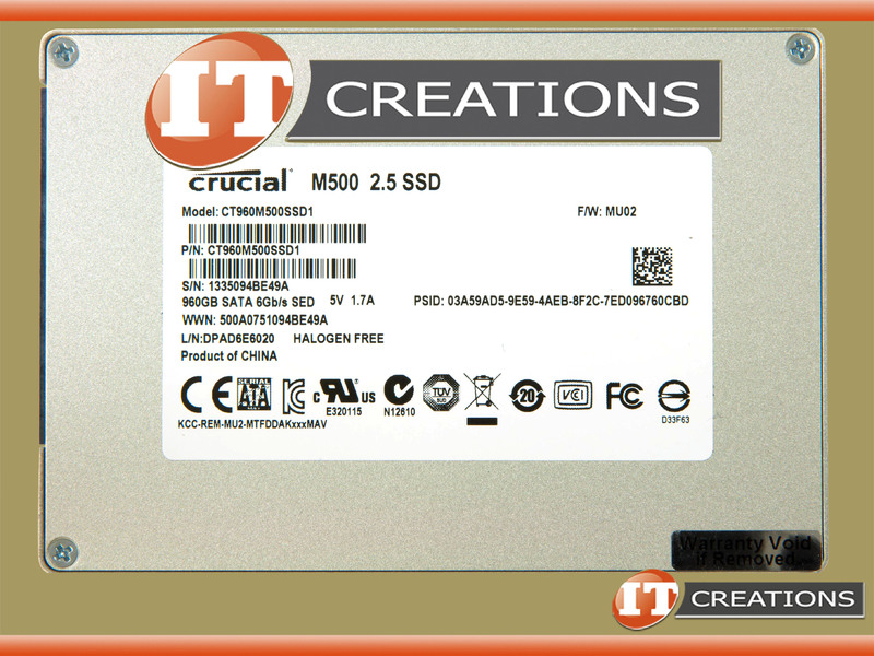

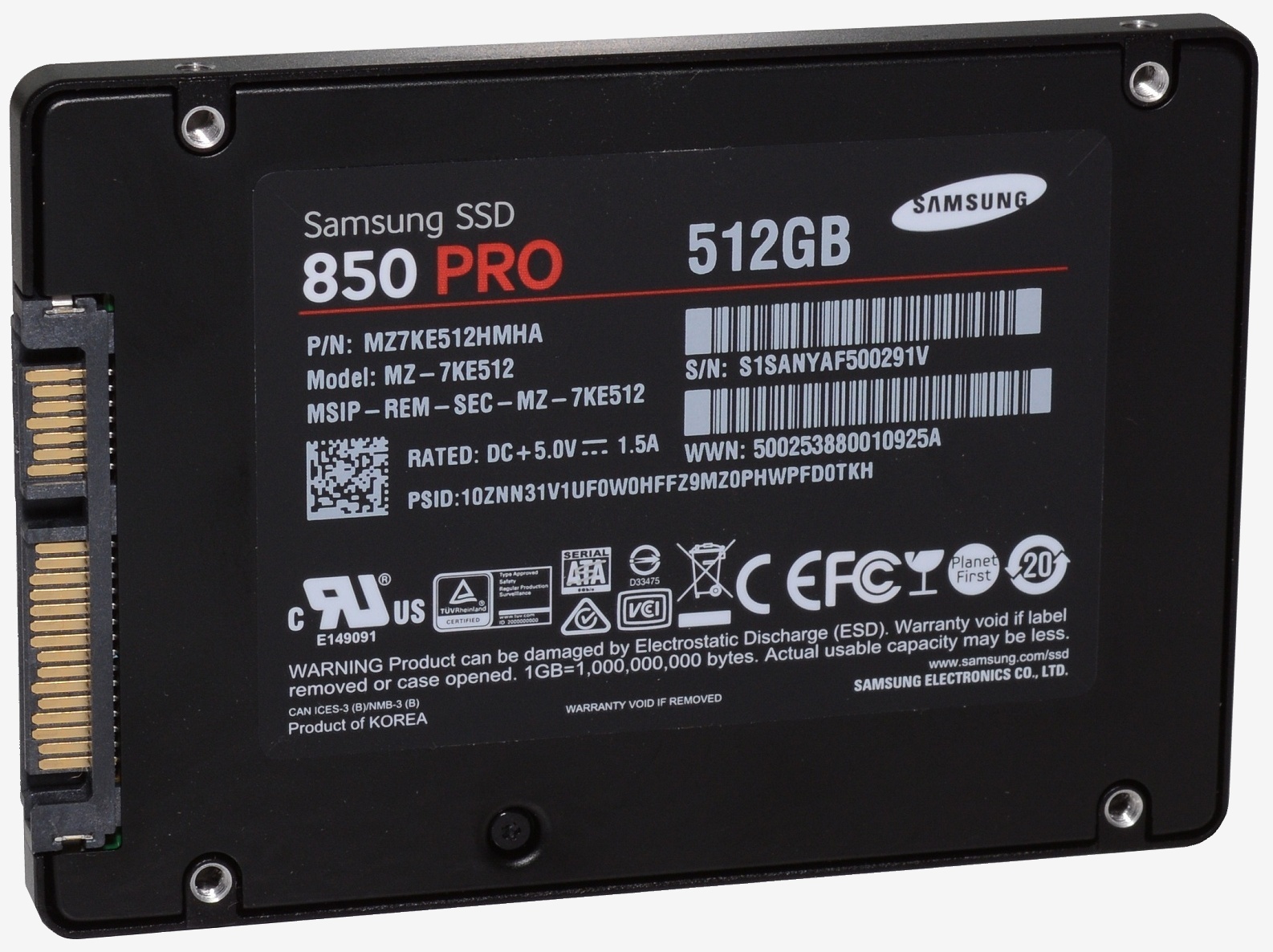

Just finded few photos of drives with PSID and one is pm810 without PSID.
File comment: Samsung pm810
File comment: Crucial M500
File comment: Sandisk X300s
File comment: Samsung 850

Wave contact me for some info
i got this picture from SSD after Boot using "Ctrl+D"
about PSID i use some but with no luck

i read something on Lenovo forum
that PSID maybe print it like 2D Barcode
with no luck i scanned all the Barcode .....
