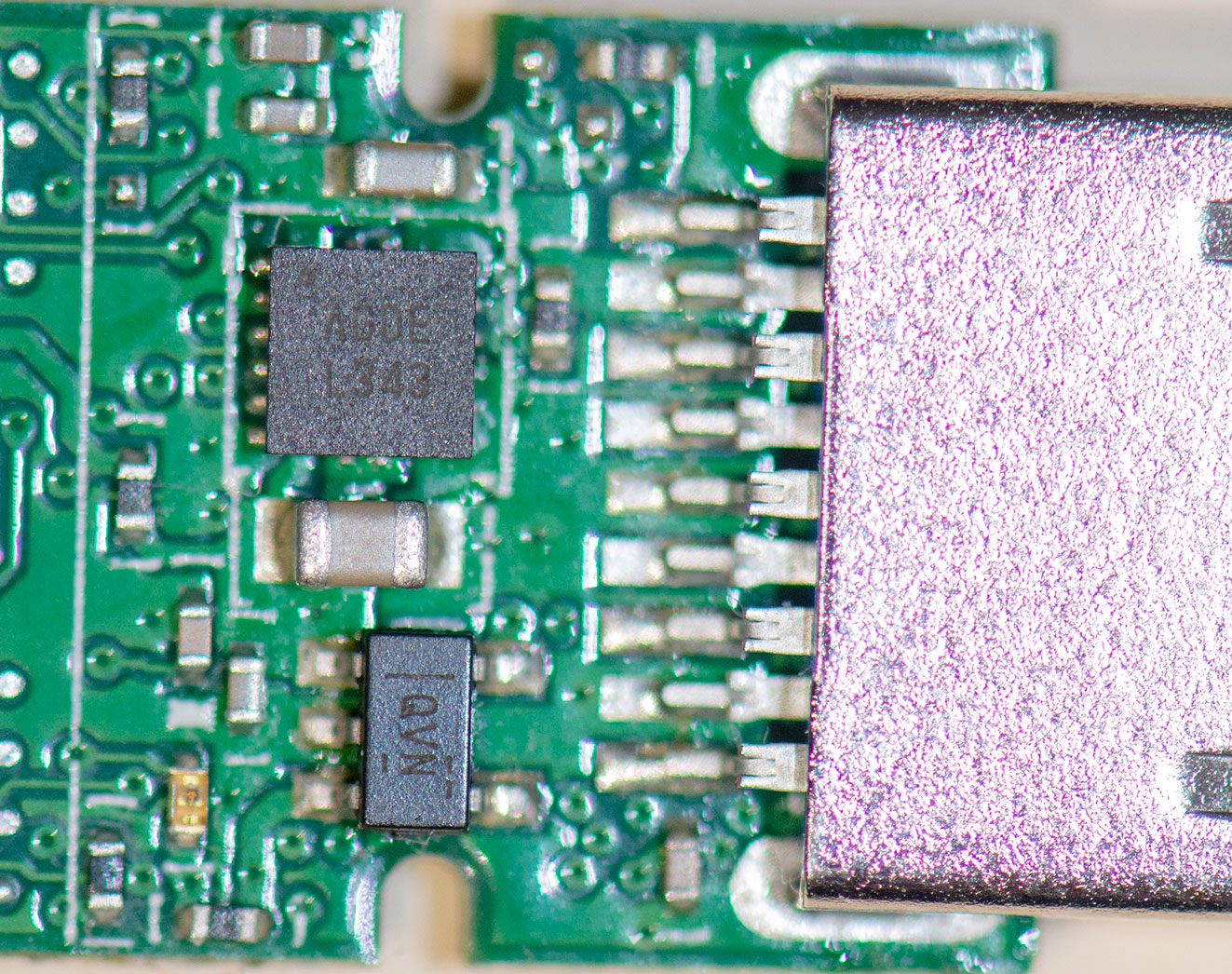

 Post subject: What is this component (L343)? and NAND ID = 89A825CBA9
PostPosted: September 16th, 2018, 11:41
Joined: July 30th, 2012, 3:37
Posts: 314
Location: Fairfield, CT USA
I got an unusual PNY 128GB flash drive today, it has a component I've never seen before, a chip labeled.
AGDE
L343
The package dimensions are 6x2
None of the components have failed, I recognize the LDO right away, I'm not looking to do down that path, just identify this component.
The controller is IS903.
Also the NAND chip is interesting
NAND Reader ID: 8 x 89 88 24 4b (8GB) = 64GB
Controller ID: 4 x 89 A8 25 CB (16GB) = 64GB
I've seen SanDisk/Toshiba switch manufacture IDs (45/98) when IDing but NEVER an entire model/bank count.
By see, I mean with a logic analyzer, first ID = 45, second ID = 98.
Flash ID code:      89A825CB - Intel JS29F64B08HAMF1 - 4CE/Dual Channel [MLC-8K] -> Total Capacity = 128GB
Flash ID mapping table
[Channel 0]   [Channel 1]
89A825CBA900   89A825CBA900
Before thinking the controller ID code is erroneous, why would it return a valid NAND chip ID, much less one of the proper capacity?

 Post subject: Re: What is this component (L343)? and NAND ID = 89A825CBA9
PostPosted: September 16th, 2018, 16:29
Posts: 17335
The IS903 requires 1.2V (Vcore) and 3.3V (Vio) supplies. The "QVN" LDO regulator provides the 1.2V, so where is the 3.3V?
BTW, "343" could be a YWW date code, ie week 43 of 2013.
TLV70212DBVR, Texas Instruments, 1.2V, 300mA, Low IQ, LDO Regulator, marking QVN, SOT-23-5:
http://www.ti.com/lit/ds/symlink/tlv702.pdf
IS903, Innostor, USB 3.0 flash controller, Vcore = 1.2V, Vio = 3.3V, 30MHz:
http://www.innostor.com/file/Innostor_IS903_Specification.pdf
PostPosted: September 16th, 2018, 18:11
Posts: 17335
AFAICT, the "AGDE" component must be a 3.3V regulator, although I would have expected to see an inductor nearby (or on the underside of the PCB?). FWIW, other designs use an EML3020 switchmode IC (TDFN-6 package).
http://flashboot.ru/flash_recovery/2016/10/03/fix-innostor-hardware-problem.html
https://img.alicdn.com/imgextra/i4/2226666264/TB2_U._wm8mpuFjSZFMXXaxpVXa_!!2226666264.jpg
https://imagescdn.tweaktown.com/content/5/4/5481_07_adata_dashdrive_elite_ue700_usb_3_0_flash_drive_full.jpg
https://imagescdn.tweaktown.com/content/5/4/5481_08_adata_dashdrive_elite_ue700_usb_3_0_flash_drive_full.jpg

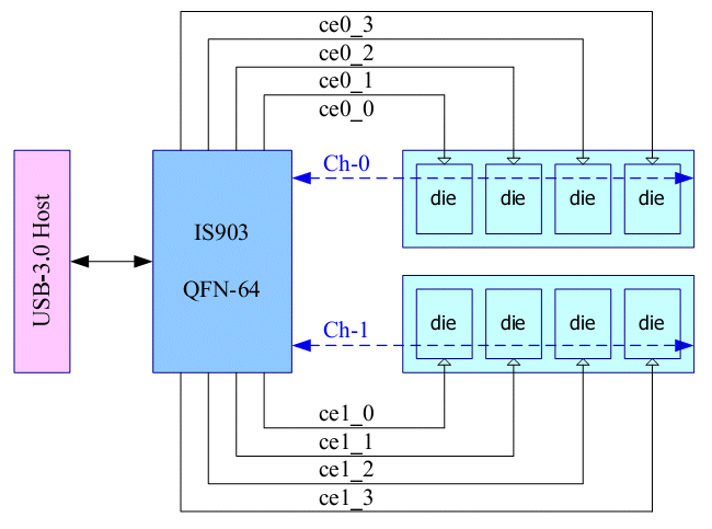

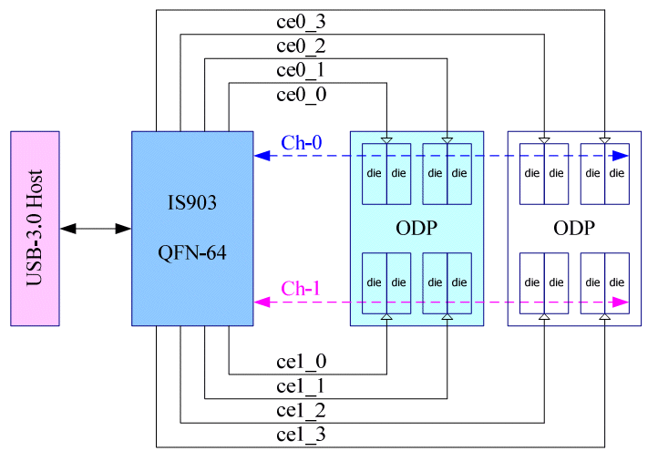

PostPosted: September 16th, 2018, 22:43
Posts: 4022
maybe they doing some funky stuff and "striping" channel 0 and channel 1 onto the same phy bank, and this is what NR is seeing (with some controller overlay or translation to lie about the ID. whereas the LA is seeing reality.
I am not 100% following whats going on either, definately a new way for PNY to be weirdo's
PostPosted: September 17th, 2018, 2:15
Posts: 17335
Does this help (from Innostor's datasheet)?
