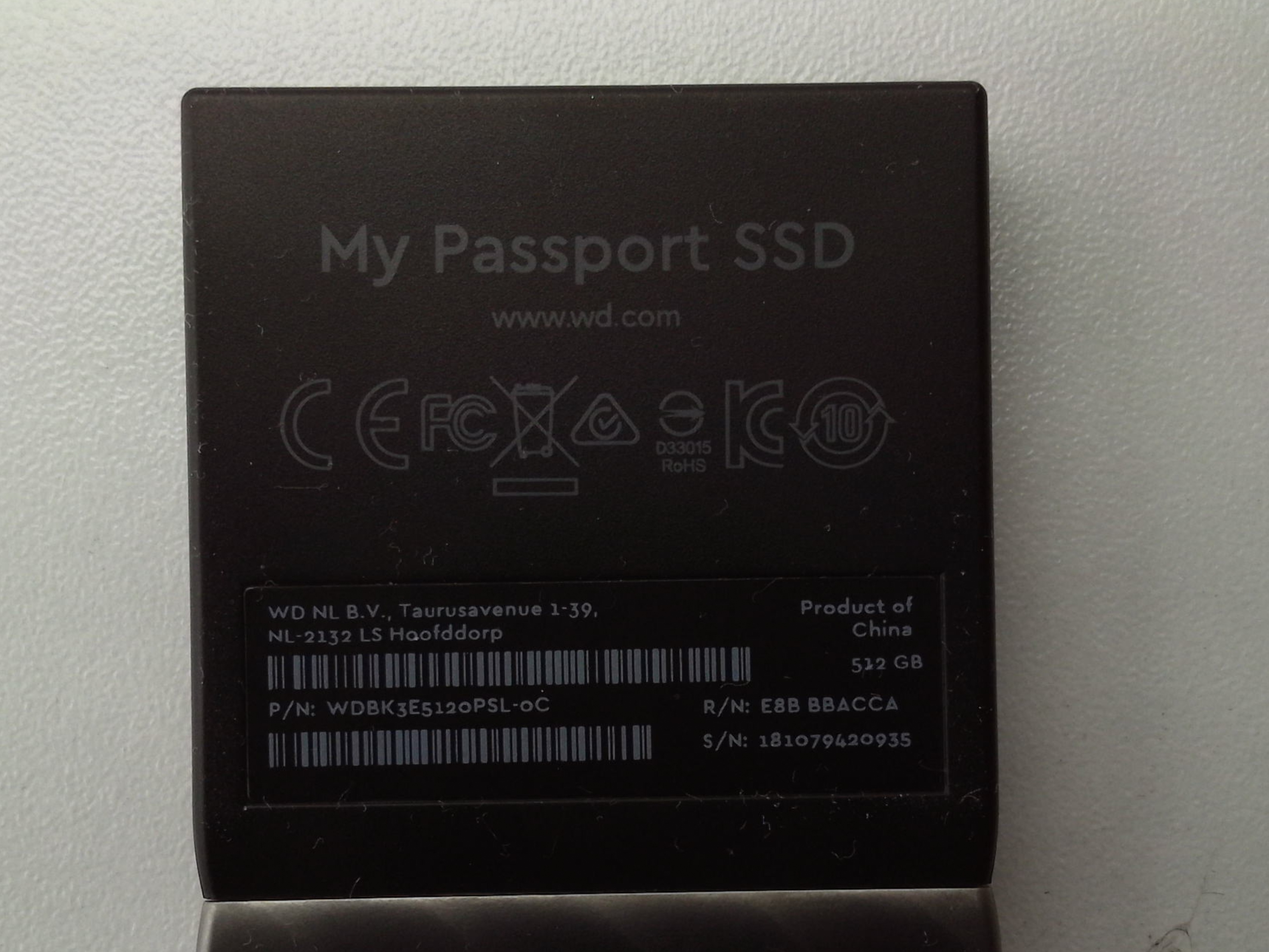

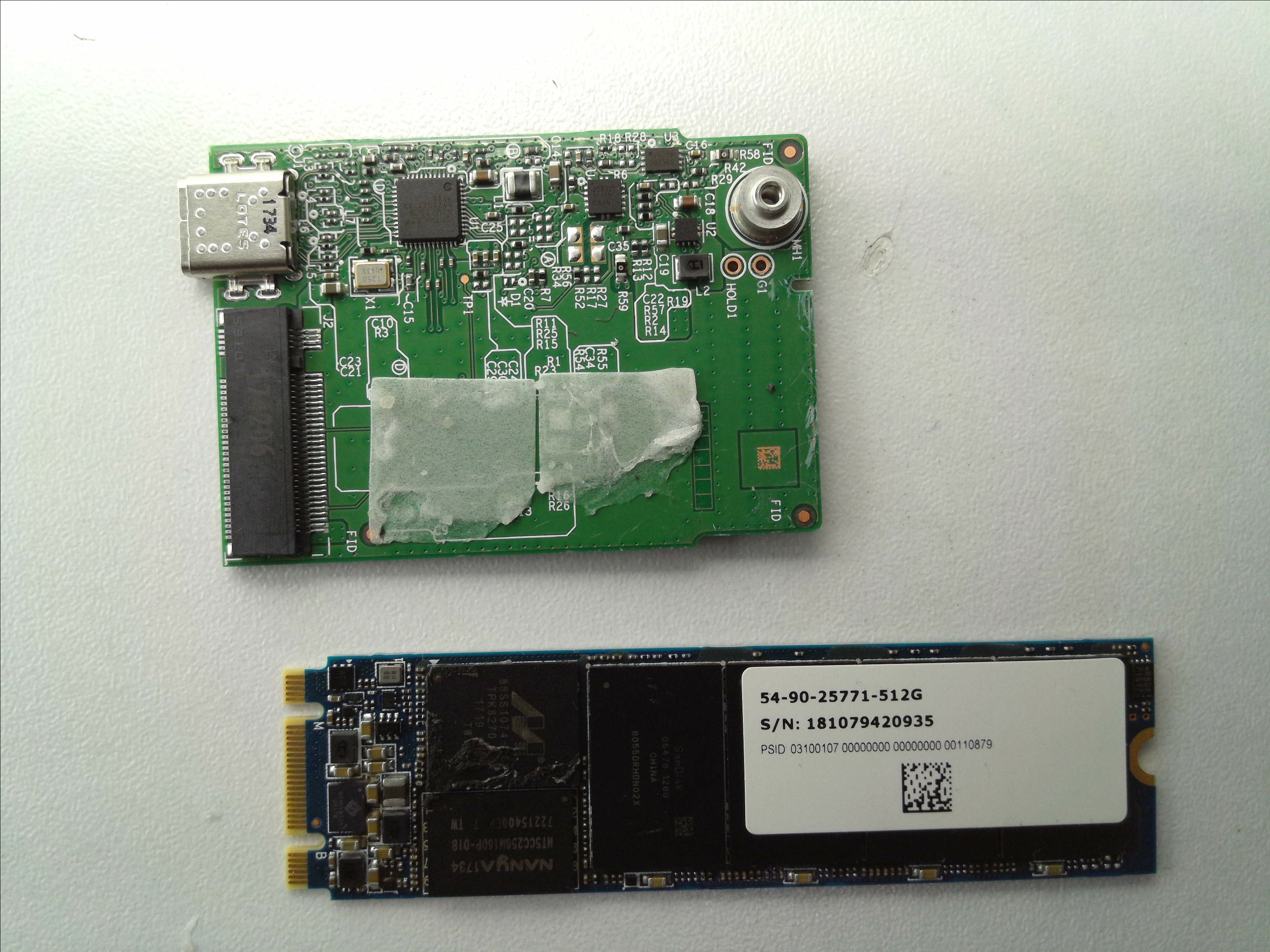

hello guys,

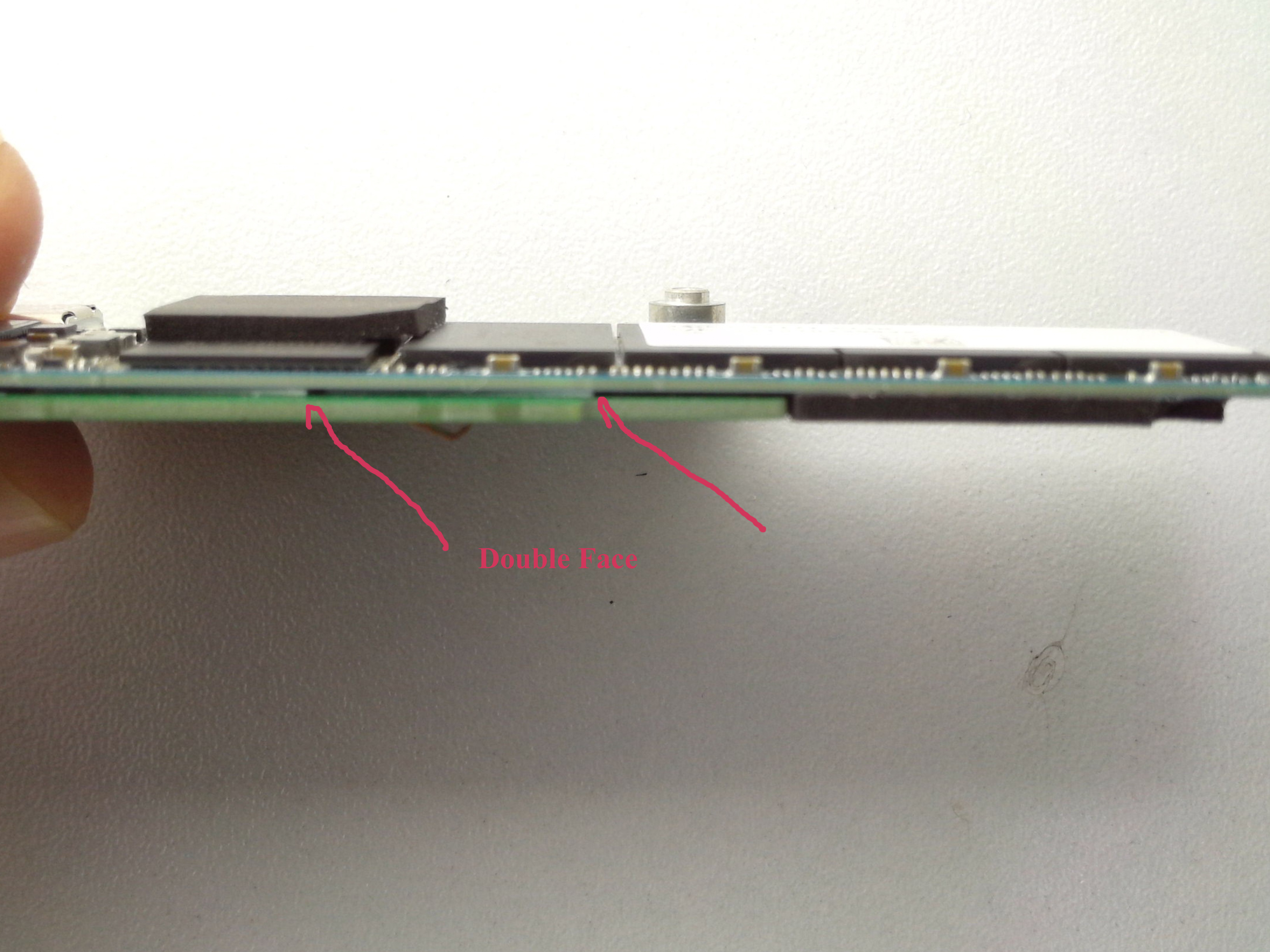

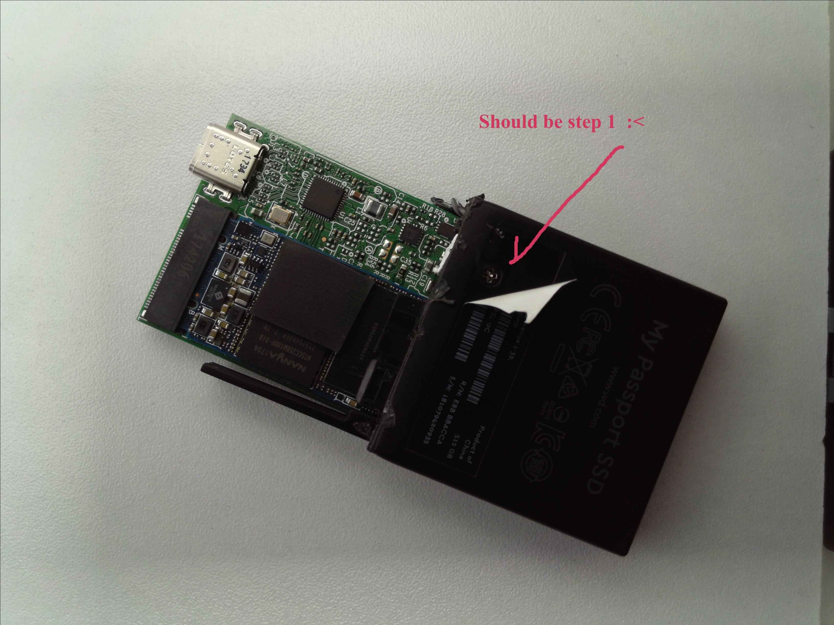

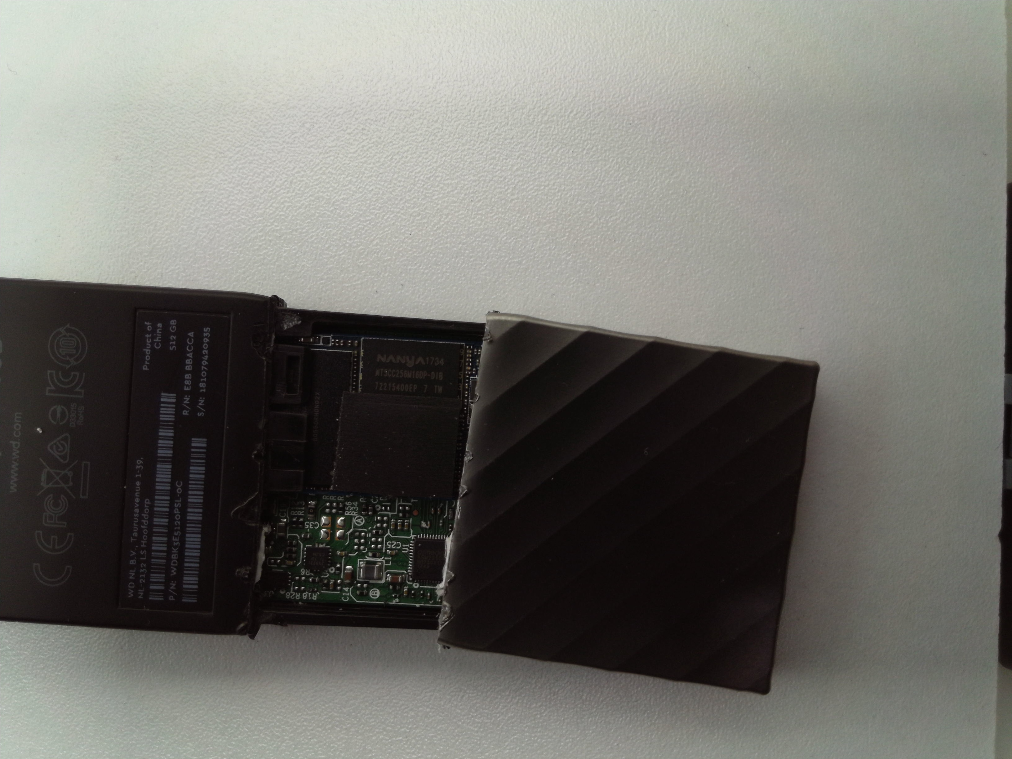

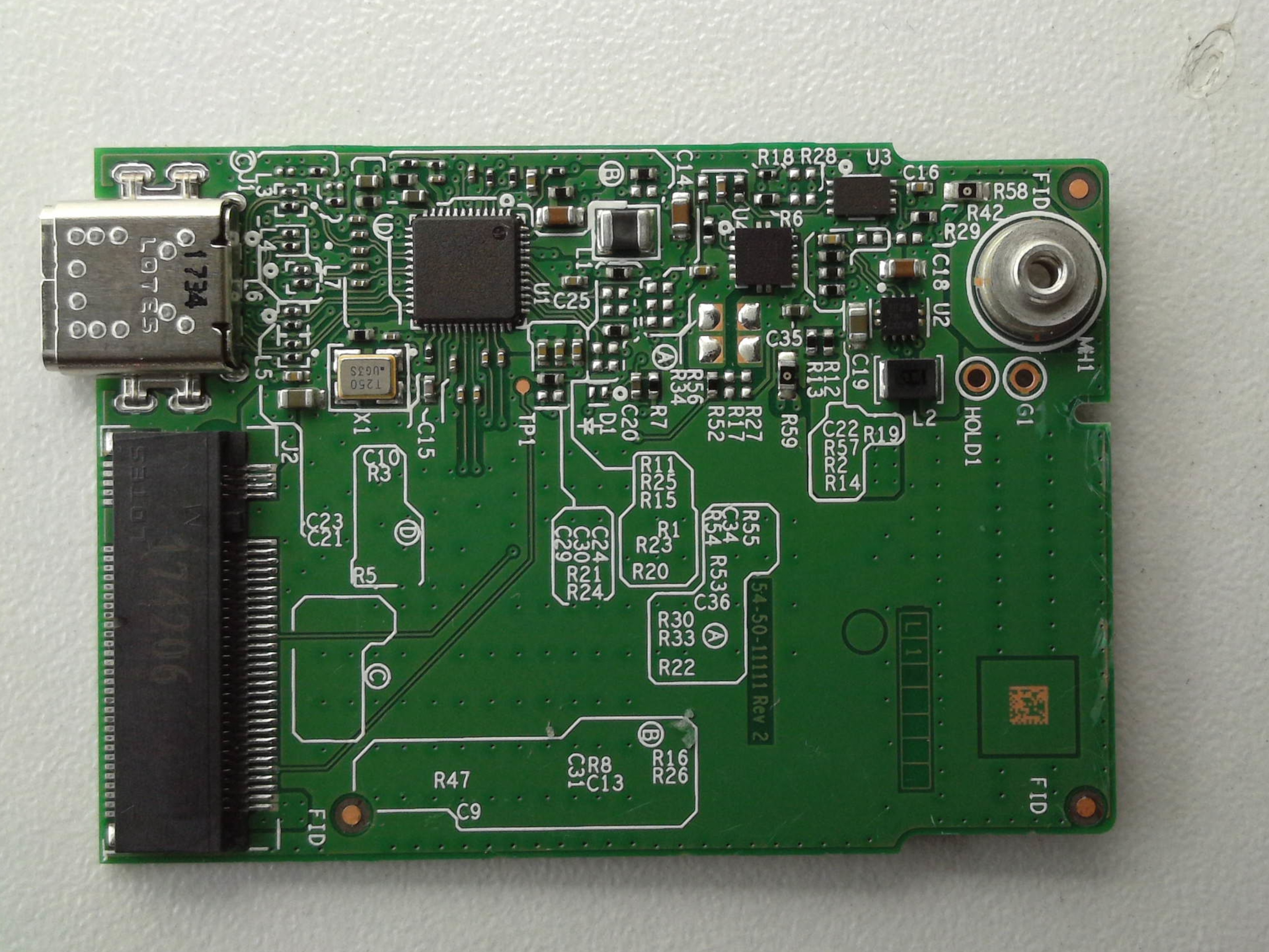

I was googling looking for someone disassembled this SSD cover but i could not find Any, so i decided to DI (Myself) the brutal way
after doing few mistakes i found the correct way of opening it which is presented here on those selected images.
Conclusion,
double face tape is holding this M2 which am trying to remove in a very gentle way to study the damn SSD Encryption and how the damn thing works.
hope this is useful for you guys..
have a good day :wink:
File comment: this is how it look like inside pcb
File comment: should be step1, learn from those silly mistakes
File comment: After the brutal wrong start
File comment: how it looks like fresh :>

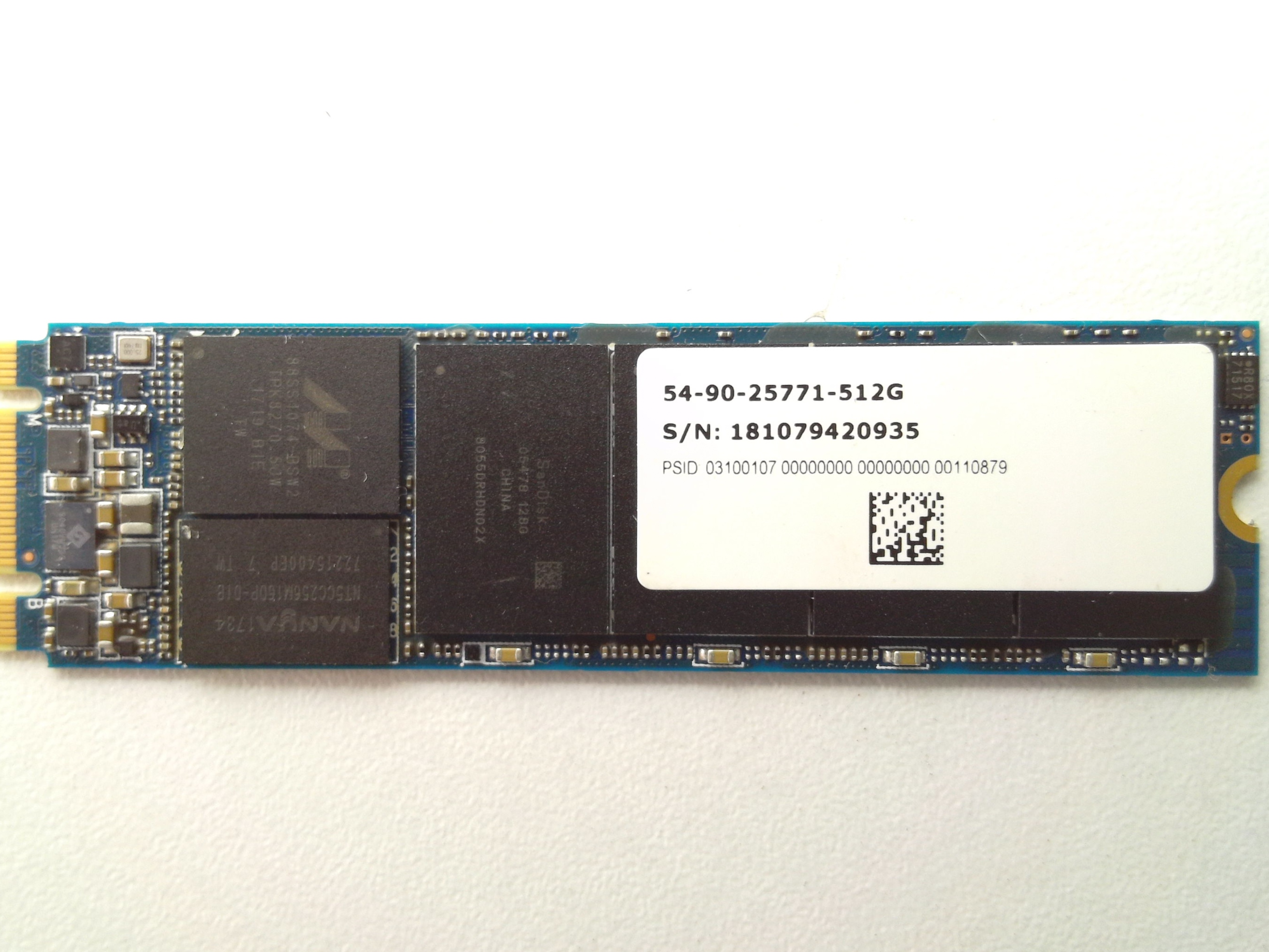

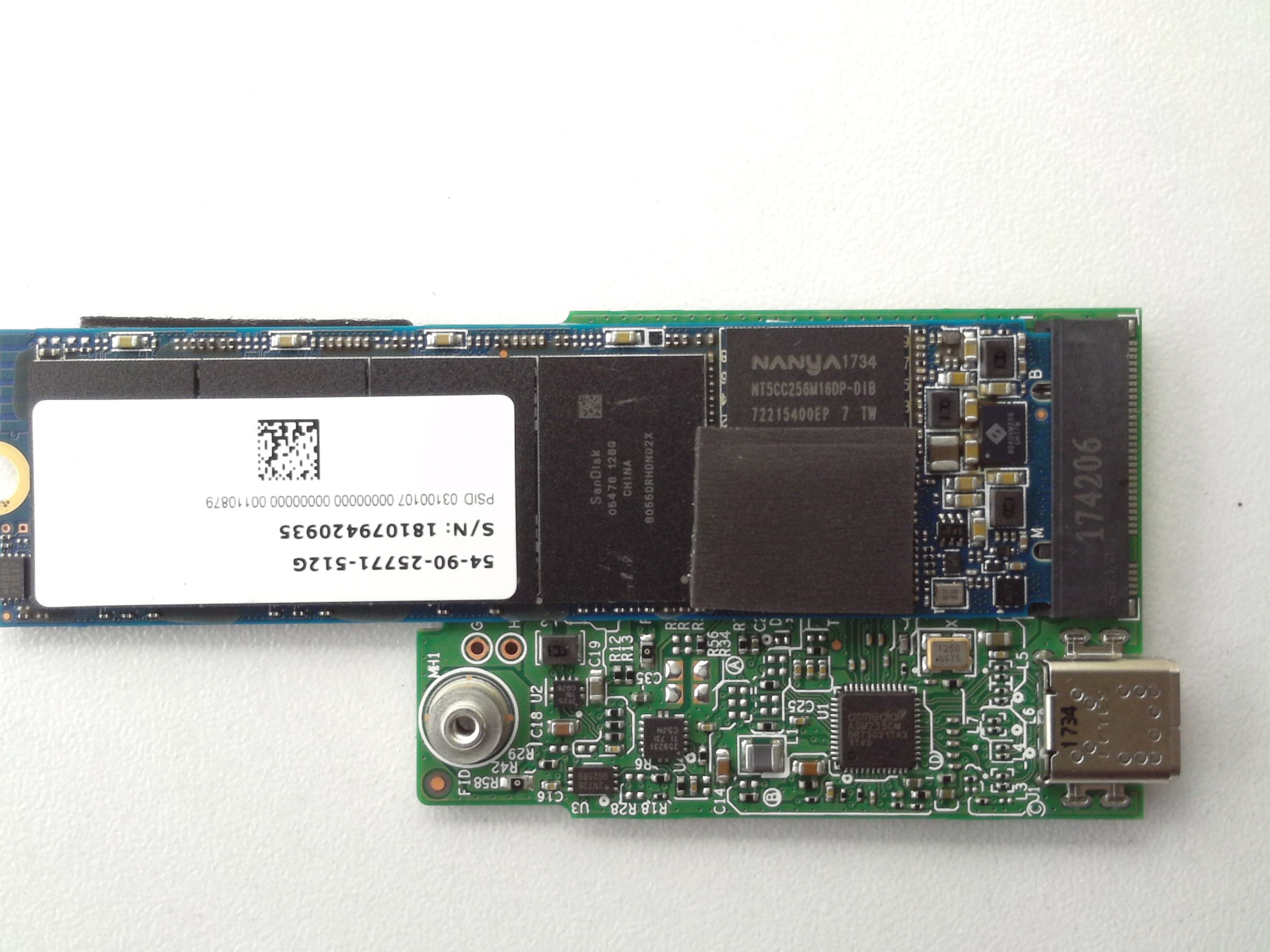

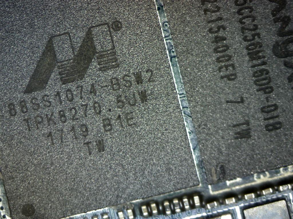

here is the other images after cleaning the pcb with more details:
To Lock/Unlock the drive you have to install the Security App. (comes with it), you cannot use the other older ver.
WD My Passport Init: ASM235CM (Am assuming the key is somewhere saved)
M2 SSD Controller: Marvell 88SS1074-BSW2
SanDisk SD8TN8U512G2000
the performance is really bad (M2 alone) slow compared to the others i have.
