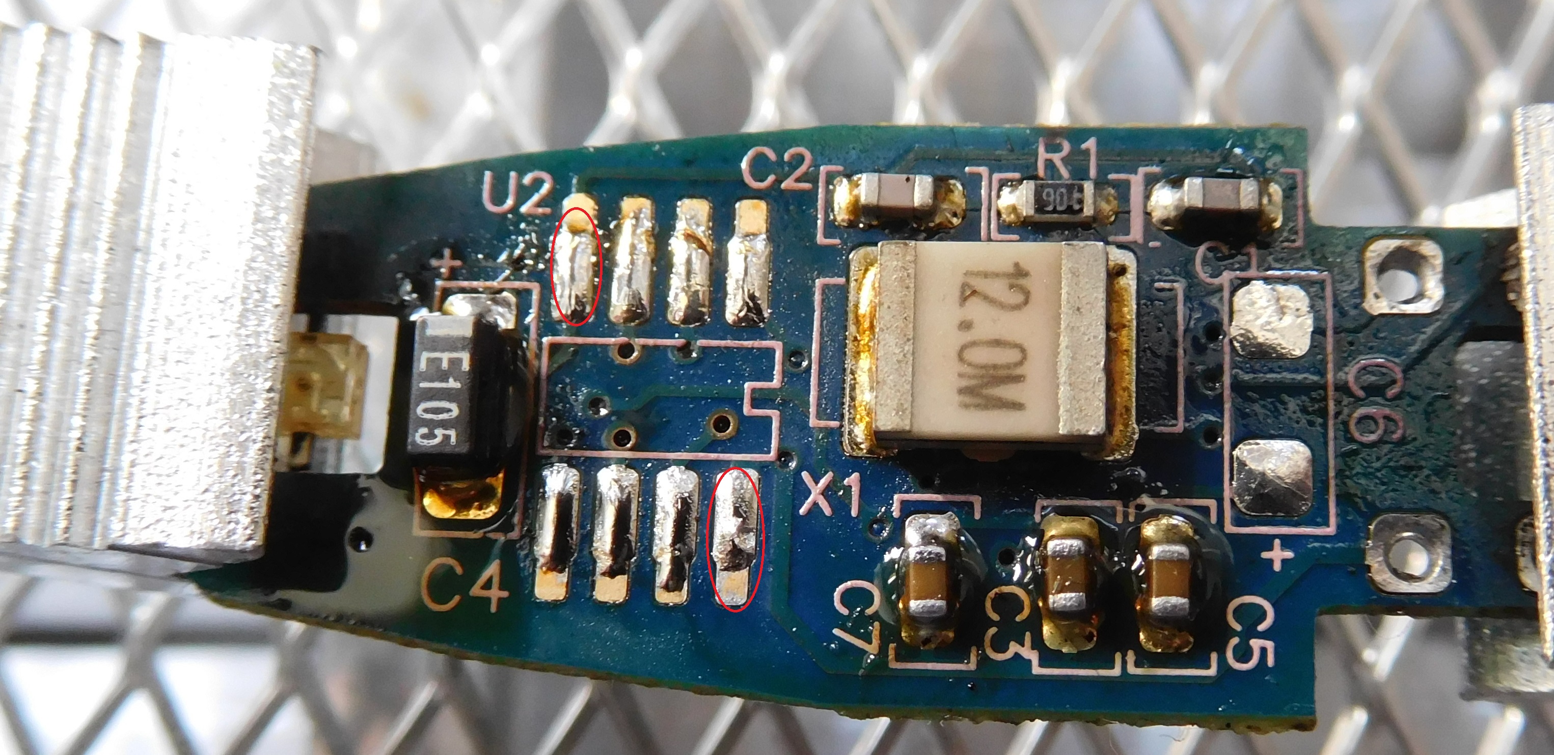

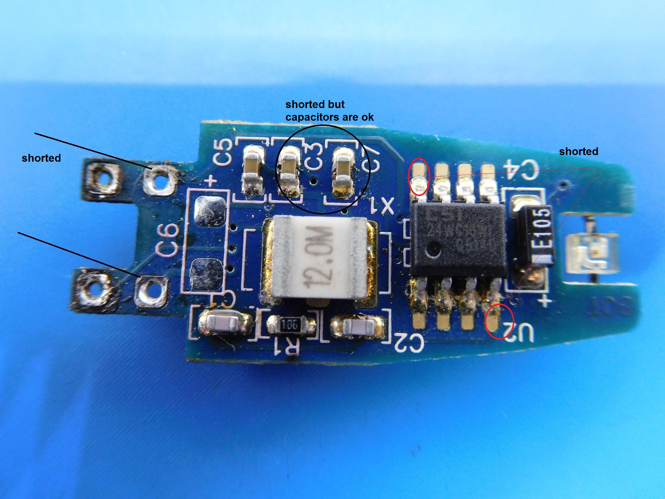

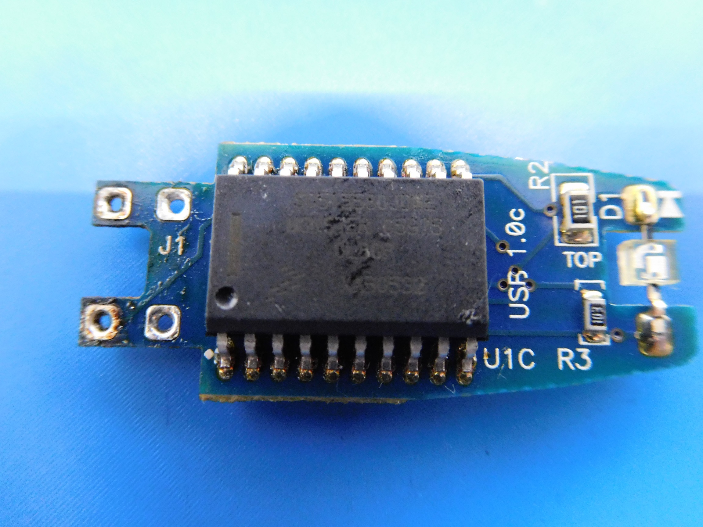

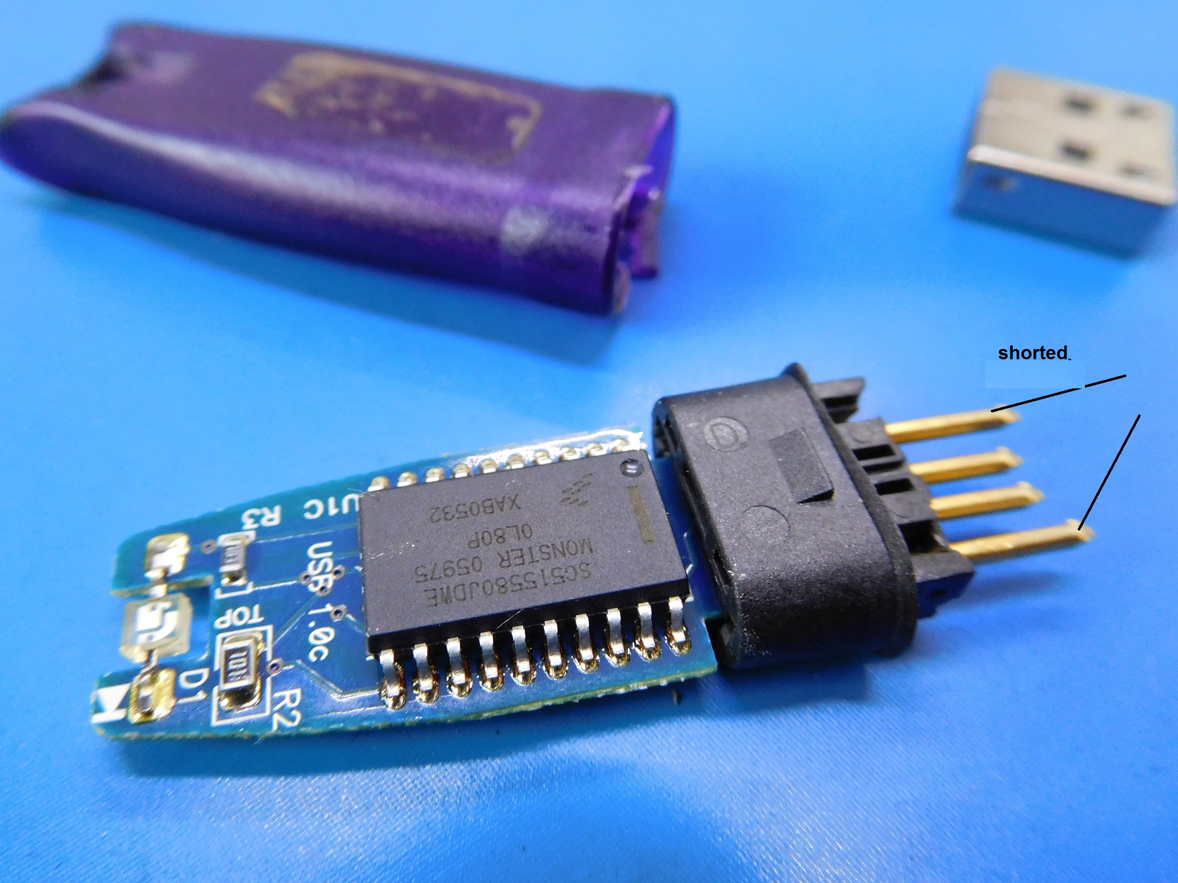

Got an interesting case of a HASP dongle, that had broken connector but also + and - are shorted. Can't figure out why. Need help and advice.

ISTM that the "Monster" chip (SC515580JDWE) must be the culprit, assuming you have excluded the serial EEPROM (24WC16WI).
CAT24WC16WI, Catalyst Semiconductor, 1.8V - 5.5V, 16-Kbit serial EEPROM, SOIC-8:
https://www.usbid.com/assets/datasheets/A8/cat24wc.pdf
https://www.dataman.com/media/datasheet/Catalyst_(CSI)/CAT24WCxx.pdf

Semiconductor looks good. Pads on PCB are shorted.
Didn't get any info about software or hardware it comes from. Just a question if it can be fixed/ cloned.

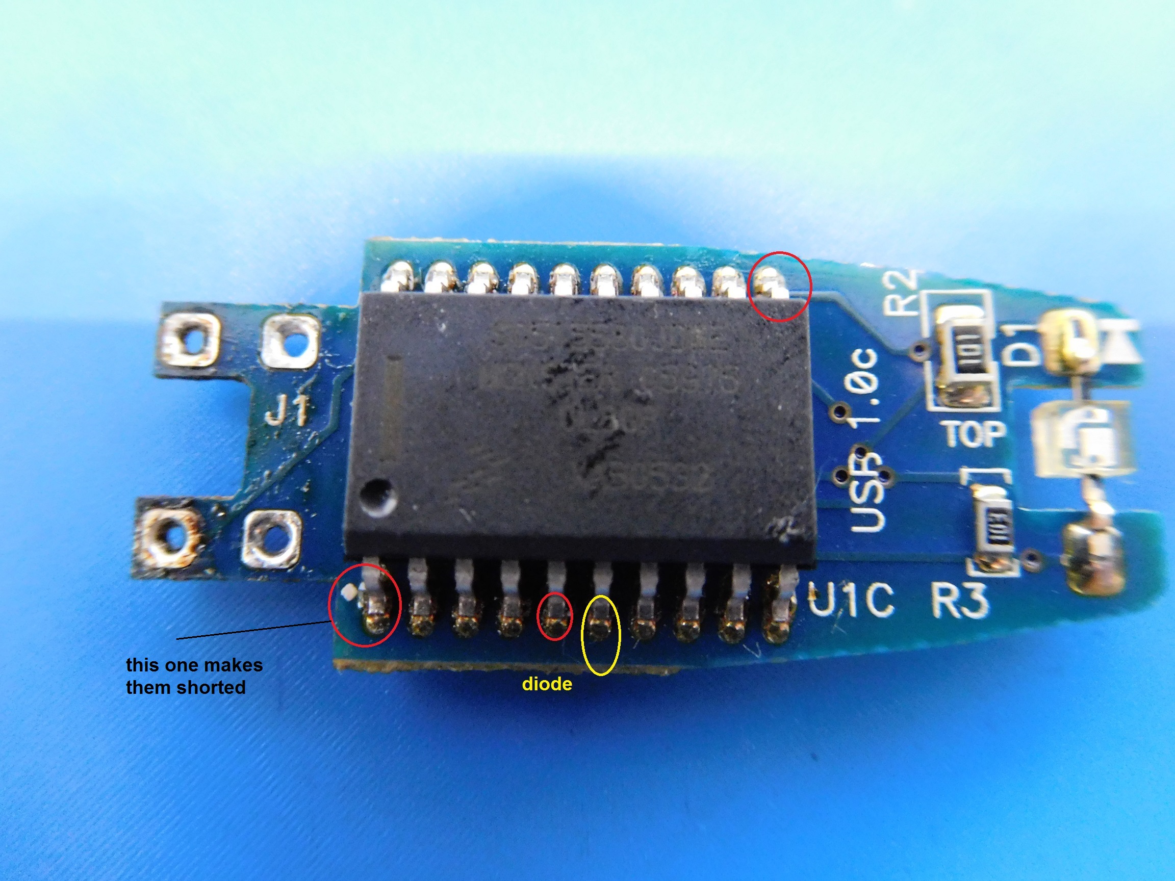

I don't see what else you could do other than to determine which pins of the "Monster" IC are connected to +5V and isolate them. If the short goes away when you do this, then this will confirm that this IC is the culprit. I presume that you have measured the other capacitors, ie C4 and C5.

Yes, C4 and C5 are ok. Found the one that makes them shorted.
Black one - makes them shorted
red ones are shorted with +
yellow - diode

I think that dongle is stuffed. If it is the Freescale MCU then replacing it is not an option as this is where the protection lies. some basic info by Cyberghost here: https://forum.exetools.com/showthread.php?t=12252
