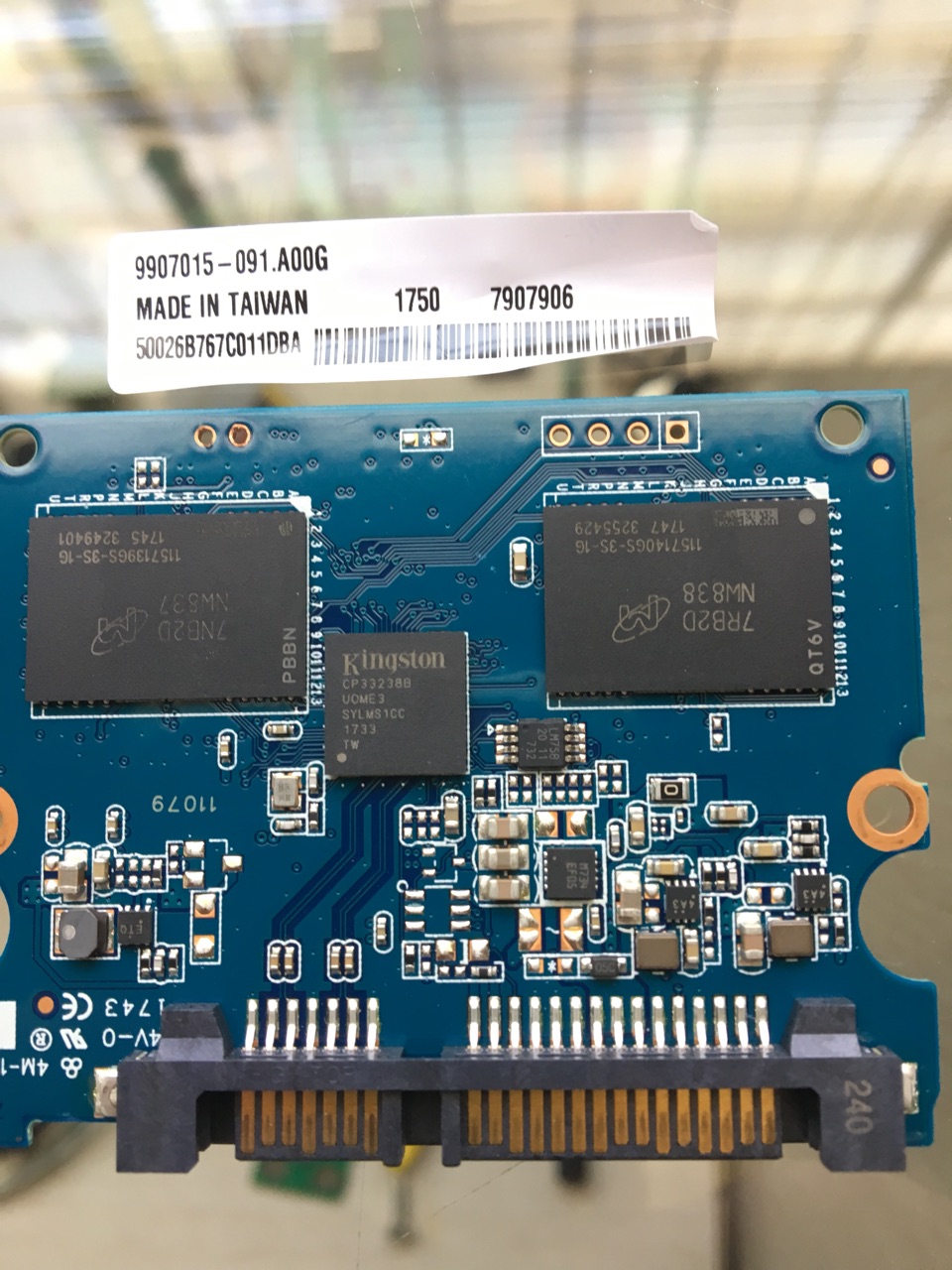

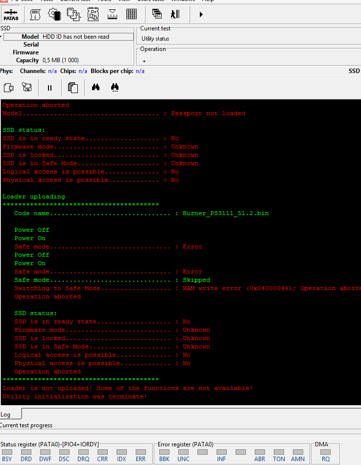

HI!
No on ssd.
File comment: Print screen pc
File comment: Photo board ssd

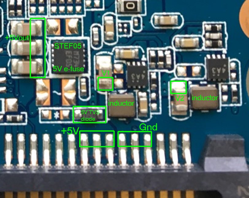

Measure the voltages across the bigger capacitors adjacent to the ETQ, 4A3 and EF05 (STEF05) ICs.
STEF05 is a 5V electronic fuse.
 Post subject: Re: Kingstone CP33238B
PostPosted: October 17th, 2018, 5:45
Posts: 17219
Test points.
PostPosted: October 18th, 2018, 9:40
Joined: September 12th, 2015, 23:46
Location: Moscow
why firmware 51.2? this nand (b0kb) support by 71.x
