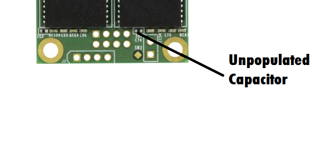

Thanks. Do you have any ideas of the golden solder blobs. Like on the top leftor next to the firmware update port. There are also lots of solder blobs (test points?) on msata ssd I have.Is there maybe something common across the different models?

If you mean this, it is just some PCBs can be used for say 256GB or 512GB drives, or have different parts depending on different versions of chips used. Usually there are more locations for electronic parts than actual parts.
The blobs are nothing special, just places where no parts were soldered. "unpopulated"

I think the OP is referring to the diamond shaped "pads" such as the one below "SW3". I haven't been involved in PCB manufacturing, so I may be wrong, but I suspect that these are registration points used for aligning multiple PCB layers.
