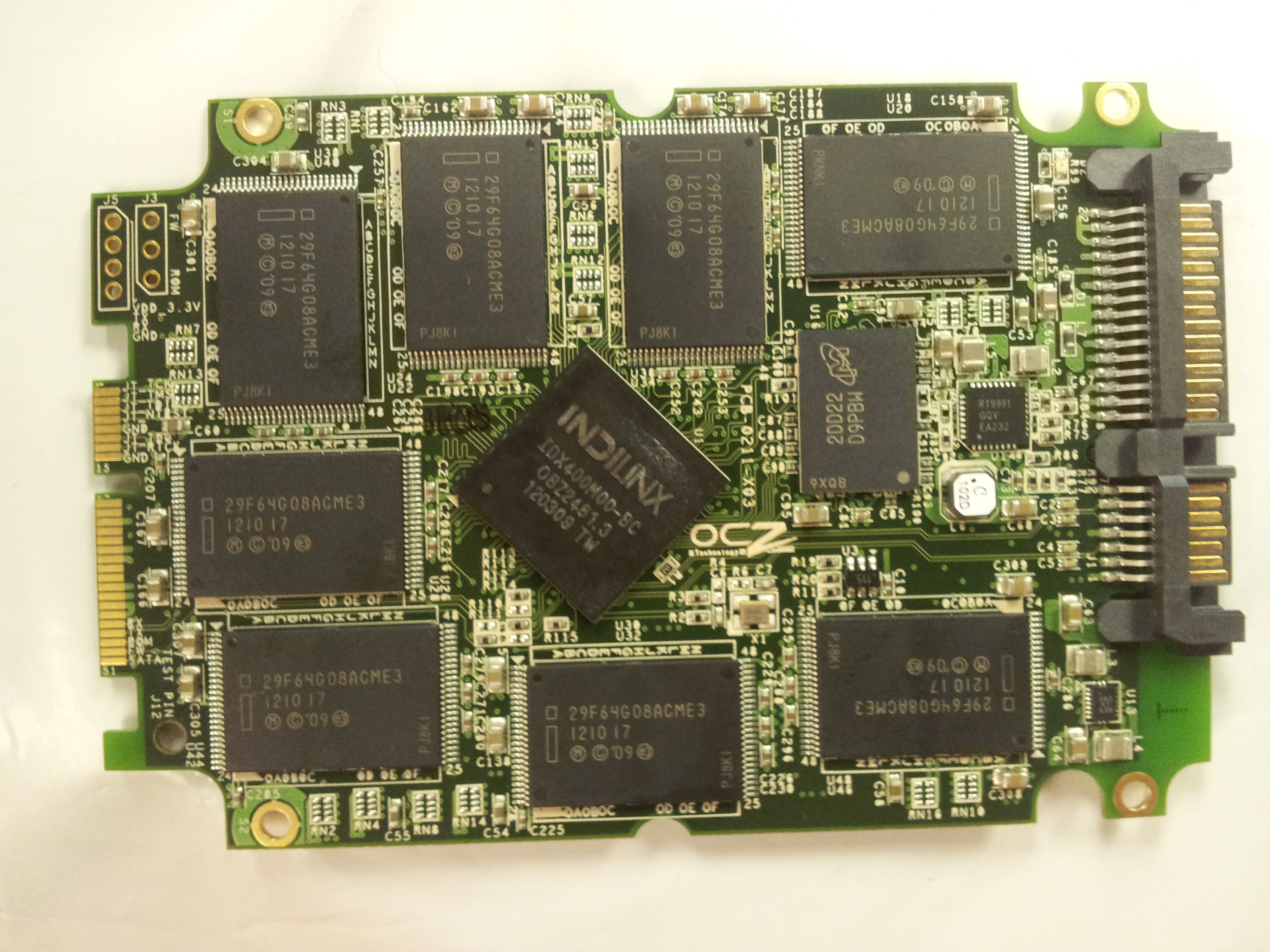

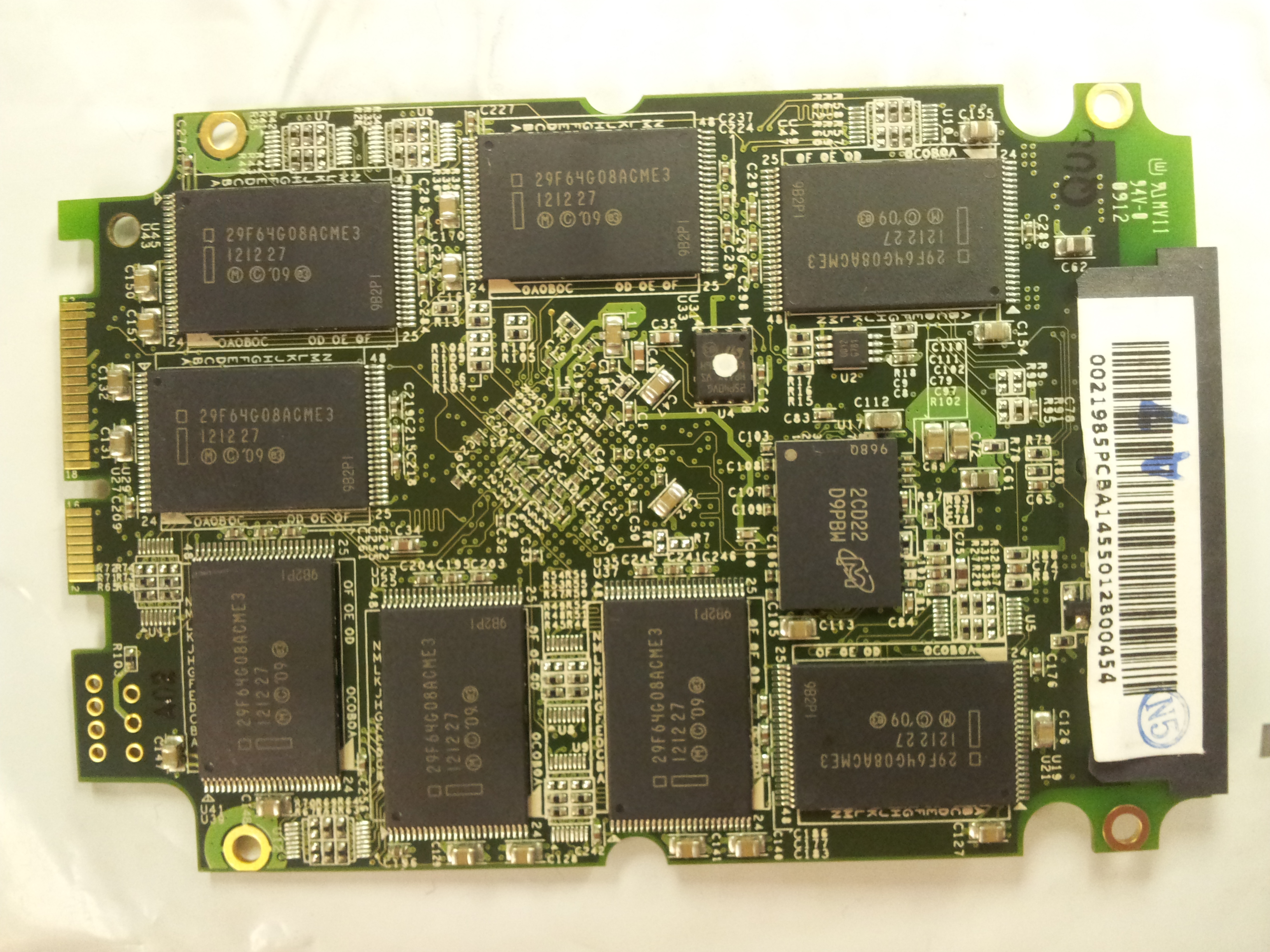

We have a 128gb OCZ Vertex 4 SSD that fails to recognise in bios (using AHCI / IDE SATA mode) - When stripped out the PCB displays a green LED when SATA power is plugged in so it would appear to be getting power - has also been tested with multiple power units.
What we need to achieve is to recover the data (yes we know this might be difficult) and we have arrived at the point of attempting data recovery through the UART interface.
Does anyone know if this is possible and if so is there any software that can be recommended? Is there particular UART code required to interface with the Indilinx controller?
The unit uses an Indilinx controller - believed to be the Everest 2 - IDX400M00-BC
Any suggestions for data recovery would be welcomed and if anyone has a schematic of the pcb for the vertex 4 128gb that would also be appreciated.

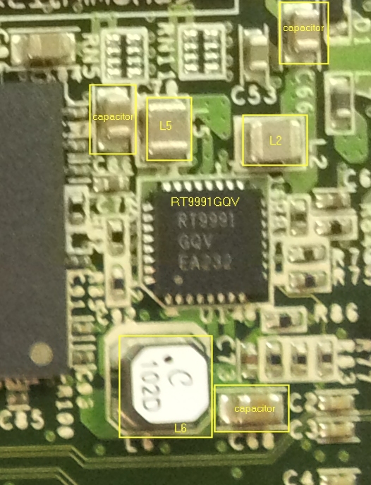

I can show you the voltage test points for the onboard power supplies. Do you know how to use a multimeter?

If you wish to proceed with the voltage checks, measure the voltages across each of the capacitors identified in the attached images, and measure the voltages between each coil/inductor and ground.
RT9991, Richtek, 3-channel Power Management IC + voltage detector:
http://www1.futureelectronics.com/doc/R ... 991GQV.pdf

U13 = SC283
U2 = G781
G781, Global Mixed-mode Technology Inc., ±1°C Remote and Local Temperature Sensor with SMBus Serial Interface:
http://www.gmt.com.tw/product/datasheet/EDS-781.pdf
SC283, Semtech, dual channel 1.8A synchronous step-down regulator:
http://www.semtech.com/images/datasheet/sc283.pdf

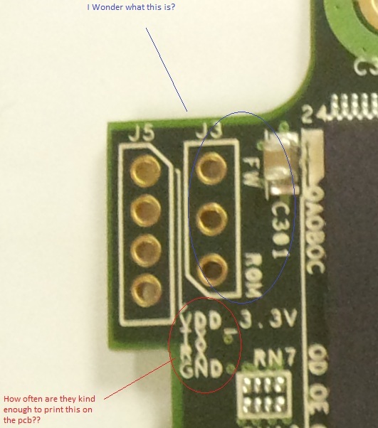

HaQue wrote:
it would be interestin to see the terminal output.. but remember...CUSTOMERS DATA.. dont experiment!
send to a pro.
those are test ports and programming
 Post subject: Re: OCZ Vertex 4 128gb UART Recovery method?
PostPosted: August 1st, 2013, 2:41
Posts: 3978
obviously J5 is serial port, UART or whatever you want to call it, but what is J3? Do you know how to use it and what port it is?
As you can see on photo - probably interface to manage ROM or something.
PostPosted: August 1st, 2013, 4:22
Joined: February 4th, 2013, 15:36
Posts: 57
Location: Russia
J3 is the jumper, if you short it, the drive will not load and run main firmware. It will continue work controlled by microcode in ROM.

does this mean that going by the PCB printing, 1-2 loads ROM and 2-3 loads FW?
http://flash-extractor.com/forum/viewtopic.php?t=3669
"... you can test by shorting the firmware jumper near the SATA connector, the drive should ID as YATADONG BAREFOOT."
