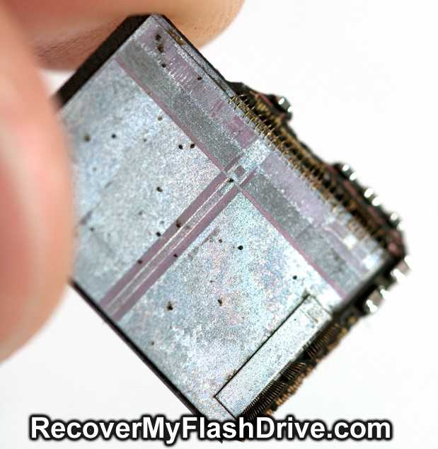

MicroSD card I decapped a while back, NAND is the size of the MicroSD card.

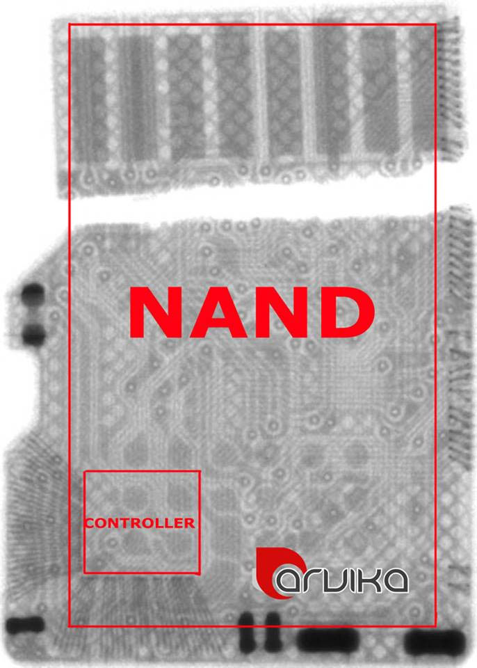

arvika one question, It's just curiosity. but , how do you know with this x-ray picture where is nand memory?

fender, compare jeremyb photo and mine. You will see bond connections to nand.

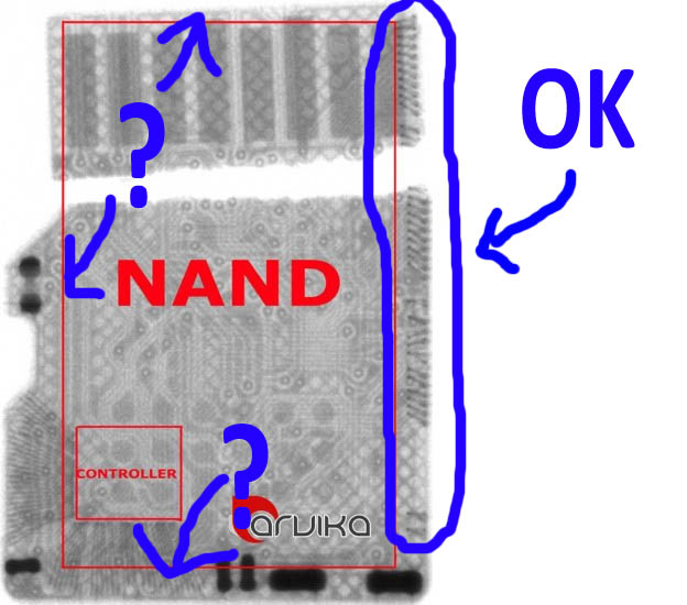

I guess you mean the connections I've marked as ok, am I right? but in that case we only know the height of the chip, but not the width ... at least I'm not able to see connections that tell me how wide it is.
Sorry for being insistent, I am very curious and the subject seems very interesting.
