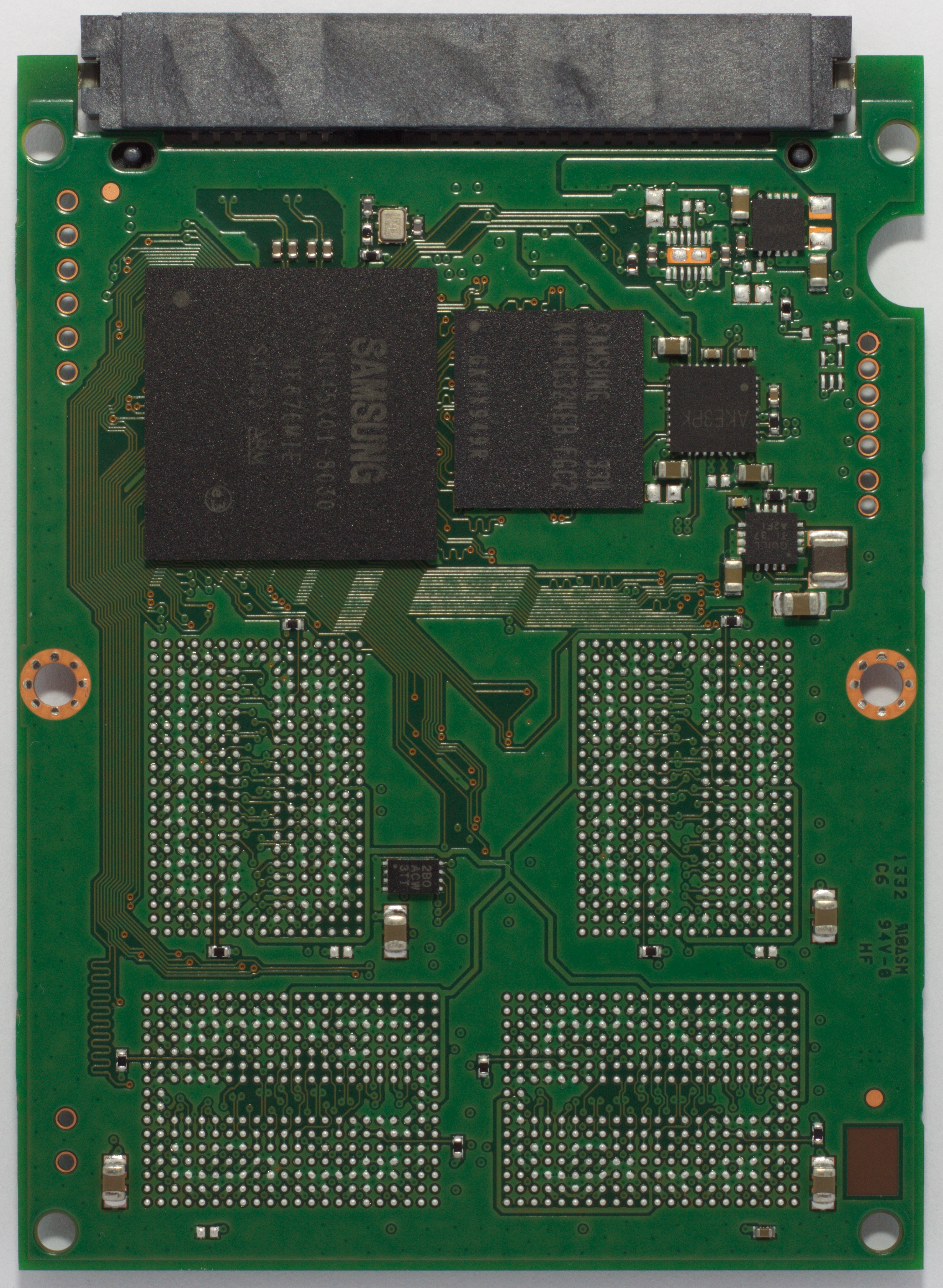

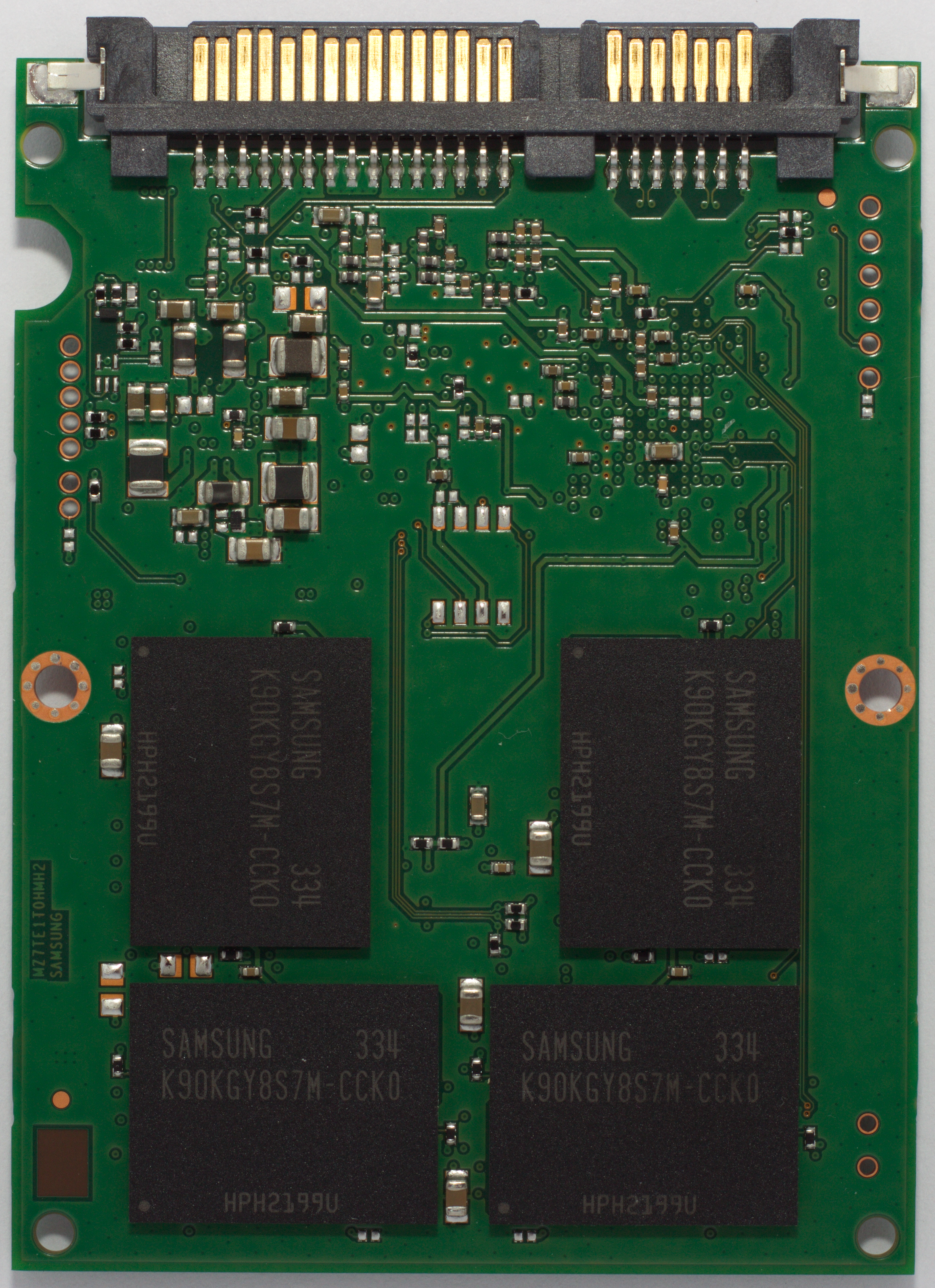

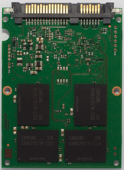

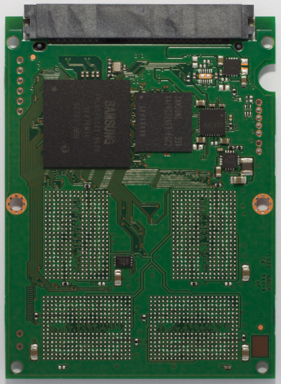

I need some help with this drive to pinpoint the problem.
Drive does Not come ready.
I checked for short all capacitors, none came short. I checked all resistors and none is blown.
If i power drive and let it powered for a while it looks like cpu is heating up, a sign that it is alive.
If anyone can help me move forward with this one i attach hi res pictures for both sides.
Thanks.

For the 250GB version ...
http://www2.futureware.at/~philipp/ssd/TheMissingManual.pdf
http://www2.futureware.at/~philipp/ssd/SamsungEVO840Voltages.pdf

Even if the pcb described in the pdf is a diffrent type, voltages measured are kind of the same.
Seems to me more like a firmware /software issue.
Question? If the content of the internal flash memory of 128kb, used to start the "safe mode", as described in pdf, is damaged, is there a way to write it back with a good file to get ssd back to life?
And next question? Has anybody dumped a good file out of a working ssd of this type?
Thanks.

I am the professional lab, i have pc-3000 ssd, i have tried to get into safe mode with no success, so there is no way to load virtual translator and go on.
If cannot get into safe mode there may be 2 problems:
1. pcb component failure problem
2. boot code is damaged
I suspect the second.
From my experience, when a controller does not have external eprom it ALWAYS have a backdoor procedure to be able to overwrite damaged boot code from internal flash to be able to recover.
I was asking if anyone knows how can it be done and if anyone has a dump from a working ssd of this type.
Thanks.

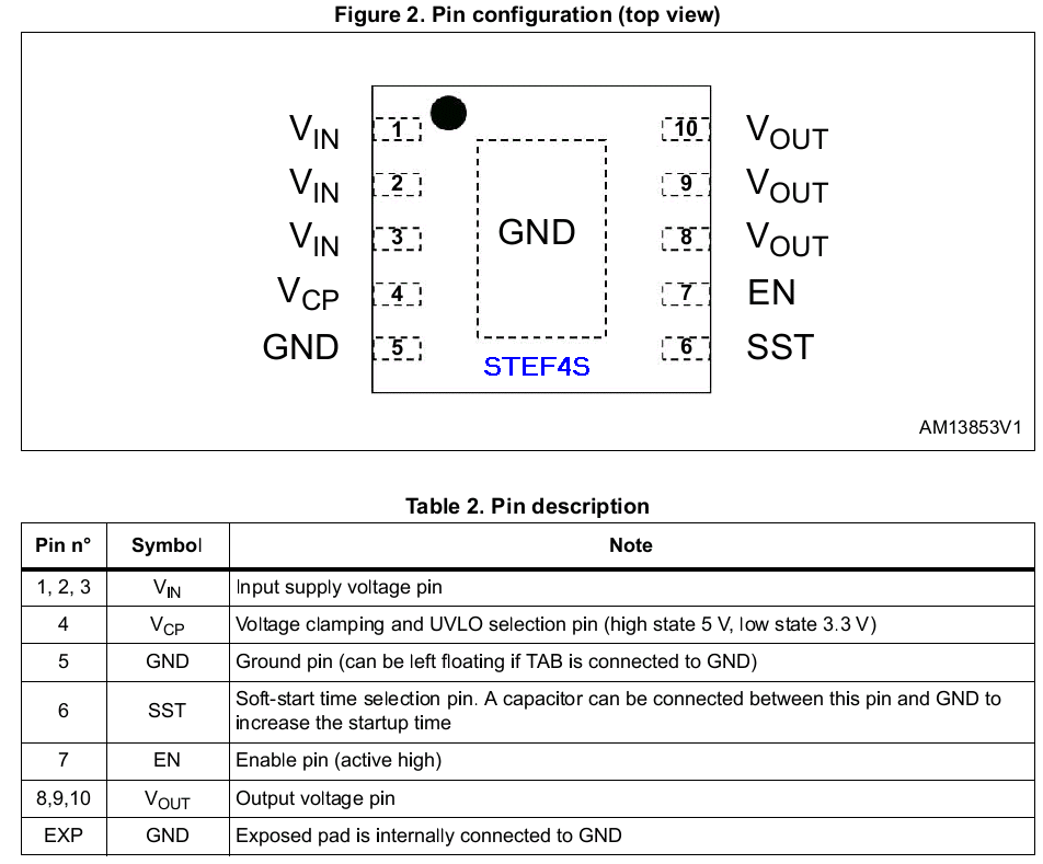

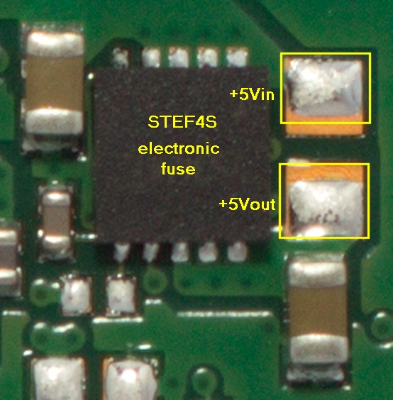

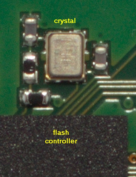

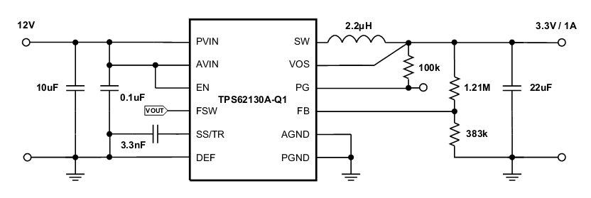

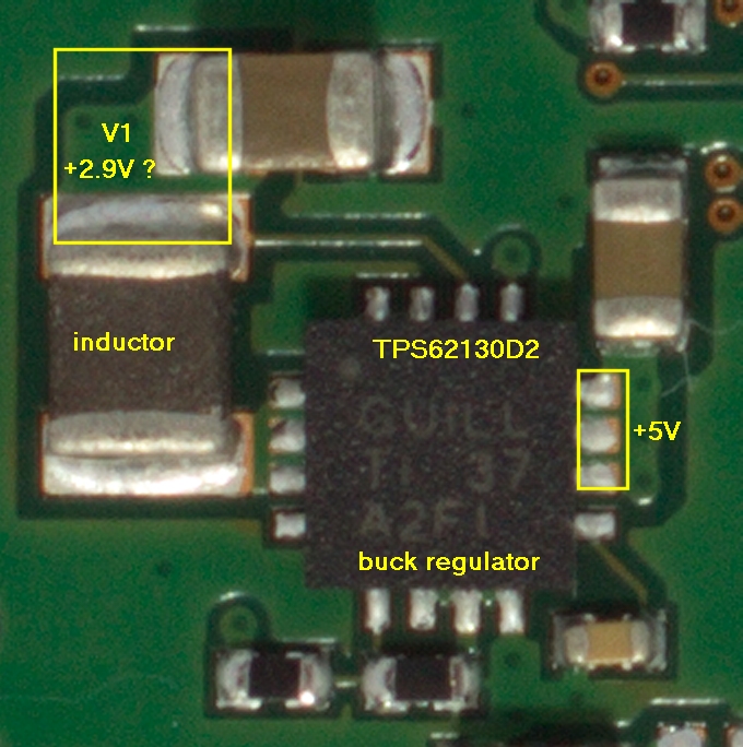

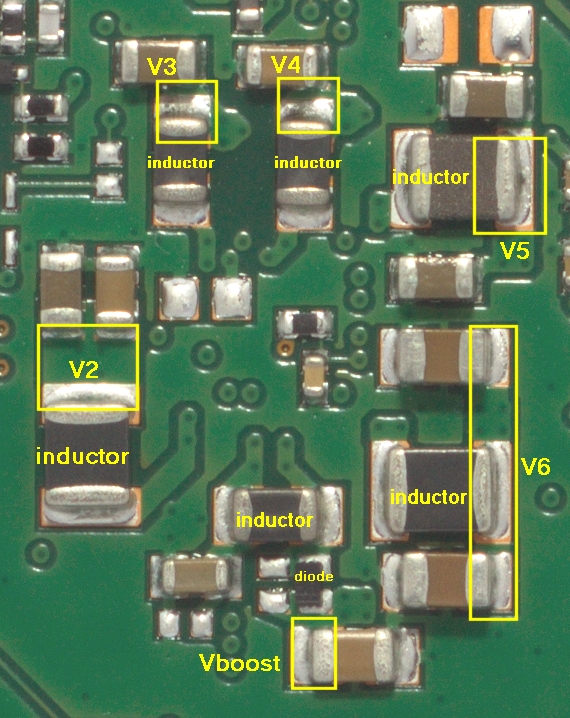

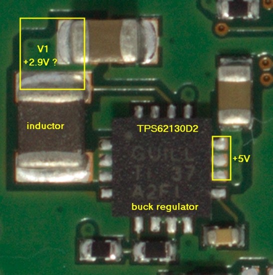

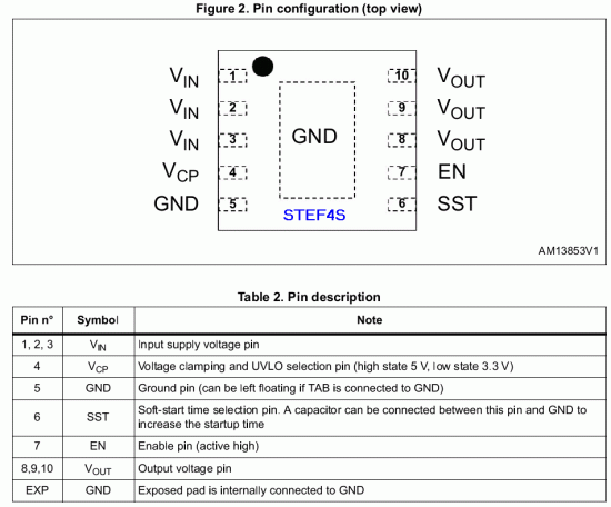

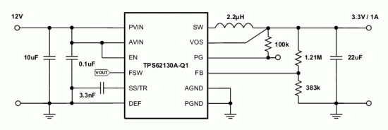

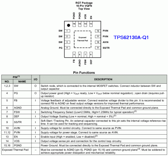

 Post subject: Re: Samsung 840EVO 500GB SSD
PostPosted: March 17th, 2018, 0:25
Posts: 17232

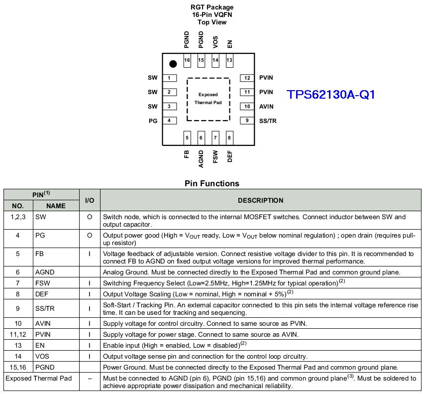

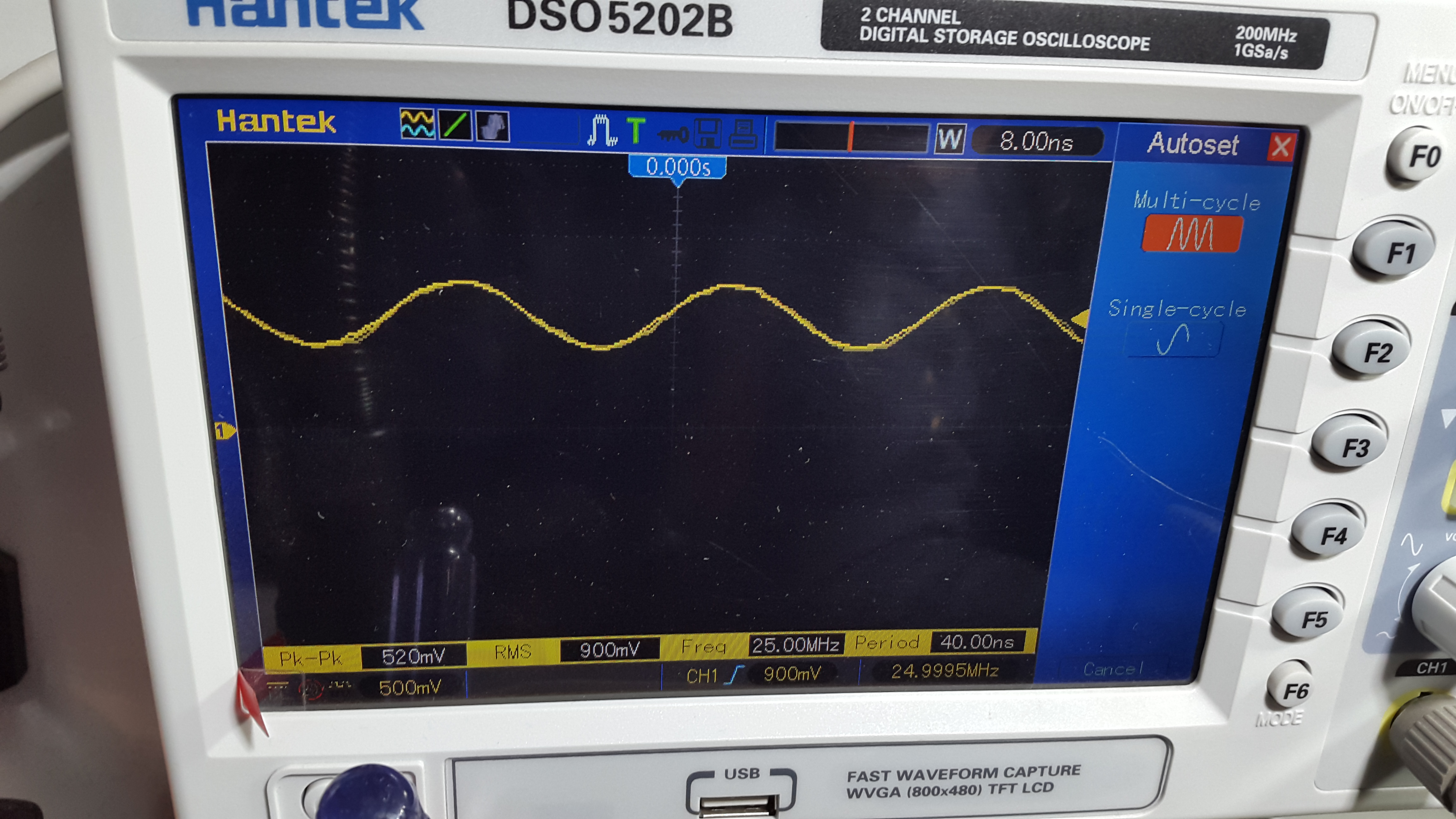

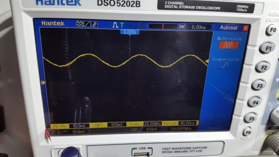

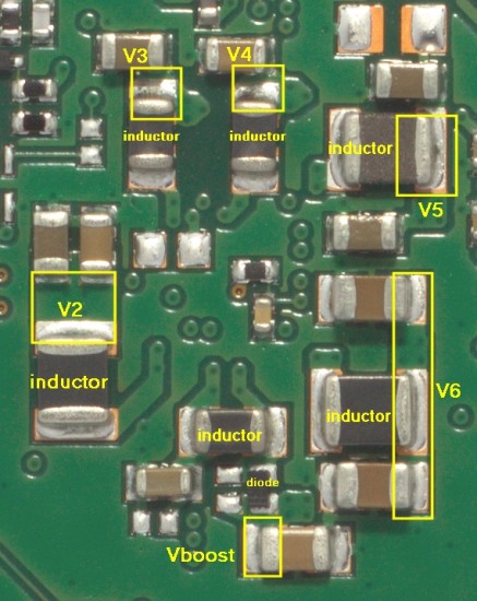

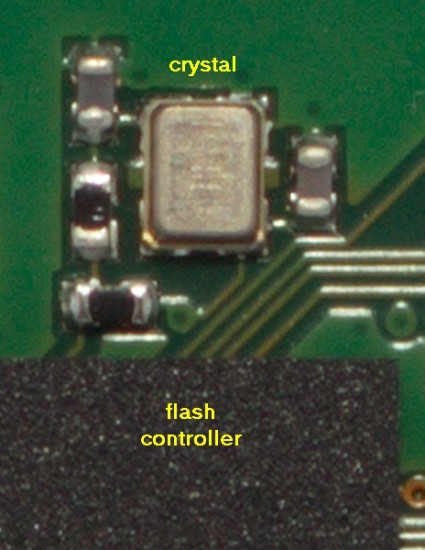

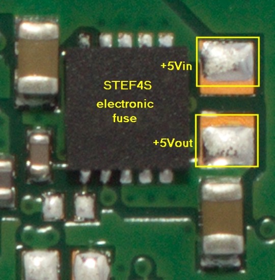

Did you check the crystal?
References:
TPS62130A-Q1, Texas Instruments, 3V to 17V, 3A adjustable Step-Down Converter with DCS-Control, marking PA6IQ, VQFN 16-pin:
http://www.ti.com/lit/ds/symlink/tps62130a-q1.pdf
This (expired) URL suggests that GUILL = TPS62130D2:
https://chipworks.secure.force.com/cata ... =TEX-GUILL
STEF4S, STMicroelectronics, electronic fuse for 3.3V and 5V lines:
http://www.st.com/web/en/resource/techn ... 095426.pdf
PostPosted: March 17th, 2018, 6:23
Joined: May 9th, 2017, 11:33
Posts: 155

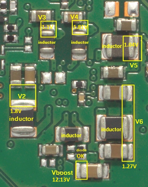

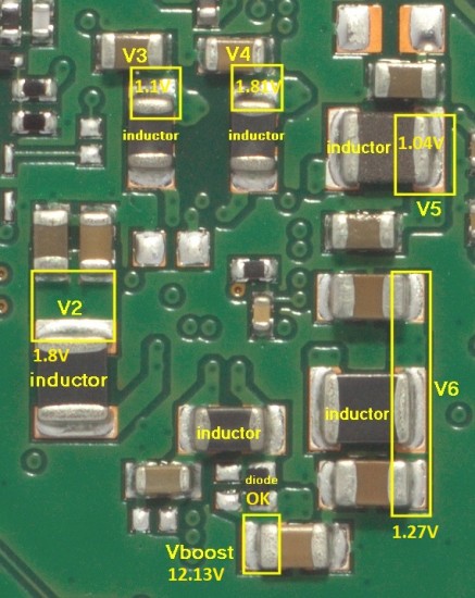

I made the measurements.
PostPosted: March 17th, 2018, 6:55
Posts: 205
Location: Vienna, Austria
Regarding the following question: If the content of the internal flash memory of 128kb, used to start the "safe mode", as described in pdf, is damaged, is there a way to write it back with a good file to get ssd back to life?
What usually gets damaged is the normal bootloader on the NAND flash chips, or the SA structures on the NAND flash chips, but not the safe mode bootloader. The usual damage can be corrected by booting it in SAFE mode and then running a firmware update (if it affects the firmware part), or by fixing the SA structures (given that you understand them, which I don't yet). The internal memory contains only the safe mode boot loader, which is only used when you bridge the 2 safe mode pins during powerup.
Perhaps there is a third bootloader inside the controller which checks the SAFE mode pins and boots SAFE mode or loads the normal firmware from the NAND chips, but I haven't seen any hints for the existance of that third bootloader yet, I only guess that it somehow must exist, because the NAND flash interface to load the firmware looks too complex to be implemented in hardware.
I have not found any way to change the internal memory yet. And I am not sure, whether it is actually changeable, perhaps it is really just a ROM. If is not ROM, I would expect it to be SPI Flash, but I haven't found that SPI interface yet.
If the internal memory with the SAFE mode firmware is really broken and that really concerns you, I would suggest to unsolder the controller and replace it with a working controller from a donor. But I wouldn't expect a broken SSD to be fixable with that. I guess that the controller could even start normally from the NAND flash chips with a broken SAFE mode bootloader.
If you think that the controller might be at fault or the PCB might be at fault, and you are good with BGA soldering, I would suggest that you take the NAND flash chips off from the patient and solder them in the same place (and orientation!) onto a donor PCB. There is no configuration data stored inside the main controller, all configuration is on the NAND flash chips.
If you aren't sure, whether the internal flash memory is working correctly, just plug the SSD into a SATA port, bridge the SAFE mode pins and power the SSD up, then you should see a ~500 MB storage device on the SATA interface, if the internal flash memory works. If that doesn't work, then try to connect with JTAG and see whether the 3 ARM cores are there.
But as I said, the internal flash memory of the controller is most likely not the reason for why the SSD doesn't work anymore.
PostPosted: March 17th, 2018, 16:50
Posts: 17232
As you have already stated, they match sourcerer's results.

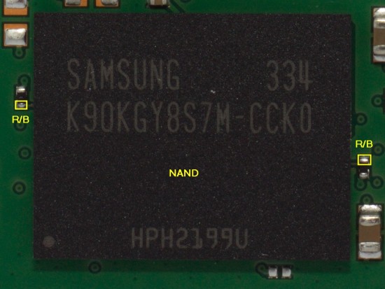

PostPosted: March 17th, 2018, 17:22
Posts: 17232

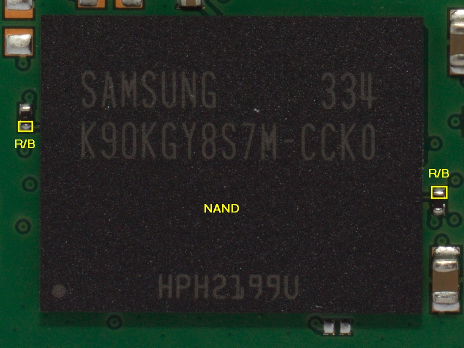

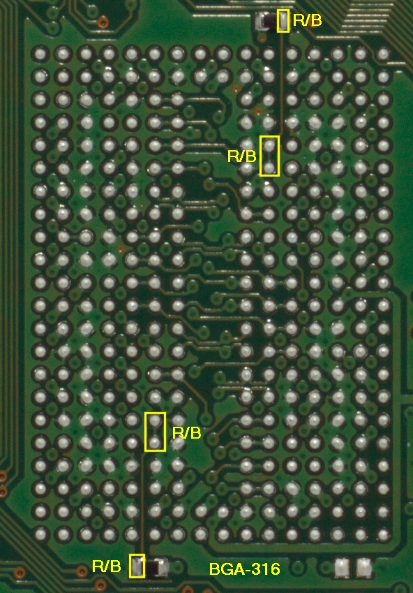

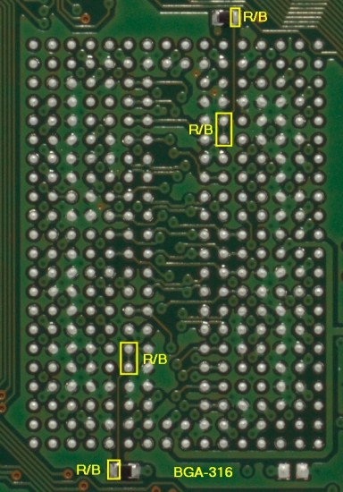

Would it make sense to wire each of the R/B pins to ground and then see how the drive behaves?

I also checked the crystal.
