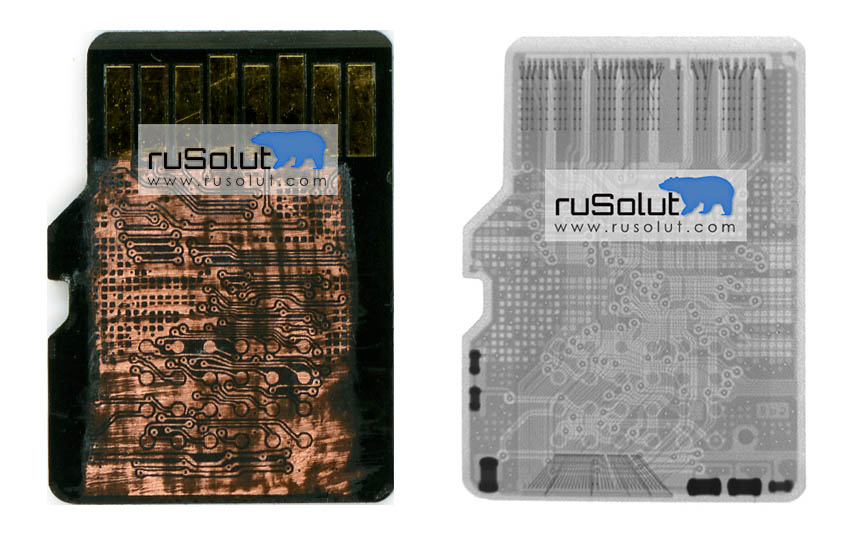

I would like to know where is the Nand memory of a memory card that I have, but I do not want to spoil it if I am not going to be able to do it. If I expose the Pinout layer (as in the photo on the left), is it possible to know it, or is an x-ray photo necessary?
If the answer is yes, how could it be known?
Thank you !

pinout layer will not help you as it uses vias and traces routed to where ever needed between layers.
Unless you are going to decap, I don't see how knowing where the NAND is will help. If the card is snapped, you probably need parts of the PCB on the side that does not contain NAND (if break missed the NAND which is unlikely) as there would be traces or wire bonds needed to connect to. very small amount of unused space on a microSD.
Once again, photos of the actual job is way more useful than this theoretical banter.

Yes, I'm going to decap the Micro SD Card, but I want to know how I should do it to see where the Nand memory is. I promise to take pictures and put them in as soon as I have, but I'm not sure what I have to do.
On which side should I decap the card?

I forgot to say that the card is a Samsung EVO 64 Gb. It may be useful to know.

you would decap on opposite side of the gold pads. did you look at the links and pics in your other thread? should be fairly clear by now.
