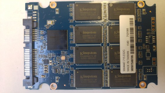

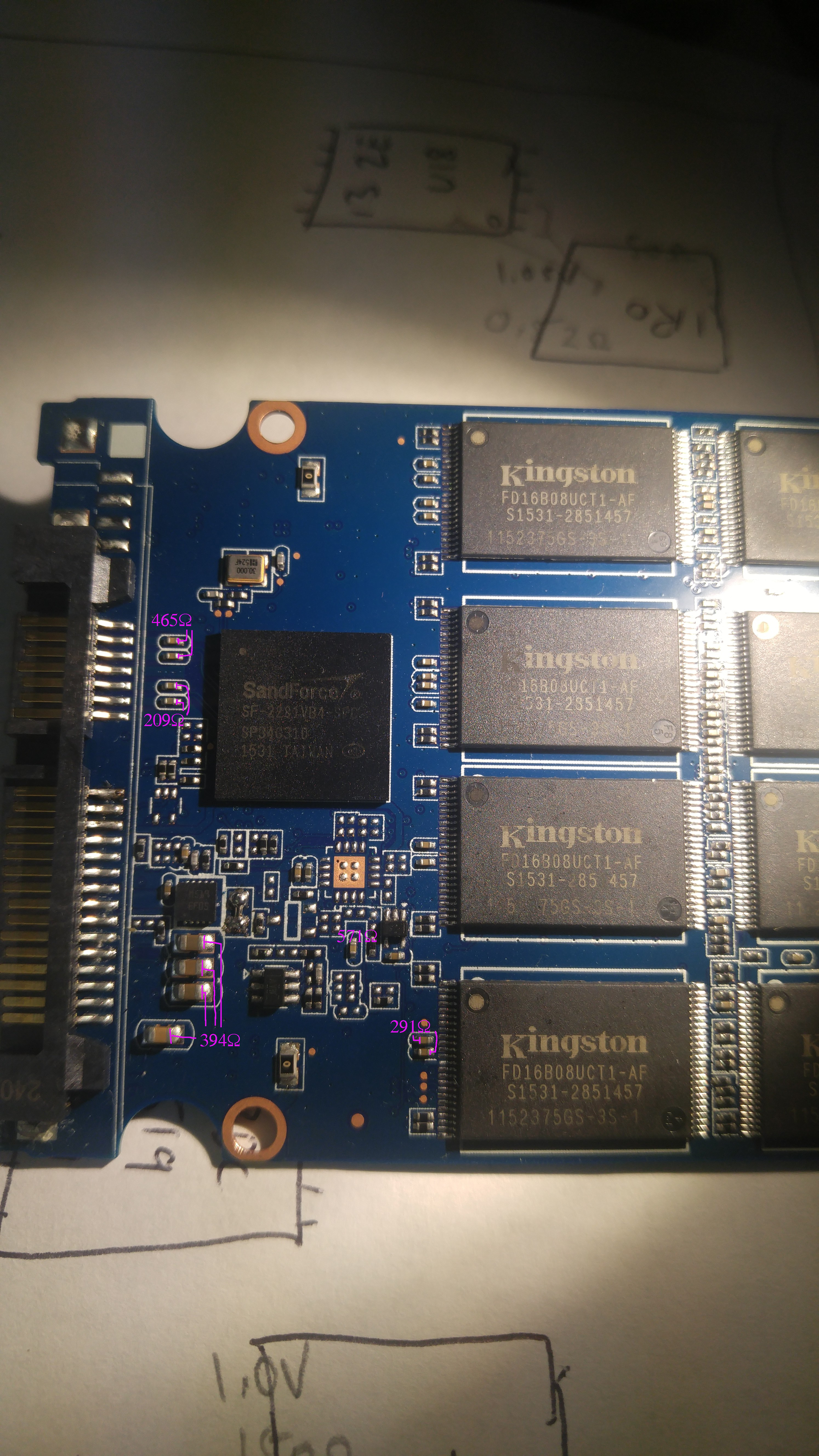

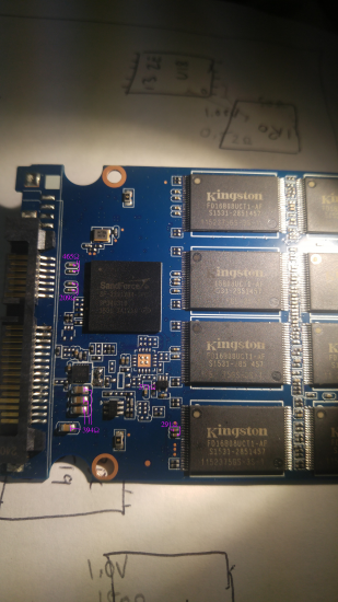

I'm not able to detect the SSD when plugged in.
It's a Sandforce Controller, so no luck with PC3K.
Any luck with this one?
Kingston 240GB
SKC300S37A/240G
Controller is
SandForce
SF-2281VB4
SP34G310
1531 TAIWAN
Thanks,
 Post subject: Re: SSD With No Power Kingston 240GB
PostPosted: December 22nd, 2018, 2:36
Posts: 17232
https://forum.hddguru.com/viewtopic.php?f=10&t=34643

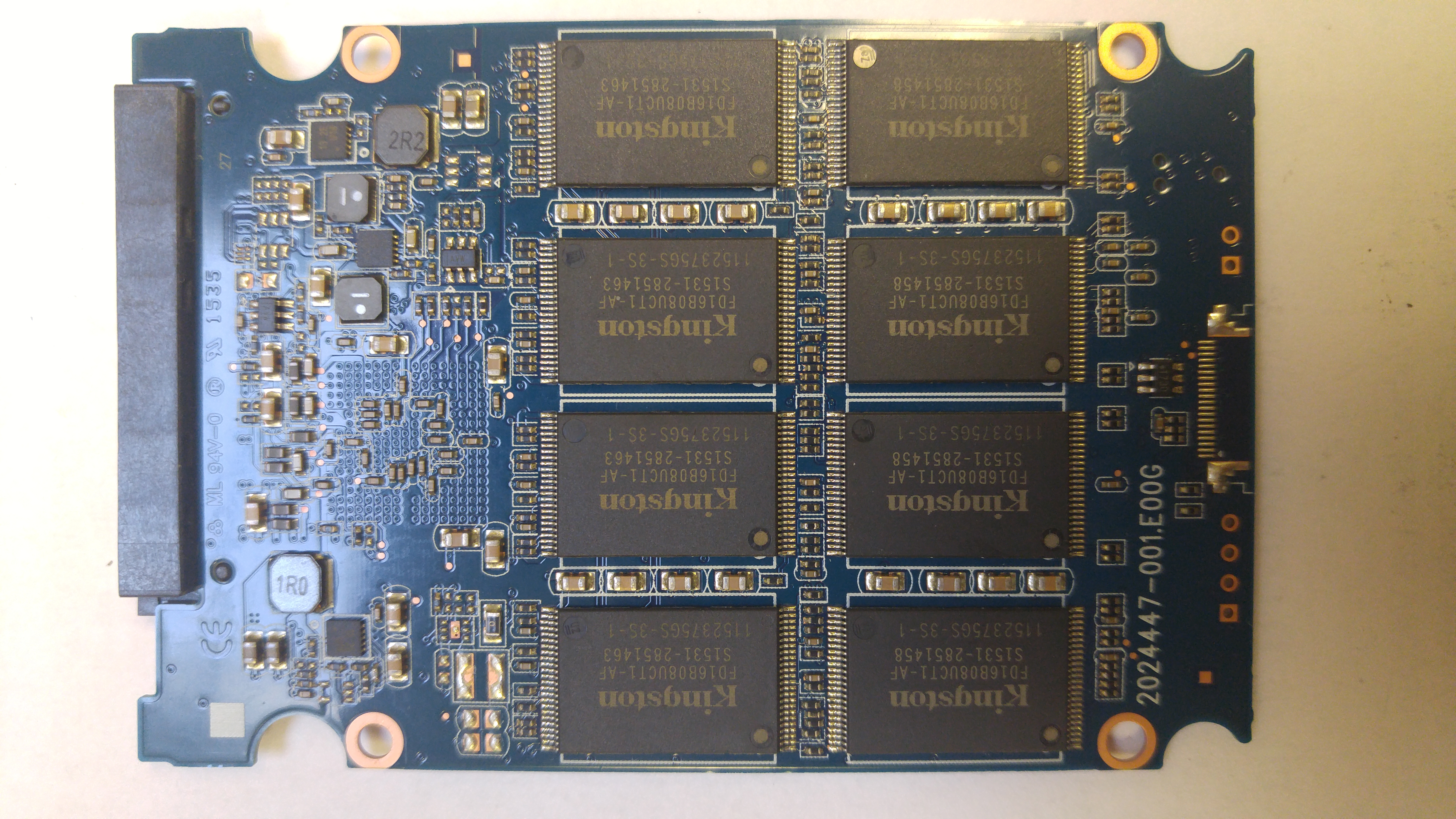

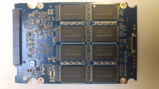

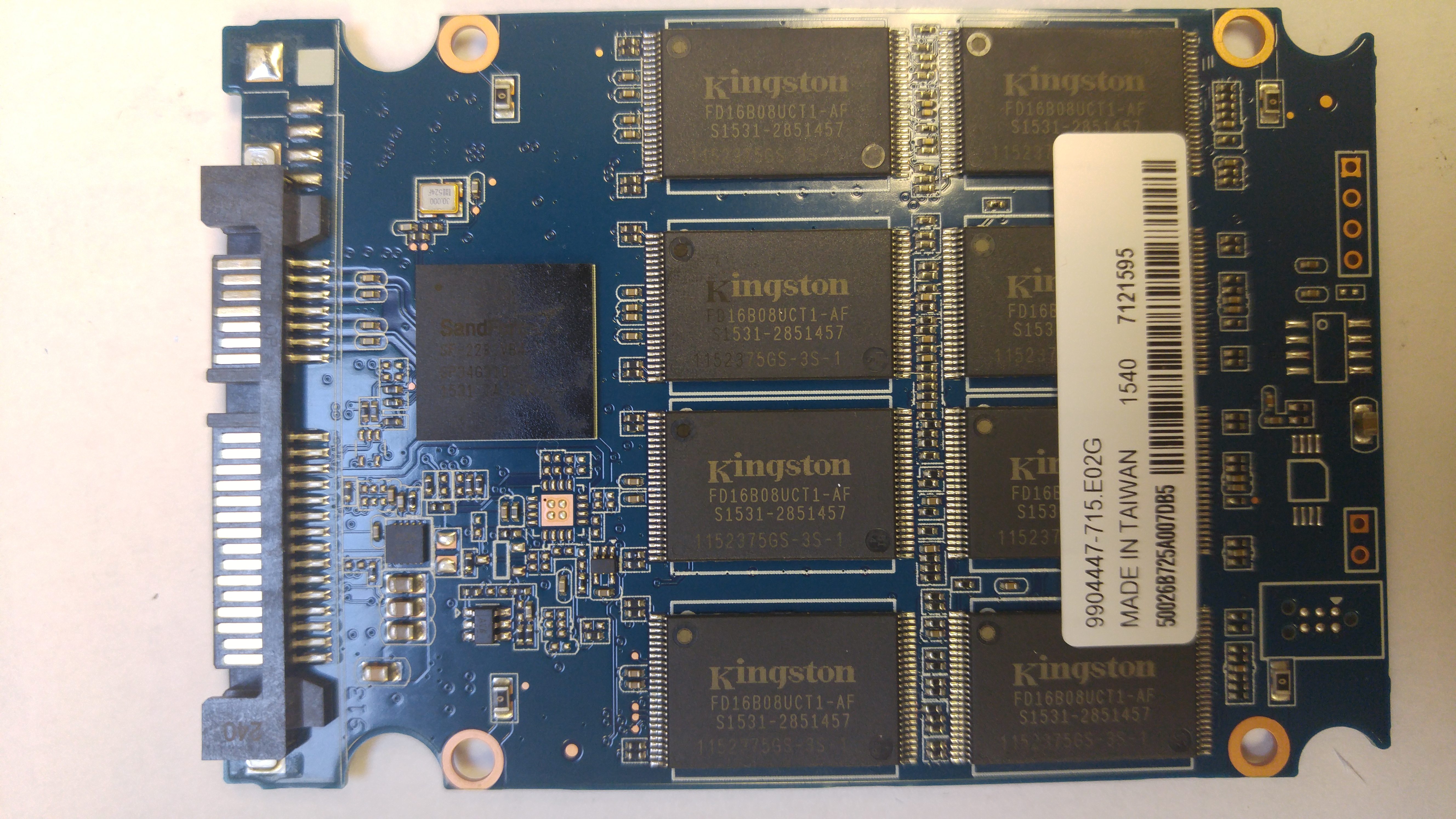

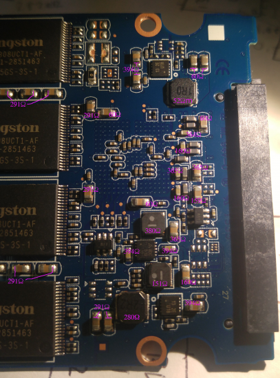

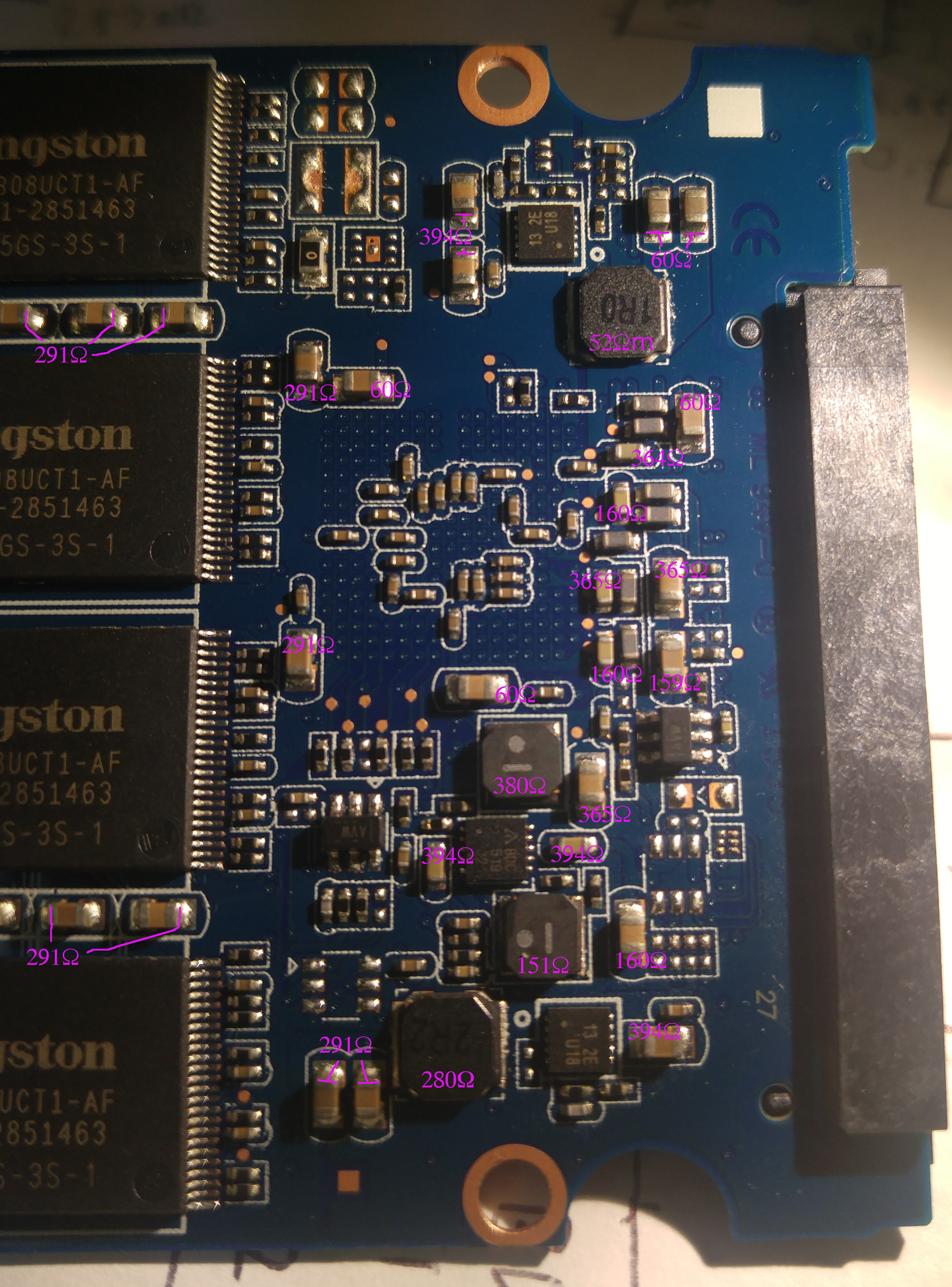

Hi. I'm having some trouble finding the problem/short with the SSD.
I bridged the 5Vin and 5Vout lines
The coils and capacitors seem fine. I've attached pictures with their resistances.
