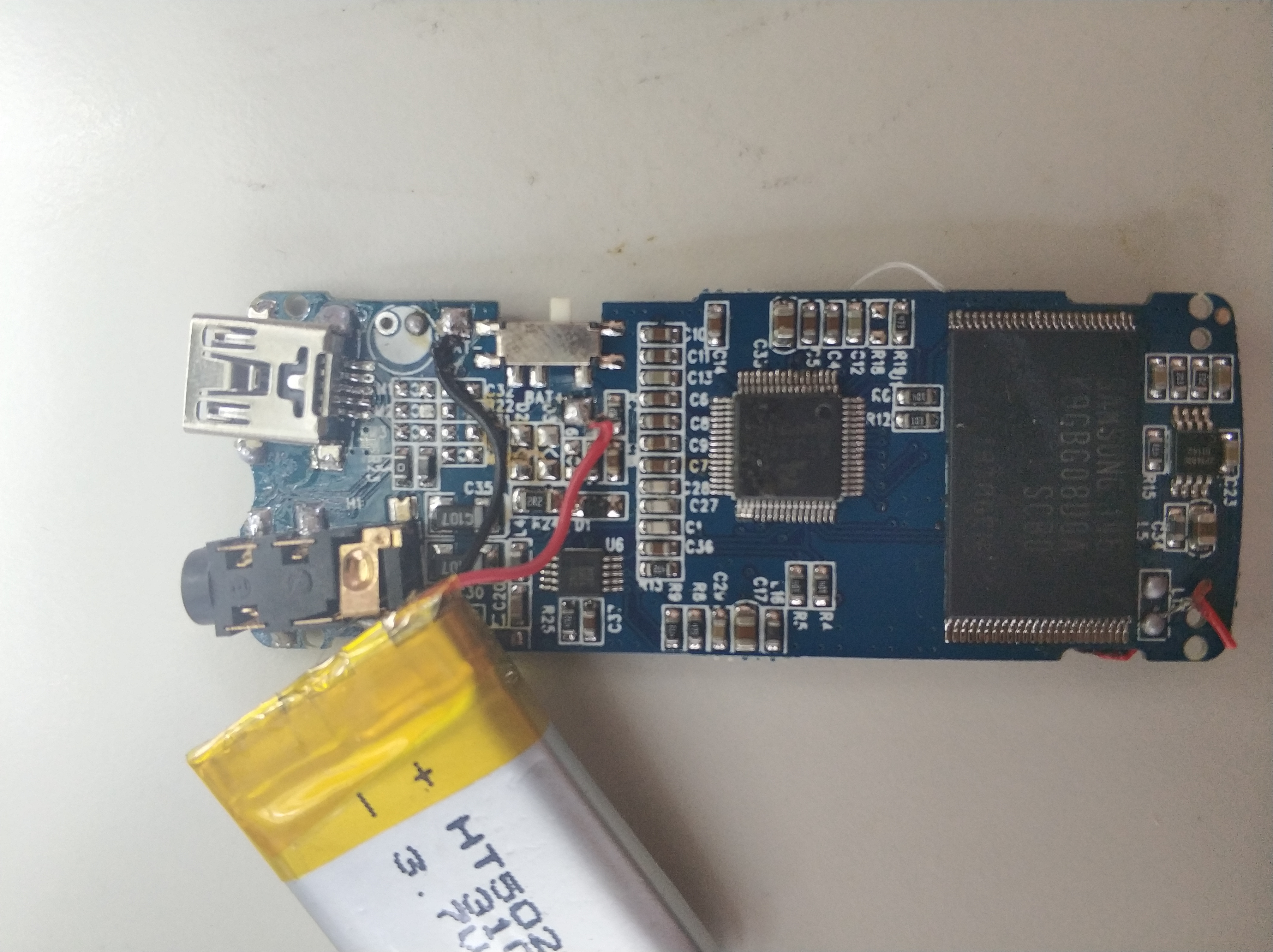

Hello ı have atj3315 controller Mp3 player. But thid player write protect. Not read with usb connect. I need this data pinout soldering. Which contact soldering data pinout?

I think you're massively oversimplifying the difficulty of getting the data off that.

http://pdf-file.ic37.com/uploadpdf_old/SAMSUNG/K9GBG08U0A_datasheet_898290/146569/K9GBG08U0A_datasheet.pdf

We solved few same cases last weeks. It not easy job. ECC works after applying XOR, after it you must assembly the image in correct way.
I figured it out and got all the data. But my intention is to read directly via Mp3 without removing the chip
