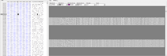

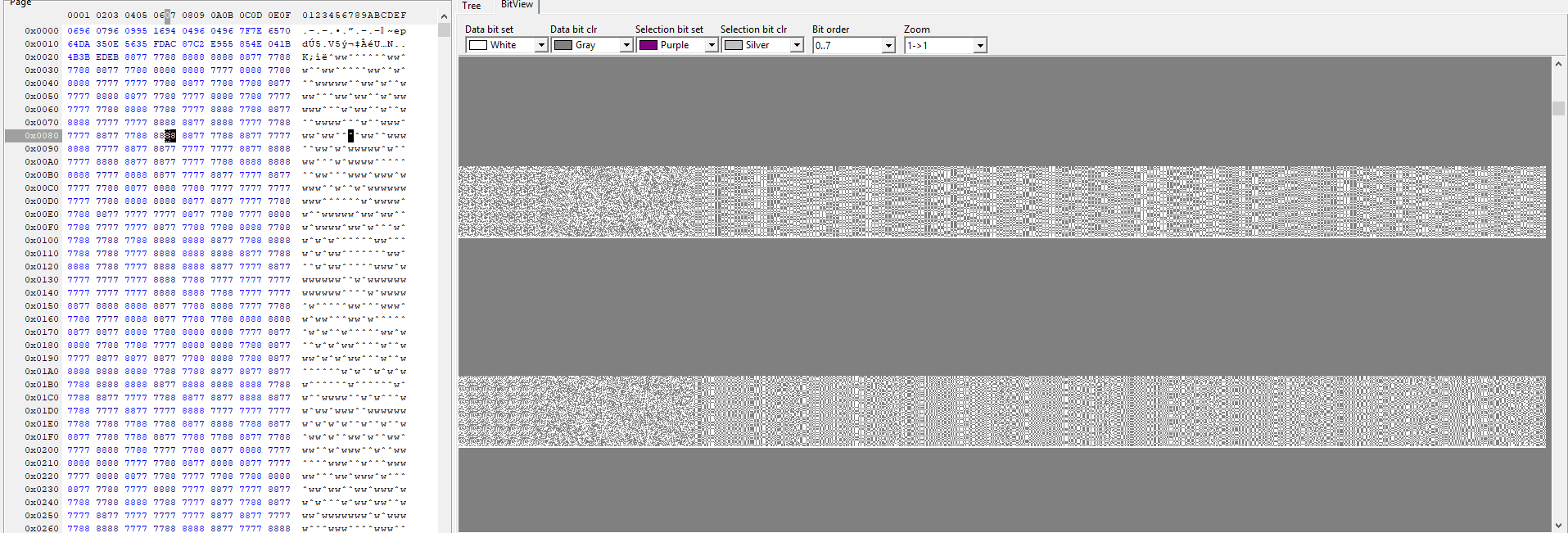

Hi arvika, Can you read Samsung EVO+ successfully? Did you find the R/B pin?
 Post subject: Re: Samsung EVO+ micro sd
PostPosted: February 13th, 2019, 10:08
Posts: 925
I think so, can you put image of card here? I need see pads, traces.

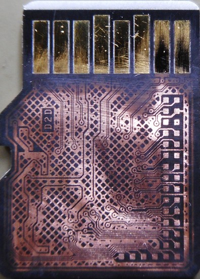

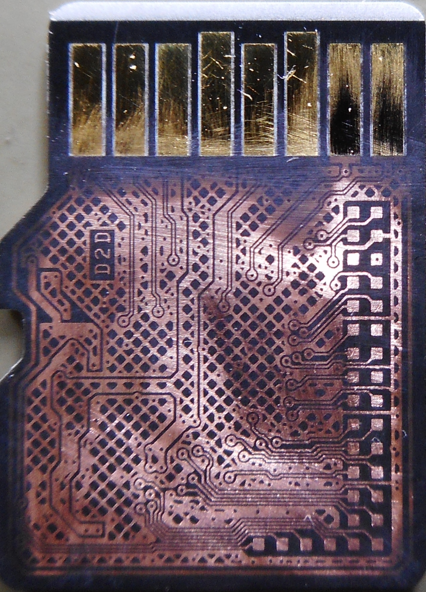

PostPosted: February 14th, 2019, 11:19
Posts: 925
MicroSD v93 from our database. We can read it but we can't assembly the data. It is complicated XOR and assembling algorithm.
PostPosted: February 14th, 2019, 11:24
Joined: February 10th, 2019, 13:43
Posts: 5
Location: united states
Where is the R/B?
