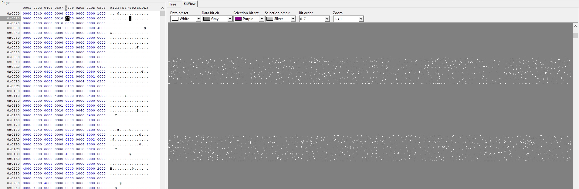

I'm trying to read Samsung EVO+ microsd, I've used Ignore busy cause I didn't find the R/B.
the dump turned out to be bad i've attached a bitmap screenshot.
What is the problem here? Does anyone else have this problem?
Thanks.

What ID do you have? Did you ask support for help?

most flash don't have any relevant data from 0x0 to after the first block. can have some firmware there or something but go forward in the dump a bit.
You are right though, the dump doesn't look right

ID - ECDE88BF, I didn't ask support for help because I've heard there is a problem with Samsung EVO+ SD cards so I thought this is the problem, is it not?
HaQue the screenshot is not from the beginning.
