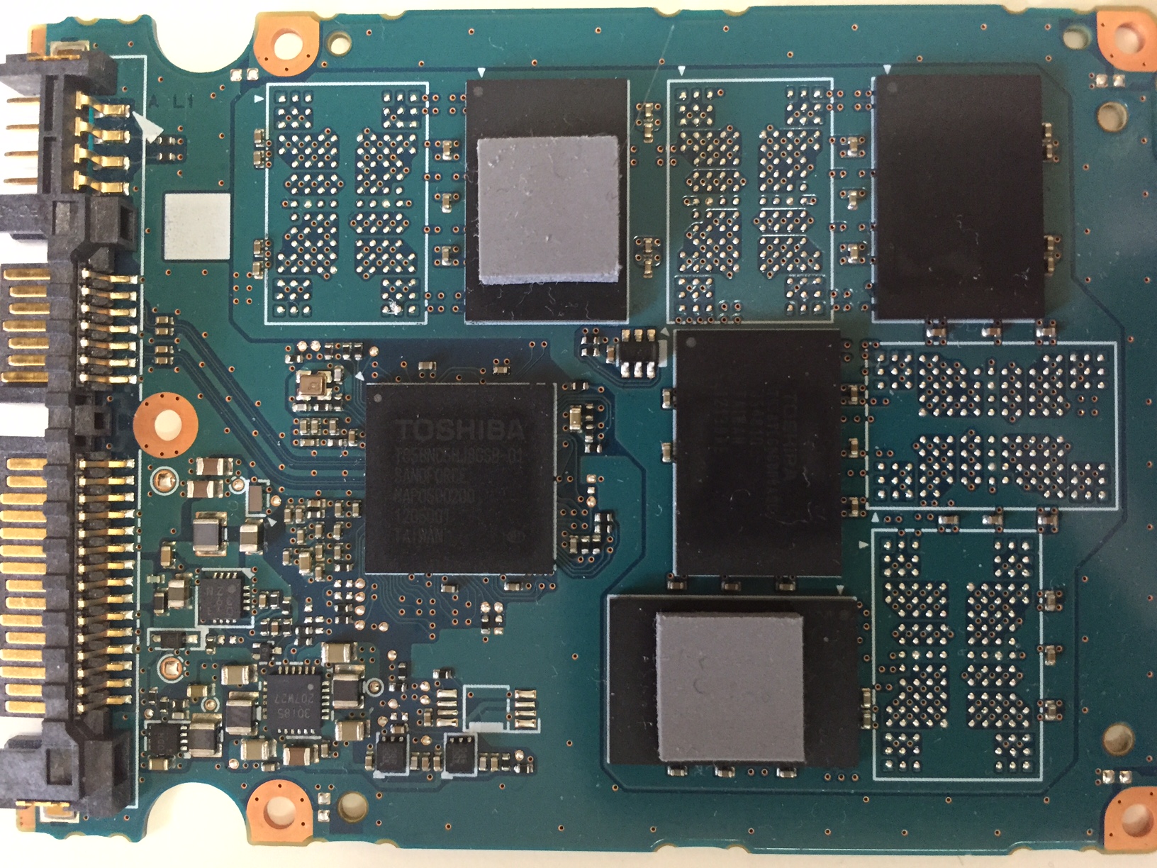

Hello everyone,
I have this Toshiba SSD drive that all sectors look empty. Does anyone know how to deal with this kind of problem on this drive?
Thanx everyone in adnvance.
Maestro

 Post subject: Re: TOSHIBA THNSNS128GCSP Empty sectors
PostPosted: February 8th, 2019, 4:12
Posts: 922

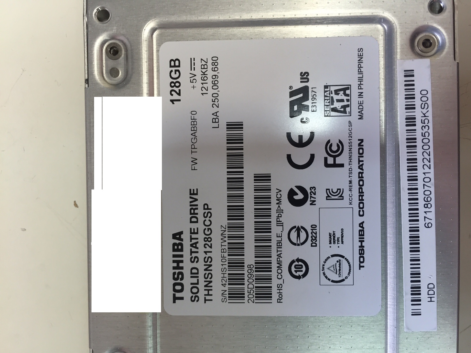

Please put photo here.
PostPosted: February 8th, 2019, 8:10
Joined: August 22nd, 2007, 3:55
Posts: 52
Here are photos from the drive
Thank you
PostPosted: February 8th, 2019, 9:09
Posts: 3977
Being SandForce makes it hard. Contact Northwind. They are in Greece but are highly respected for DR. There are not many shops that have, but they do have some SandForce solutions.
PostPosted: February 8th, 2019, 9:10
Posts: 922
It is Sandforce controller rebranded to Toshiba. Common problem.
PostPosted: February 9th, 2019, 14:50
Maybe recoverable but not DIY.
If data is important then contact Northwind
PostPosted: February 10th, 2019, 3:39
Posts: 3550
Yep, we should be able to handle those.
