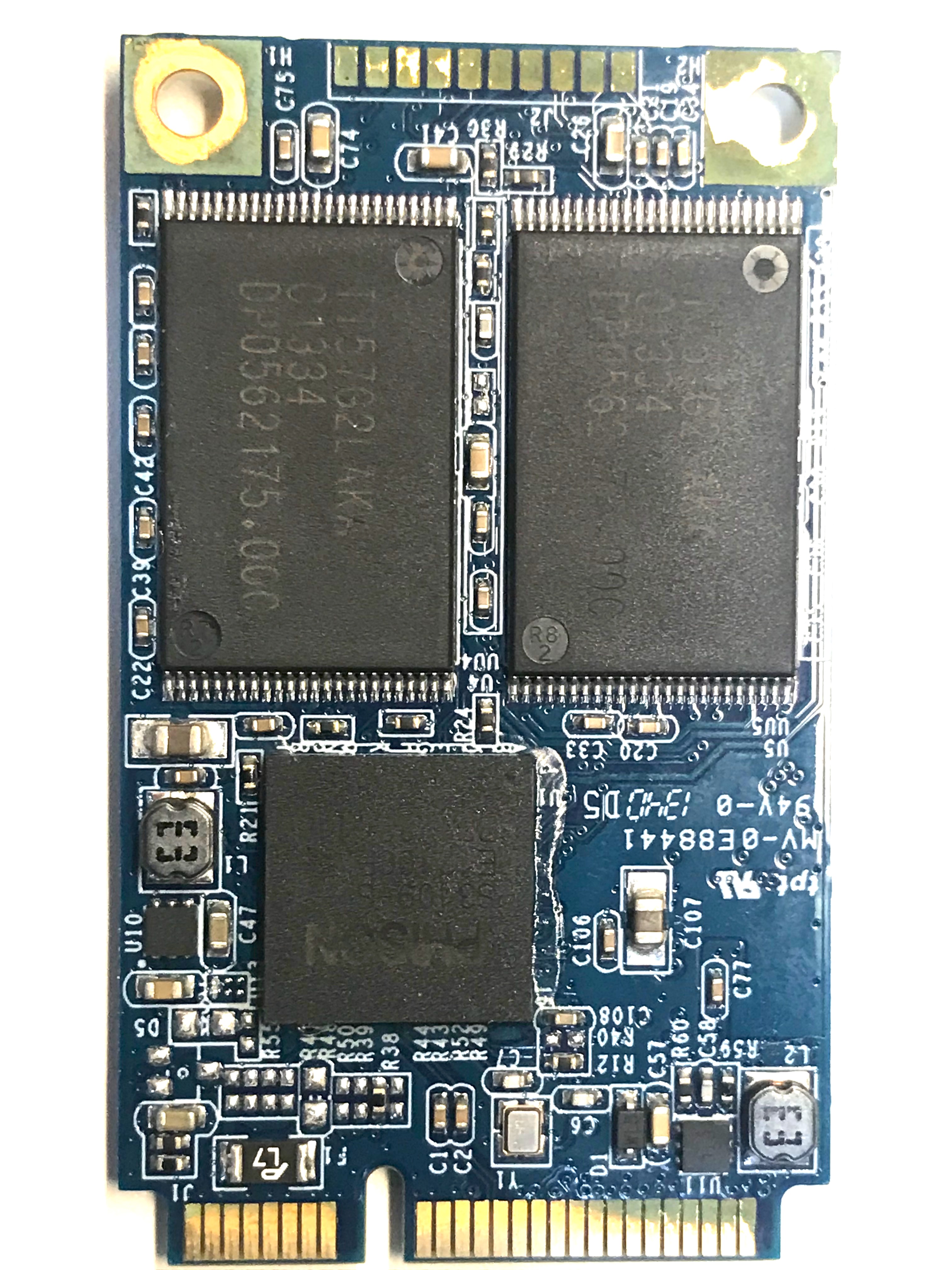

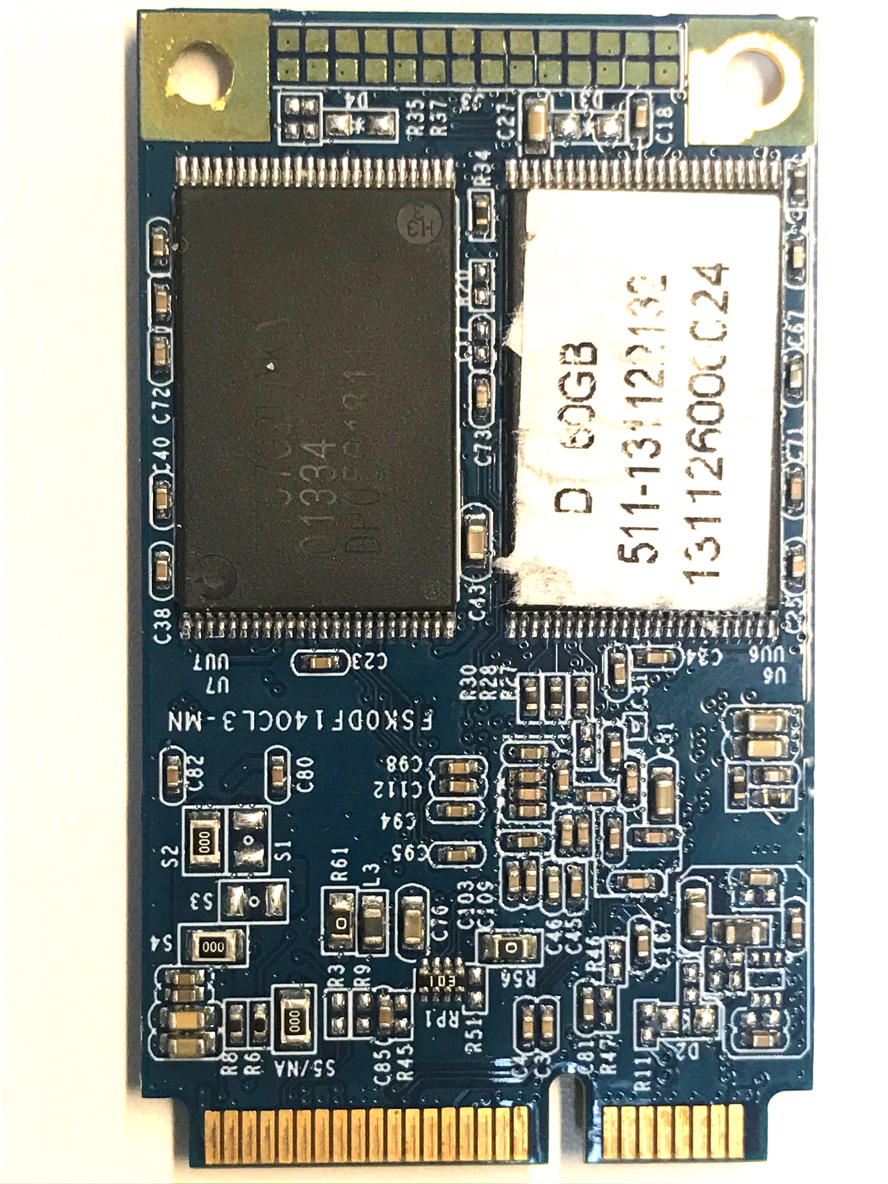

It may be a Patriot brand with a Phison PS3109-S9-J controller.
Shorting R29 has no effect.
Thanks in advance,
Jon

FWIW, here is an identical (?) PCB:
MyDigitalSSD Super Cache 2 64GB Benchmarks and Review:
https://www.servethehome.com/mydigitalssd-super-cache-2-64gb-benchmarks/
Is that a standard NAND pinout? If so, would it make sense to short the R/B* pin to ground?
Did you measure the voltages at the "E3" inductors (L1 and L2) and "L7" polyfused (F1)?

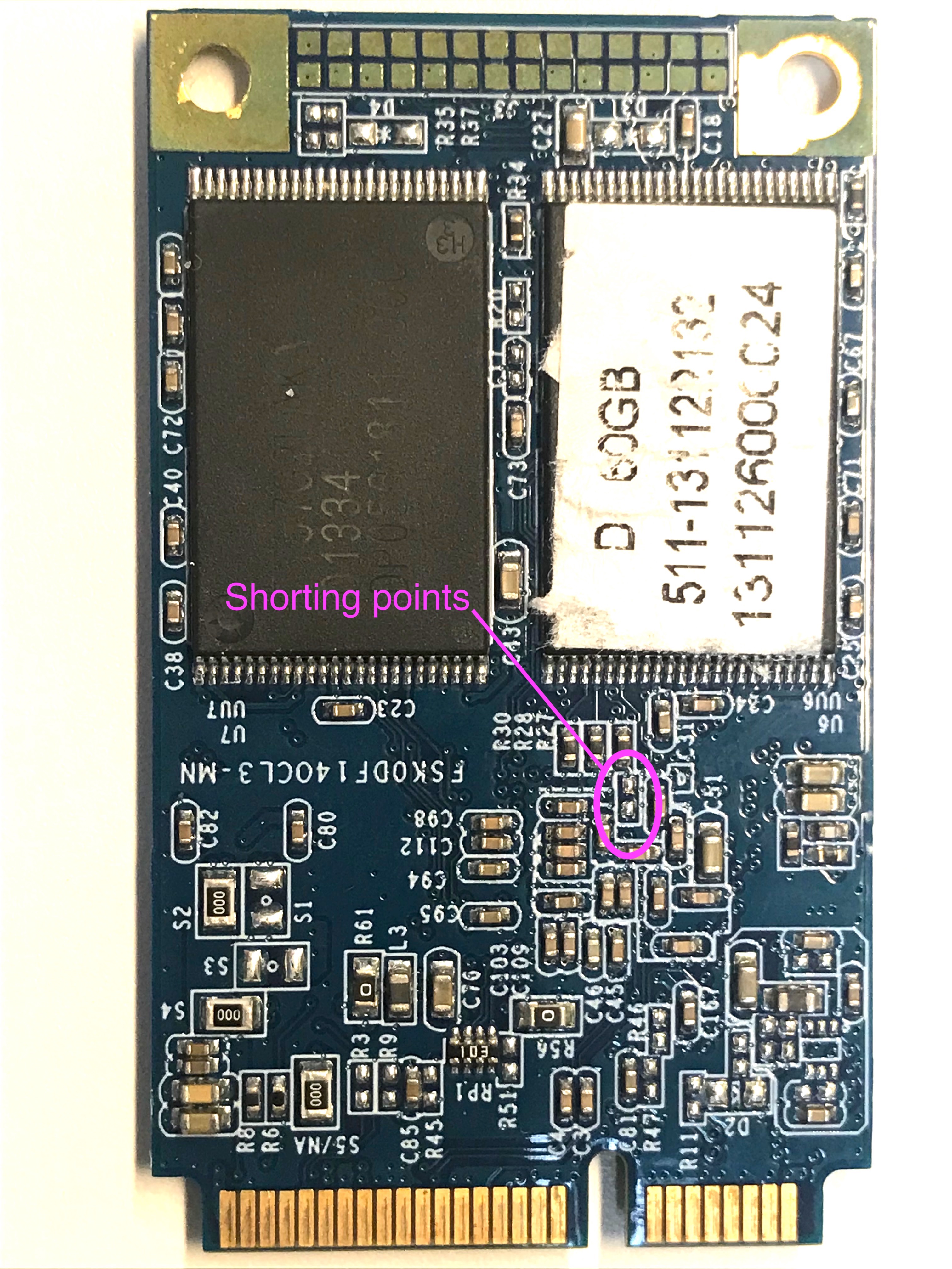

THANK YOU fzabkar.
Got it through trial and error.

Trial and error, in the absence of precautions, is a very dangerous approach.
I saw those same two pads, but refrained from suggesting that you try shorting them. One of them appears to be connected to pin #7 (Ready/Busy*). However, the other pad could be connected to ground or Vcc, or somewhere else. NAND datasheets specify that R/B* is open drain. This means that the pin is driven to ground when the NAND is Busy, and allowed to float to Vcc when the NAND is Ready. Normally one would expect a pullup resistor on that pin, either as a discrete external component or an internal pullup within the flash controller (?). If those two pads are in fact reserved for a pullup, then your tweezers would be shorting the R/B* pin to Vcc. This could destroy that pin, especially if the NAND is trying to signal BUSY*. To avoid this possibility, I would have started by checking the voltages and connectivity of those pads to confirm that one is connected to R/B* and the other to ground.
BTW, I wonder whether any of those pads at the edge of the PCB is connected to R/B*. If so, then it may prove useful for other similar SSDs. I also wonder whether shorting R/B* to ground could be a universal approach for all SSDs.

It appears that the solution in the present case was to short the R/B* (Ready/Busy*) pin to ground. This pin is "open drain" and is designed to be switched directly to ground (as are "open collector" pins). Therefore, all one needs to do is to locate, with a DMM or by visual inspection, a test point which connects to pin #7 (R/B* for a standard ONFI NAND). One can then safely short this test point to ground.
https://en.wikipedia.org/wiki/Open_collector
When the NAND is in the Busy state, its open drain (or open collector) output is driven to ground via a transistor switch. Conversely, when the NAND is in the Ready state, this same switch is open.

As you can see, if you were to short the two ends of the external pullup resistor, and if the NAND were in the Busy state, you would be connecting Vcc directly to ground via the closed switch. This could seriously damage, or destroy, the switch.
