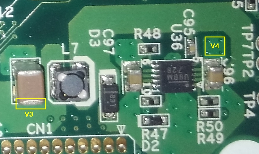

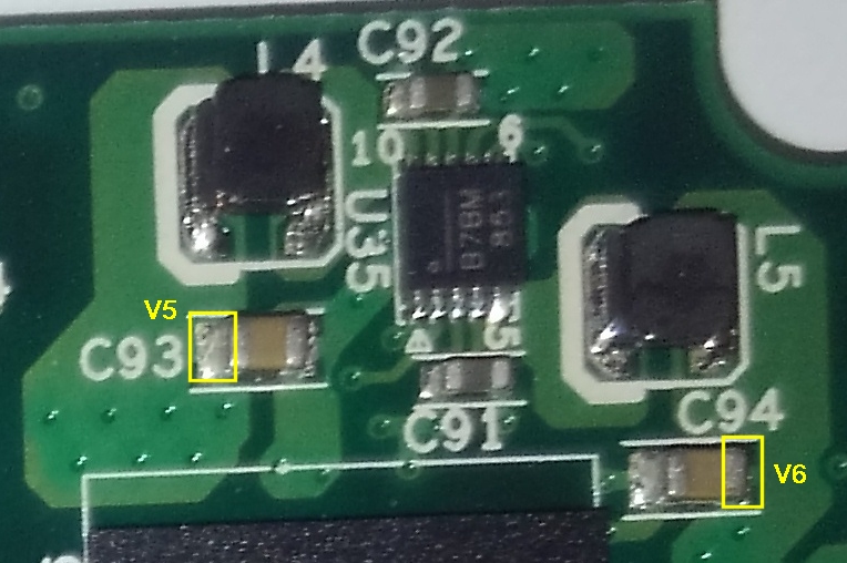

I would measure the voltages at test points V1 - V9. I suspect they will be OK, though.

MP2119DQ, Monolithic Power, 2A, 6V Synchronous, Step-Down Switching Regulator, marking U8xx+xxx, QFN3x3-10
https://www.mouser.com/ds/2/277/MP2119_r0.94-475832.pdf
MP2109DQ, Monolithic Power, Dual 1.2MHz, 800mA Synchronous Step-Down Converter, marking B7xx+xxx, QFN3x3-10:
http://www.dzsc.com/uploadfile/company/123460/201062413119725.pdf

I took measurements from the test points because i wasn't sure where you wanted me to measure from.
v1 to TP1 0.9vdc
v2 to TP2 3.34vdc
v3 to TP3 3.30vdc
v4 to TP4 4.9vdc
v5 to TP5 1.821vdc
v6 to TP6 1.986vdc
v7 to TP6 4.99vdc
v8 to TP6 4.87vdc
 Post subject: Re: OCZ Technology - OCZSSD2-1VTXPL240G.N Data Recovery
PostPosted: March 21st, 2019, 23:40
Posts: 17232
All voltages should be measured against a ground reference, eg a screw hole or SATA ground.
