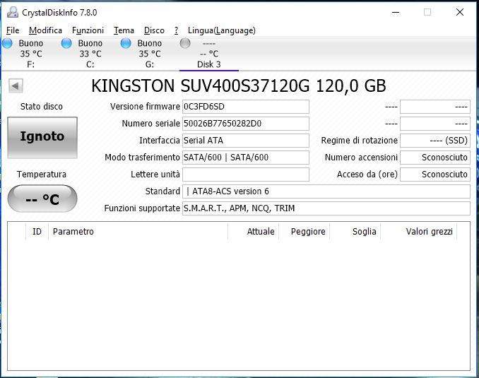

Hi guys, I have this ssd, it's normally recognized of bios and operating system but the partition its inaccessible. I have try to use ssd manager. Of Kingston but say there aren't a ssd connected on system, its strange because are connected. I have see in MRT but this unit missing. Can have suggestions for me? Thanks

What does CrystalDiskInfo report?
 Post subject: Re: Kingston ssd 120 suv400
PostPosted: April 12th, 2019, 21:23
You'll likely need to purchase PC3000 SSD or outsource to someone who has it already.

It would appear that the SSD has a "firmware" problem. You could measure the onboard supply voltages, but I suspect they will be OK.
