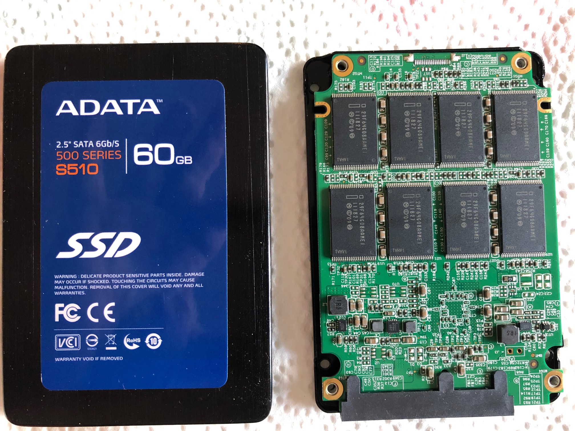

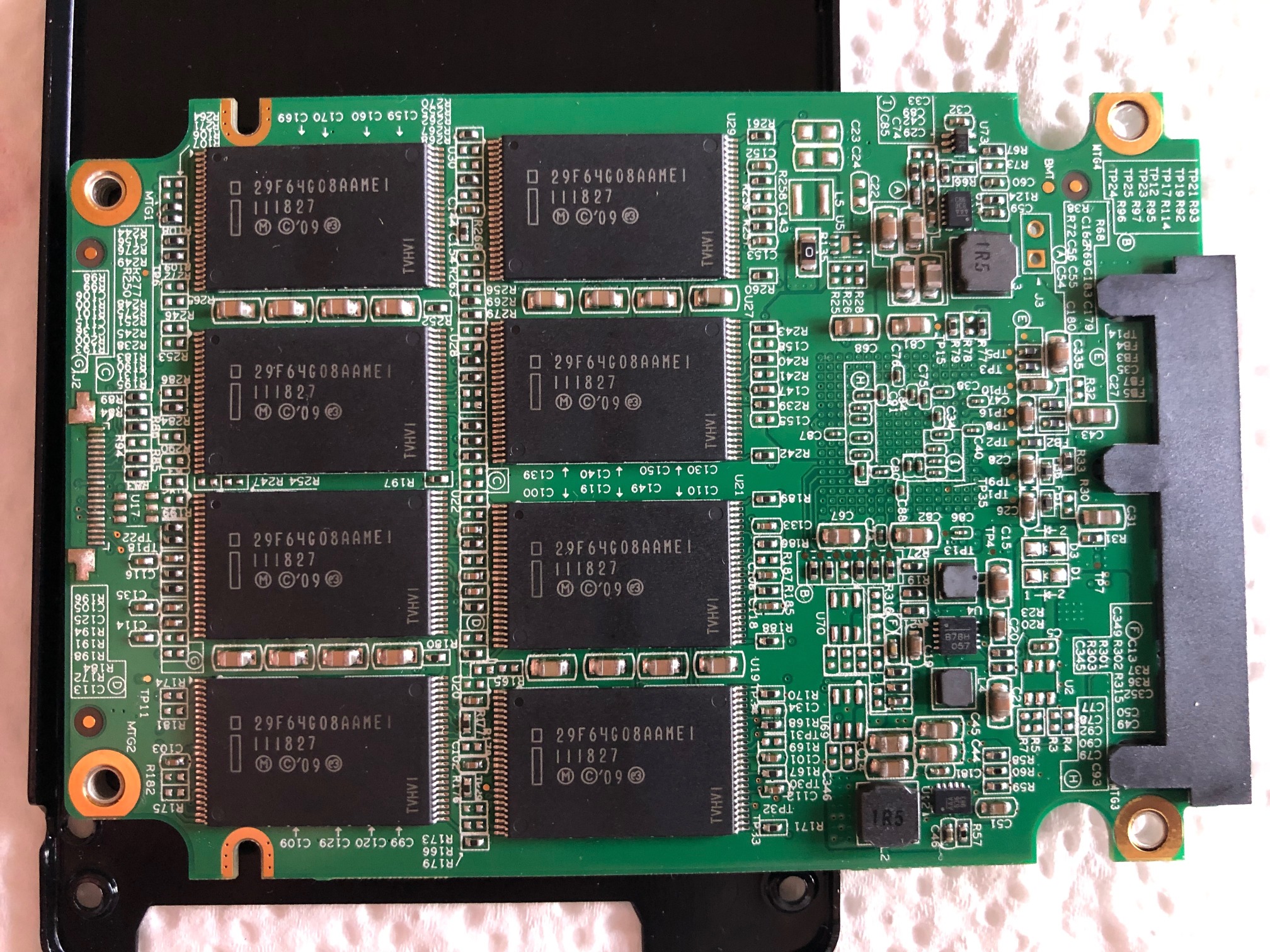

I have an ADATA 60GB SSD here. Here the firmware update with the official software of ADATA failed. Is there a way via Termial to reload the firmware?

If you don't need the data …
http://forum.ru-board.com/topic.cgi?forum=84&topic=5360

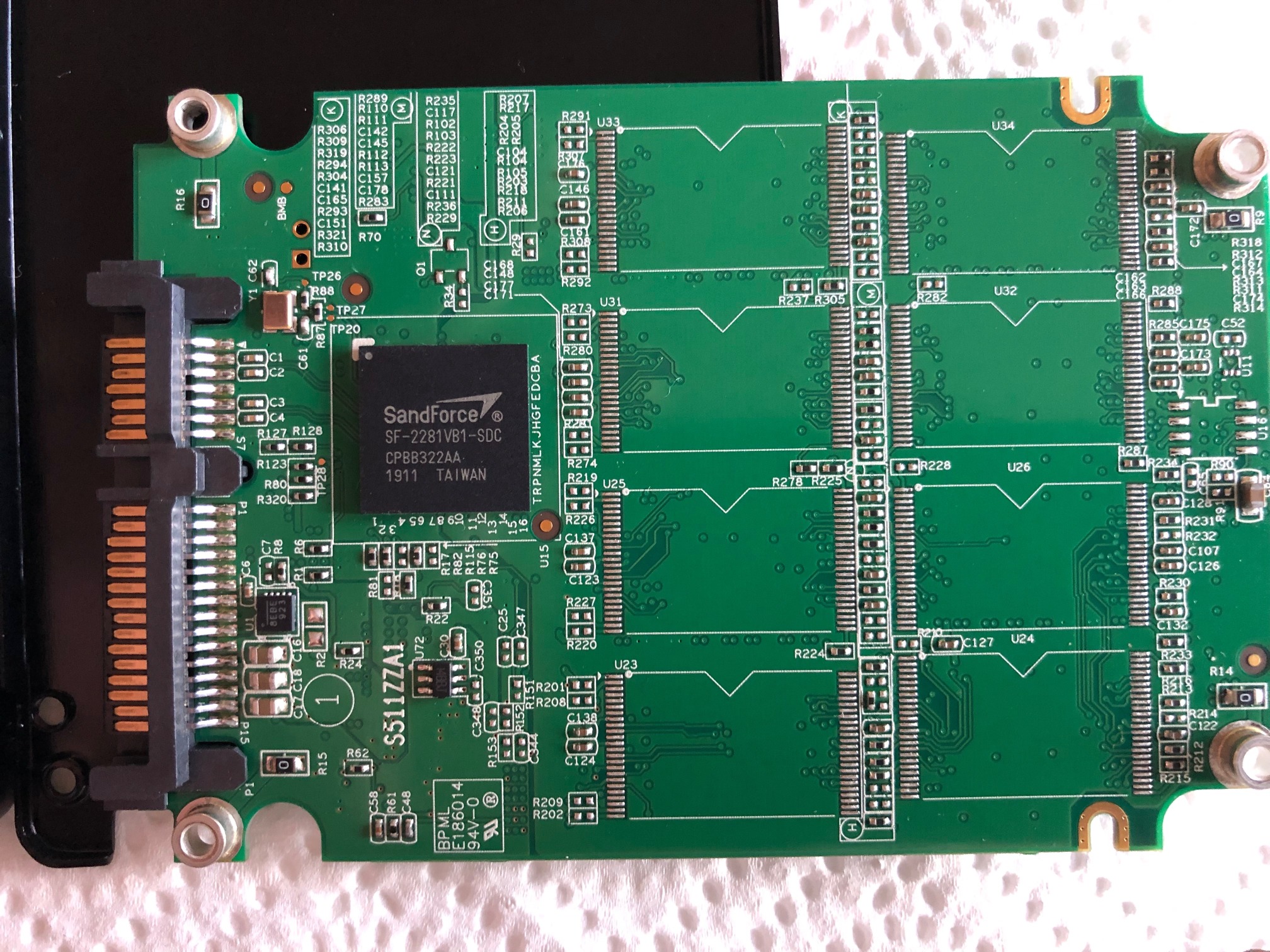

Does anyone know if this SSD has a temperature sensor? I could not locate any on the board.
I don't recognise any discrete temperature sensor IC.
What is the marking on U73? Is it "F2C"?
Is there a temperature attribute in the SMART report?

The Marking is 14BBJ.
Smart say Temp. not Supportet and SSD Toolbox say Temp over 60000 Grad
That's U72.
MP6400DJ-01, adjustable Programmable-Delay Supervisory Circuit, marking 4Bxx, TSOT23-6:
http://www.mouser.com/ds/2/277/MP6400_r1.1-371744.pdf

I think this ssd has no temperature sensor.
