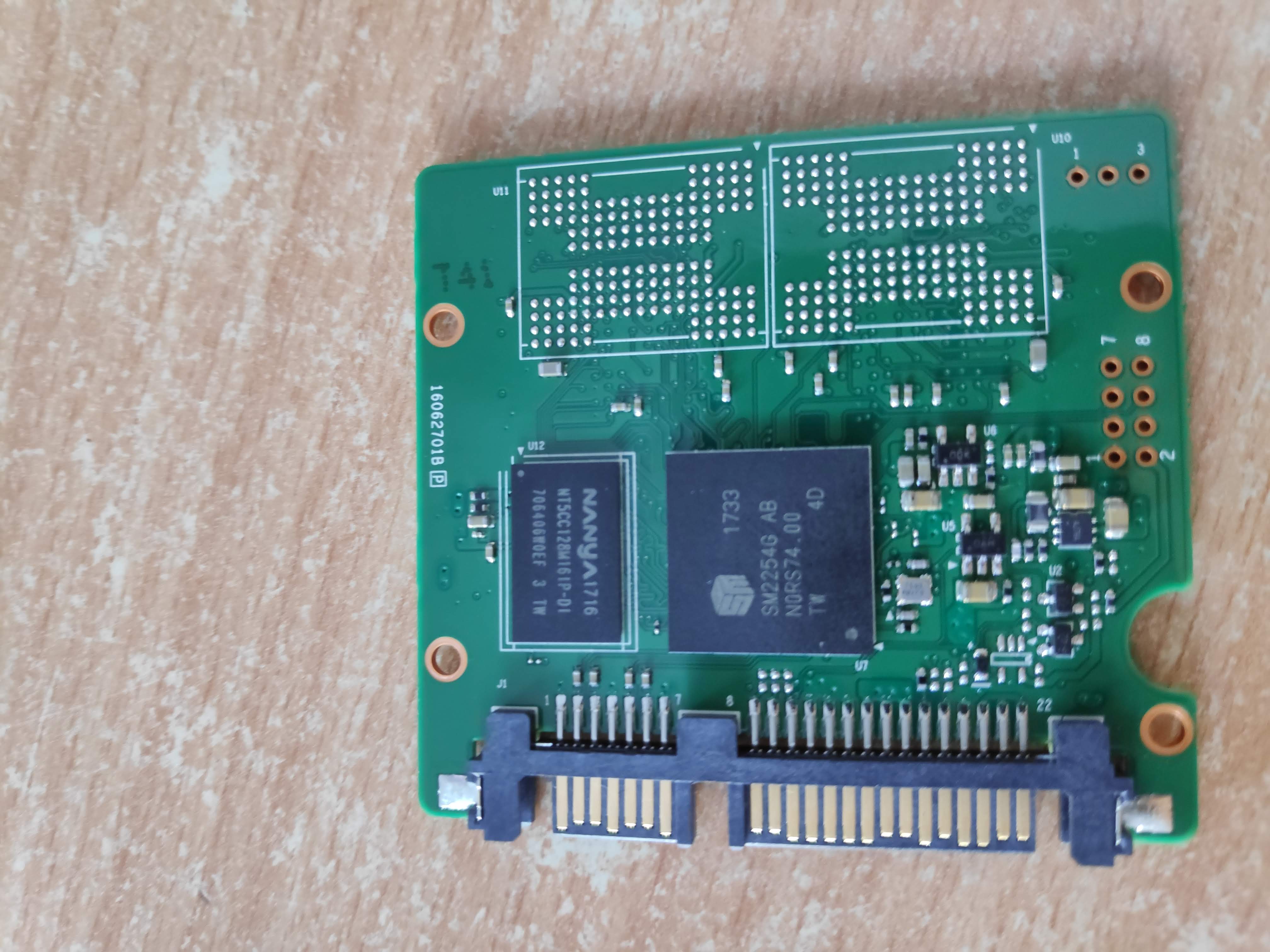

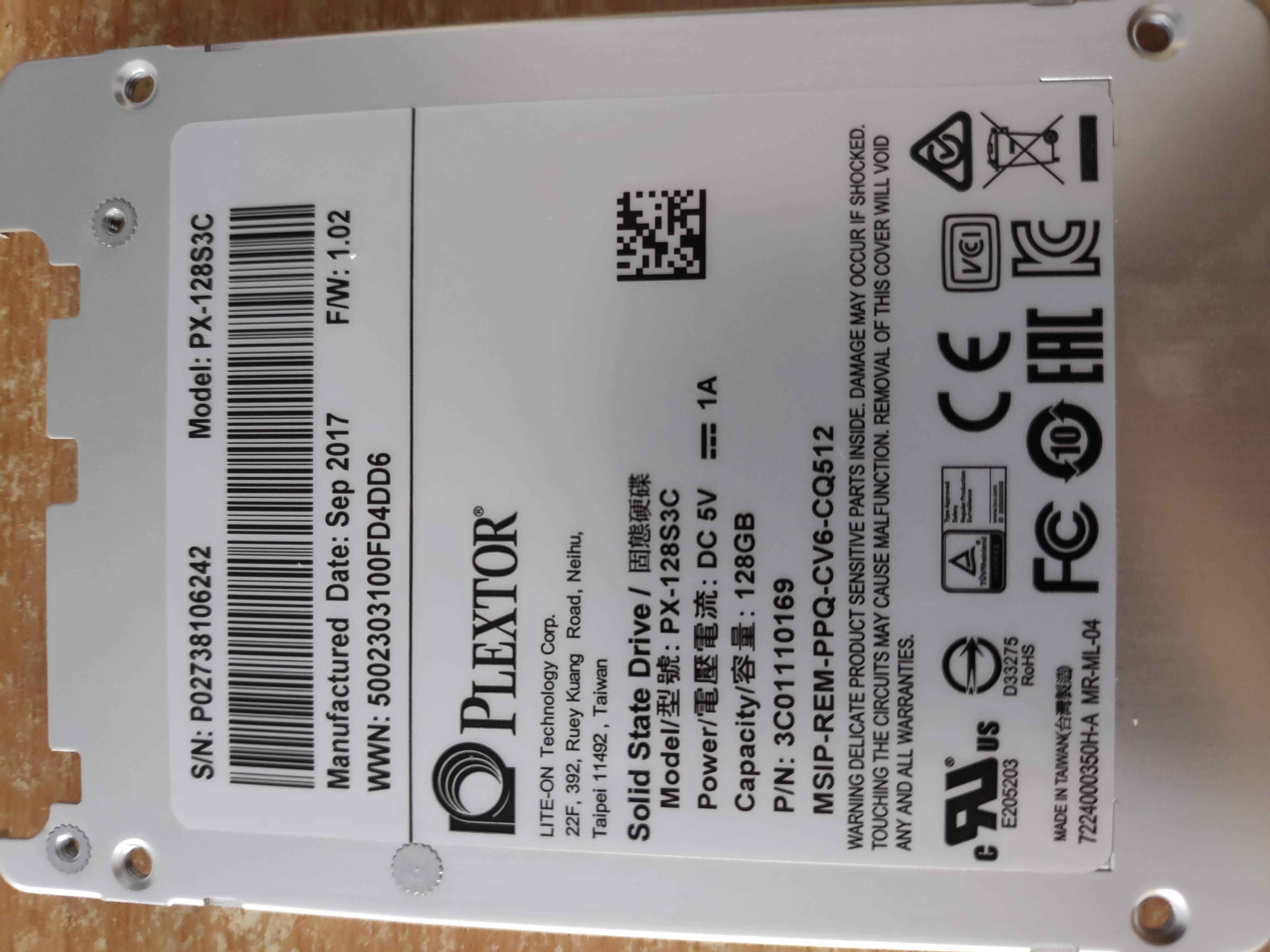

Hi Guys
I have this Plextor SSD that is well ID, but no access to UA (stays busy).
This controller is not supported yet by PC3K.
Does anyone have any kind of solution?

In-circuit recovery of SSDs with "weak" NAND:
http://www.hddoracle.com/viewtopic.php?f=106&t=2740

And how to connect?
Did you ever make one work?
ACELab partner
 Post subject: Re: SM2254G Plextor
PostPosted: July 22nd, 2019, 3:49
Posts: 17230
pclab wrote:
And how to connect?
It's all explained in my tutorial.
Otherwise, show us the other side of the PCB.
This question was also answered in my tutorial with reference to the following thread:
viewtopic.php?f=1&t=38346

Hi
After all the case was solved with PC3000 DE.
Thanks for the help!
