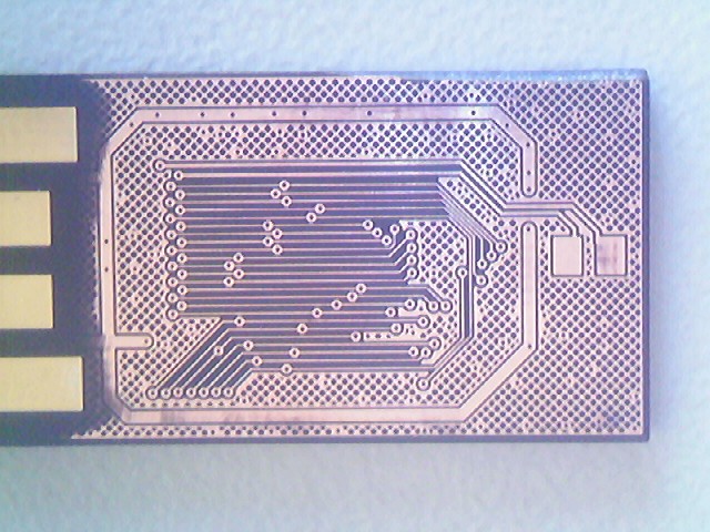

Hello.
Somebody know or have this pinmap?
best regards

There is similar pinout in VNR database, number 0077.
How do you find that one? I can't find any numbers in my database, and entering 0077 in Model or Identifier returns nothing. In fact, now when I checked it; I cannot find a single monolith image in the database.

bos wrote:
I have been meaning to put in a support ticket about the current TDevicesDB.sdf database file. It appears to be 16MB and the previous file was over 100MB in size. Also, there is a new monolith.db file but the instructions don't mention where to save it.
